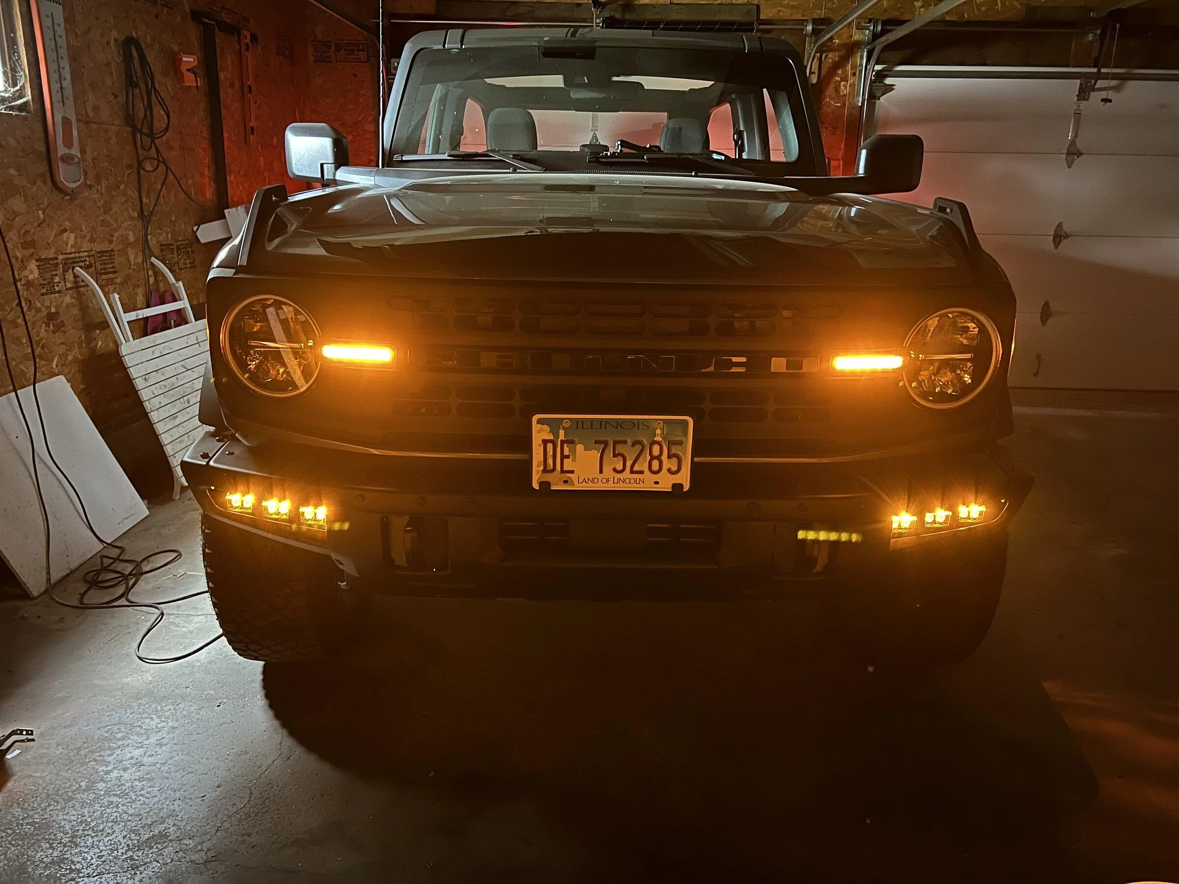

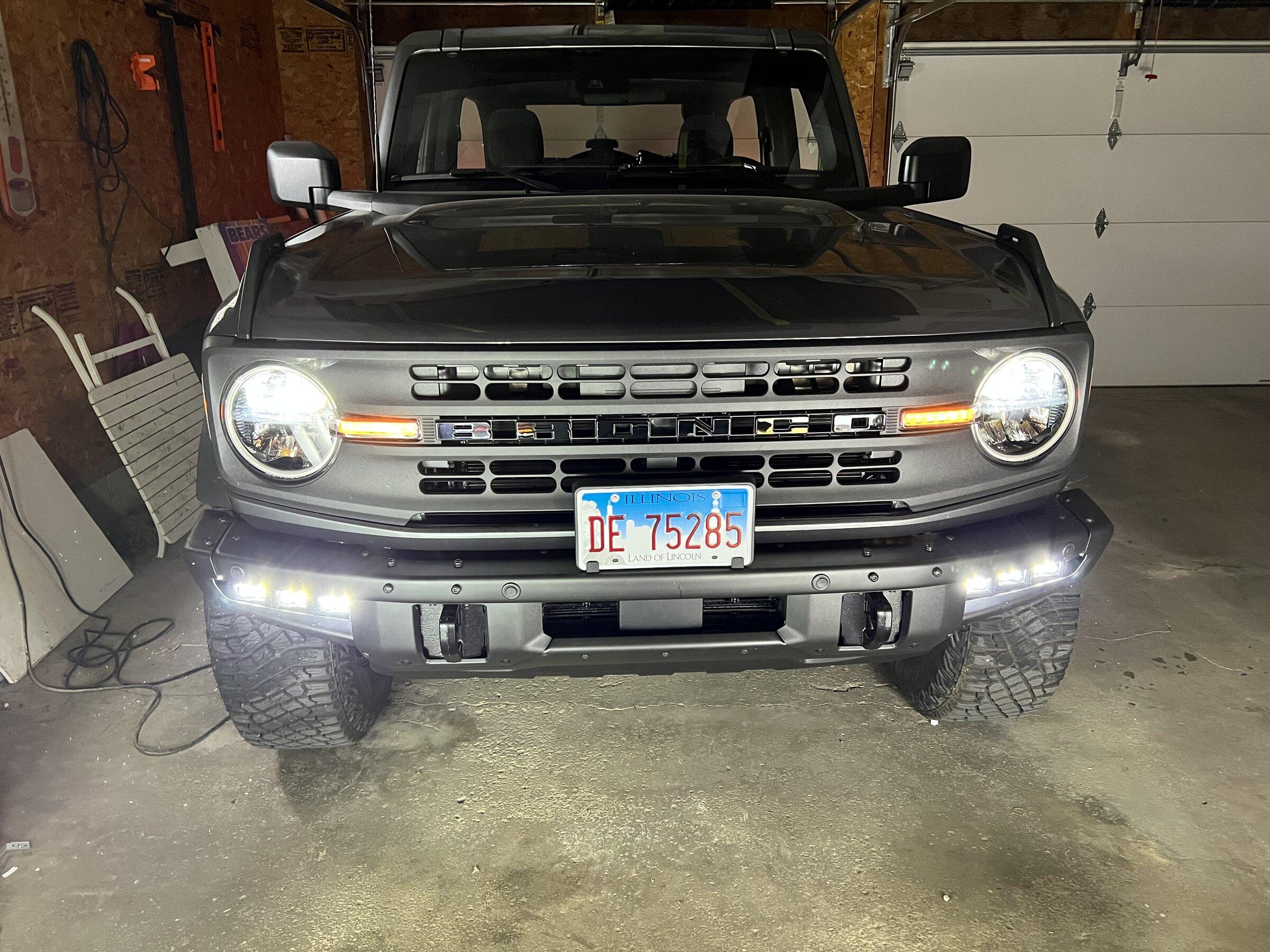

I got the ambers. Looks great with the running lights!
Ford Bronco Rough Country pocket lights - anyone installed? 2B8F3EC5-CB1C-406A-97DE-1E1305BF051C
Looking great! I just had the hidden winch installed a few weeks ago. Im going to install some performance rigid’s today. This post has me sold on their fog lights.
