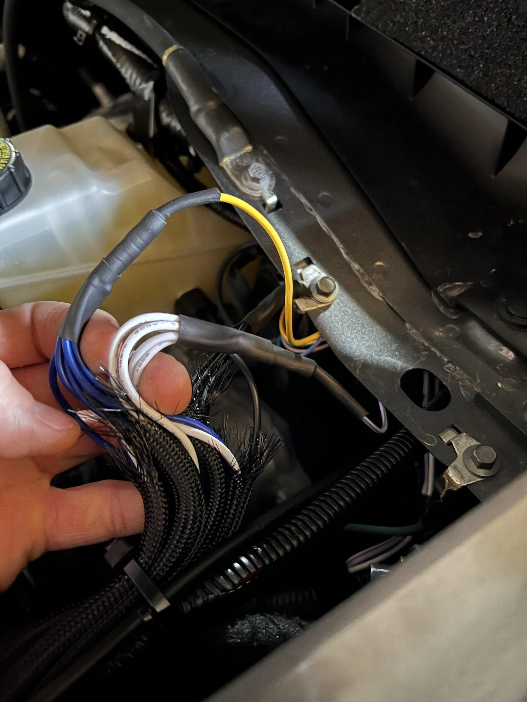

I ended up using two switches. Switch one (30 amp) for the white LED. And switch 3 for the drl. The total amps for 6 lights was 18 amps so if you want them all on one you have to use switch 1 and I’m ok with it. Switch 2 should be plenty for most light bars that’s my plan for switch 2.
here's where in confused... there's 3 wires in each of the harnesses, (a ground, and one each for the DRL and other light) obviously the 6 grounds you can run together, what did you do with the 12 remaining wires? hooked them all up to switch 1?
I tied all blue wires together to switch one those are the white LED. All white wires together to switch 3 those are the amber drl.
perfect! thank you! are there 4 or 6 white wires?

Cmcbronco rocks. Made this so much easier. Thank you! For those wondering I did switch two for white and three amber and it is works perfectly. I actually thought getting the wire runs safely throughout the engine compartment was the tricky part. I ran the passenger side up and behind the radiator and zip tied to the other wiring harness which sits on a cross beam. I ran both sets under the battery to the wiring connections. I love the overall look of the finished product and can't be happier with the rc lights.

Yes, that is correct. I wired white to aux 1 (yellow wire) and amber to aux 3 (purple/green wire) as suggested in this thread. Although a few posts above says aux 2 works for the whites as well, I was concerned about the power draw.
So I just ride around with the ambers on aux 3 on. When I turn my car off, they turn off. And at night when I need more light I flip aux 1 (and then I turn aux 3 off although technically they can both be on together but the bright white washes out the amber). Haven't taken them on any trails yet but they spread quality light very effectively. And they say off-road use only but I haven't had anyone flash their lights at me yet suggesting that they are too bright for oncoming traffic (I did try to aim them down a bit)
