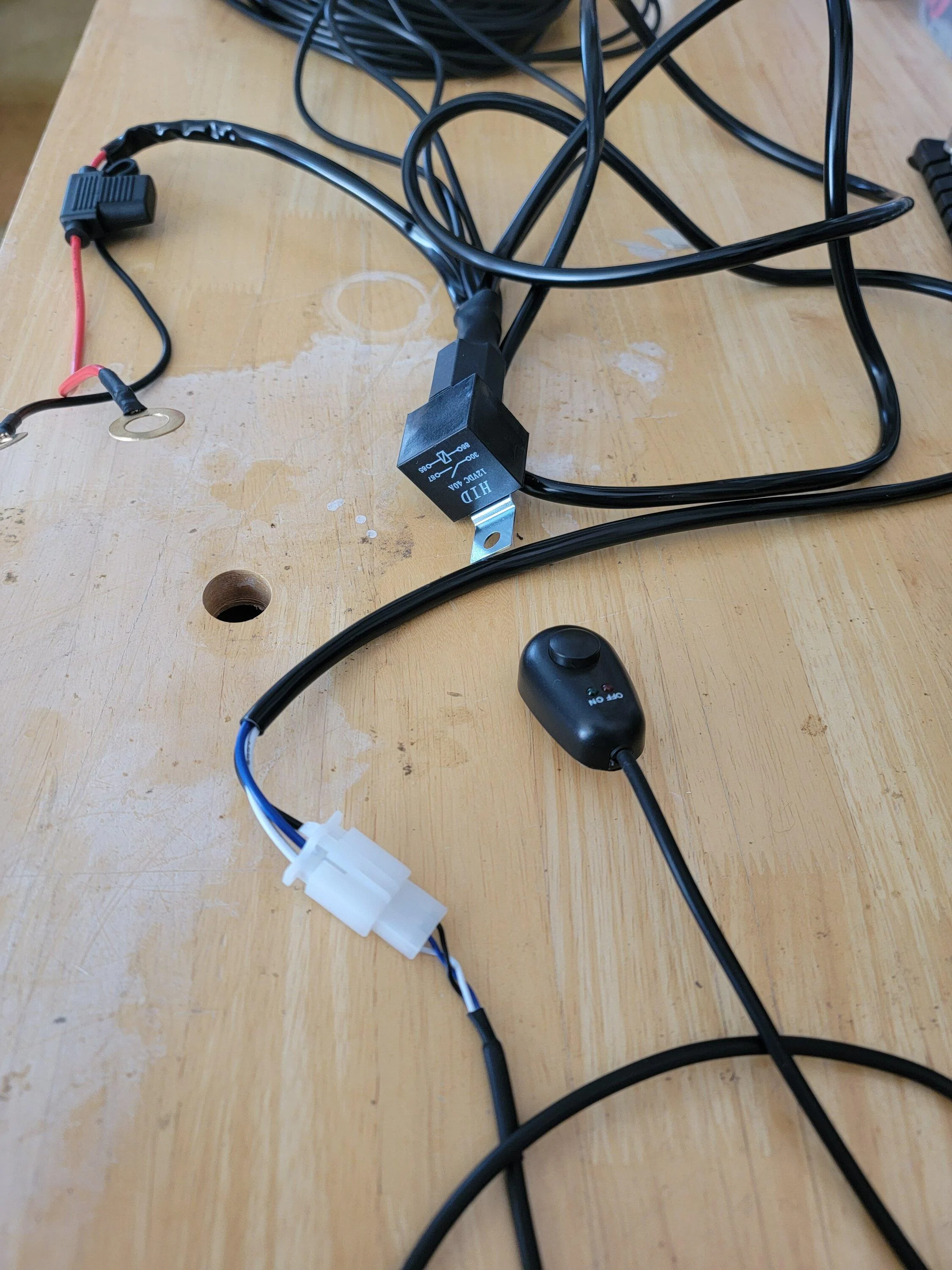

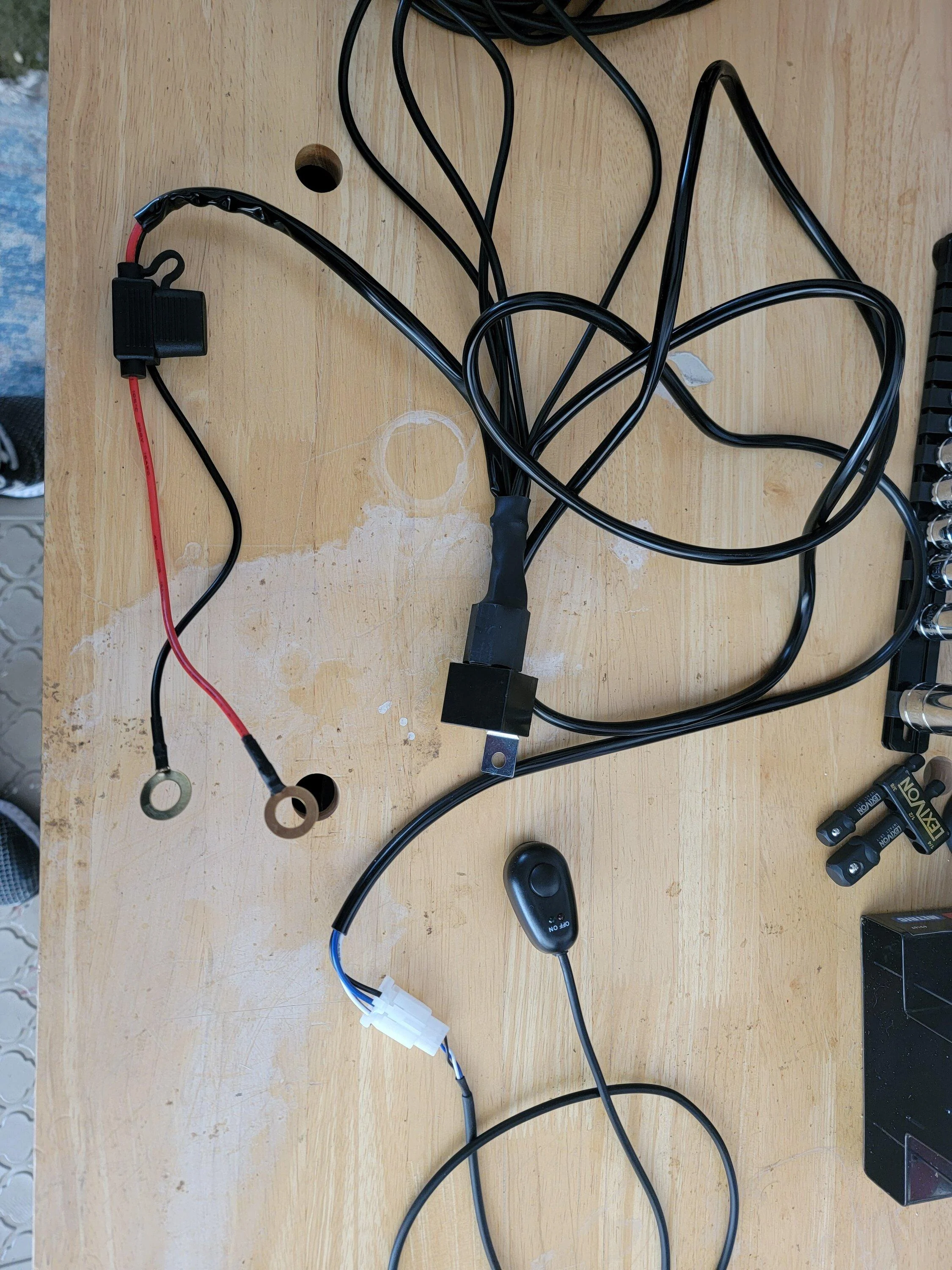

Anybody install them that has the accessory switches? How did you wire them? The harness is made for their switch and I can't seem to figure out how to modify it to work.

Yea I have on a couple of Broncos, the lights have a pig tail that clip into the harness that comes with the kit. I clipped the harness on then cut off the remainder of the harness. Then wired the positive to six switch wire and grounded the ground. Hard to explain. If you post a pic of the harness laid out I can mark where I cut it.

Remove the relay and the supplied switch and then wire the positive red wire to the desired AUX switch, then black to chassis ground
