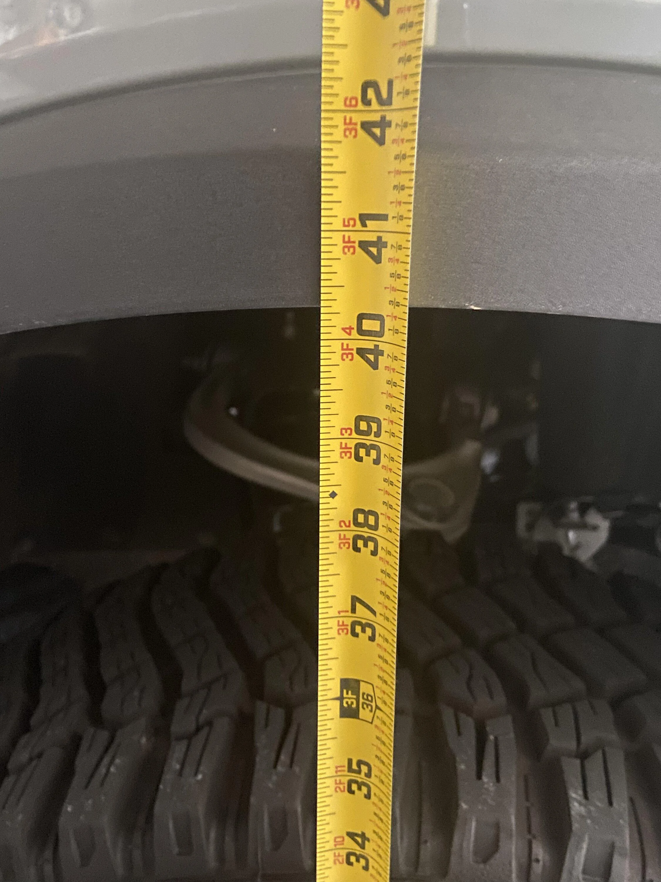

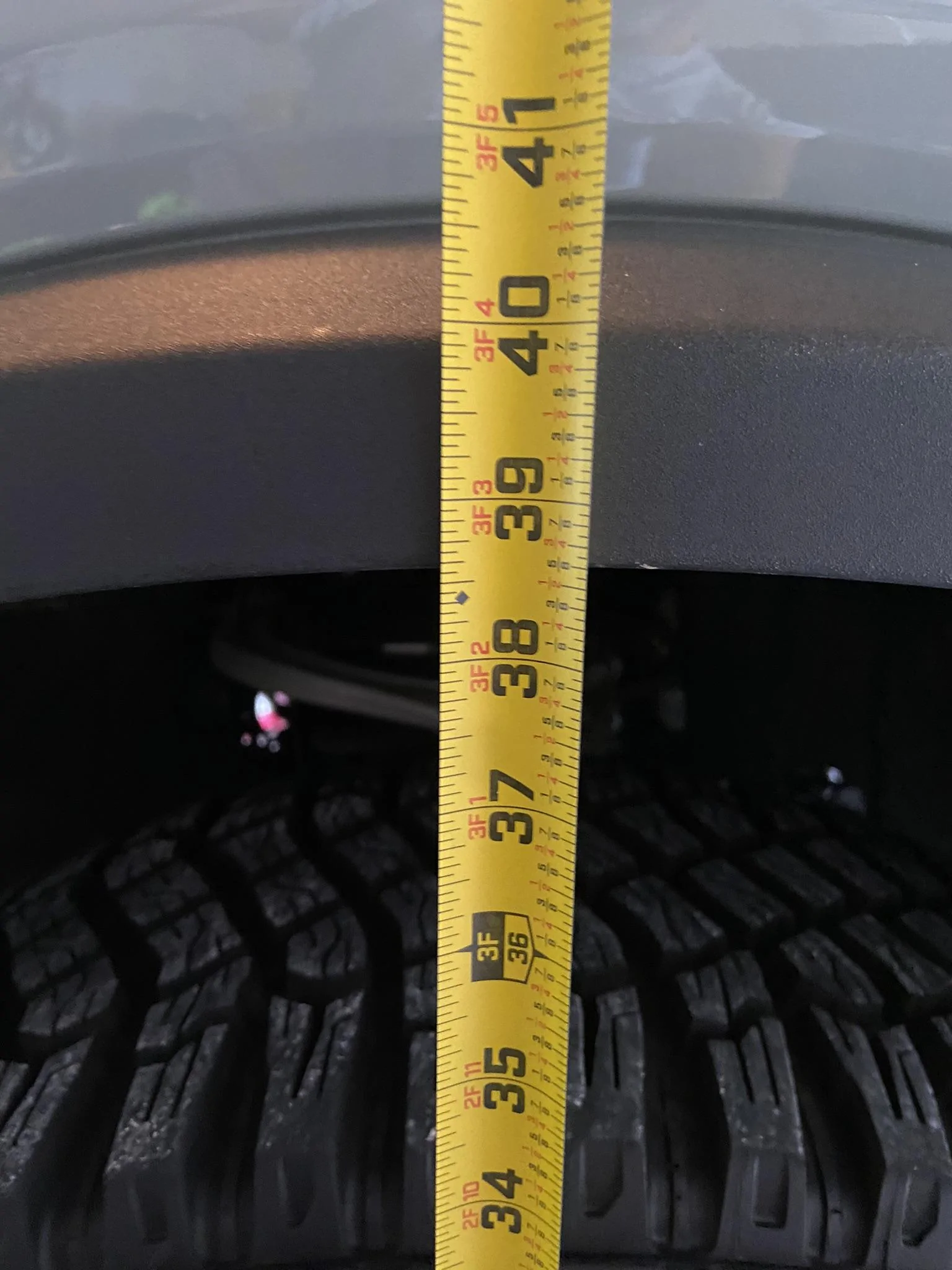

Anyone measure before and after? I don’t believe I’m getting the 2.25” height in the front. To me it looks like 1.75” in front??
