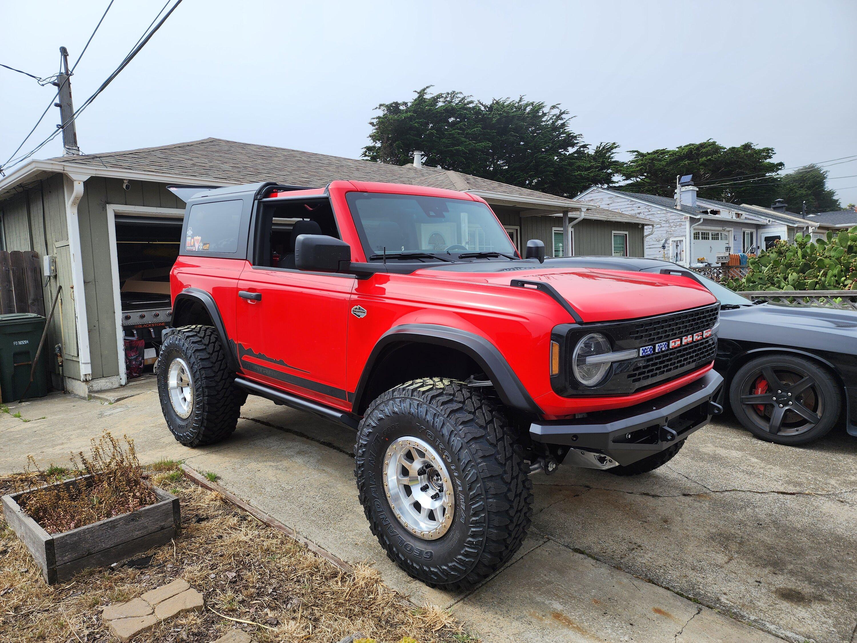

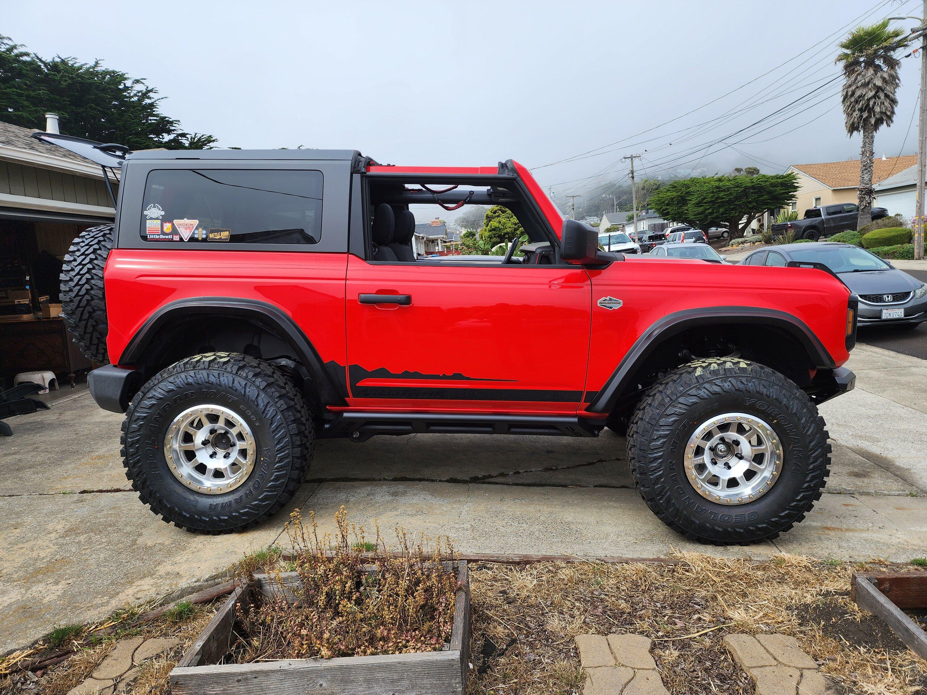

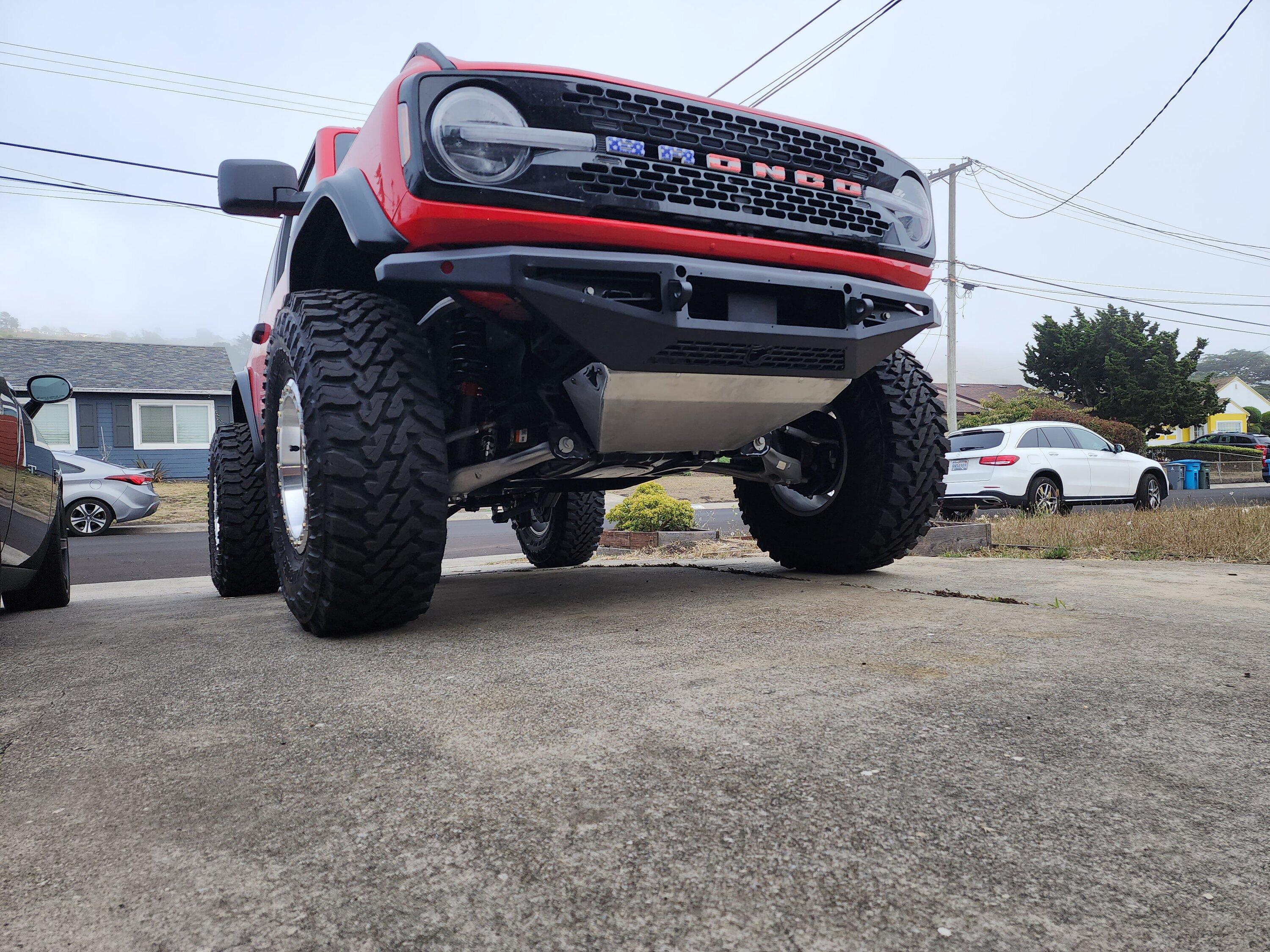

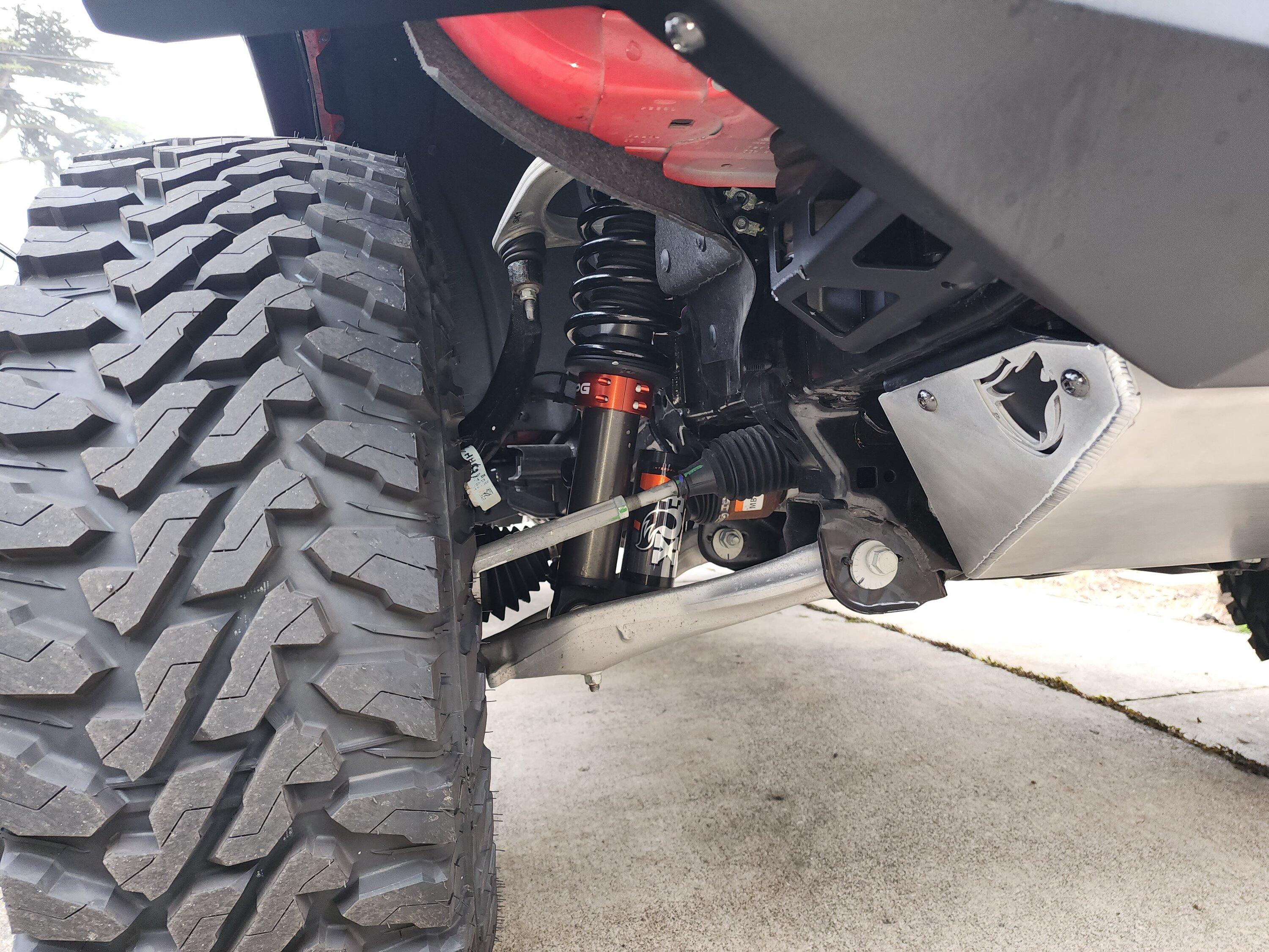

I guess I'll answer, LOL I installed the 3"/2.25" RPG collars on my HOSS 3.0 shocks last Saturday. Super easy install. Took me and my fellow tech (we are dealer techs with all the cool tools) 2.5 hours at the most. We also installed 37" Yokohamas with Battle Born Wheels and a Lobo HNT front bumper. I have yet to align it as I have some RPG upper control arms to install still.

Ya- niiice… I have the same RPGs and I love them. I have yet to encounter a drawback.
Are those the KDB fender flares? If not, what are they? THAT is the look I’m going for on my EG Moar Door!
Whatever brand they are what do you think of them and where can they be found?

Yes, they are KBD. I bought them right off their website. They look good and fit fine. I haven't applied the adhesive yet to stick them to the fenders. The mounting holes in the flares could be a little bigger for eaier install.

Boy, that came out great! I'm after maybe a 2" or 2.5" lift to clear a set of 37s. I assume the UCAs are because you're at 3"?

I haven't installed the UCA's yet, no problems so far. But I am putting them in tomorrow.
