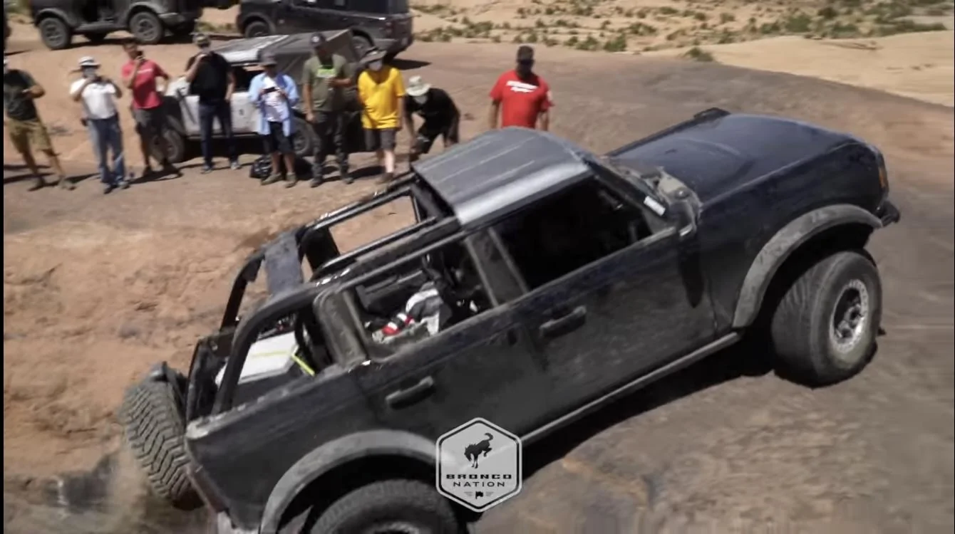

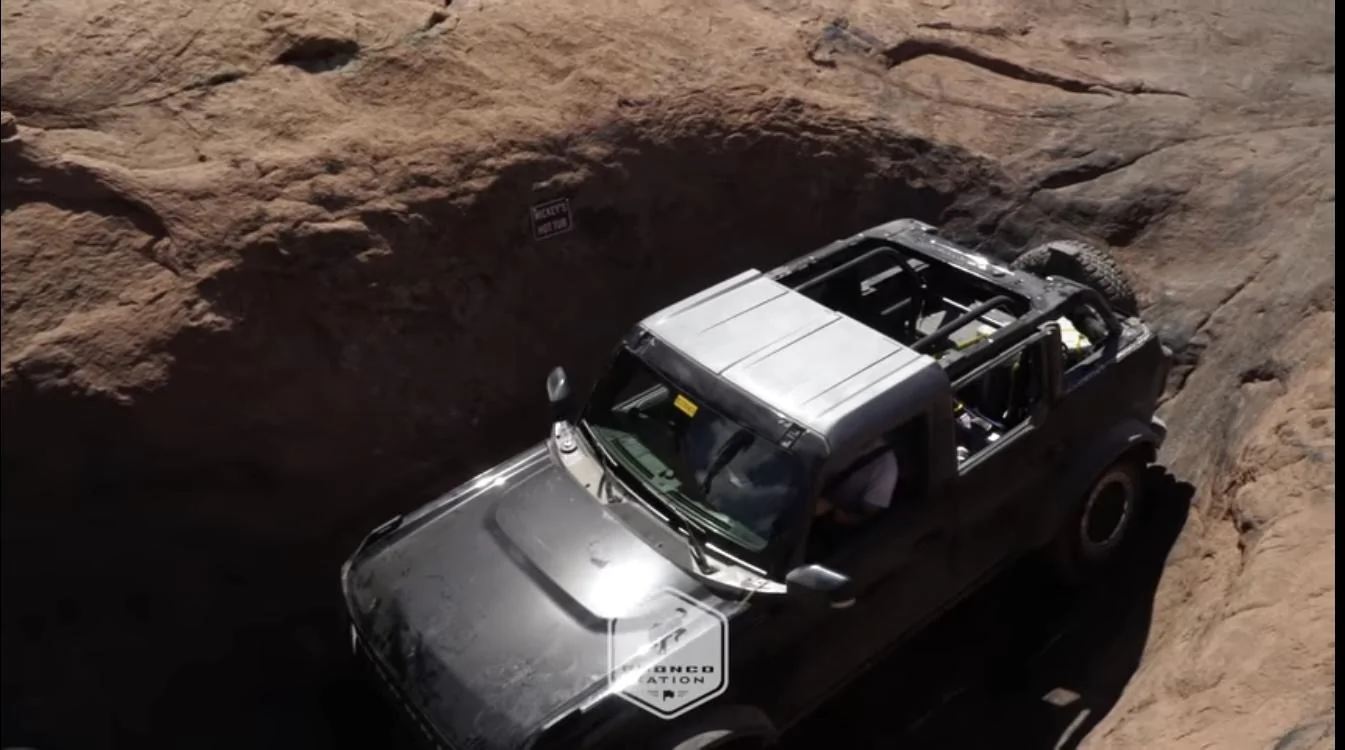

Enough support to climb out of a hole. While this is a 4-door, same concept. I guess it’s just the guide pins and the pressure from the twist locks holding it in place. Trying to remember if the 2nd row has guide pins and I wonder if it would be as secure. I’d too would like the option to run front panels or 1st and 2nd row. You’d think there could be a bracket to install to hold it securely.

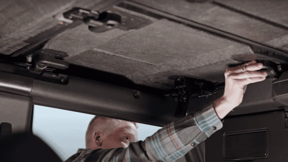

The front hatches connect to the roll cage. There are four points of contact. Three slide locks and a guide pin lock. You lose only one when you remove the rear hatch. It’s been a while but I remember them being really secure even without mid-sections in place. I would be surprised they’d fly off honestly. The panels nest with each other more than they structurally lock to each other anyways

As people have stated and it has been demonstrated, you can run front panels only off-road but Ford advises against it on road and definitely a big no at highway speeds.
However, I think a bracket could easily be fabricated that bolts/clamps/secures the rear of the front (or middle) panel to the rollbar that would make it safe(r) for travel at highway speeds.
