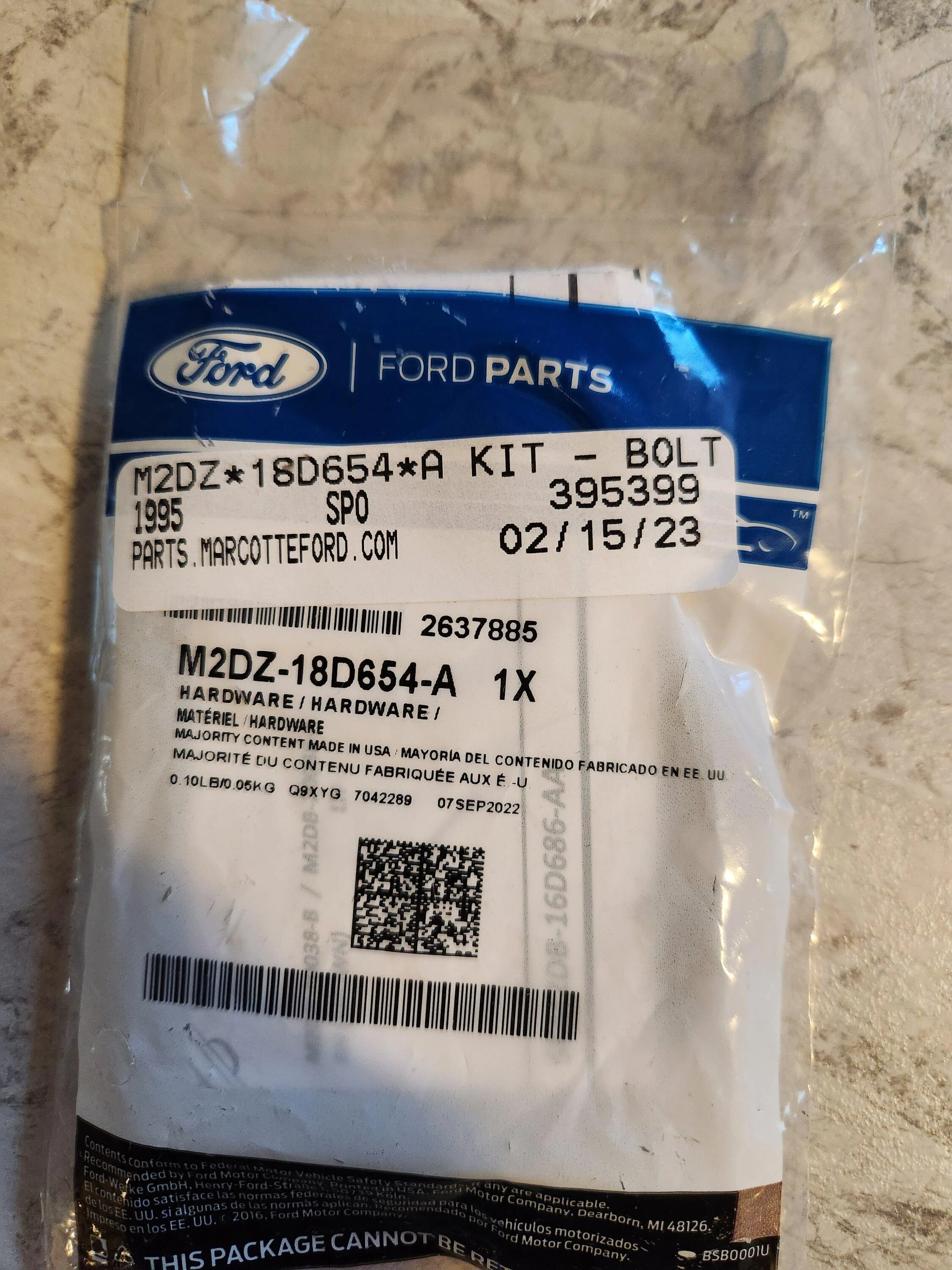

Has anyone ordered these? Ordering 2 sets runs about $100, just wondering if it's a satisfactory replacement.

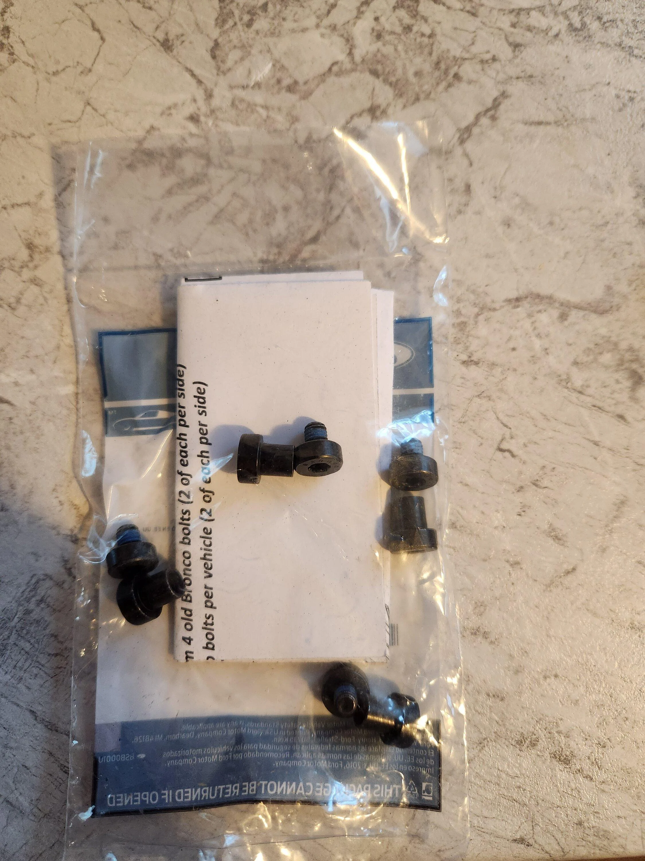

I ordered 2 kits @ $29 each plus shipping . Each kit came with 4 bolts and 4 nuts, so only needed 1.
