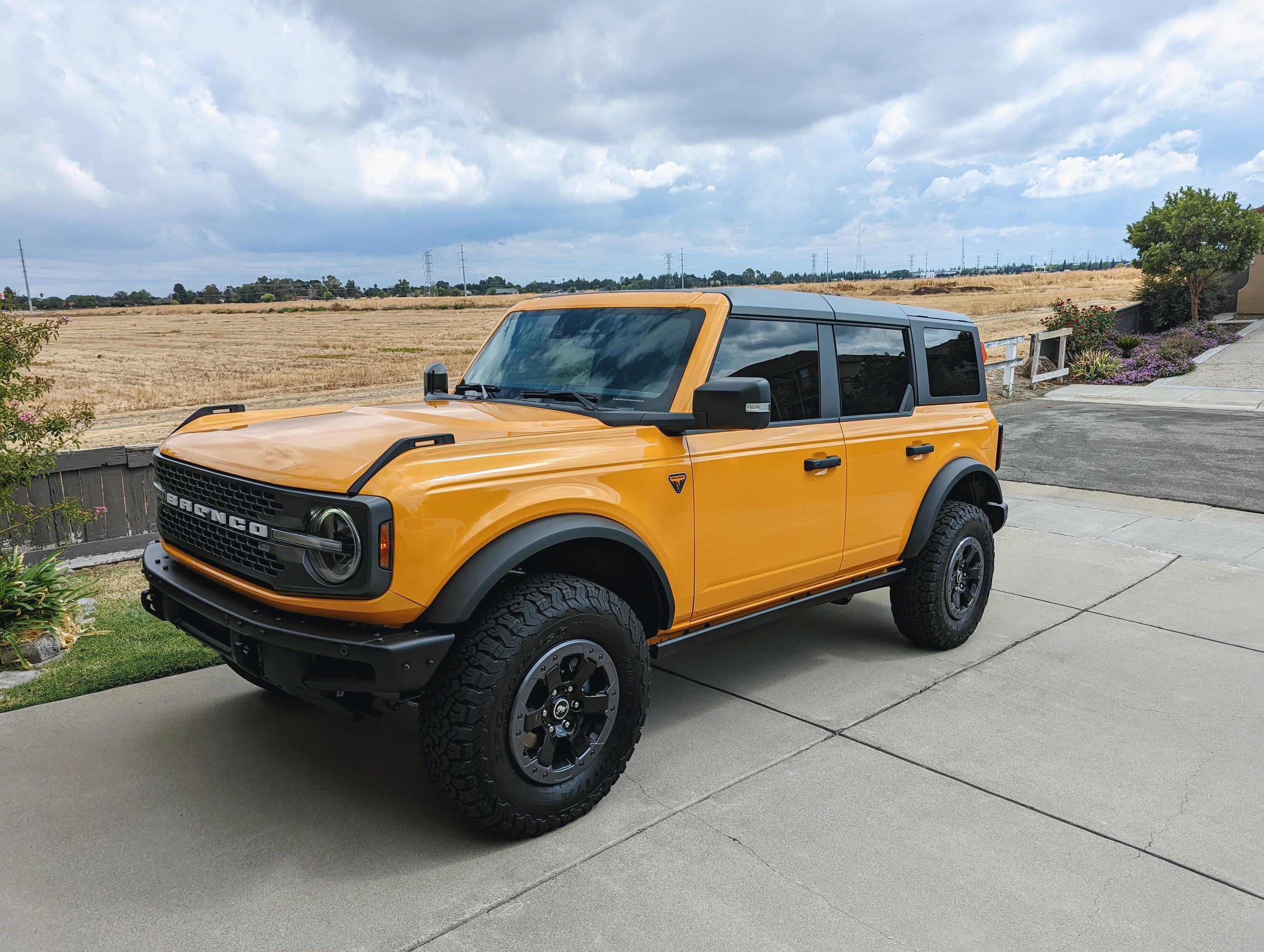

I went with a 4-door Badlands, 2.7l Auto, MGV, Lux, MIC top in Cyber Orange. I opted against Sasquatch as I preferred the KO2s over the Goodyears, and I got everything else I wanted with Badlands. I originally included the tow package, but decided to remove it in the hopes of still getting an MY22. I reserved the first week in July 2020 and picked up September 17, 2022. Purchased through Serramonte Ford, who I would happily recommend.
I live in Sacramento, normally a 2-3 hour drive from Serramonte near San Francisco. But with an eye towards a proper break-in, avoiding the constant RPM of the interstate, I took a somewhat longer route home. Headed north across the Golden Gate Bridge, then cut across Sonoma and Napa Valleys, and took a couple of smaller highways to arrive home just after dark.

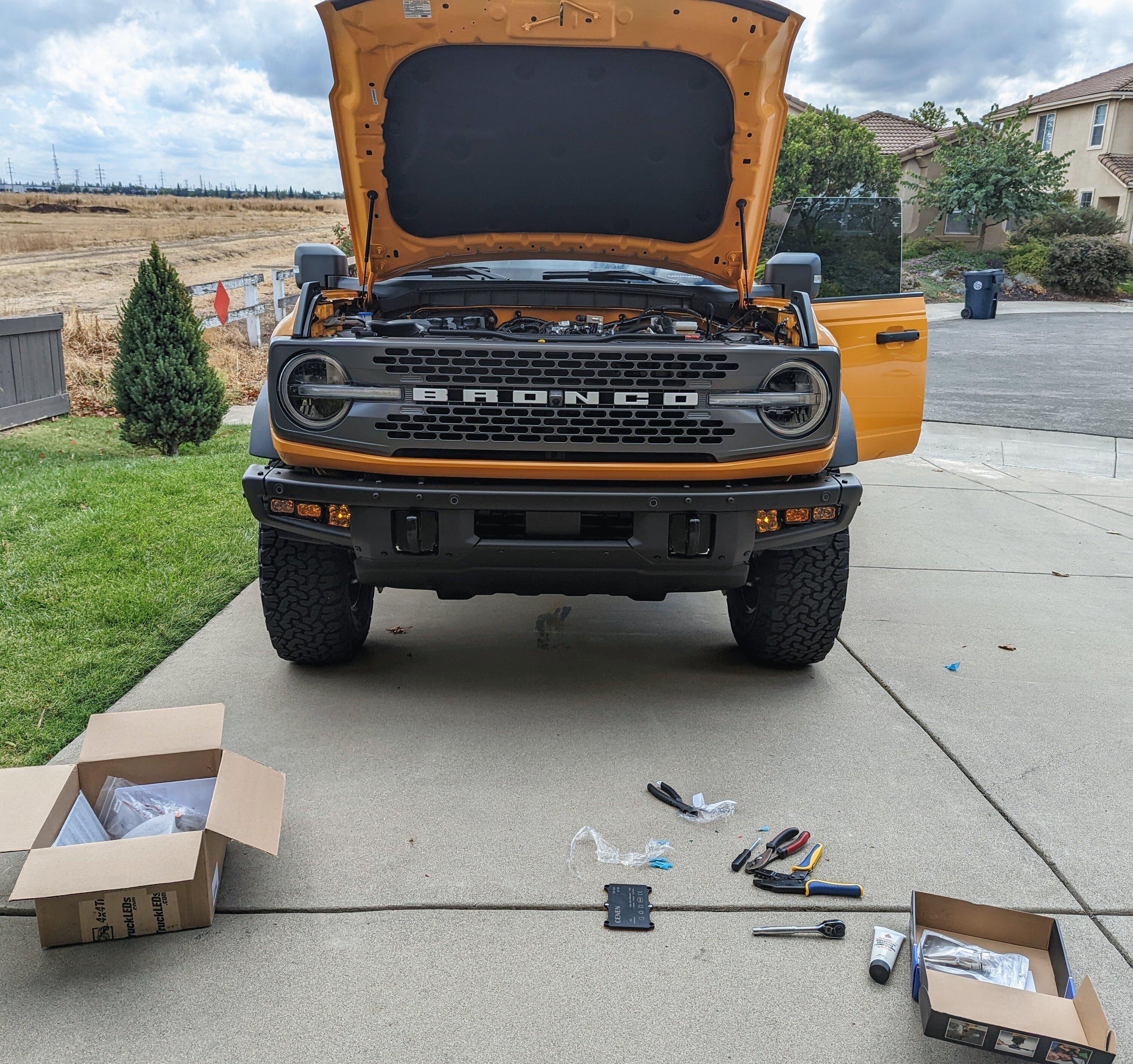

I took a week off to get the bulk of my add-ons and accessories installed. Here’s what I’ve got:

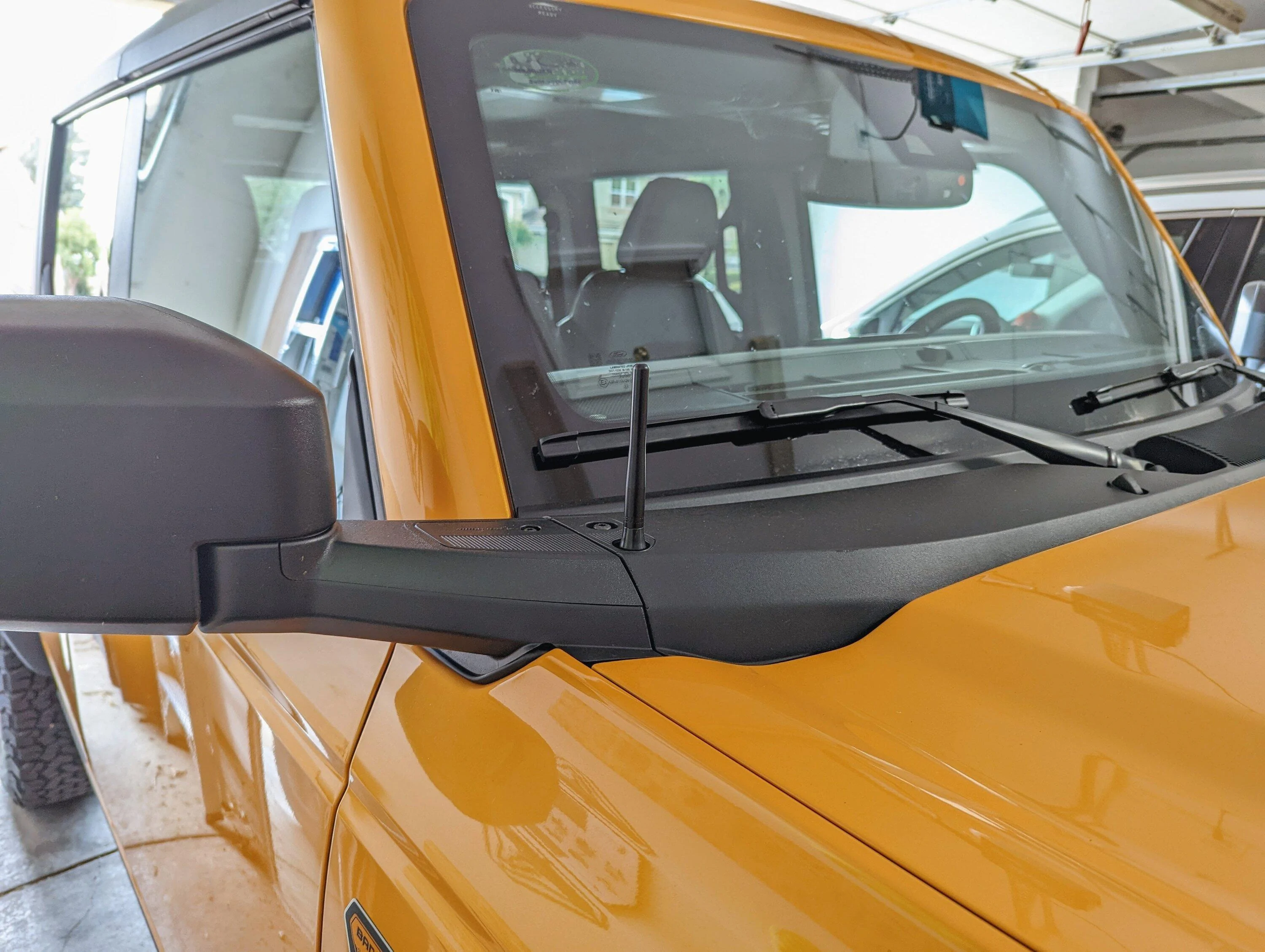

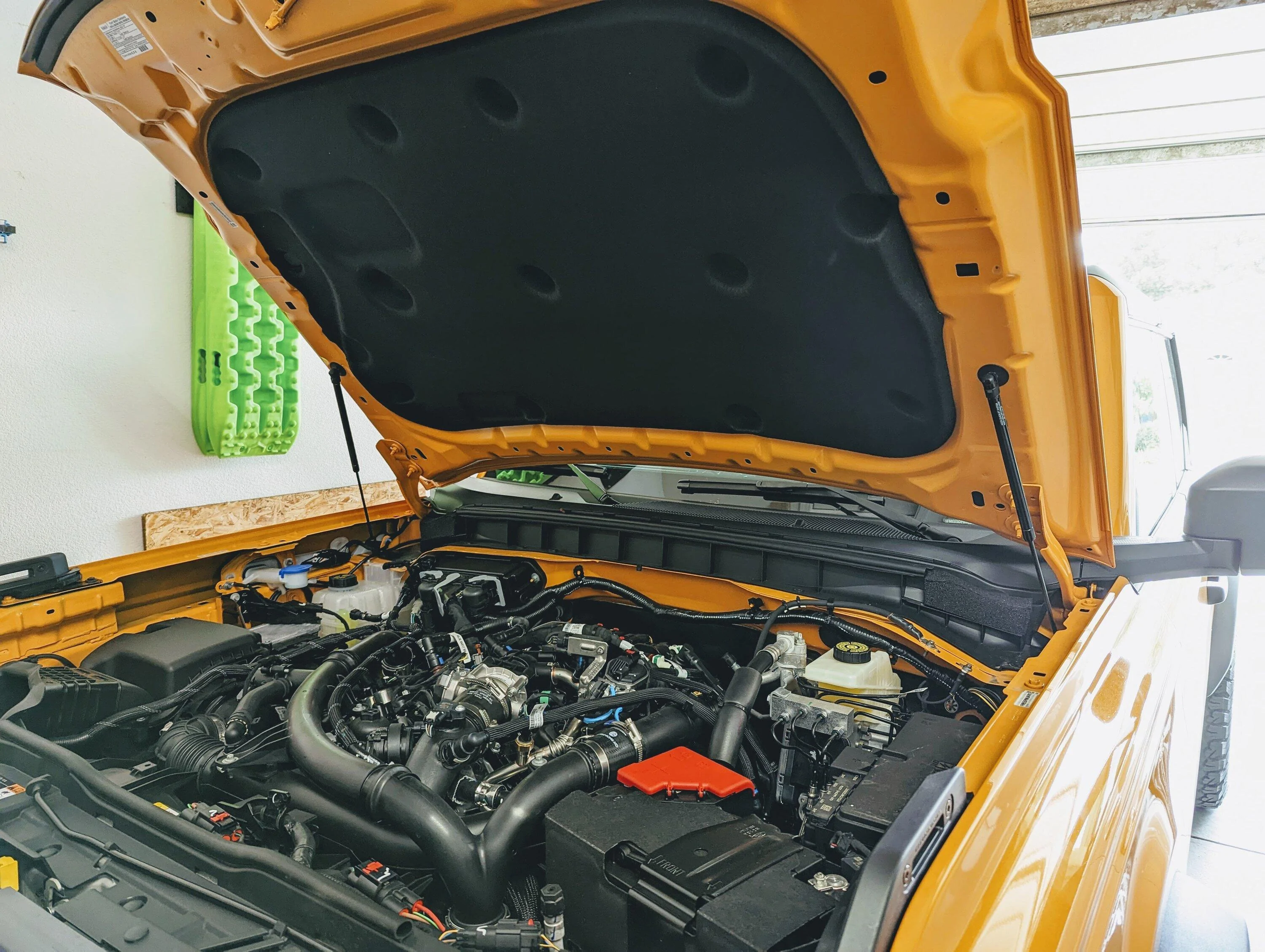

First step was the hood struts. Easy to install, work well, and provide a bit more room to work under the hood. After that, replacing the stock antenna with the stubby.
Ford Bronco Saga of the King in Yellow 20220918_HoodStruts
Ford Bronco Saga of the King in Yellow 20220918_StubbyAntenna

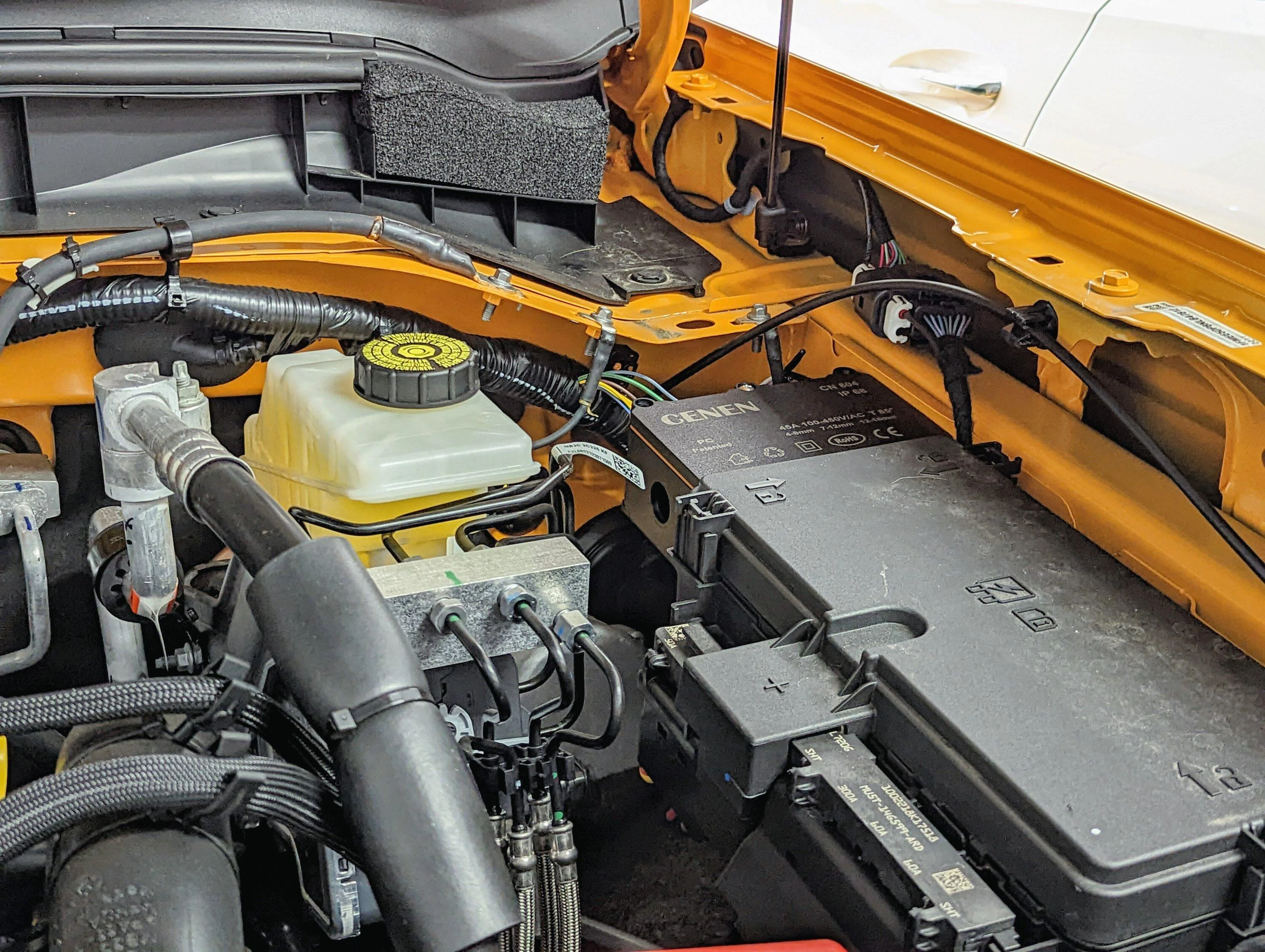

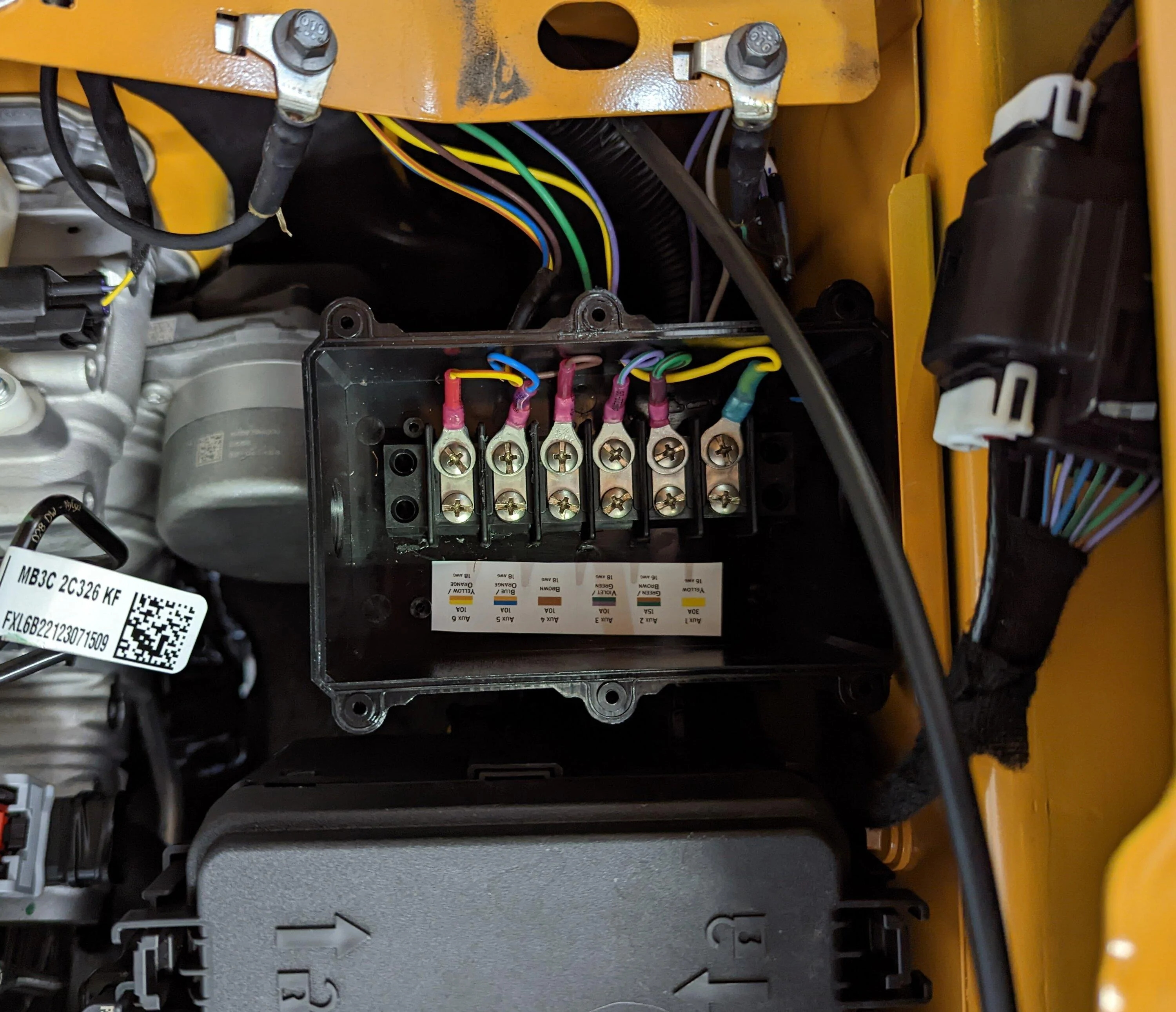

Now it was time for a bit of creativity. I have a number of accessories I plan to connect to the aux switches. But I also fully expect to decide to make changes down the road. So I assembled some bits and pieces into an underhood wiring box. Terminal block inside a moderately weather-resistant box, some terminal connectors on the aux wiring, some dielectric grease, and good to go.
Wasn’t able to mount it where I really wanted, due to how short the aux wires were, but good enough. Also installed a busbar to use as a good ground point.
Ford Bronco Saga of the King in Yellow 20220918_Wiring3
Ford Bronco Saga of the King in Yellow 20220918_Wiring5box
Edit: Here's some more info on the aux switch wiring box, for those that have asked about it or are interested in making their own.
Waterproof Junction Box (7-12mm holes) https://amz.run/67Pm
Marine Terminal Block 6 Gang https://amz.run/67Pn
Heat Shrink Wire Connectors https://amz.run/67Po
Dielectric Grease https://amz.run/67Pp
Use epoxy or adhesive tape to mount the terminal block in the box, and then 3M Automotive Adhesive Tape to secure the box inside the engine compartment. This box ends up being very lightweight, so the adhesive tape is plenty. Make sure to use dielectric grease on your connections. The box protects from the elements well, but the grease prevents any issues with moisture or corrosion. I recommend attaching the aux wires to the terminal block before securing the box, simply because the factory wires are kind of short.

Dayumn, I super super like this, really clever.
Of course now I'm gonna have to go back and potentially do the same.

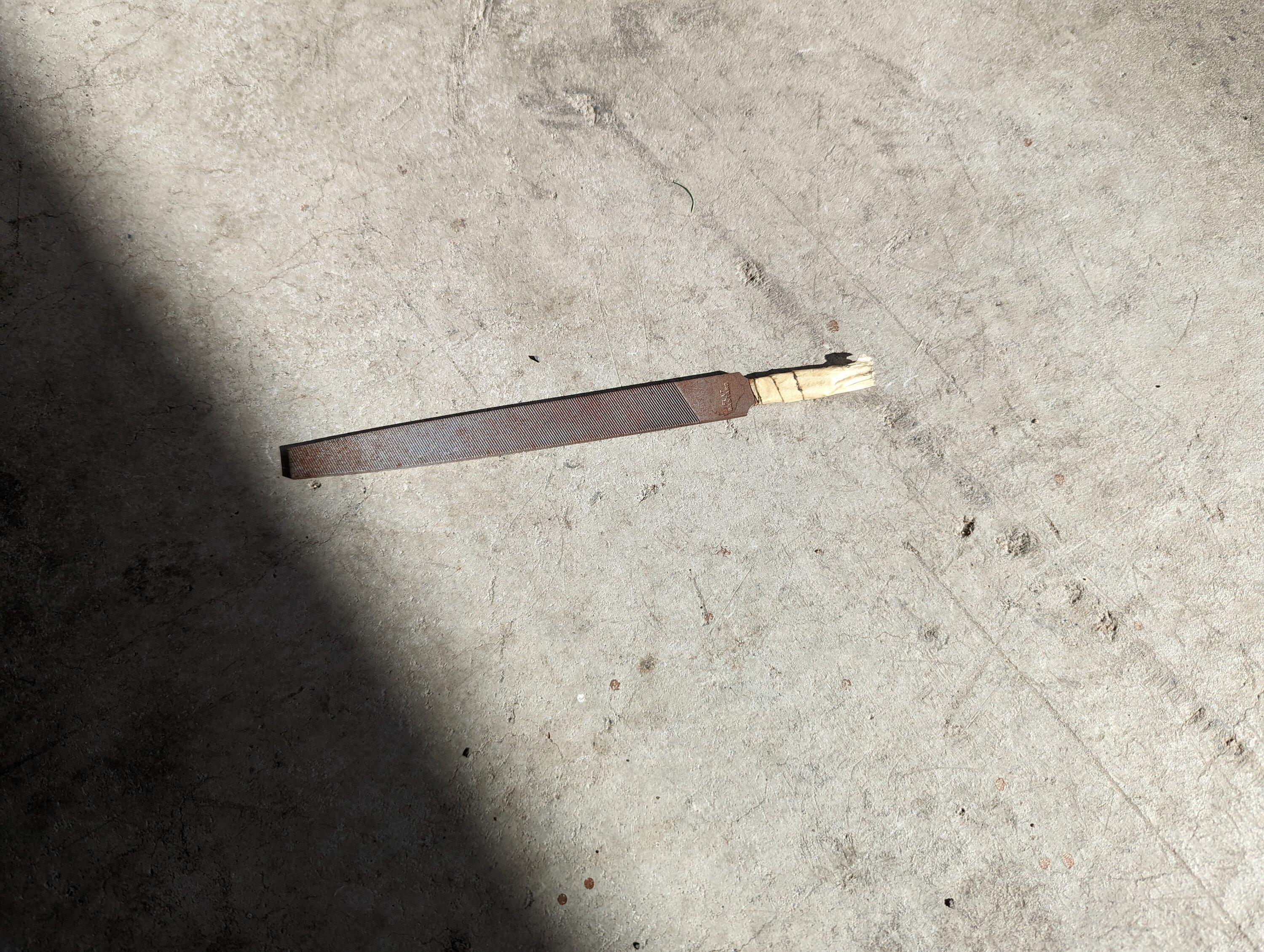

And I would be remiss if I did not mention the surprise I got when I got to the first wash. There, nestled on the cowl at the base of the windshield – was a rusty metal file. I really don’t know where it came from, but I think it must have been there when I took delivery. Fortunately, it stayed put until I came across it. I don’t want to think of what it would have done to the windshield if it had kicked up on the highway.

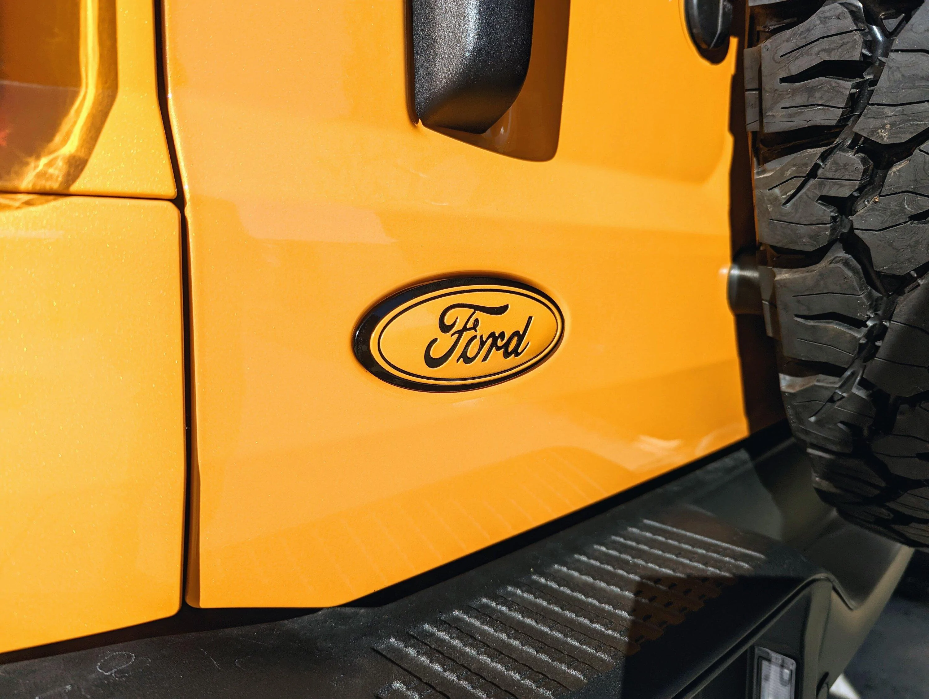

Next were the badges.

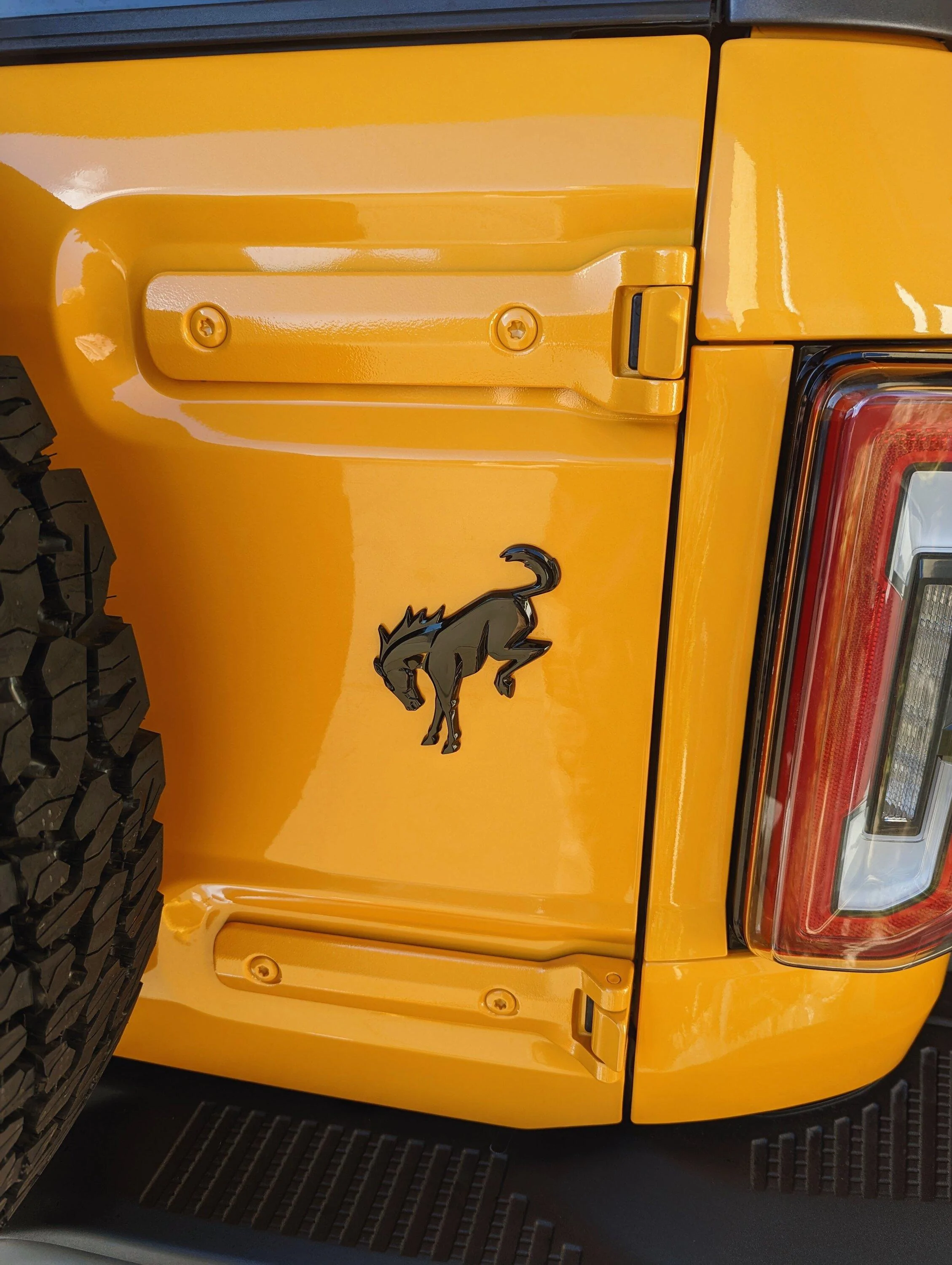

I moved the Badlands trim badges. One to the top inside of the swingate and one... to a place I will describe later.

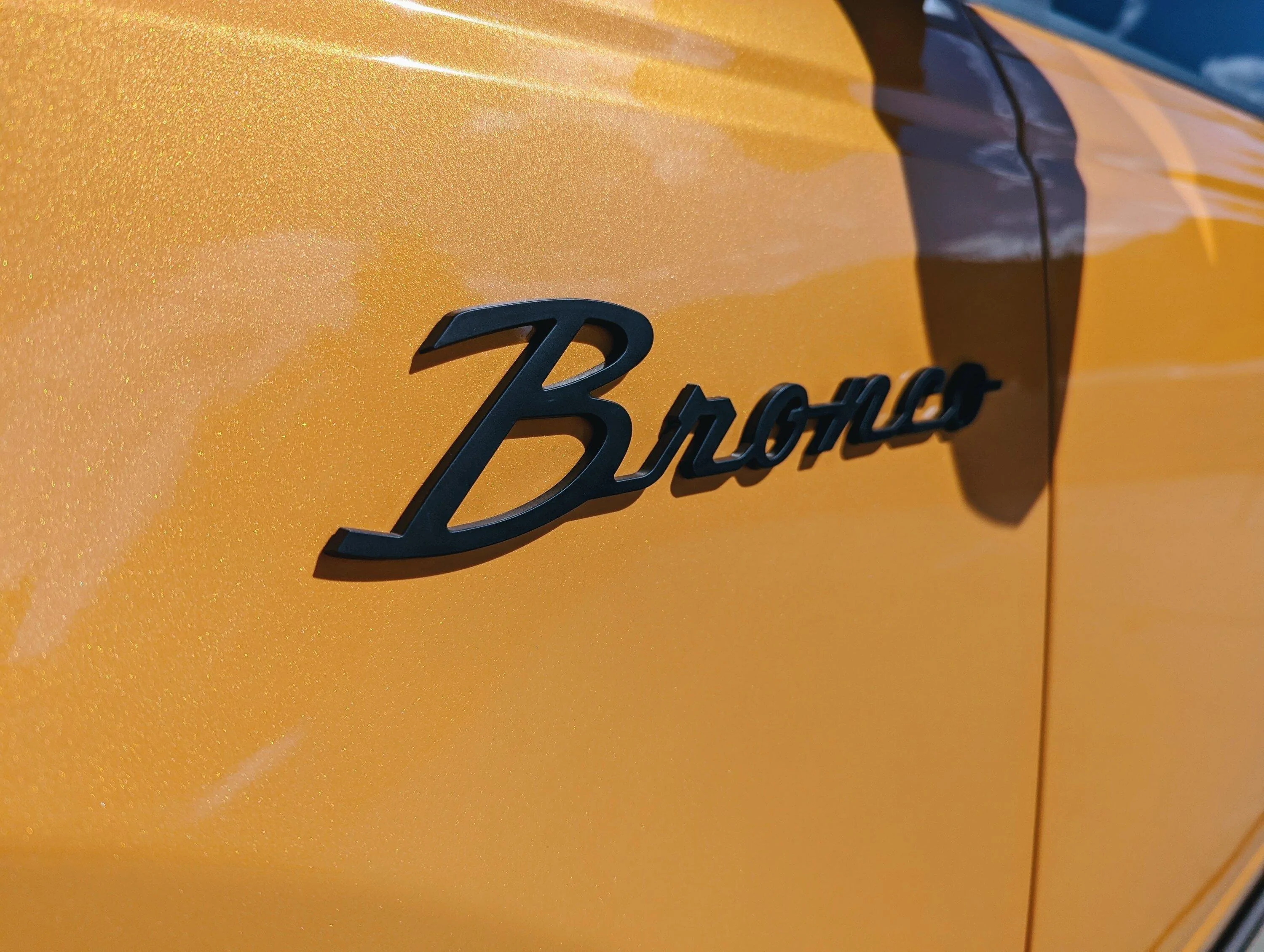

Added the Bronco script, which I fortunately got from Bronco Depot quite a while back. Swapped the chrome Bronco on the swingate for the black version. And following the examples here on the forums, I got another Ford emblem and painted it to match.
Ford Bronco Saga of the King in Yellow 20220920_BroncoScript
Ford Bronco Saga of the King in Yellow 20220921_BroncoEmblem
Ford Bronco Saga of the King in Yellow 20220920_FordEmblem
I’d bet this most likely came from the tint shop. They use a file to trim up the edges of the film after placing it on the window

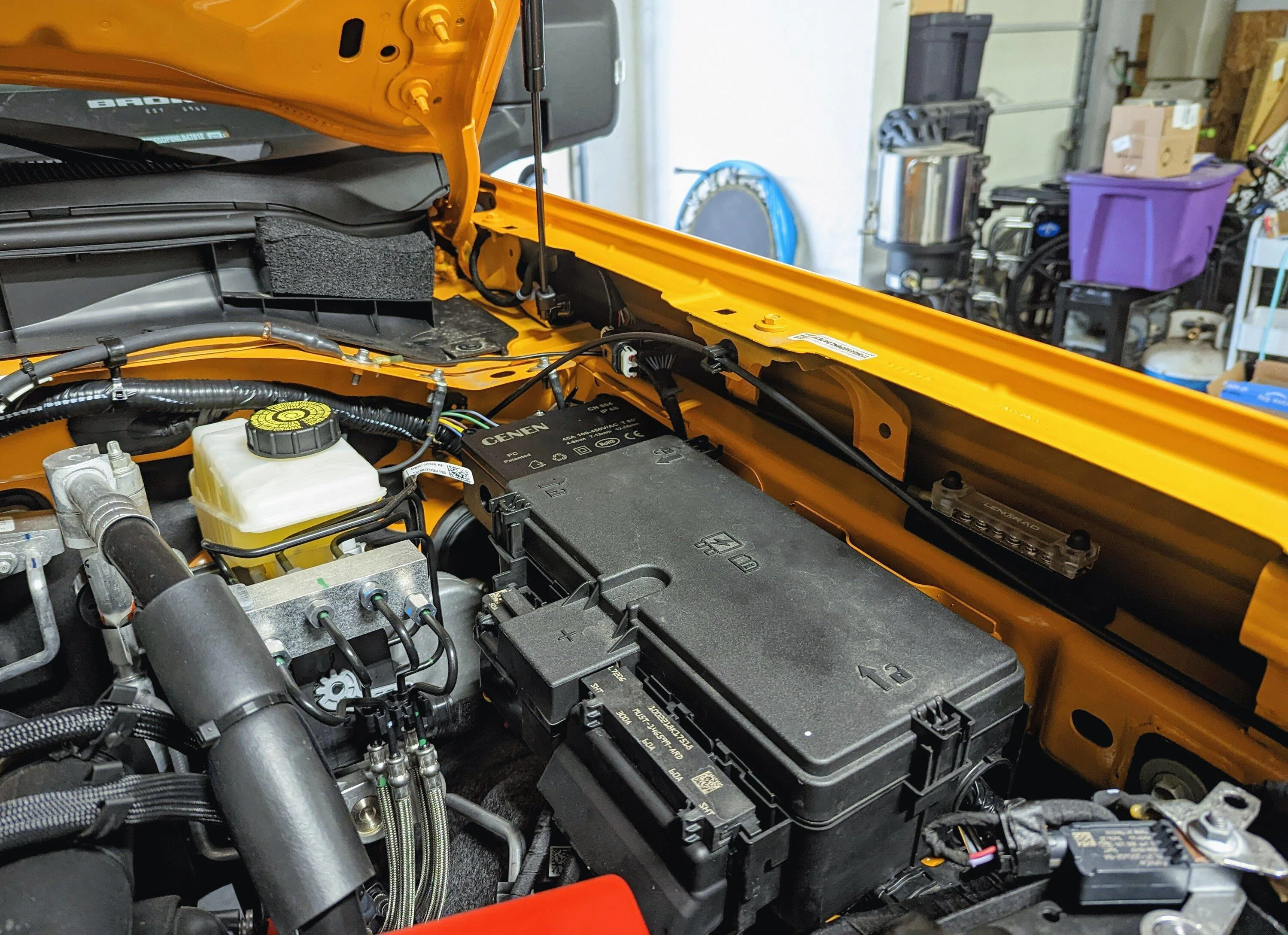

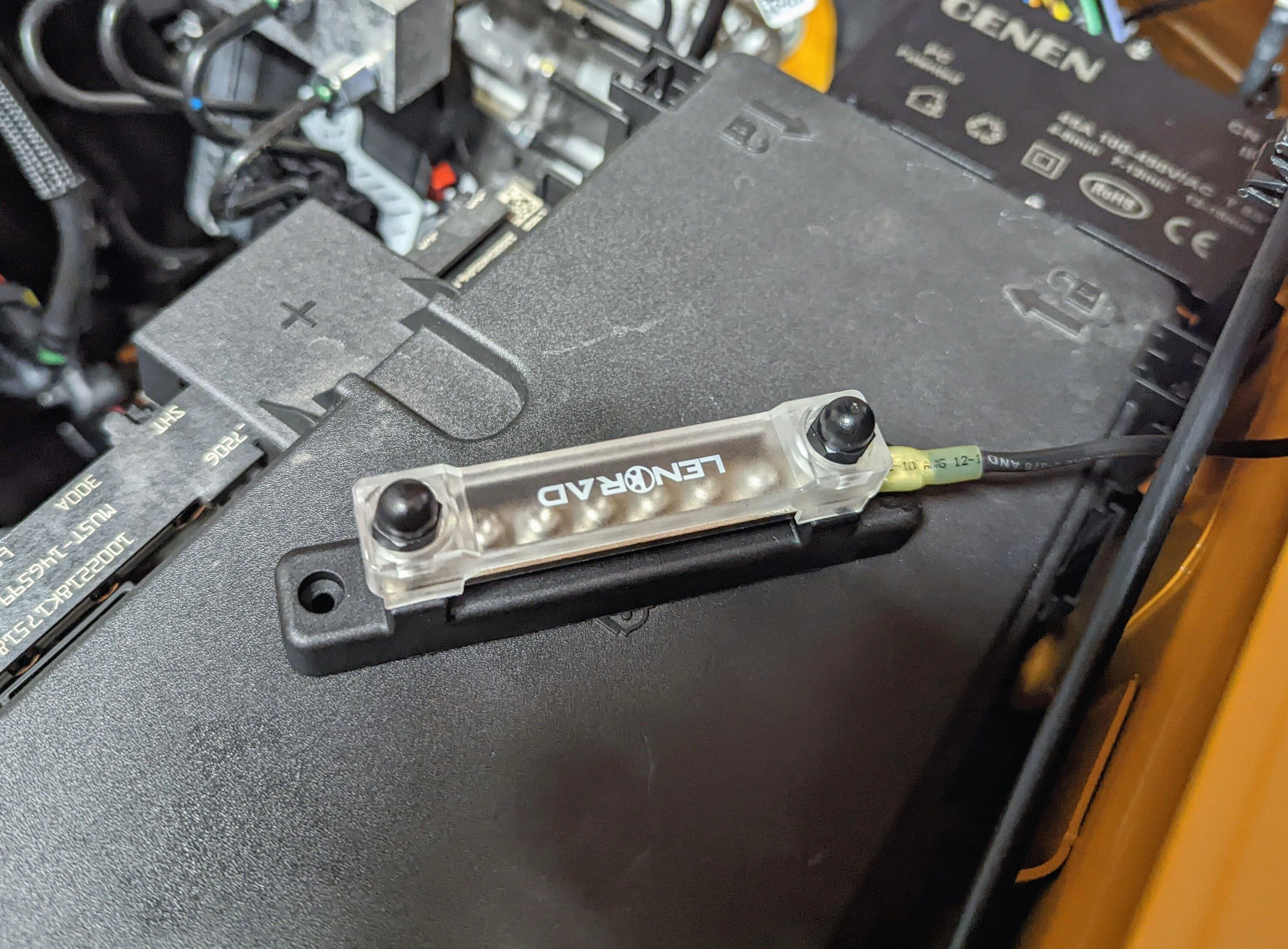

Here's a couple of shots of the grounding busbar.
Ford Bronco Saga of the King in Yellow 20220920_Wiring6busbar
Ford Bronco Saga of the King in Yellow 20220920_Wiring7busbar

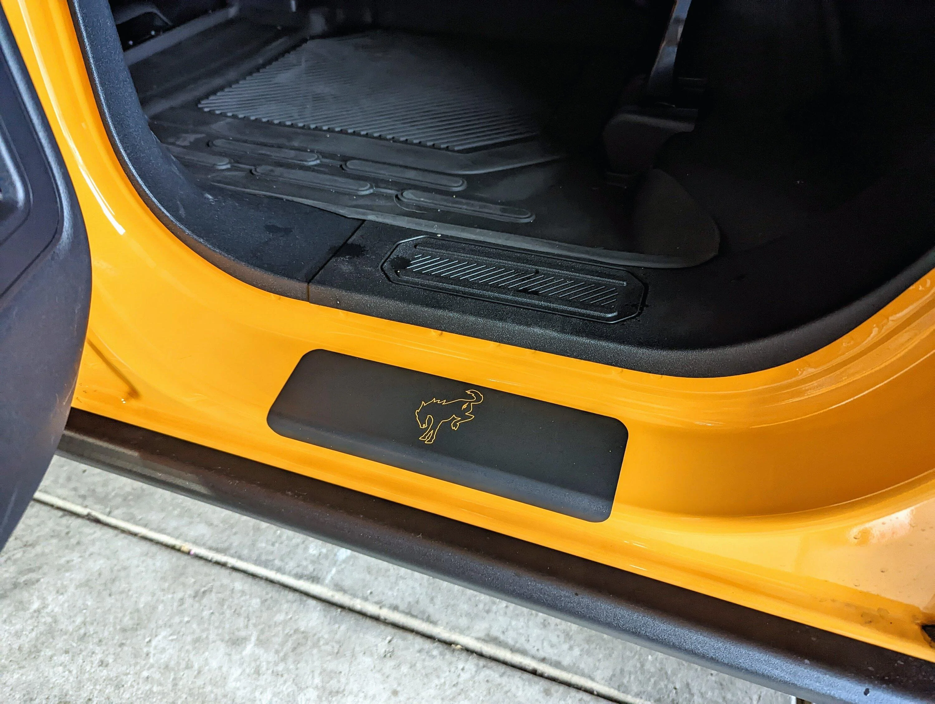

Got the sill guards installed. Installed easy, and they match the CO great.
Ford Bronco Saga of the King in Yellow 20220920_SillGuards

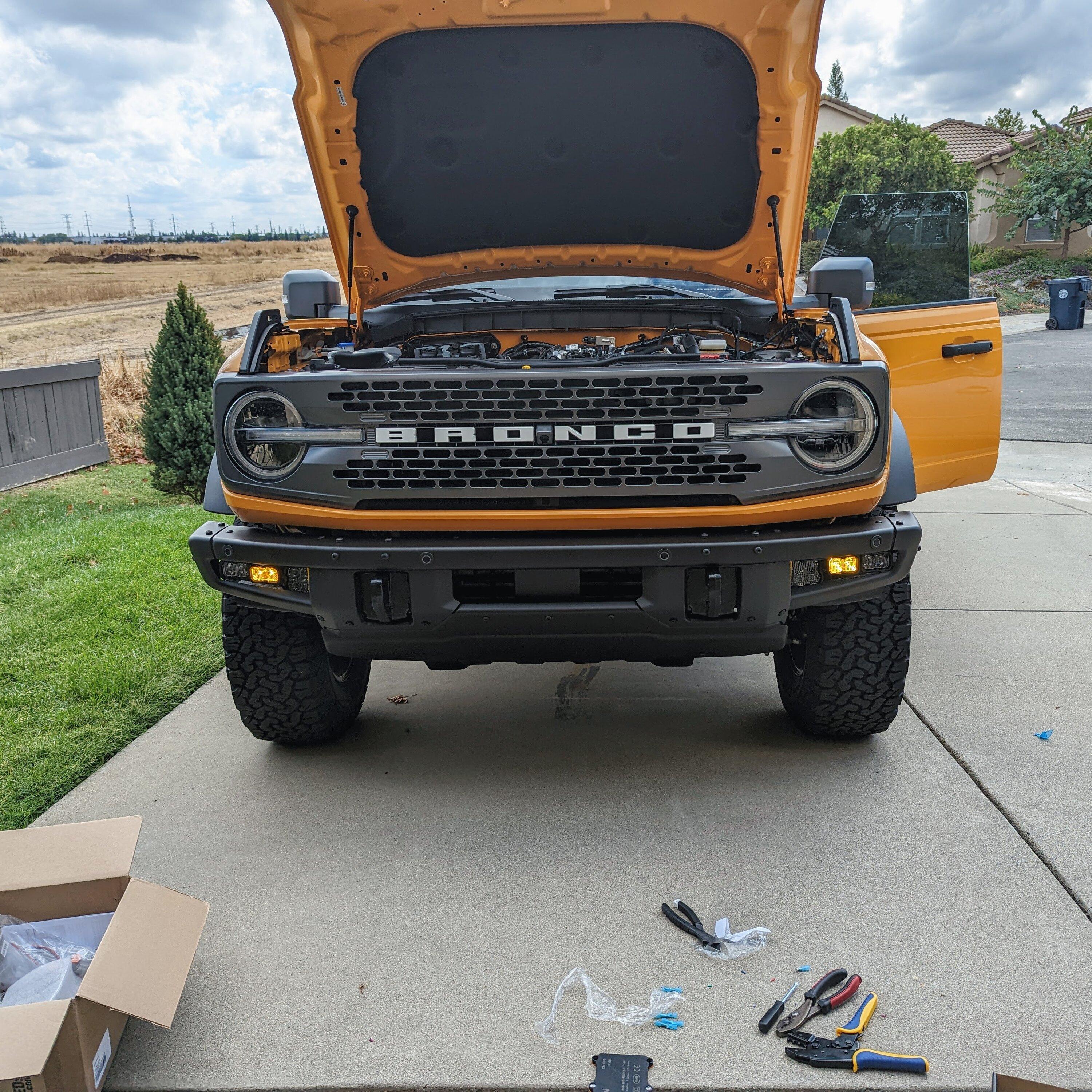

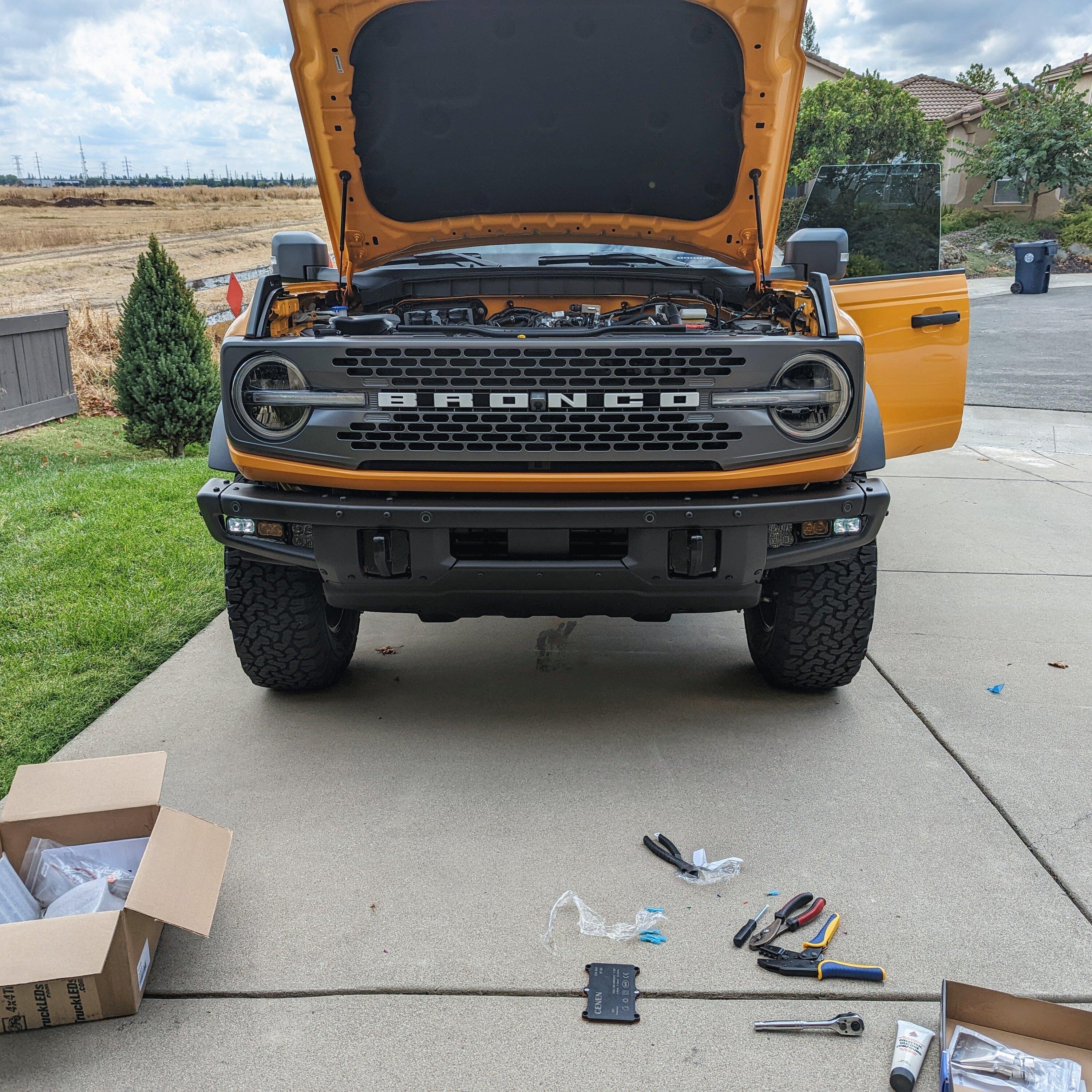

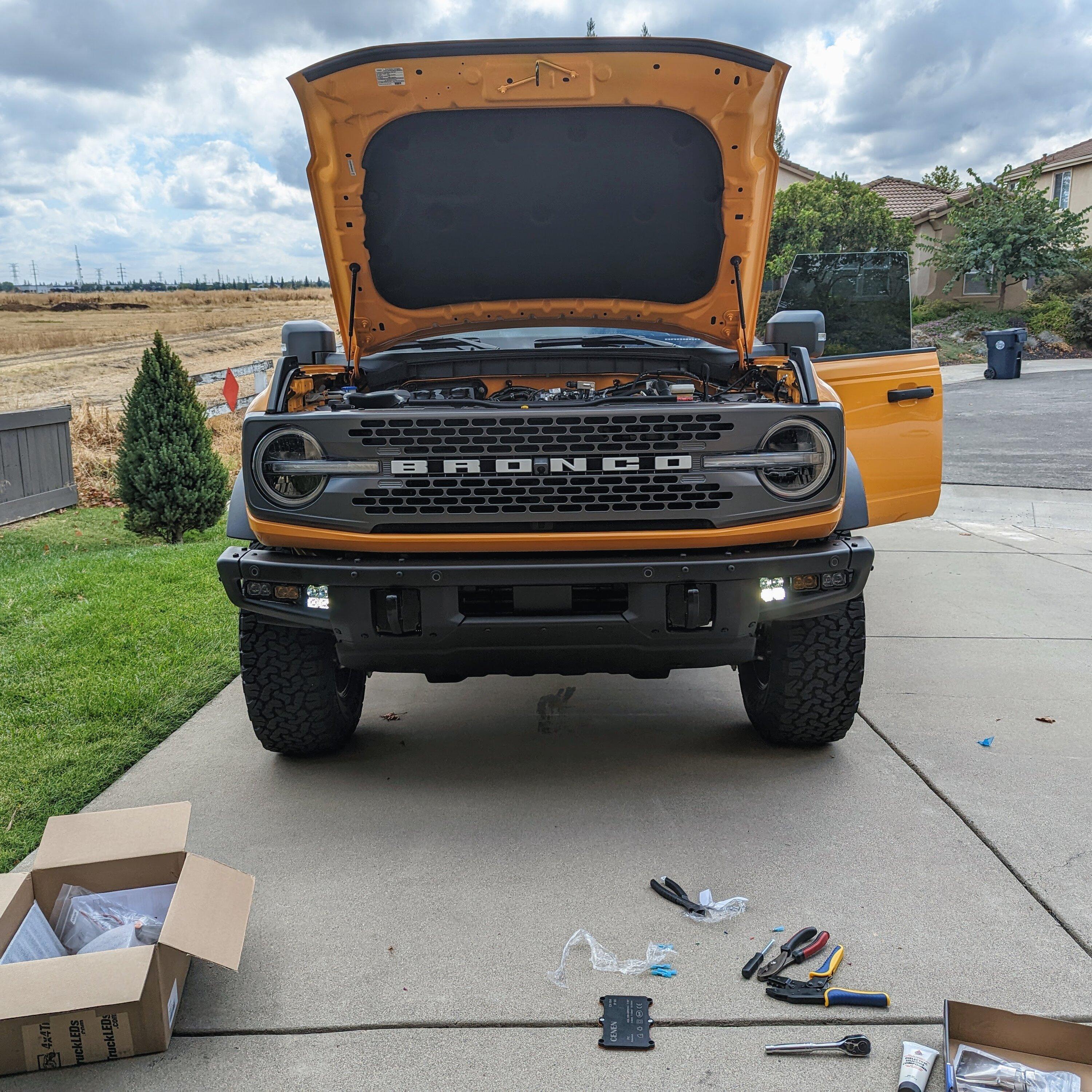

Next up comes the lights. I don't need massive banks of gargantuan lights to illuminate an airfield, but I do need some fog lights. We get some heavy fog in the Central Valley, especially near the fields between my house and the airport. I'm also hoping to take the family up into the Sierras during the winter (none of our previous vehicles could go up when chains were required), so I want some amber lights too.
I went with a kit that let me pick the lights I wanted. KR Off-Road Bracket to mount 3 pairs in the pockets of the HD Modular bumper. After seeing some real-world testing, I went with Diode Dynamics. They seemed to provide better light output than Rigid or Baja. I decided on one set of white fogs (SSC2 Sport) for routine use, a set of amber fogs (SSC2 Pro) for worse conditions, and a set of white combos (SS3 Sport). The combos came with an amber backlight, so I opted for the backlight on all 3 pairs.

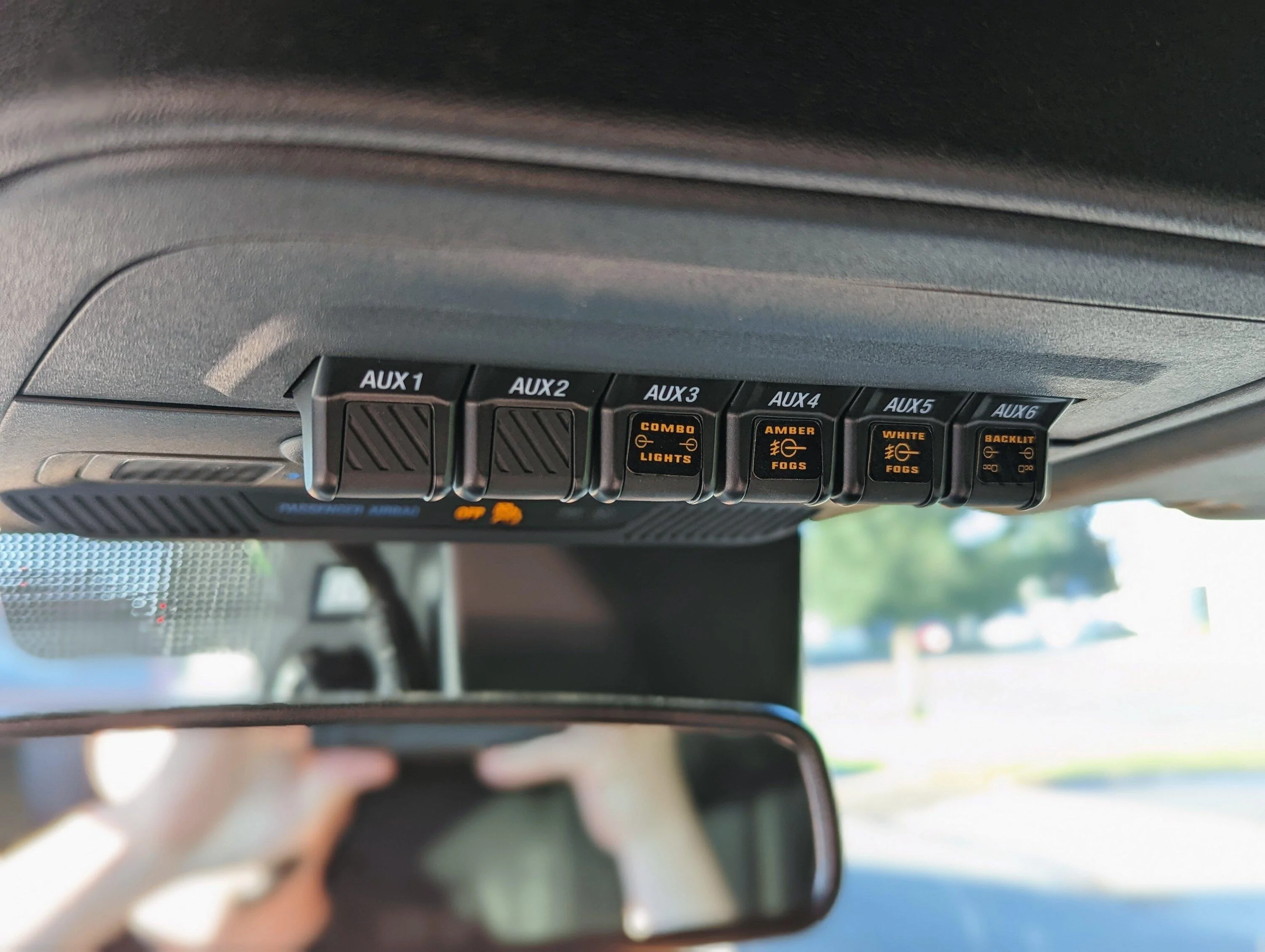

And of course, the aux switch labels:
Ford Bronco Saga of the King in Yellow 20220922_AuxLabels
Nicely done. @Natai
