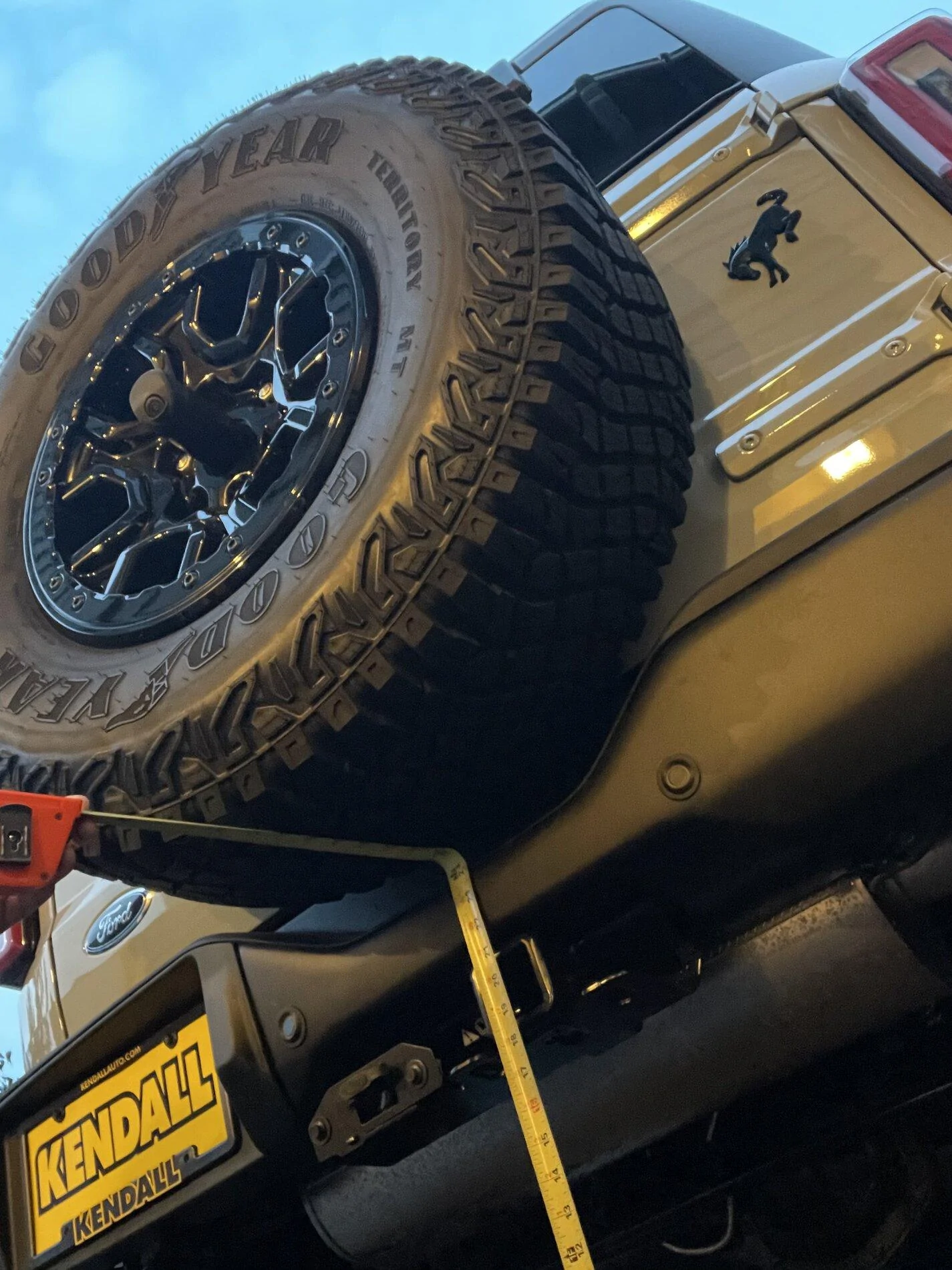

Dads_bronze_bronco
Feb 18, 2020
4,170
7,457
08 JKUR / x_x 00 TJ x_x
Non-Squatch badlands (just add 1.1ā€):
Ford Bronco Sasquatch bumper height for overland trailer 4F06CA1A-05D9-47AE-AC94-8FB798B91B8B

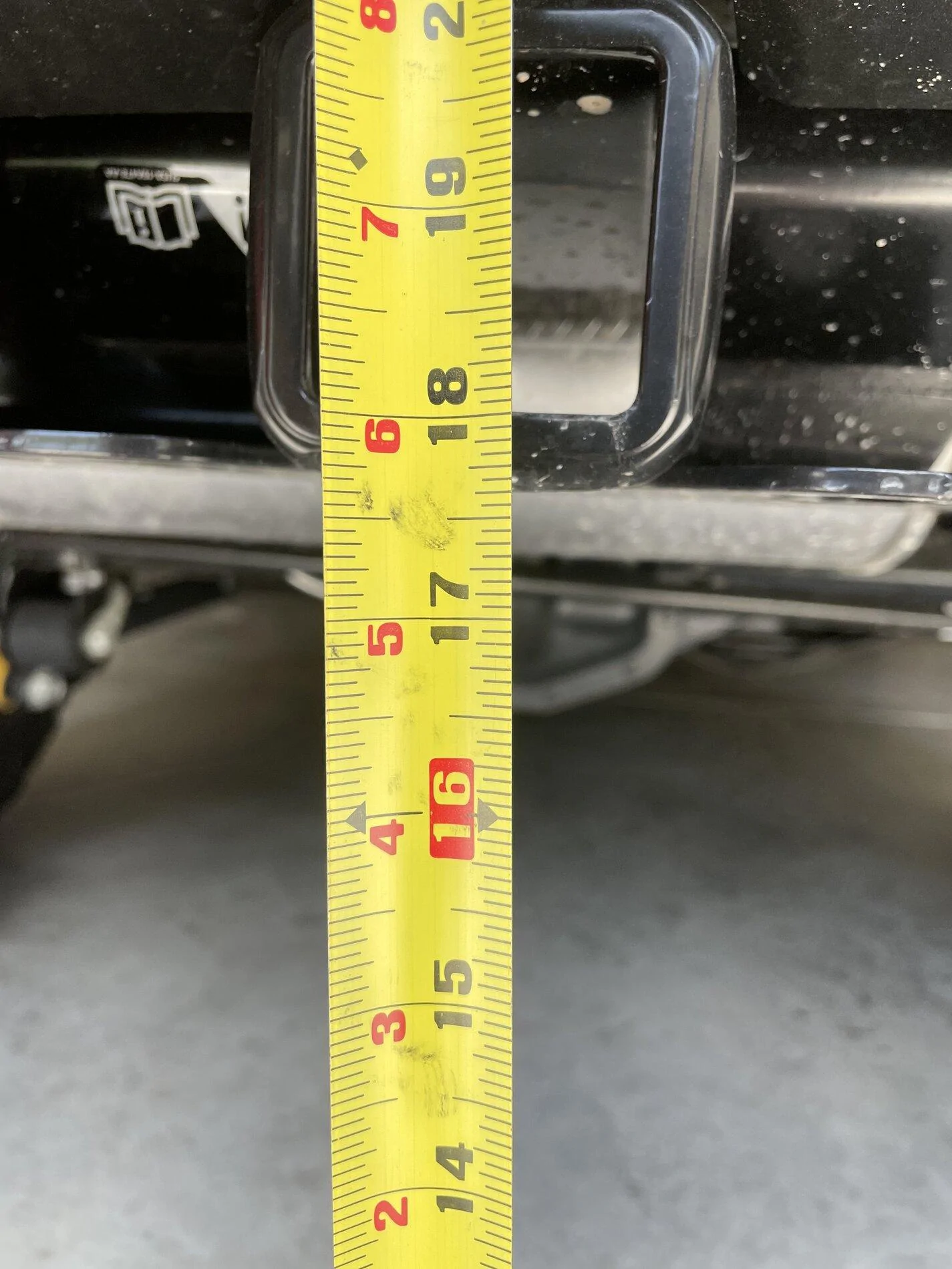

Thank you sir, looks like with Sasquatch it should come in at about 19 1/8ā€ at bottom of the entry, give or take a hair. Keeps me pretty close to a level tongue. Much appreciated!
Keep in mind the rear suspension will probably drop an inch with the full 350lb tongue weight. Also this is a soft top Badlands mannequin. I know the Bronco MIC top is supposed to be lighter, and the soft top would be heavier than my JKUR, but for example, my JK drops half an inch when I put the hardtop on.
So your mileage may differ ā€¦ assuming your trailer is 2000lbs loaded, and youā€™re loading gear in the back of the Bronco, Iā€™d figure on 18-1/2ā€.

My co worker and I are starting an overland trailer build this winter, I was curious if any stock Sasquatch owners have measured or would be willing to measure the height from the ground to the bottom of the hitch. Would help immensely in getting my tongue height set for the trailer. TIA.
20ā€ dead center on Sasquatch
