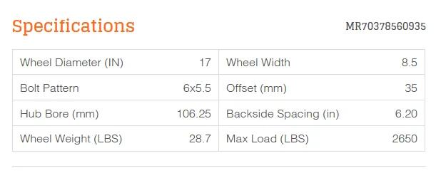

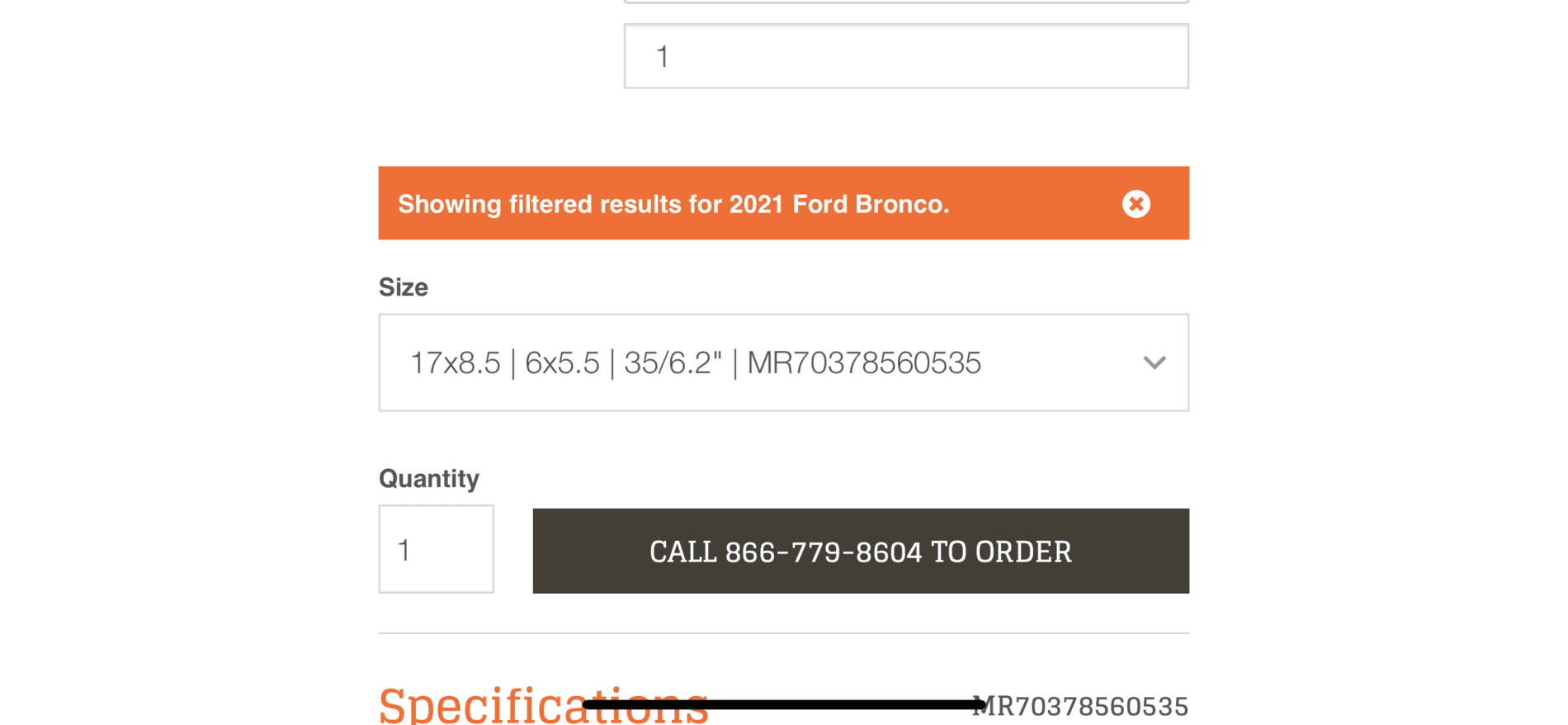

Method has there 703 in a 17x8.5 with +35 offset, thats pretty darn close to OE Squatch wheel
Jordan, I can't seem to find the 703 in that size with that offset? I am looking on Method's site, where did you find it?
JBowles
Jordan
May 19, 2021
249
861
Ozark, MO
Ram 2500
For what ever reason is only on the Black and Bronze 703s and not the titanium ones
Ok, that would be the problem then, I was looking at the titanium! Thanks. Edit: I don't understand why they would offer that offset in black and bronze and not titanium. Doesn't make a damn bit of sense!

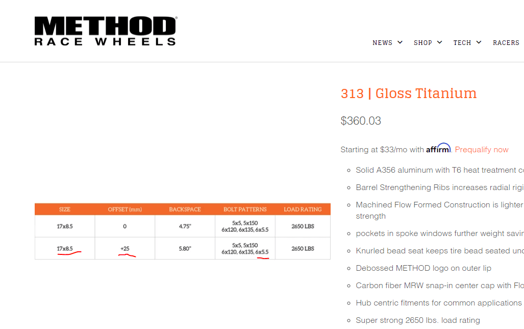

Two others I've found, not quite the same offset (+25mm), but close:
Icon Vector 6 (~$245, 30 lbs)
Method 313 (~$385, 25 lbs)
Curiously the Method part number does not appear on their website, although it is all over the retailers and even part of their pictures on their own page:
Ford Bronco Sasquatch fitment replacement wheels 1626107126933
ETA: The Icons are spot on with the factory center bore diameter at 93.1mm, the Methods are a little bigger at 106.25mm
