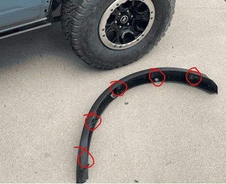

I finally got my bronco last night. I live on a 2000 ft gravel driveway so mudflaps are a must. I got these at advance auto parts for 12.99. I shot 2 screws thru the raised part of the fender well to attach them. I wedged the bottom onto a contour of the wheel well to hold it in place. I plan on upgrading once a reasonably priced (not $439) is available. I also plan on swapping out the silver screws for black. For $12.99 they work well.
UPDATE- after 3300 miles I had 4 chips on the right, 8 on the left. I removed the 12.99 flaps and installed the $23 larger flaps from Advance for more coverage. They screwed on the same way and are holding well just like the first pair.

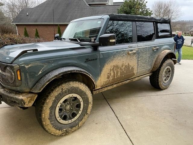

PS, did you guys know the fender flares have a hollow channel that runs the length of it with several holes? Great place for rocks and mud to buildup. They do pop off easily to wash it out, but until you do that you don't realize how much has filled that channel.
