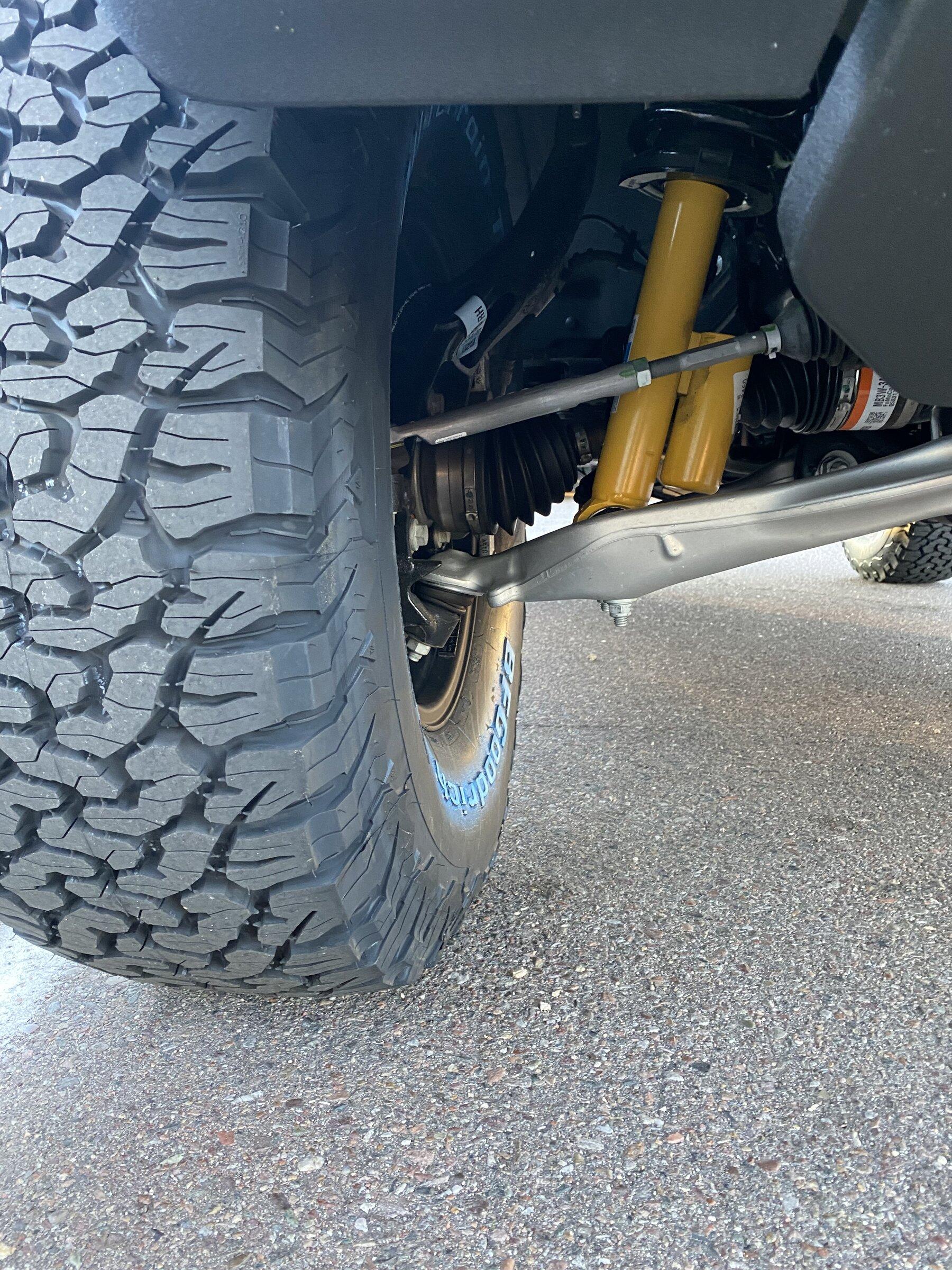

How's the ride with that perch collar?
Also, do you have any shots of the CV angles?
3 days in and the ride quality is still great and the MPG has also Stayed the same at 18.1 off driving it for 250 miles the same way i did before!

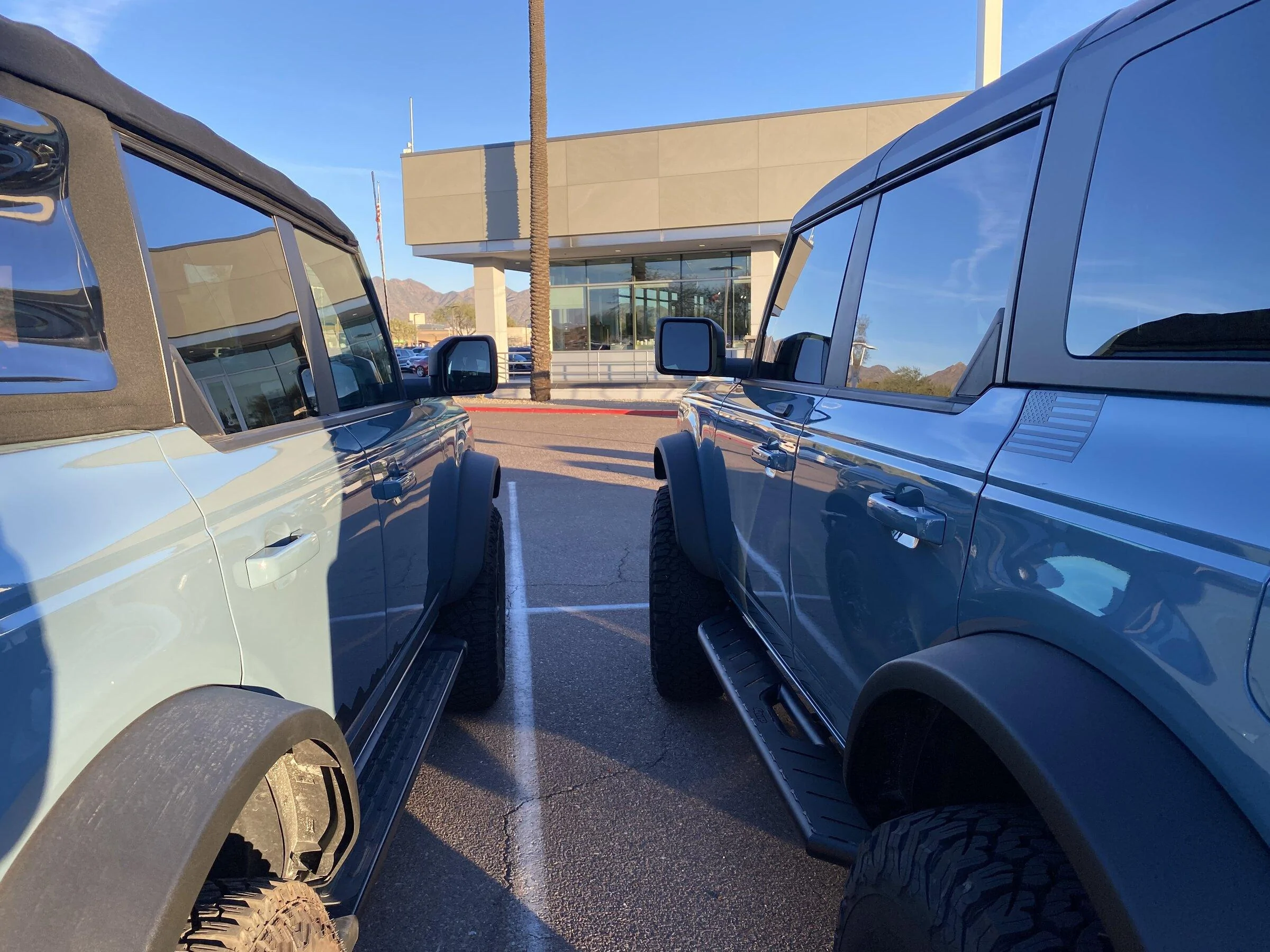

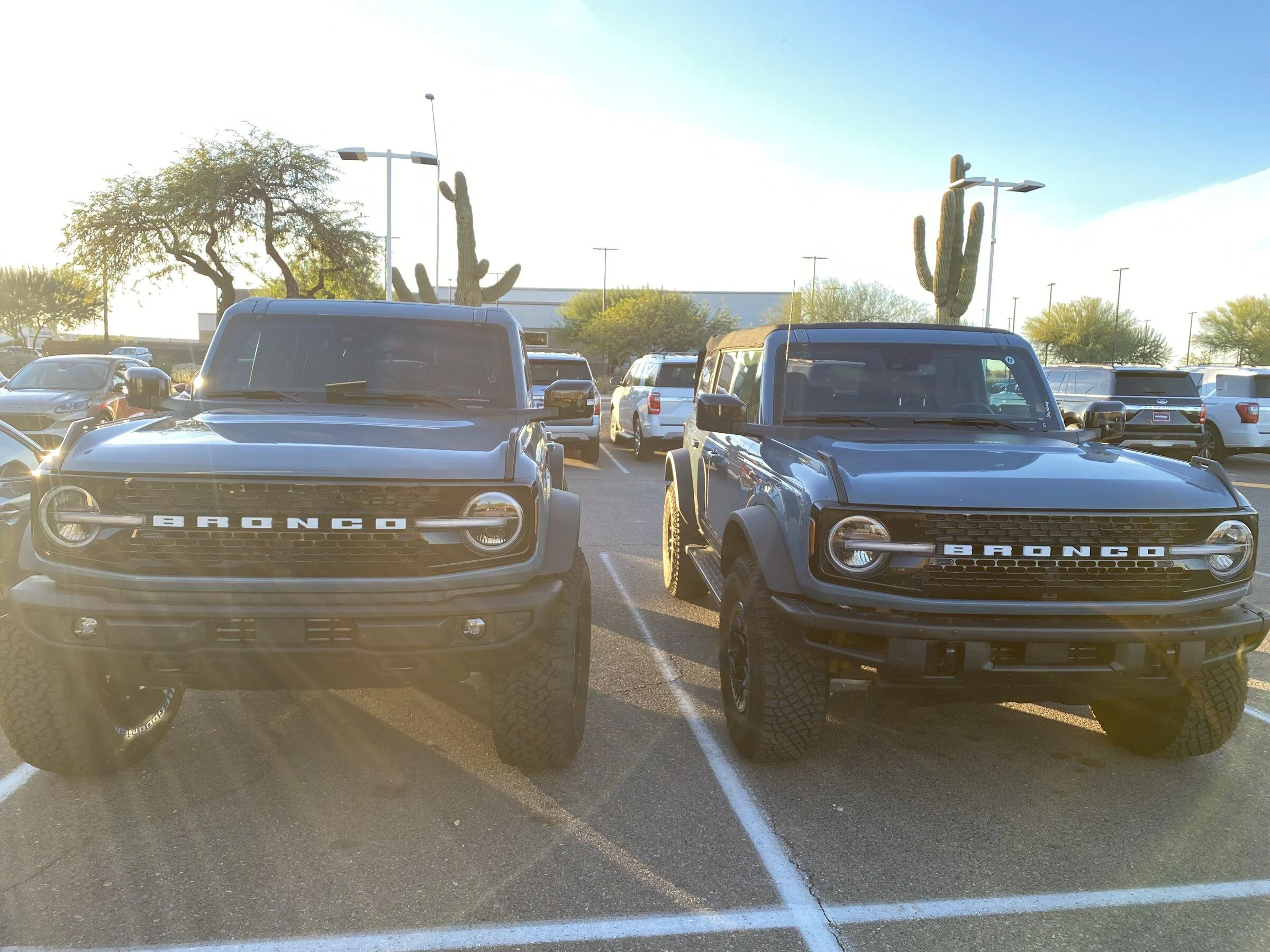

I'm curious what the total vehicle height is with that setup?
Rpg quotes 2.25 front and 1.25 on back then going from 35s to 37s I would say it’s probably 3-3.5 maybe 4 inches higher
currently parked to a stock wildtrak
