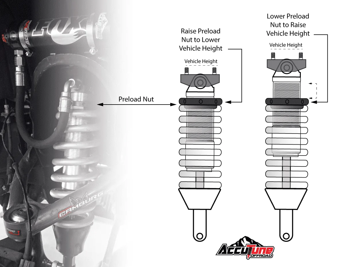

You don't need taller or stiffer springs to increase ride height with coilovers, you just need to adjust the pre-load. Reference: Every adjustable coilover on the market. The purpose of stiffer springs is at least partially to reduce body roll created by raising the vehicle's CG.
Good point. If the spring "bottoming out" is the compression limit, then you're also giving up travel to gain some height with this approach. Correct?

The spring is the same height. As long as you're not overextending the shocks, travel should not be effected. Adjustable coilovers have recommended ranges, if you want to go higher, changing the whole setup (stiffer springs and longer travel shocks) is best.

That diagram doesn't make sense to me. If I've added pre-load the the right spring then at ride height it should be compressed more than the one on the left. The right spring "sees" more weight. The pre-load plus the weight of the car....
I admit it could be just me getting confused... help me out :)

Preload does not add to the effective weight on the spring at load, it just makes sure the spring is never fully uncompressed. In other words, if your vehicle is 4,000lb, the suspension is seeing 4,000lb of pressure whether the preload is 1" or 3". The diagram is as if the vehicle is already sitting on the suspension.

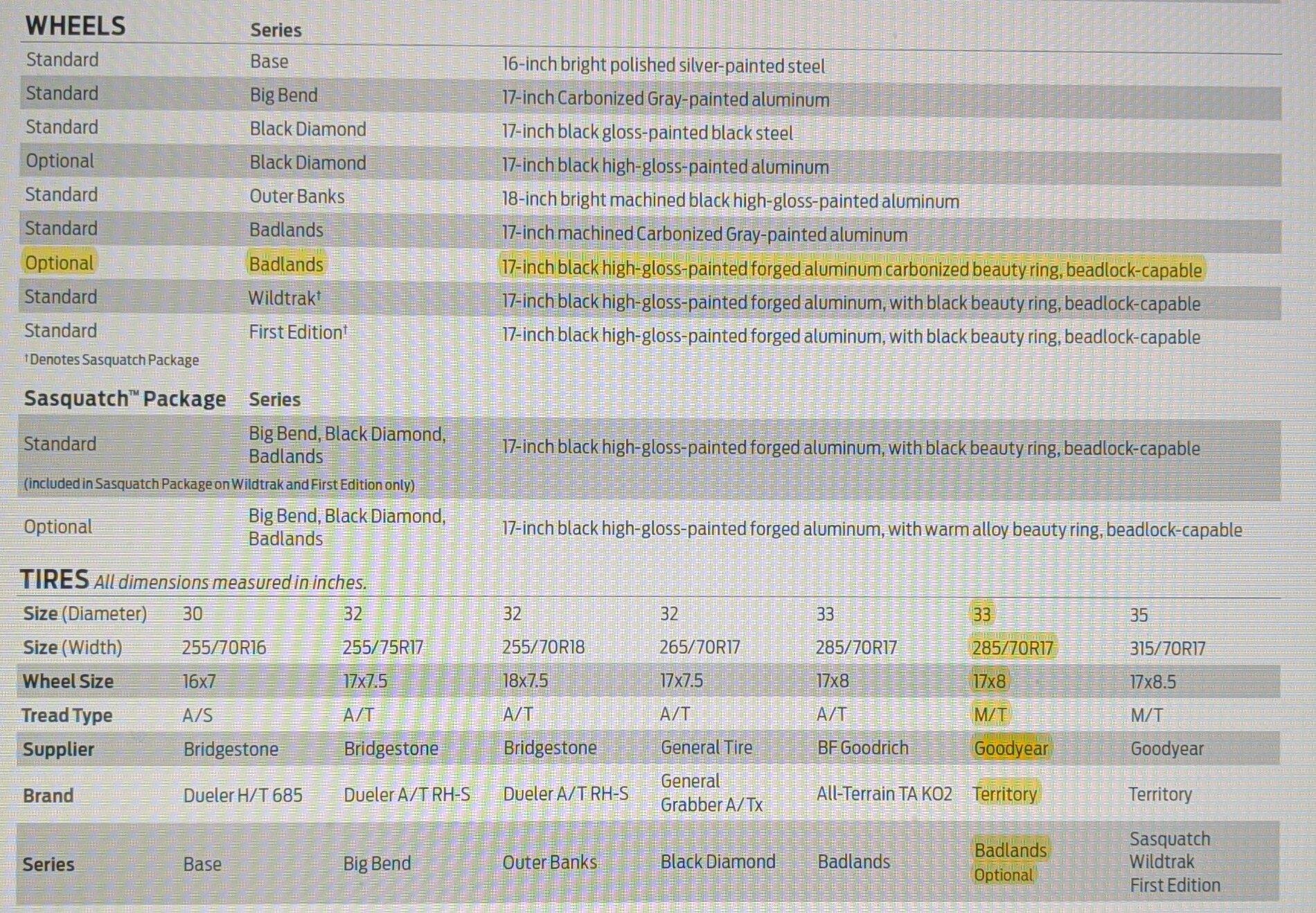

Oh that kind of stinks - would be nice to have an option.
Good to know, I was under the impression you had to go Sasquatch since the rims are wider (aren't they) - so more targeted to 12.5" wide tires.
No worries. I think what we really need is a table that shows all the actual known (believed to be known) options in one spot. I agree that the value of Sasquatch becomes a little less clear with the Manual trans (no gearing change, no front digs).
