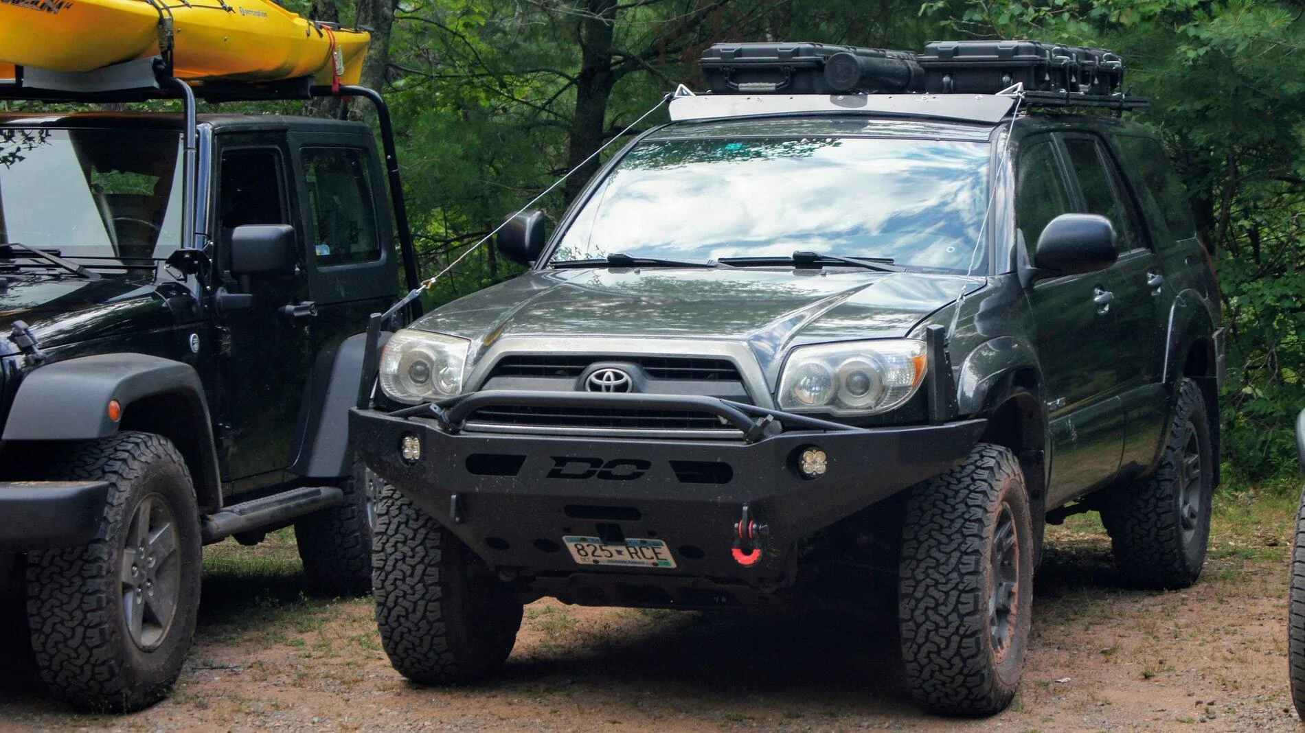

Hi friend, thought some context by comparison could be helpful, considering your described use case. It seems like you're asking the question whether the upgraded specs (35s vs 33s, locker vs no locker, more travel vs slightly less travel) are worth it/good to have/needed for a potential overlanding hobby. In my experience, it all comes down to the kind of terrain you expect you'll be traversing.
In my case, with my '08 4Runner over the past 5 years I've run a handful of light trails in CO & WY, but otherwise mostly upper Midwest MN, WI. For several of those years I was running 31" Destination A/T tires (slightly better traction than all seasons?), 2" lift, and have since upgraded to 32" KO2s. I have center diff lock and ATRAC, no rear locker. Even the base new Bronco will meet or beat most off-road geometry/specs on my 4Runner, so I'd think unless you're specifically seeking out challenging overlanding heavy on the technical terrain/off-roading, you'll be very capable to overland a huge amount of trails without 35s/locker. I could've run 95%+ of those trail miles in stock form - have gotten stuck only a handful of times and usually only when I voluntarily tested the limits (take the harder rut/hole/whatever vs drive around it) because I had other vehicles around to help recover.
That experience is partly because you have to work to find much of anything for technical trails here in the flat Midwest, and because I enjoy just driving trails, getting out in the wilderness, seeing new places, and camping - not as much into testing limits on technical trails/off-roading (though that's fun, it's not primary, and so far has always been optional - where I could just drive around if I wanted to).
Like you, I also consider trail capability alongside on-road manners, power, mileage, etc. And since about 99.6% of my driving is on-road, I opted for 32s over 33s, kept lift at 2"vs 3", etc.
Bottom line, the Bronc looks like it'll be highly capable even in base form, and while 35s/locker/lift will make medium difficulty terrain even easier to traverse - and some extreme terrain passable vs not - unless you want to seek out those extreme trails (even if you live in a place where they're plentiful:), there's an awful lot of medium-difficulty or less trail to explore where you'll never need those 35s or locker.
My 2 cents, hope something in it is helpful to you ::)
The enthusiastic max-upgrade-all-the-things perspective is easy to come by because it's more fun and exciting to talk about! And the vehicles with huge lifts and tires are the ones that grab attention on the road or on shows. Seems like there are fewer popular voices/channels out there talking about the advantages and benefits of mild upgrades for a lot of use cases. ::)

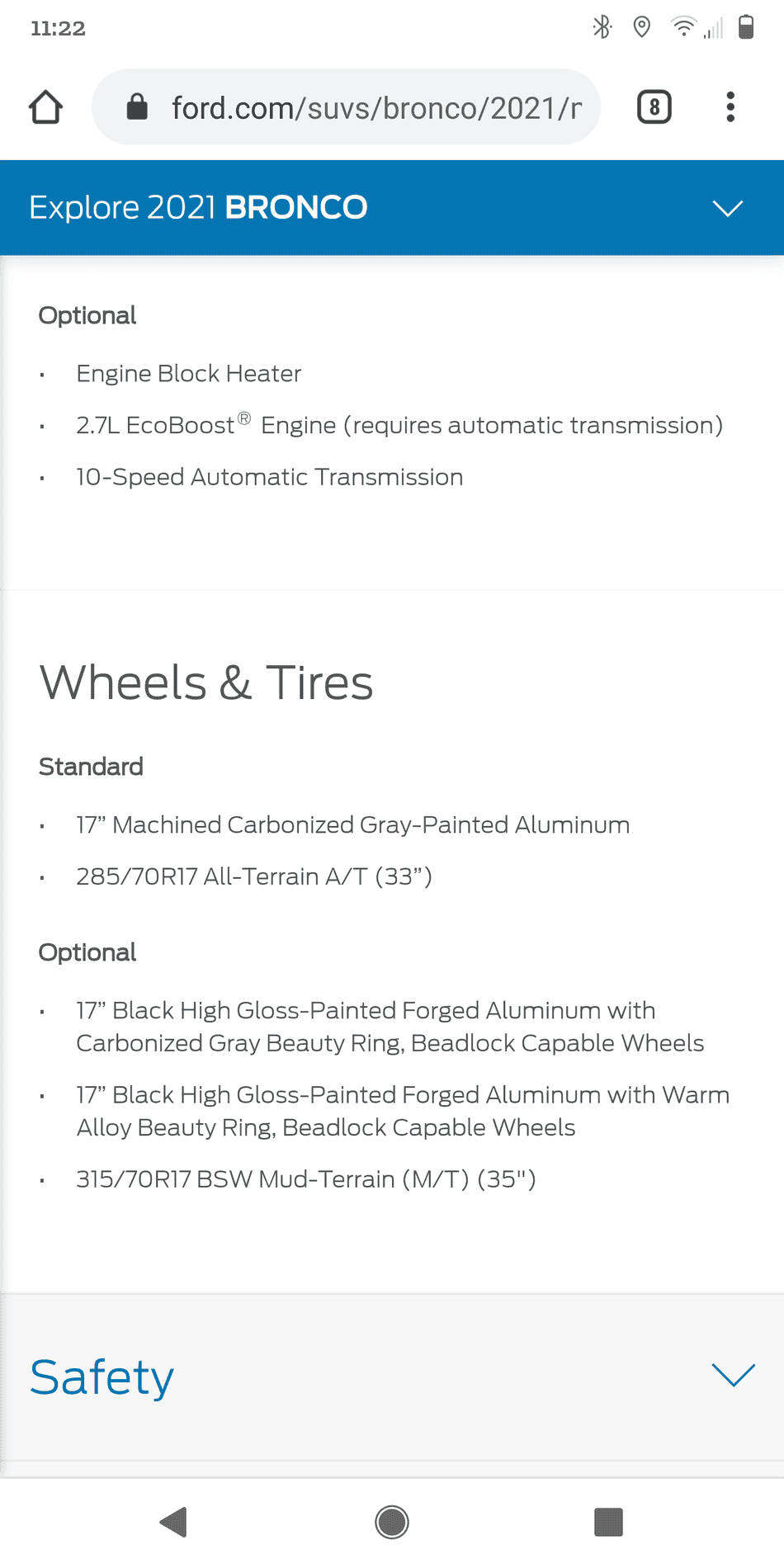

Yes, but only with the 10 speed auto transmission. The standard Badlands manual transmission has a 4.7:1 final drive ratio, same as Squatch. The final drive ratio is 4.46:1 with the auto transmission. I've attached the specs for you. Helpful information. But anything can change?

Yes I am aware. I am coming from the auto 2.7 perspective.
To get the 4.7 gearing need to go Sasquatch.....the gearing is the biggest benefit to me.
