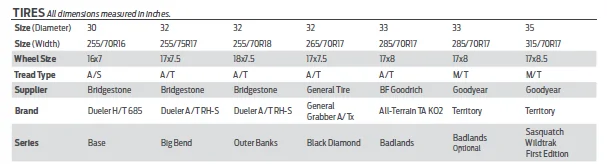

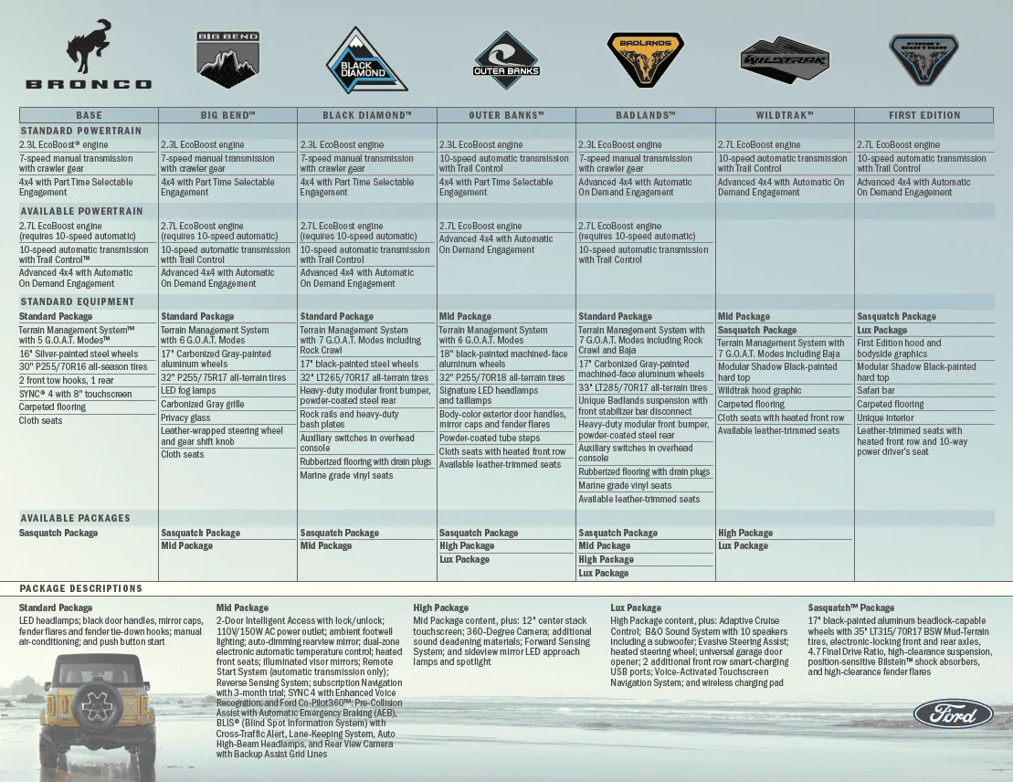

A number of new members have missed the Ford pdfs, here are highlights and attachments.

I was replying to the guy who wants automatic transmission and wants Sasquatch for the 4.7 gearing. What I said is clear, it makes no sense that one would want Sasquatch because it has 4.7. 35" tires need that low gear ratio to be able to crawl
Badlands is not listed on the SotF side of the table because Badlands comes with Advanced 4x4! AND because Badlands has Advanced 4x4, if you put Sasquatch on a lower trim automatic, Badlands will BLOW AWAY squatch without the upgraded 4x4 system, but I ALREADY SAID THAT. Please read more carefully before disagreeing!

Scanning through, I haven’t seen anyone point this out.... these are NOT Mud Terrain tires, they are a Maximum Traction, or Multi Terrain tire. A hybrid of the 2. I have the cooper discoverer version on my wife’s Rebel and they do just fine for Michigan winters. There is zero issue running them year round. The 33 m/t’s for the badlands are same style tire as the 35” squach tires as well.
