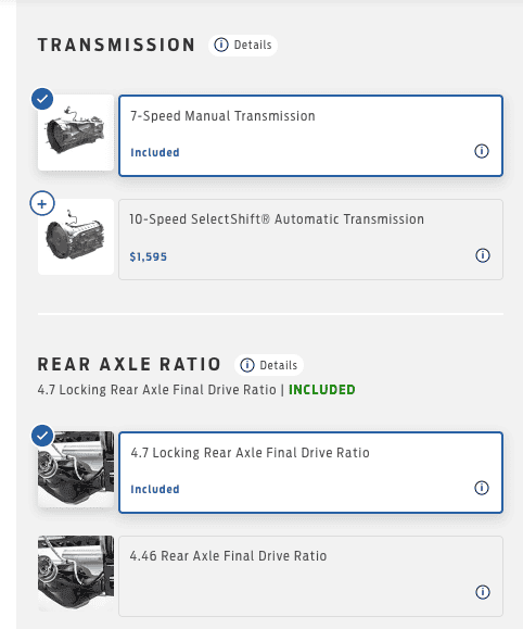

Lots of folks think the SAS is just suspension and tires, but lets not forget it adds the 4.7 drive ratio for the front and rear axle.
Ford Bronco Sasquatch Suspension Quality for Use 1651096700476
Otherwise you could have the 4.46 if you don't select the 4.7 as an $1,595 optional extra.
Agreed, but with one slight change - going manual, you get the 4.7
