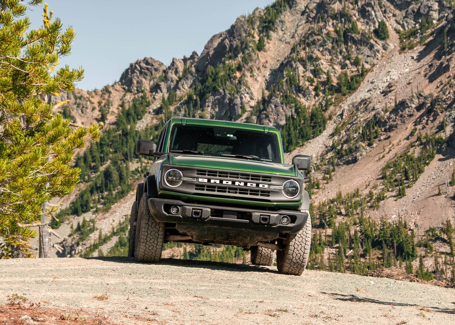

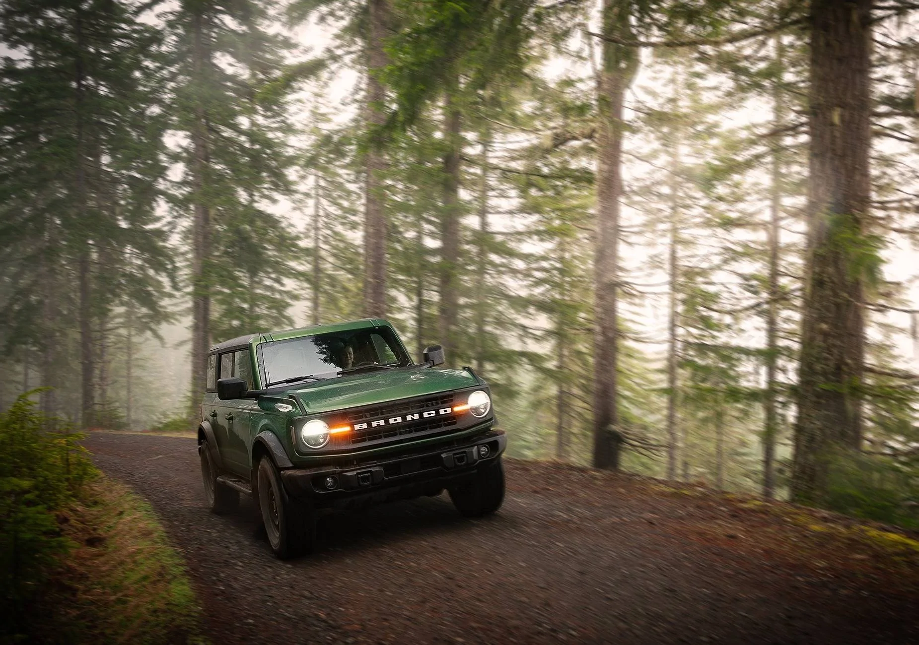

I figure it's time to start a journal for our '23 Black Diamond that we purchased in Sept of 2023. It'll be a good place to chronicle our journey with this thing and to share the many photos and experiences we've gained along the way. Hopefully you enjoy the photos and reading about our progress in building up a Black Diamond to meet our needs.
The Bronco is our first off-road vehicle. I've always been a car person focusing mainly on trackdays and racing of older BMWs. My wife wanted a vehicle to be able to take on gravel roads to access hiking and mountain biking trailheads. We originally wanted a 4 Runner until we drove one and were severely underwhelmed. After the test drive of the Toyota, we saw this Eruption Green Bronco on the lot next door. With the way it was spec'd out, it was very comparable to the 4 Runner, but we liked it better in every way. Little did we know, we'd get hooked into offroading....follow our journey below:
2023 Black Diamond 2.3L Auto, Eruption Green Metallic
Ford Bronco Scott's PNW Black Diamond Photo Journal 20230919_182312 (2)

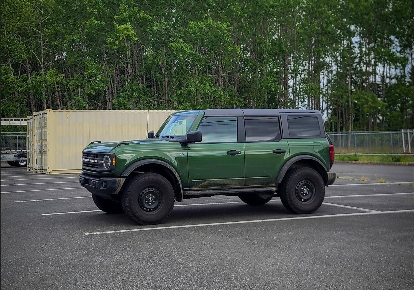

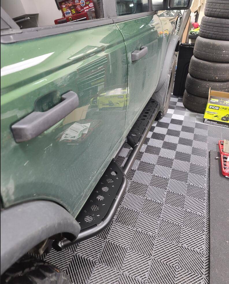

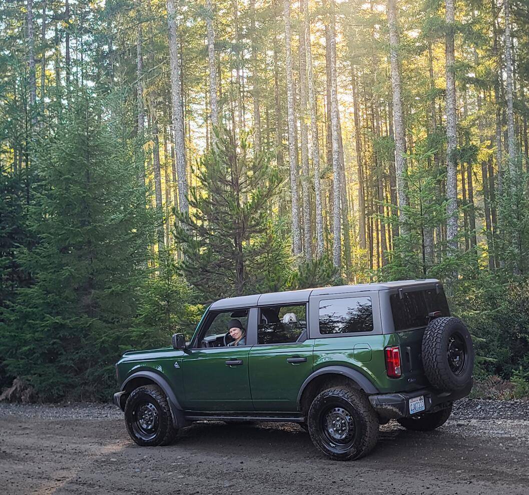

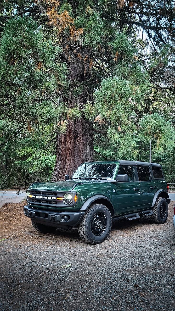

First mod was Black Rhino D1 side steps which were truly terrible but they their main purpose was to protect against the stones that those factory General Grabber tires would throw at highway speeds.
Ford Bronco Scott's PNW Black Diamond Photo Journal 1735582858411-4s
Ford Bronco Scott's PNW Black Diamond Photo Journal 1735583055868-j8

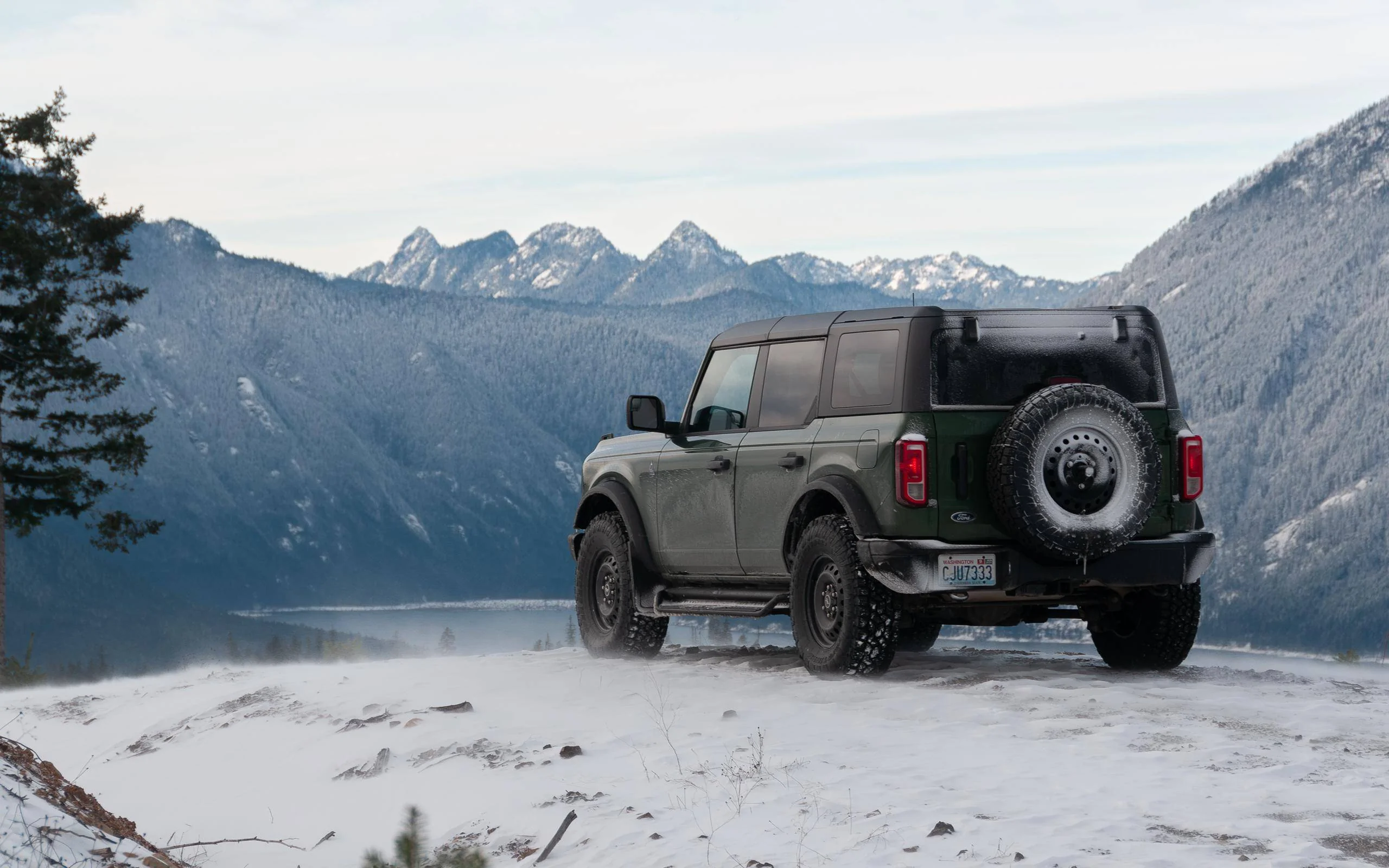

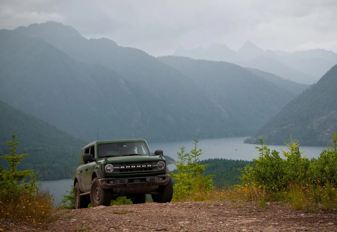

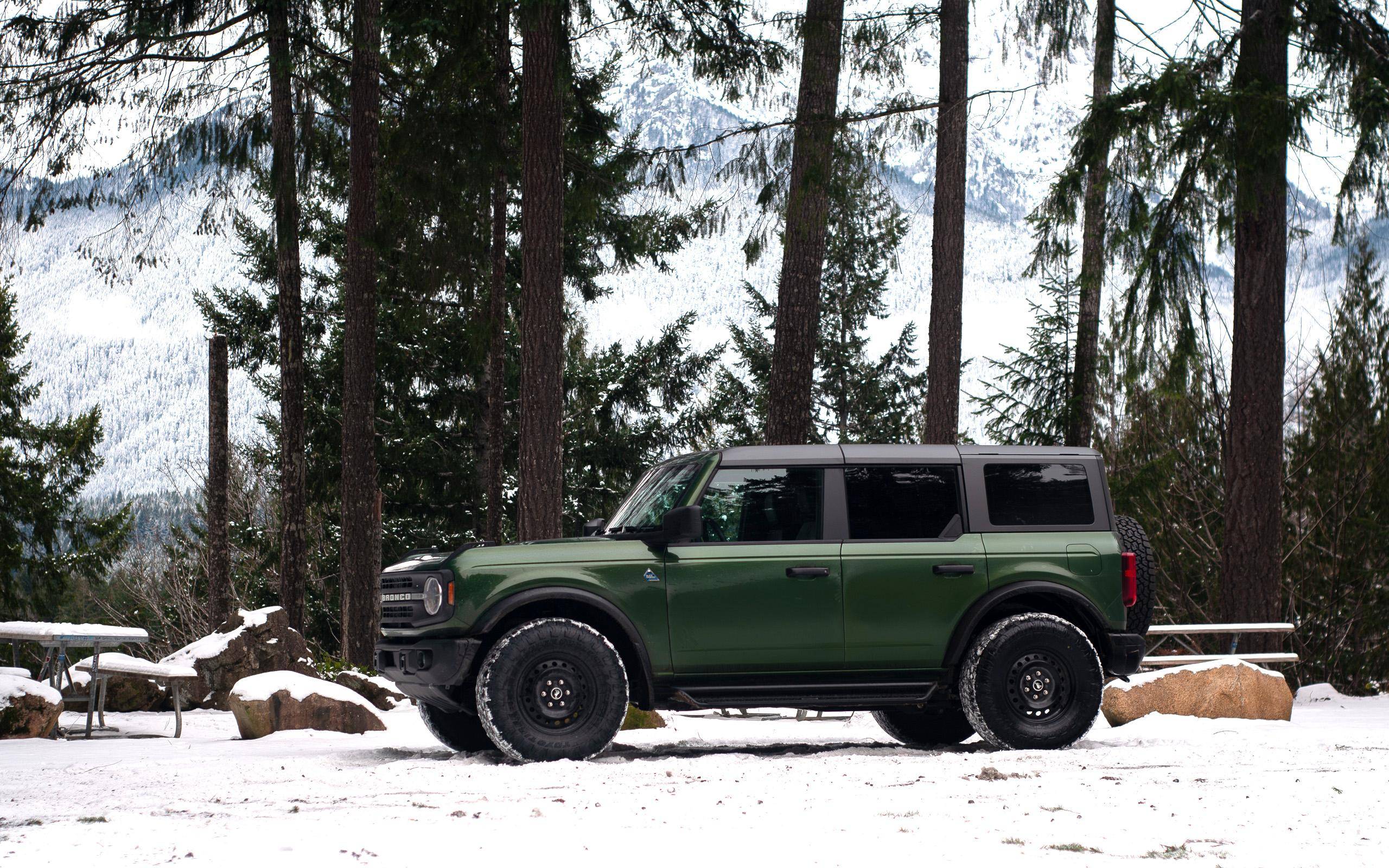

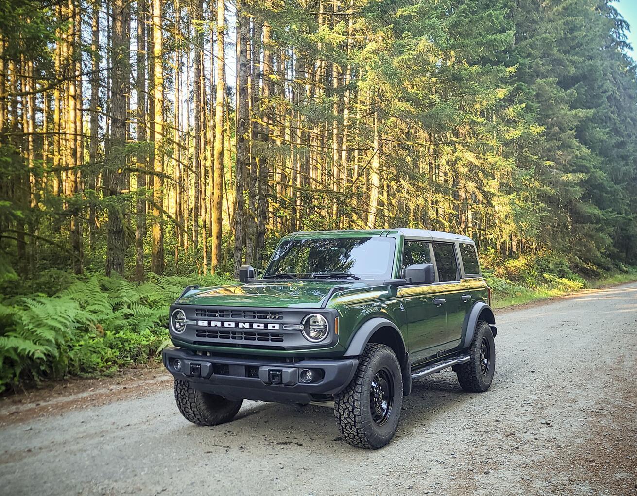

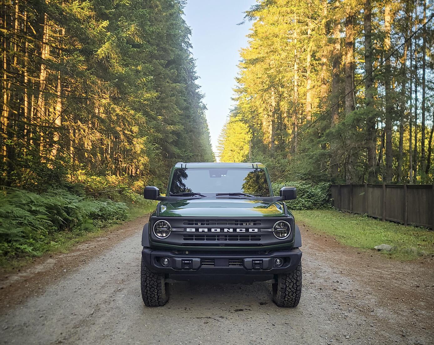

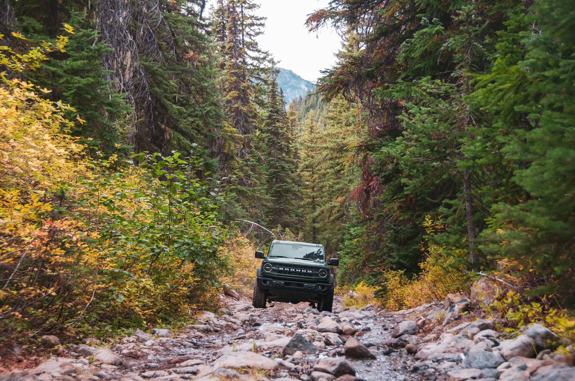

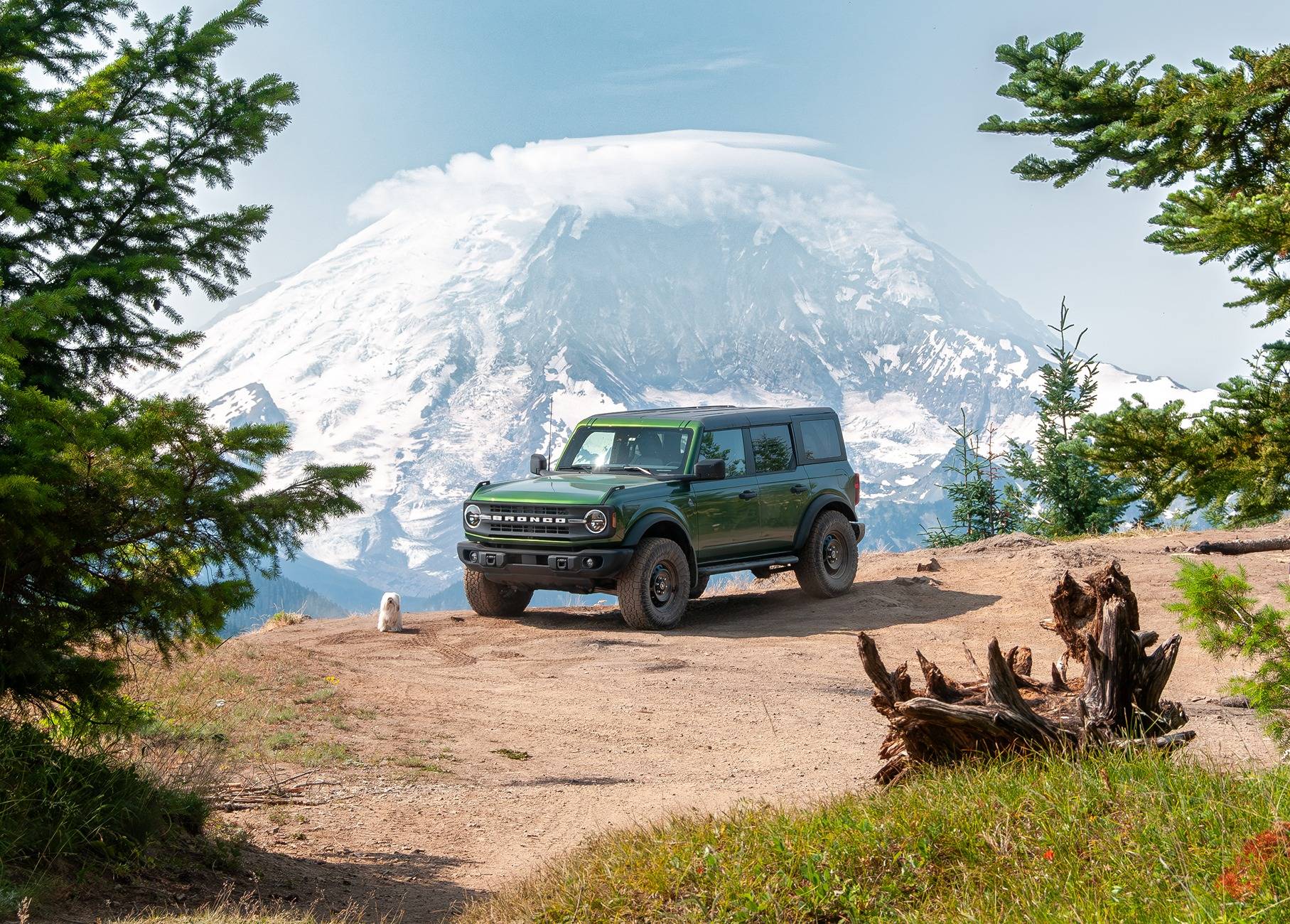

At first we thought we were only going to use it on mild forestry roads for the sole purpose of getting to trailheads (hence the low side steps). Little did we know off-roading would turn into a hobby all its own. I'm well aware of the slippery slope of modding vehicles and we spent the first winter just driving it as is then started to slowly make changes to address shortcomings without introducing too many downsides.

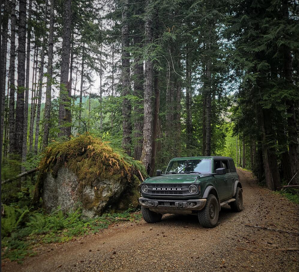

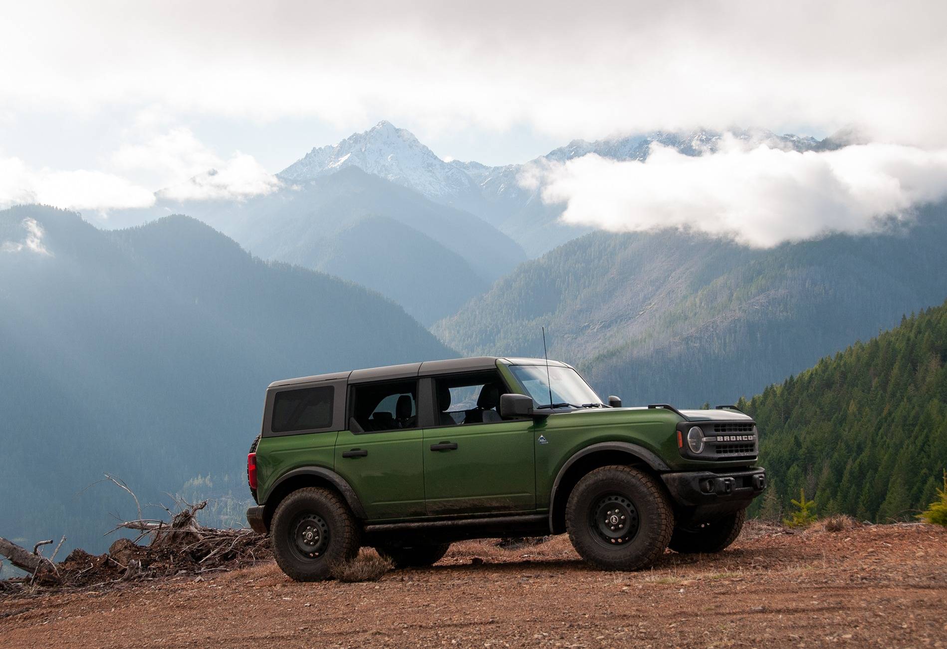

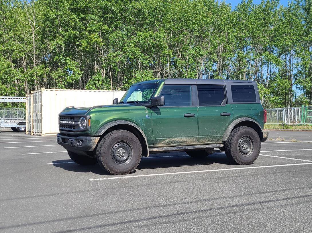

First real mod was a set of tires
I wanted a bit more ground clearance and less rock throwing. Didn't want to ruin the fuel economy, the ride or do any other mods so we settled on the largest tires that would fit without removing the crash bars: (34"x11.5") 285/75R17 LR C Toyo Open Country A/T III installed in Jan 2023. Here are some initial thoughts from another post 285-75-17s-on-a-black-diamond-non-sasquatch
"My main concern prior to driving on them was the additional weight of the 34" Toyos compared to the 31" Grabbers. At a little more than extra 12lbs per tire, I knew that was going to be noticeable, but didn't know how much so. I was happy to find that the additional weight doesn't detract much at all from the driving dynamics. Yes, you can feel the extra weight but it balances out the ride a bit better (feels more planted and softer over bumps) and the additional inertia on the drivetrain has the benefit of smoothing out the 10-spd's shifting. The Bronco overall now feels a bit less sports SUV and more like a truck, but I think it suits the vehicle's character a bit more and the tires now feel better matched to the heft of the chassis. It took about 3 days to get used to the new dynamics and after a week it feels perfectly normal. Main difference is slightly more brake pedal pressure to come to a stop, slightly more throttle to get up to speed, and slightly more steering effort when cornering.
I'm running them at 35psi cold and recalibrated the speedo with Forscan (I used 2565 for Tire Circumference (mm) and it is dead-on with my gps at 70mph)
The 2.3 with the 10spd and 4.46 gears has plenty of power and accelerates and cruises at 80mph (or above) effortlessly. Looks like we lost about .5 to 1 mpg.
The OC AT3s roll more smoothly than the Grabbers with less overall vibration. They aren't necessarily quieter, but their noise on the highway is in a higher frequency band which makes the tire noise less intrusive when talking or listening to music. They also pick up and throw much less gravel. They drive as well, if not better, than the Grabbers in wet or dry and felt very surefooted in the snow and ice we just had in the northwest.
They look great too! What is only about 1" of ride height difference looks and feels 3" when standing next to it or from the driver seat. Photos don't do them justice either- they appear much larger in person with a nice sidewall bulge and aggressive side lugs and tread pattern. Perfectly completes the look of the Black Diamond steel wheels in my opinion - it's sitting pretty now with no other mods."

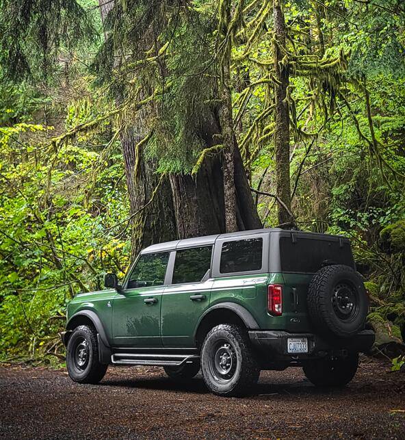

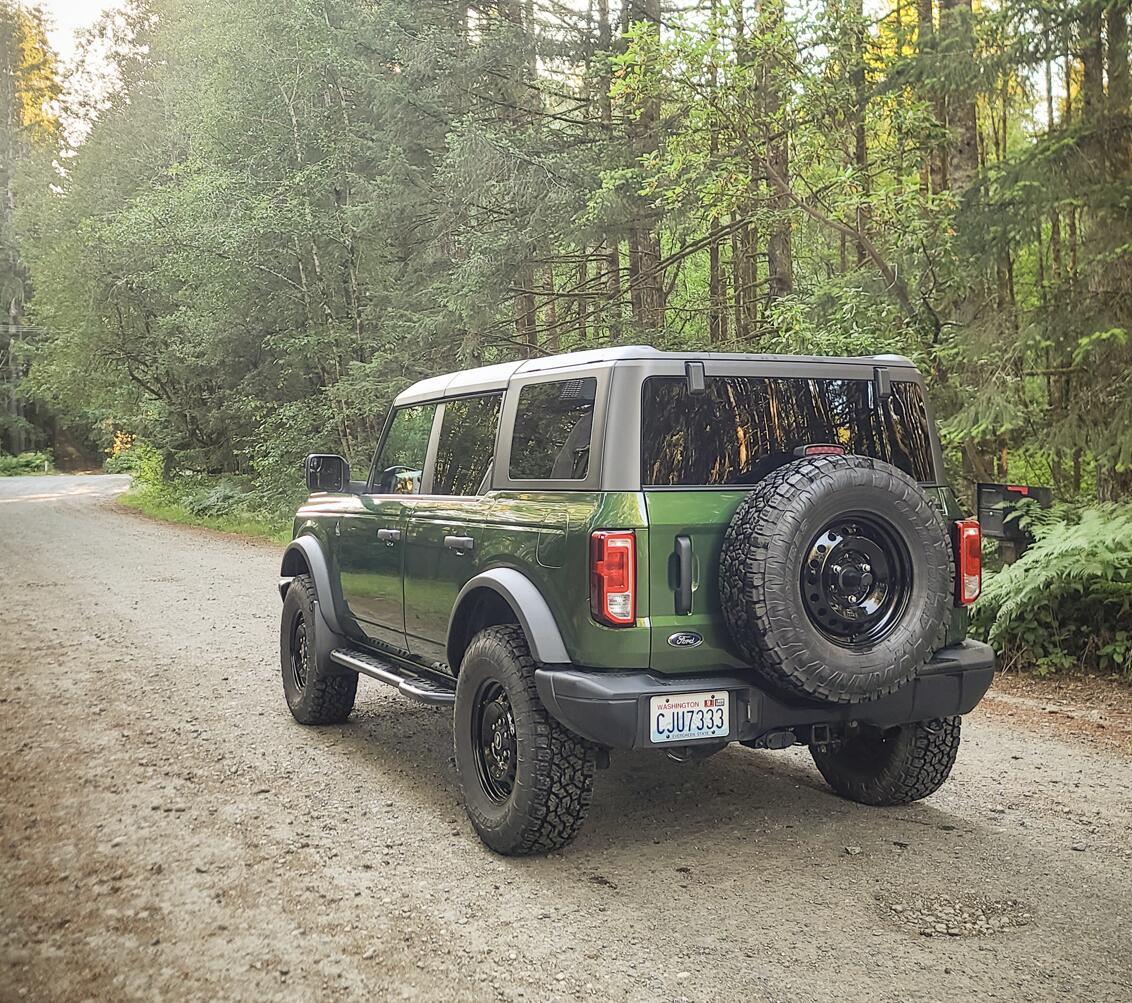

Next mod was a set of ZRoadz step/ sliders.
I was going between a few different options when I saw the ZRoadz for sale at a discount for $300 on their website. I ordered and not too long after they called me to explain that it was a pricing error on their end and couldn't sell for that price. But they did give offer a 50% discount as a consolation. I thought that was fair and so placed the order. They are body mounted, but they are pretty beefy and have served our purposes for the types of trails we encounter in the northwest. The rear kickout works great for pivoting off of trees.

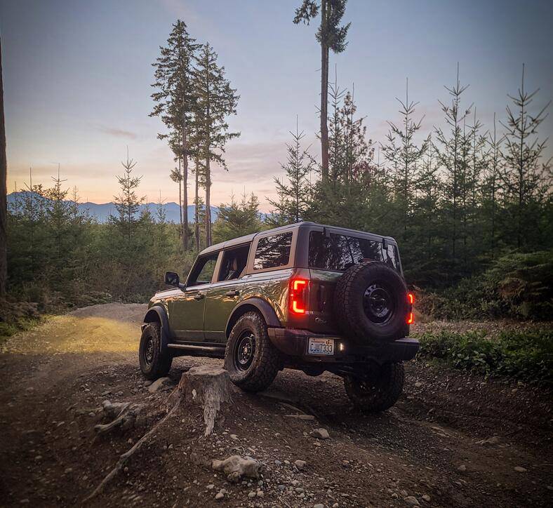

Next up we installed Morimoto XB Taillights. I liked the look, but they had an issue where the left brake light/turn signal would not illuminate intermittently. After a few frustrating weeks of troubleshooting and not getting much help from Morimoto, I ended up returning them for a refund. Seems like this issue only affects those of us with OEM halogen tails. More here: https://www.bronco6g.com/forum/threads/new-morimoto-xb-tail-lights-now-available.99542/post-2358750
