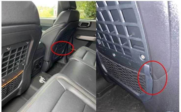

My issue is kind of minor. I have a Badlands with the orange accents in the interior. However, the passenger seat back has a black elastic cord instead of orange.
I know I could just leave it black, but I thought I would get it replaced under warranty. Simple fix right?
Talked to the dealer and they filed the warranty claim and ordered the part, M2DZ7860762AA. Well it turns out this seems to be the WHOLE seat back insert. The dealer didn't show me the part and I forgot to ask. They said I would need to drop it off because they would need to REMOVE the seat to replace the part because there is a strap on the bottom of the seat back that goes to the front of the seat. (I need to get a mirror under the seat and check that out.)
Seems extreme to replace that little net.
You would think it would be an easier repair because people will break that string and probably the net too. I would think you would just have to pop that trim piece out that holds the "string" and net and just replace the "string" and net. (right side pic) and pop that U shaped trim back in place.
And no I have not tried to pop it out because I know I'll break it. Ha!
I did remove the "Bronco" bolts to see if the panel would pull away from the seat back...it didn't budge.
Any interior part experts out there that might have some input?

M2DZ-7860762-AA Should be the panel if you have manual seats. $474.42 retail.
Not crapping on the dealer but this is considered misbuilt and would've needed to be caught when the vehicle was delivered to the dealer. This is easy to overlook and we've eaten our fair share of stuff that wasn't caught until it was too late.

Thanks Flip. I saw your previous post as well, much appreciated.
I still find it amazing that the whole back needs to be replaced to fix the cord/net.
It appears it would be a much easier task on the door cord/net.

No I wasn't asking anyone on the forum to remove their seats. I just know there are a LOT of folks on the forum that do a lot of work on cars and have more knowledge than I do.
Let's do a hypothetical.
Let's say the dealer ordered the whole seat back because they thought that was what they had to do to fix the cord/net. Thus ordered the wrong part to fix the problem.
When they possibly could have ordered just the cord/net and popped of the trim piece holding it in place to install the new cord/net.
Not saying that is what happened and not saying they could have just ordered the cord/net.
But what if? Stranger things have happened.

I took some pics of the elastic strap the "Interior Parts Expert" at the dealership said goes from the back of the seat to the front, which requires the "Interior Parts Expert" to remove the seat.
It appears to me it only goes about 3-4 inches under the seat.
