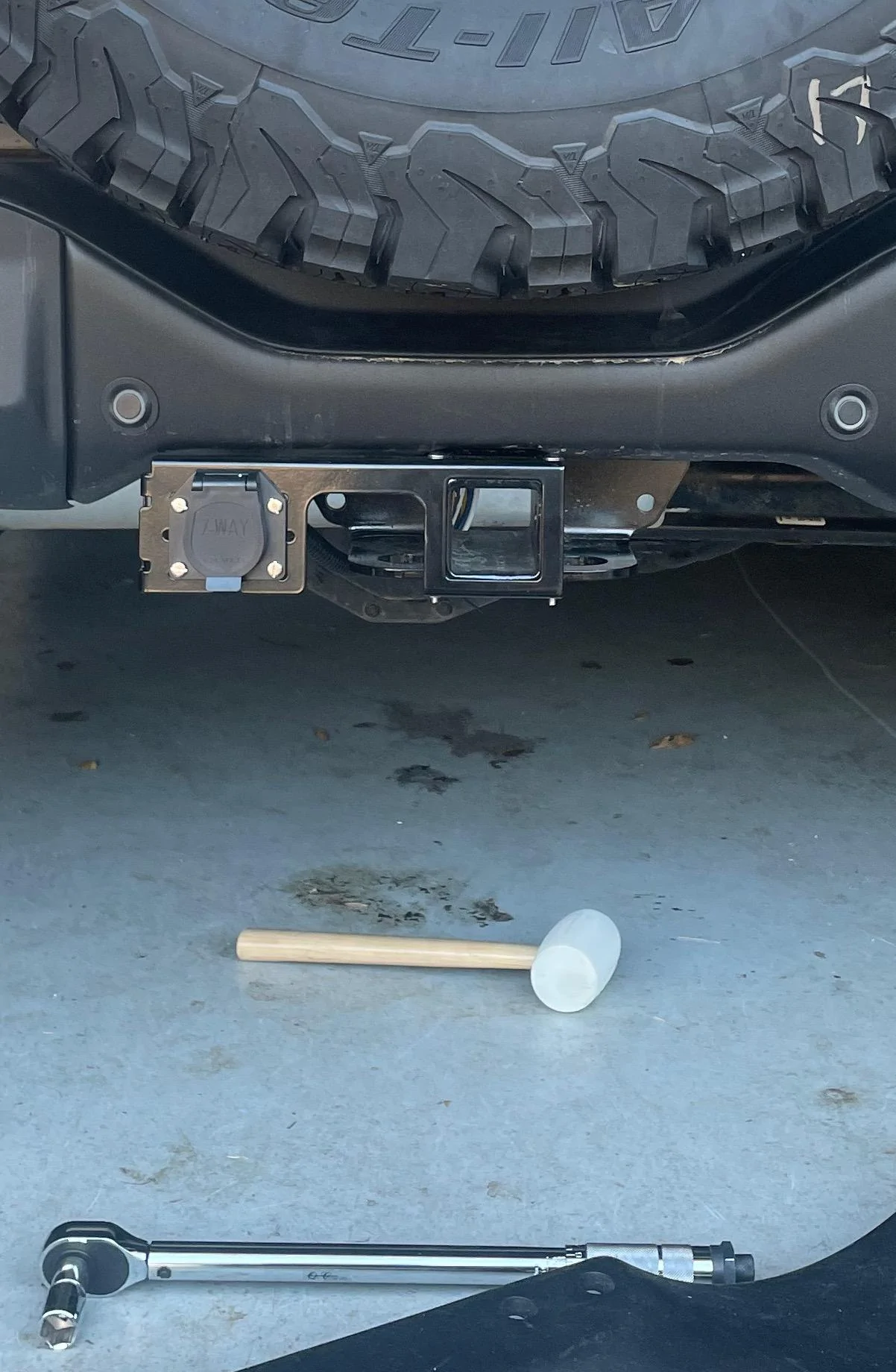

Hello, I thought I'd share my tow package build. I have not looked for a similar post so apologies if it's a repeat. But here is my self made Tow package. I removed the factory tow package to hopefully get built quicker, and it worked. Here is my parts list, and a quick install review:
Parts:
1. Curt wiring kit p/n: 56468 - $79.82 (etrailer.com)
2. Curt Receiver Hitch: 13493 - $104.31 (toysfortrucks.com)
3. Wiring Connector: Road Tough - $16.89 (Amazon)
https://www.amazon.com/Road-Tough-W...x=road+tough+trailer+connector,aps,114&sr=8-3
Total: $201.02
Savings over Stock: -$393.98
Hitch install, easiest I've ever done. Seriously. It took less than 15 minutes.
Wiring, was relatively easy other than the Wire running to the battery. Had to get creative on that one.
Total install time: 2(ish) hours.
Conclusion: I got my Bronco early, and saved $400. Totally worth it.

If one doesn't need the 7-pin, then yes, you made the right call.

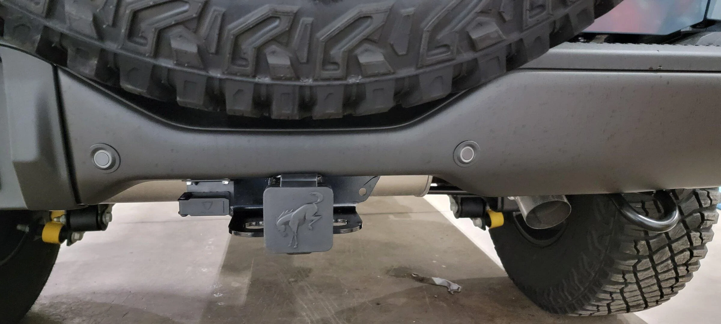

opted for a similar setup, (currently don't have reverse and using curt echo for brakes):
Ford Bronco Self Made DIY Tow Package (If 7-Pin Not Needed) IMG_4520 (1)
i didn't say it was pretty. lol

It's so easy the video would super short. Literally 4 bolts. That's it.
My boat trailer is 2,500 lbs but it has a 7 pin for the reverse lockout. I didn't know about the echo, it's nice but for the price, I'll get out and put the pin in or wire the reverse. Thanks for the info.
