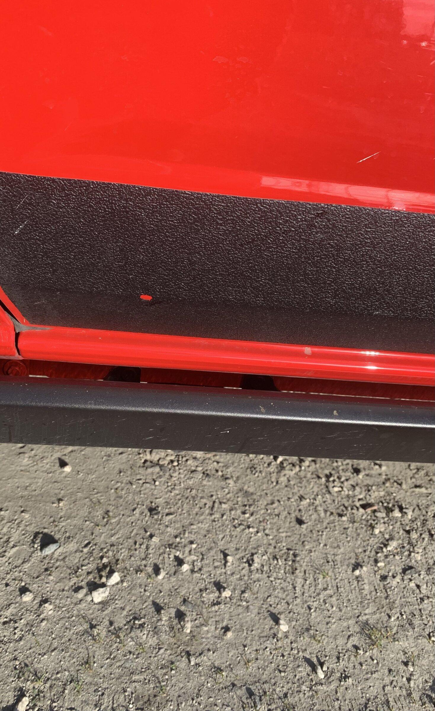

I'm just not convinced that a thin piece of plastic film will really protect against rocks flying at hight speed?
Ah, but it does. Indeed it does.
I installed XPel Armor PPF on the bottoms of mine soon after noticing I was getting some chips/scrapes from gravel.
I would hate to think what this one would have looked like without it.
it took a chunk out of the PPF but the paint looks to have been saved.
