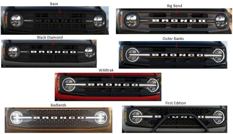

Might be an MY22-23 change. Probably will be retrofittable too. Not an engineer and I did not stay at Holiday Inn Express either.
As an engineer, if they want to move it towards the top of the grill the have to make a new plastic injection mold for the new grills and assign all new part numbers to each color and style.
Then they possibly have to create a new wiring harness to reach the new camera location.
Then, they have to possibly create a new part number bracket to hold the camera, unless it mounts to the grill itself.
But after looking at my grill shutter drawing none of this will work as the active grill shutters are in the way, see pic below.
PLAN B: Relocate the camera to a new bracket on a new part number brush guard, new wiring harness and modify the software for the new location.
Now I can see why this will not happen for 2021 and maybe not until the next major refresh cycle, like the floor mounted combination heater vents / wash out water resevoirs.

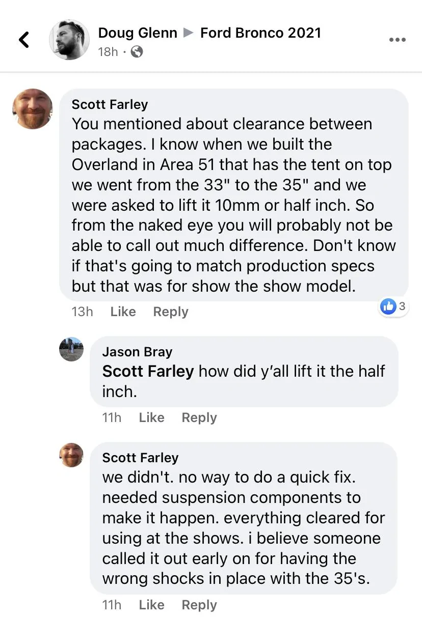

My interpretation of the guy’s response is that when you get the Sasquatch on a Badlands, you get a 10mm/0.4” lift over the standard Badlands suspension. If you get the Sasquatch package on any other trim, you get a 1.5” lift over the standard suspension.
Badlands has the HOSS with position sensitive dampers. It is the only trim that has that without including the Sasquatch package. Based on the preliminary spec sheet, the Badlands has more suspension travel than the base (which the other non-Sasquatch trims look to share) leading me to believe that the Badlands has a lift of some sort over the other non-Sasquatch trims.
Thought this was interesting and might confirm the 10mm lift to 35’s
