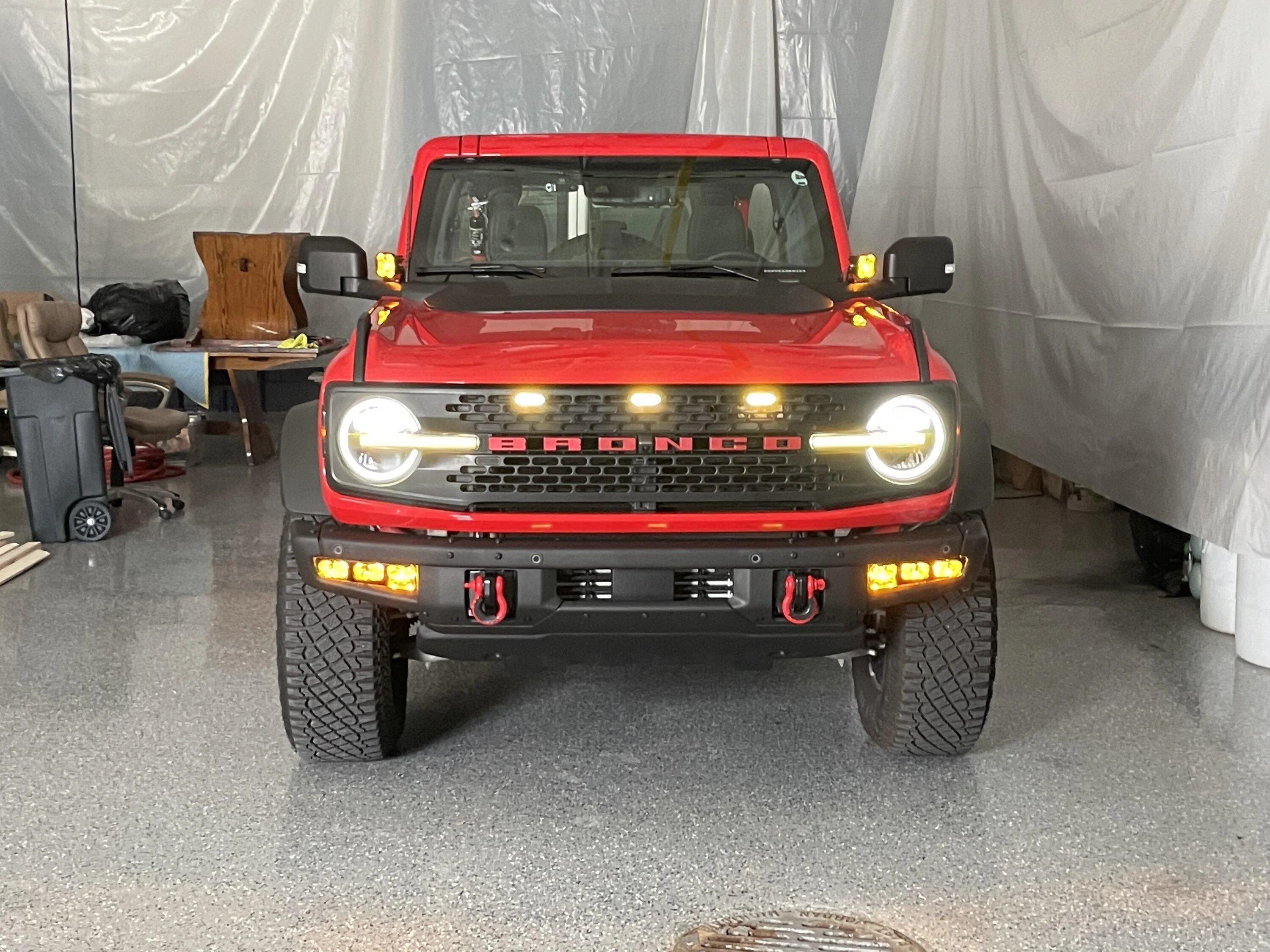

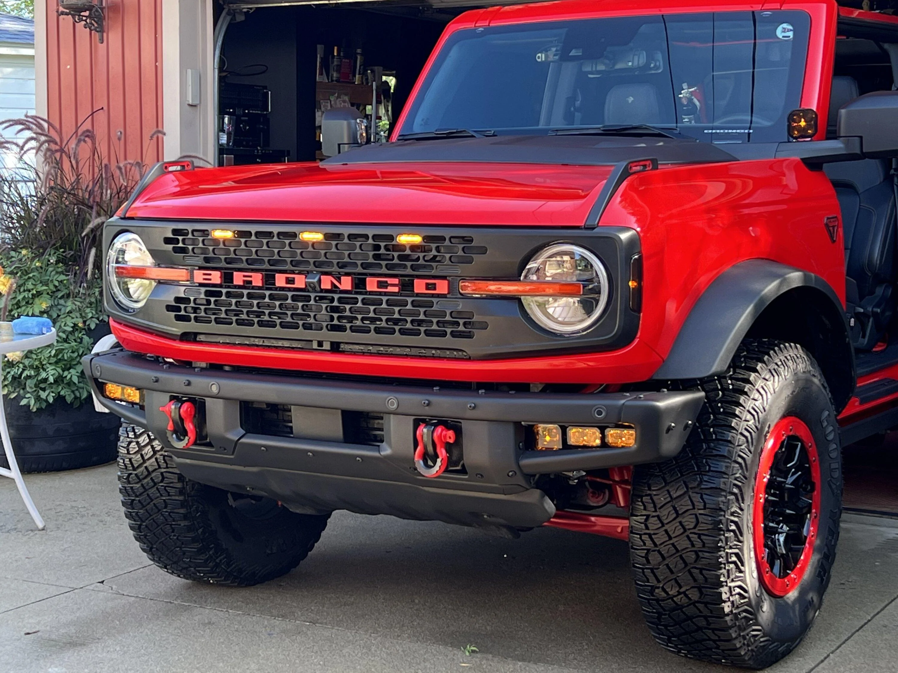

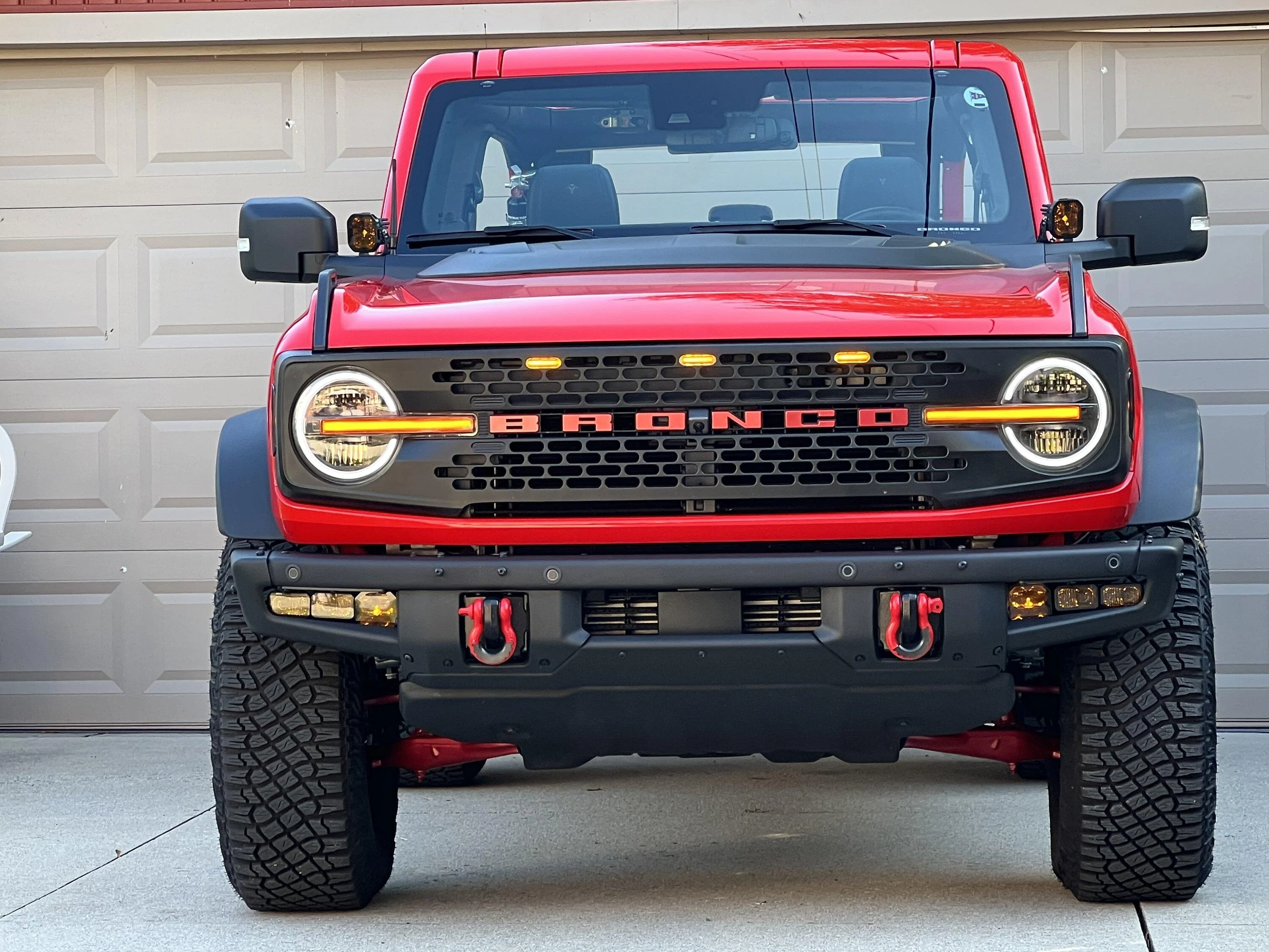

All mine are wired to one uplifter. Rears and grill included. Running ambers in the front and did red for the rear. Light bar back lights will be hooked to the same if oracle ever gets that light made. If not diodes will be going up top.

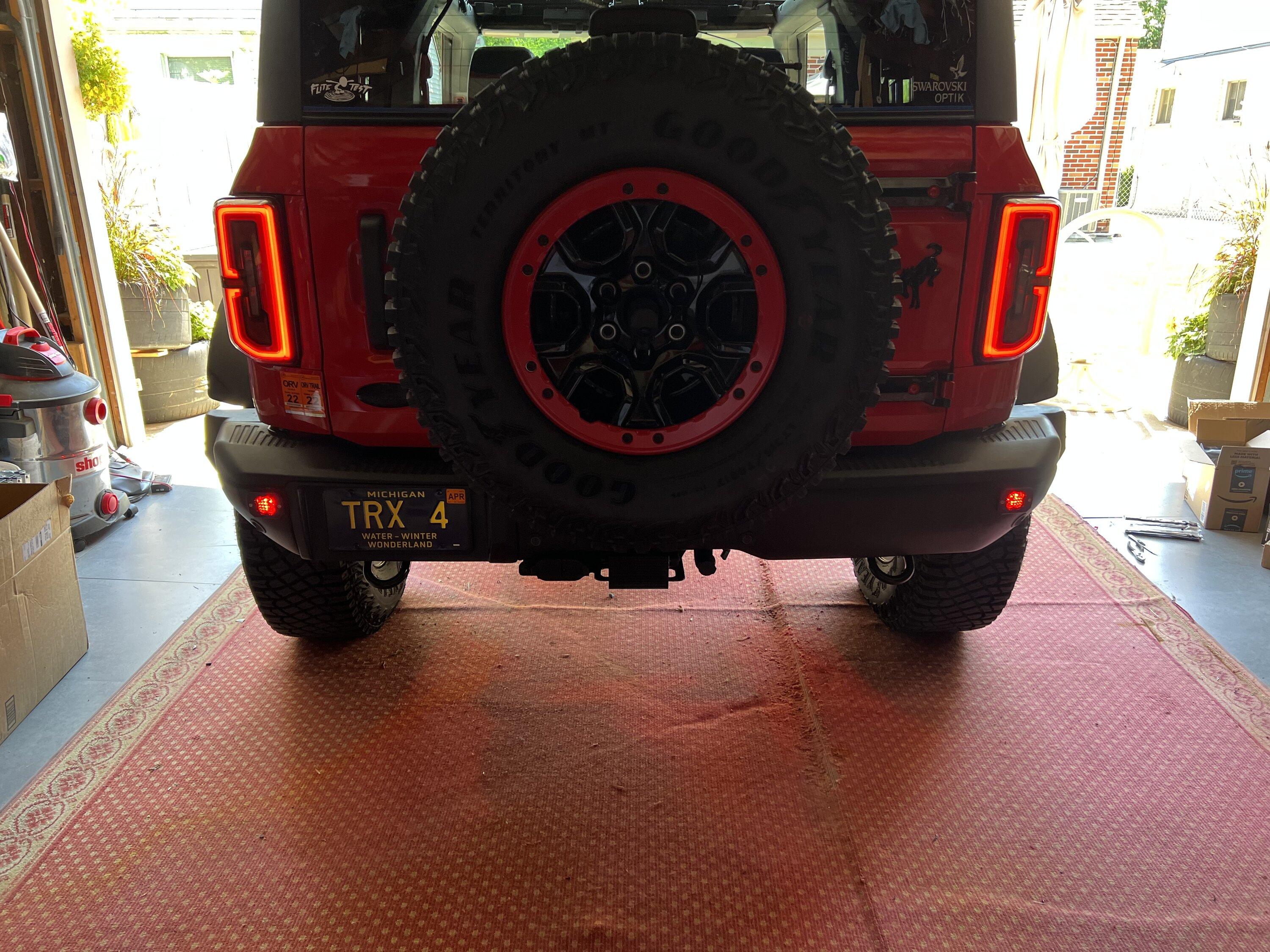

Looks great! How did you put lights in the rear bumper? Is it a steel bumper, right? And what color you have for each of your lights when they are not in the backlight mode?
Ground_zero298
Apr 5, 2022
2,179
5,455
Scs michigan
Lights are all white. Then I got the amber and smoke clip on covers. Using smokes on all the fronts right now. So smoke covers for the city, amber covers for the winter/dust, and whites for nighttime looking around. Covers all my bases. First 2 pics is smoke covers on. Last pic is no covers, just the actual backlight.
Rear bumper is metal. There is a post on here for adding the ss1’s to the rear. Have to cut the metal out but they fit nicely in the spot he chose.
