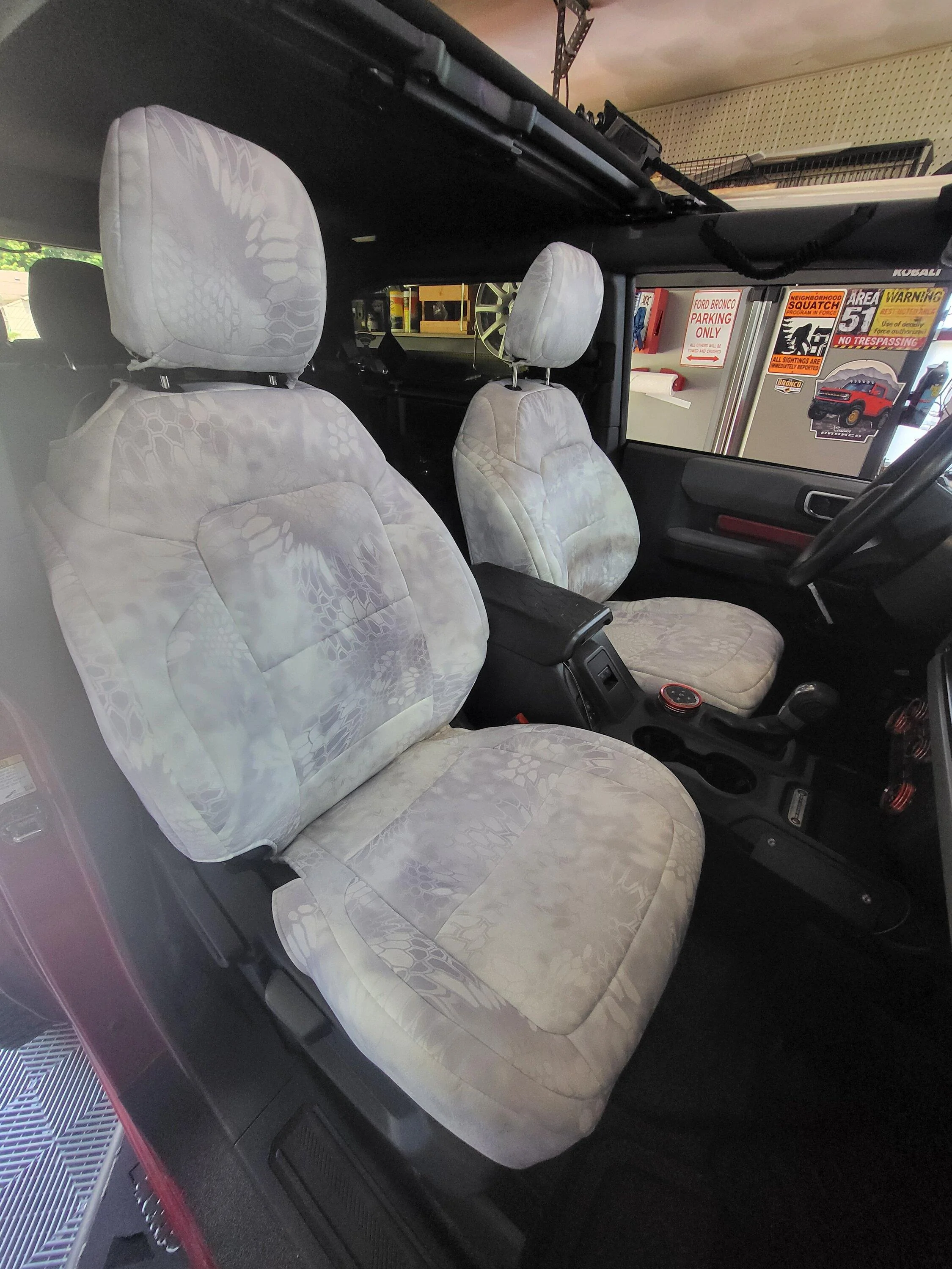

Just installed the front seat covers today. Pretty easy to install, the seatback and base covers are one piece, and there are straps under the seat to hold the tucked seam in place. Fit is good, matches up well to the factory seats, so it looks good. Will update later on how well it stays put.
Trying for a lighter color for a bit less heat in the seat, buy they have all the colors too. This is Kryptek Wraith camoflage.
Right now, my only beef, which is only partially with Coverking, is that the front and back seat covers shipped separately, so the back seat covers have not arrived yet. I suspect that is more a UPS issue, but if they had been in one box, it would not have happened. On the other hand, that might have cost more to ship, so I understand potentially why they made the decision.

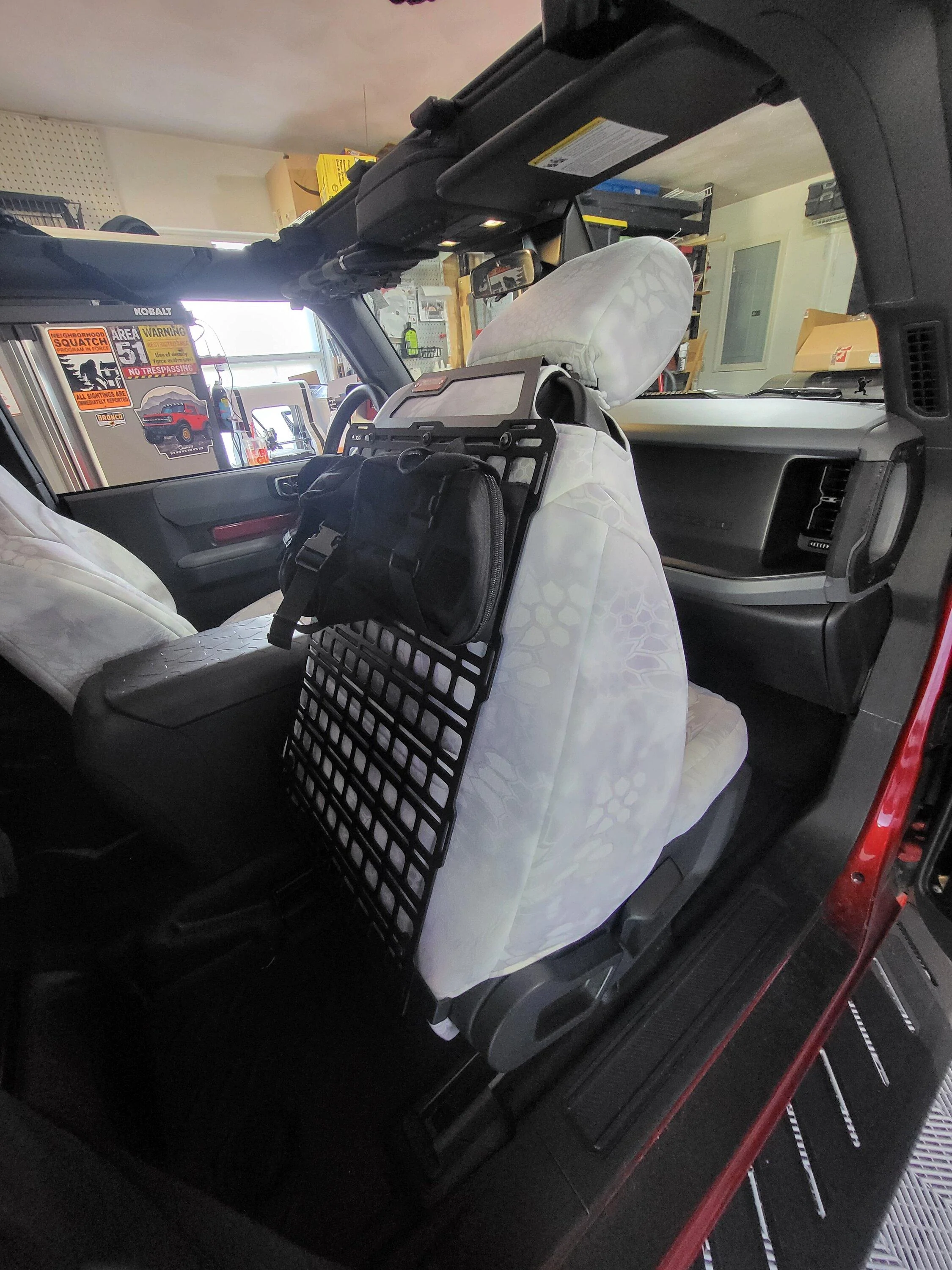

Also took the opportunity to upgrade a soft Molle pannel that hung from the headrest to a BuiltRight seatback rigid molle panel to get rid of some straps and tighten up the mounting.

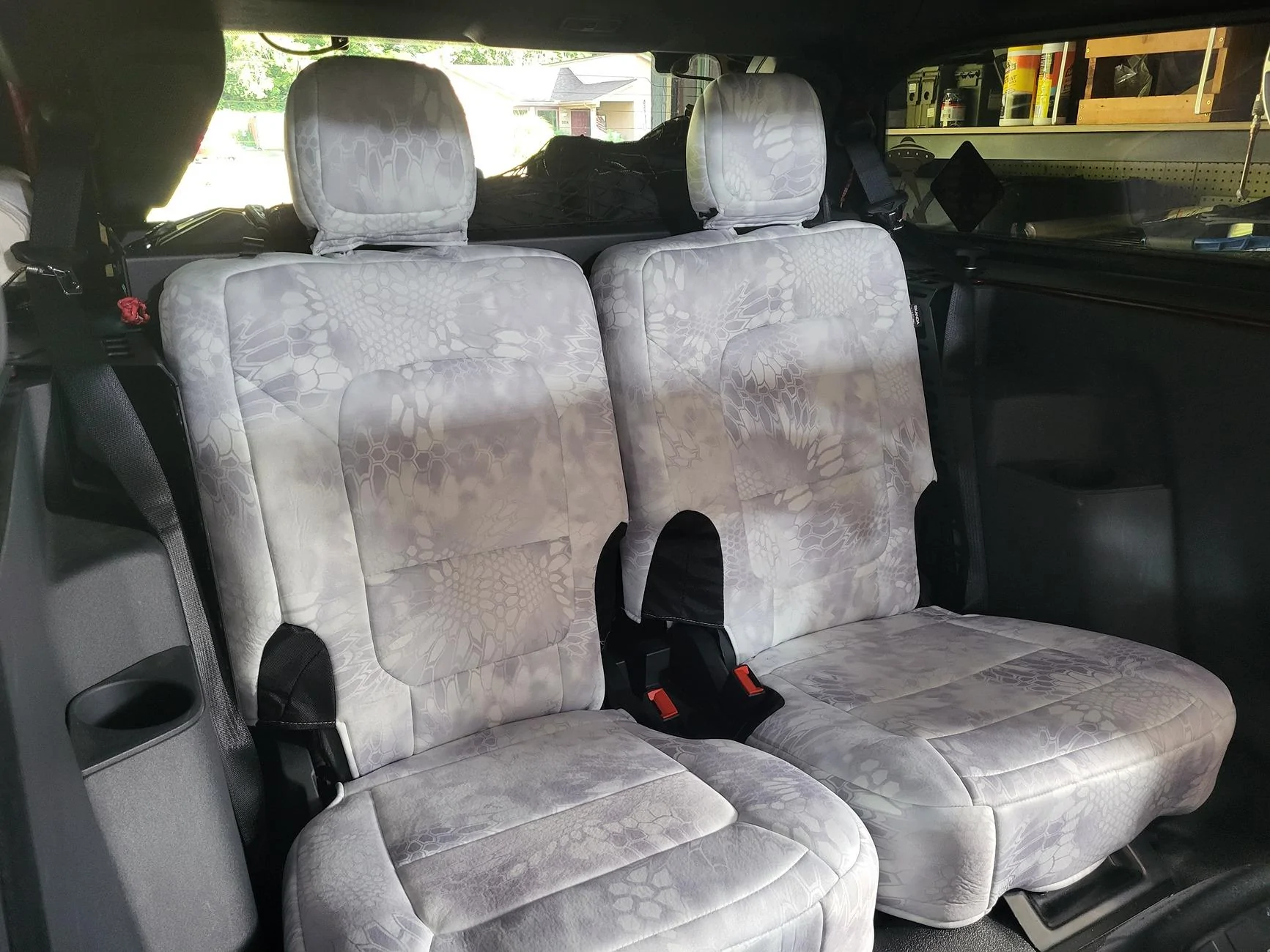

Installed the back seat covers too, they were about a week behind the front covers, no idea why, but the UPS tracking was chaos, so it may be UPS' fault. Installation is very simple, no tricks here. The seatbacks slip over, there is velcro to close things out, the seat bottoms hold on with straps. Very straightforward. The black areas around the seatbelts are kind of a nylon/Cordura type material that should take the friction here better. Those areas would be pretty high friction if I had back seat passengers much.

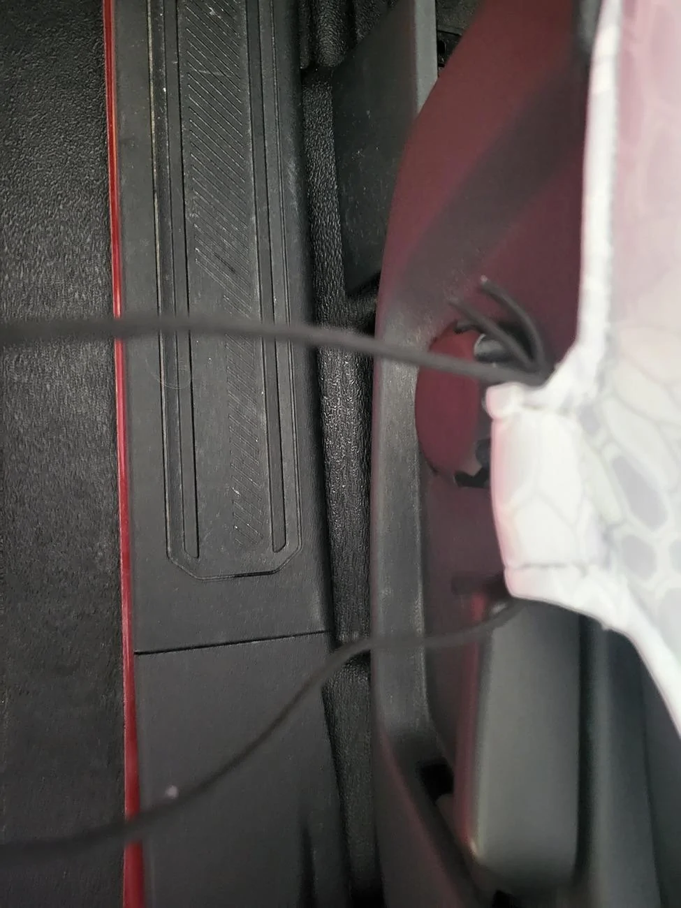

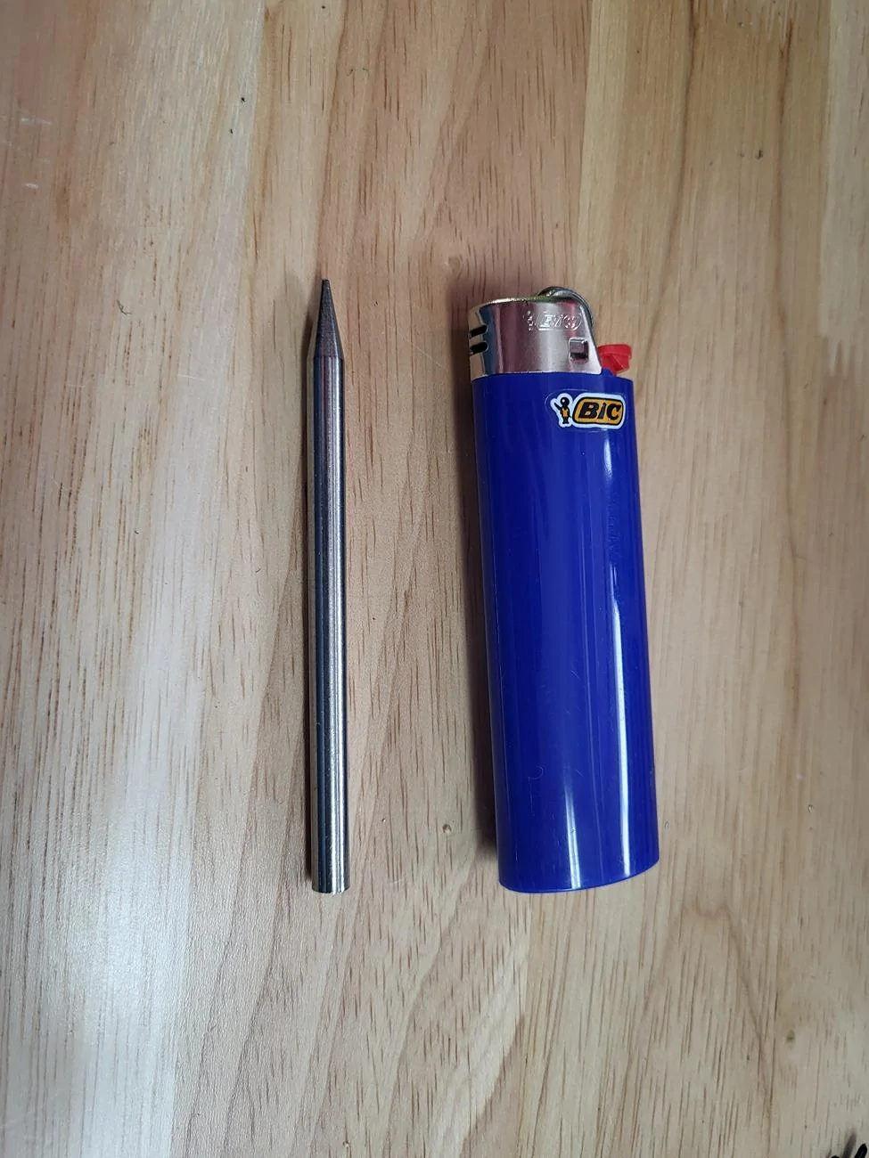

Also, I have had an issue with the left side of the driver's seat pulling out. It is only held in by a tab on the seatcover, that has a piece of tubular foam or something like that sewn into it. it comes up pretty frequently for me. My first fix is to run some shock cord through the tab and hook it off under the seat. To get it through, I used a "fid" paracord tool (shown below) and jammed that through the tab, then pulled the shock cord through, tied it in a loop and ran it under the seat.

You can find the "fid" on Amazon or anywhere that sells tools for paracord crafting.
