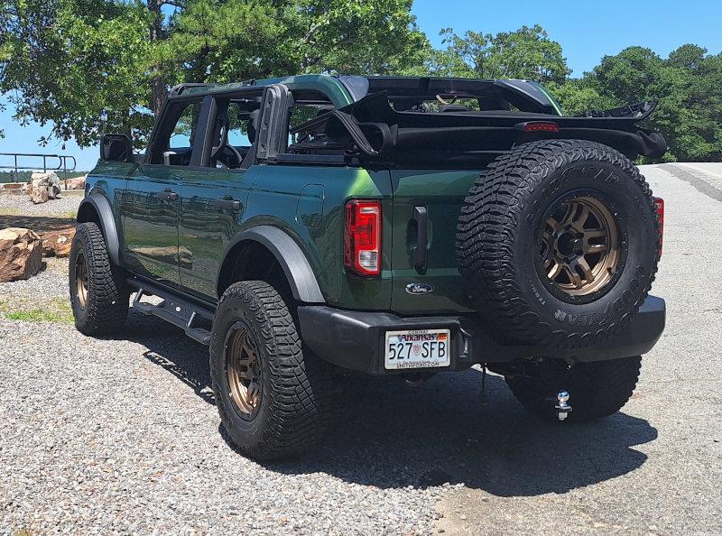

Changing wheels was on my radar, but more of a nice to have, being dictated by tires. 285 75R18 actually gets me a higher ride than the 315s do (only like .5", I know), lower rolling resistance, better on road manners, and higher downward force per square inch. If I was up north with deep snow, or out west with lots of dunes the 315s would make more sense. Since our snow is rarely more than 6" at a time, and our trails are tight woods, rocks and dirt, pizza cutters make more sense to me.
Ok. But honestly I think you're overthinking the small differences. If you want to tires to stick out more, which I like that look much better, then ok, I get it.
I bought mine used that already had aftermarket rims and 315-17s. Here's a look to see how far the tires stick out.

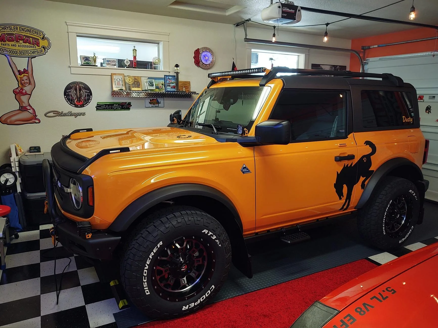

18's!!!!!!!!!!!!!!!!!!!!!!!!!!!!!!!:
Ford Bronco Show me your 18's. Calling all mall crawlers? RearDone
Ford Bronco Show me your 18's. Calling all mall crawlers? InManCave
