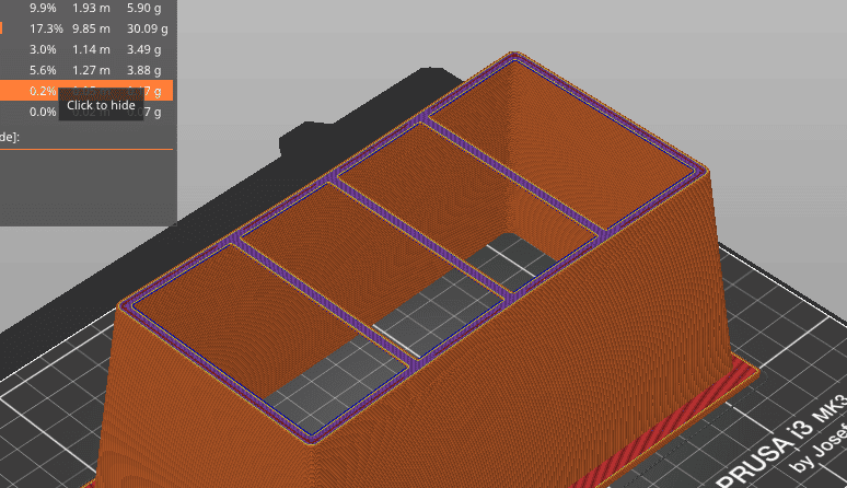

This looks to have some stabilizing ribs across the bottom of it which don't seem that they would print well with bridging and no supports.
Ford Bronco Show me your 3D printed accessories. 3D Prints for Bronco Enthusiasts. 1667946818693
I don't remember why i did that. Maybe my thought was that those ribs would bridge easily and act as joists for the full bottom bridging, versus it going the full width.
I also didn't consider using support blockers to have a single narrow support in the middle instead of the entire thing

I would just flip it right side up from bottom to top with supports up the sides. If you do it upside down the inside bottom will look bad IMO and that's the part you will see.
