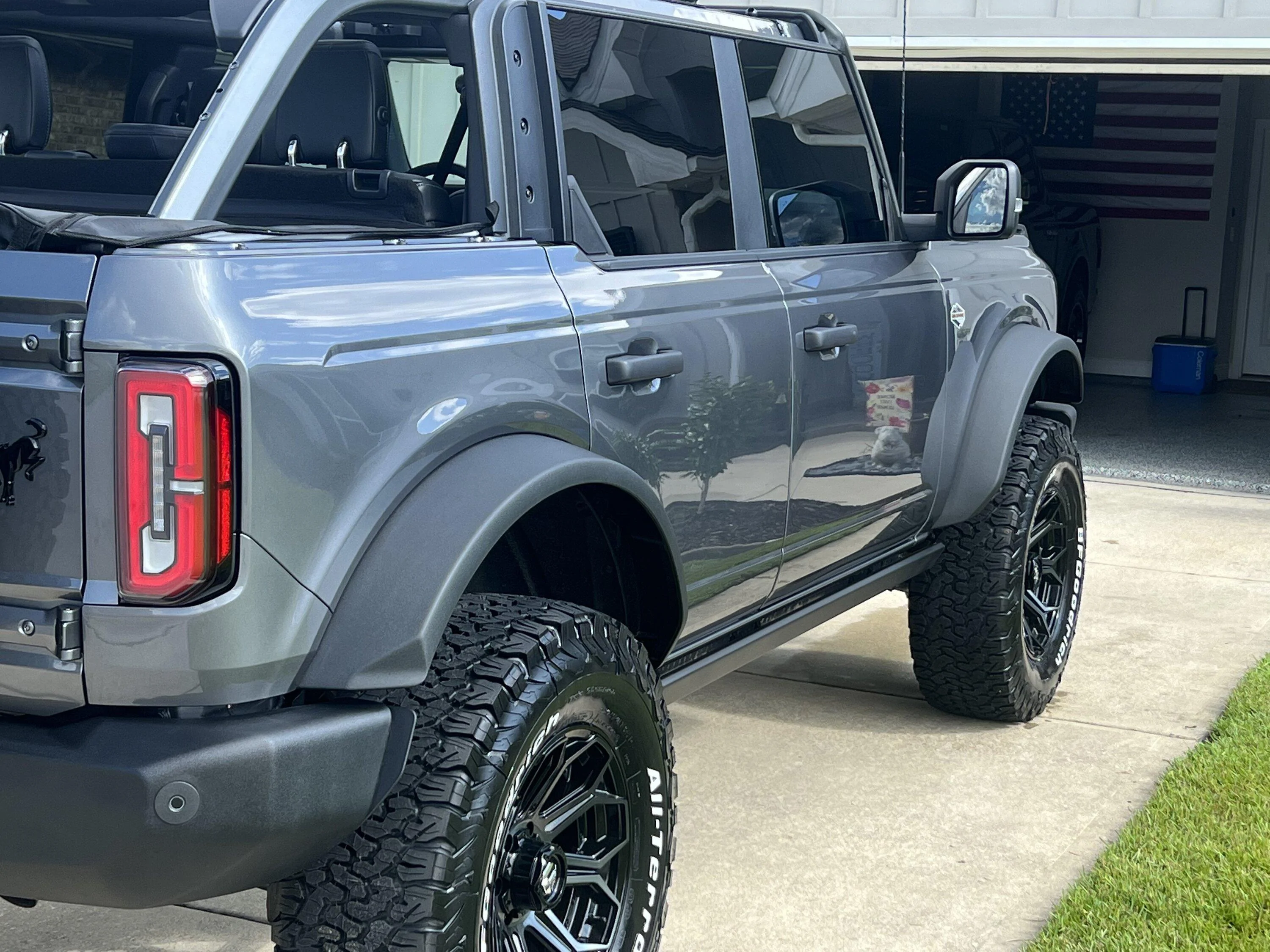

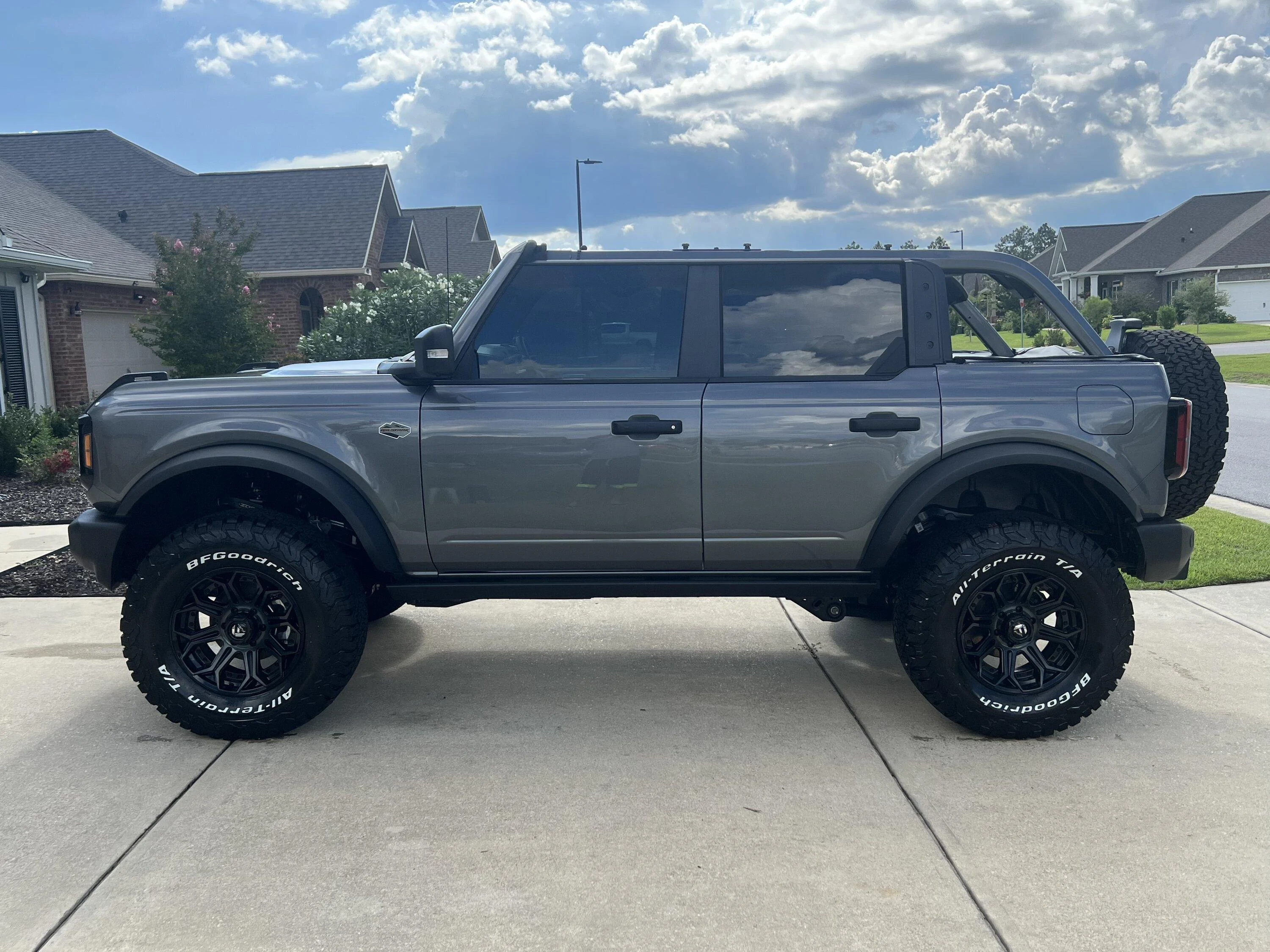

90Bronco19
2021 bronco outer banks
Motegi trail lite wheels 17x8.5’ +18 offset 4.46” backspace I believe.
Nitto terra grappler G2 D rated 37x12.50x17. 3 1/2” Rough country lift with new UCA’s
I really wanted the recon grappler but they don’t make them in a 37”x12.50x17. And I did not want to upsize the rim diameter.
fit nice no rub at all city driving or parking (crash bars removed). Will test flex and compression to look for rub but everything looks like there is plenty of room.

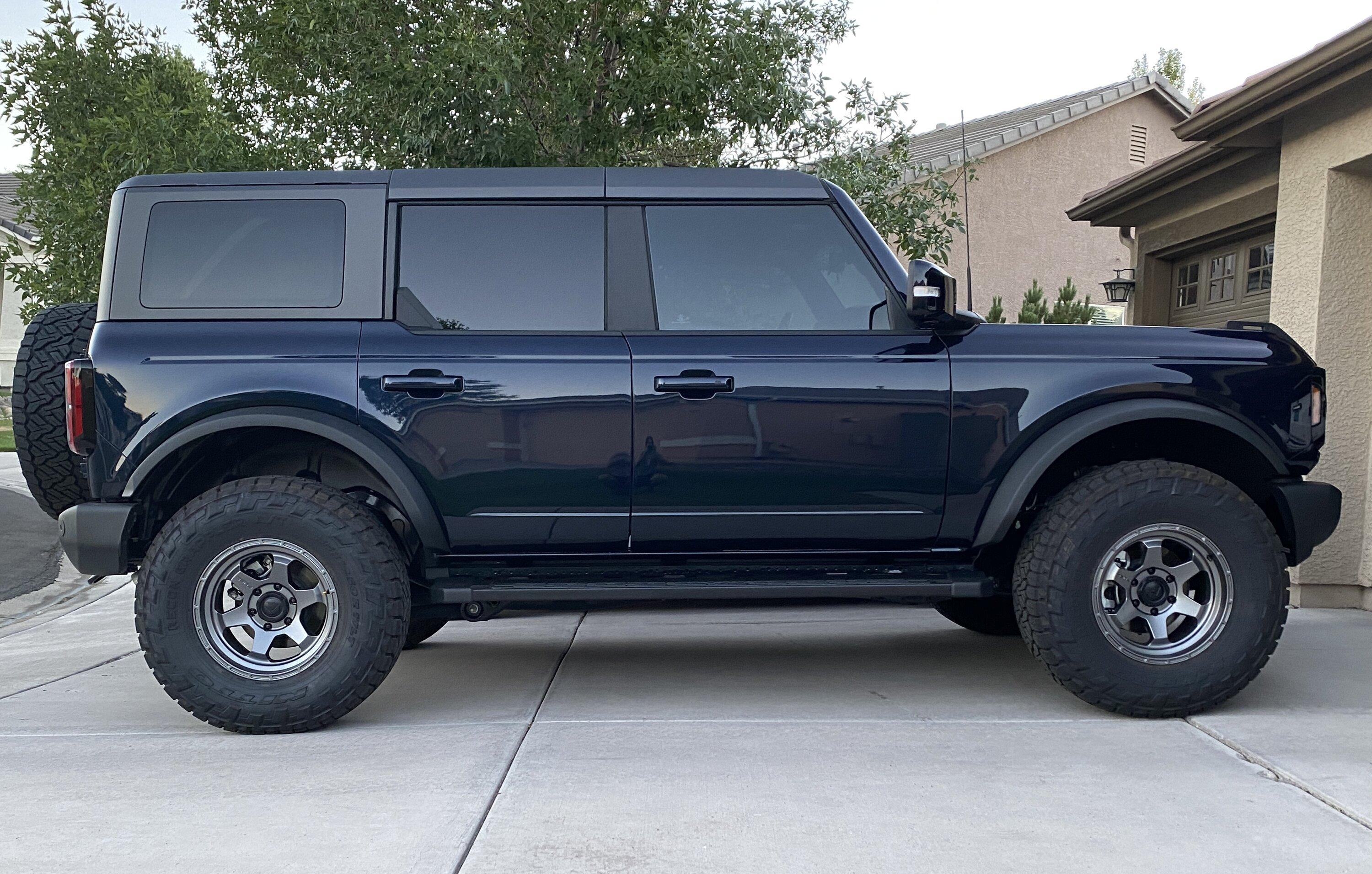

Covey427
Jul 20, 2022
2022 Bronco
20” Mayhem with 37-12.50 Nitto Ridges.

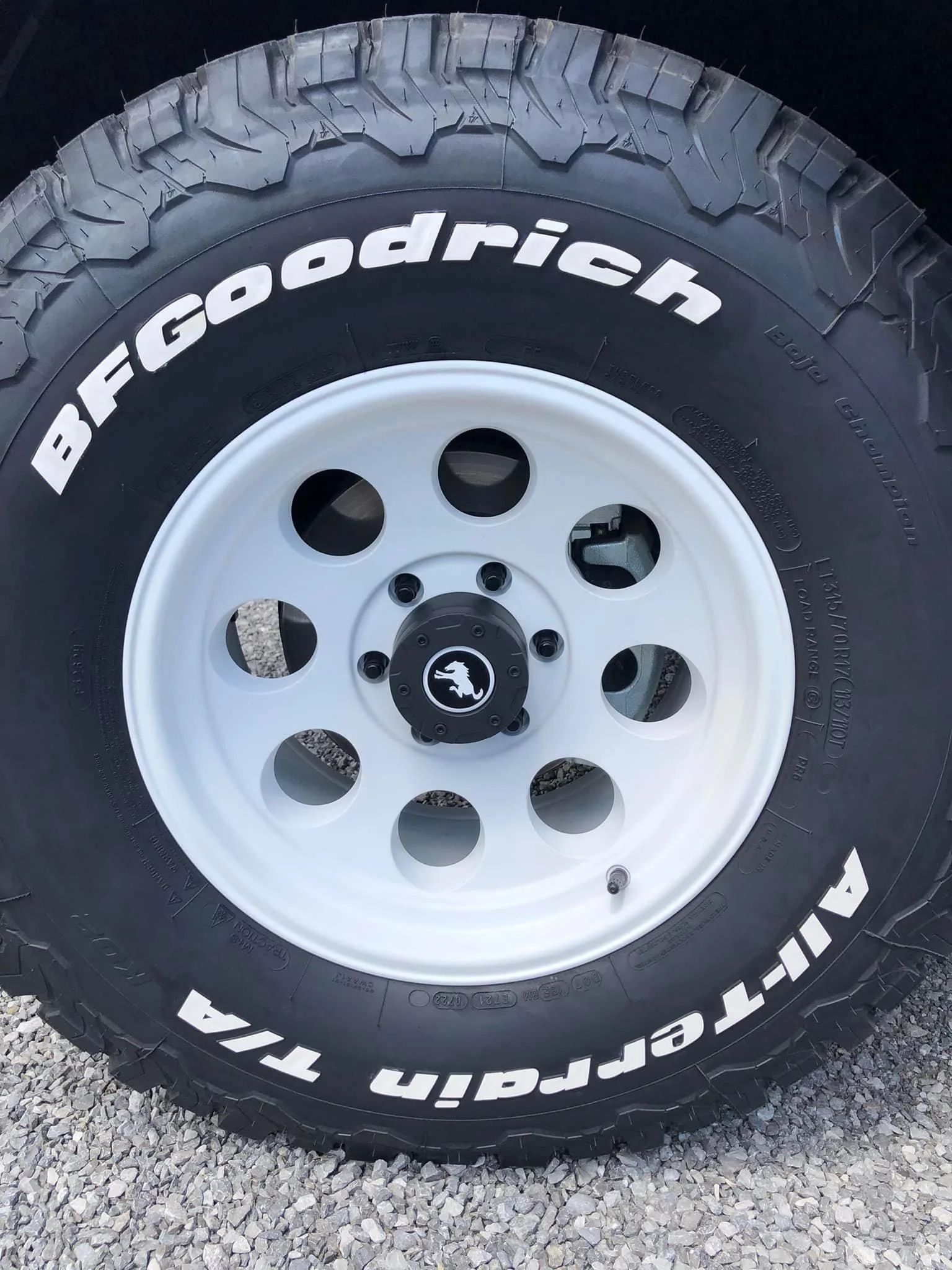

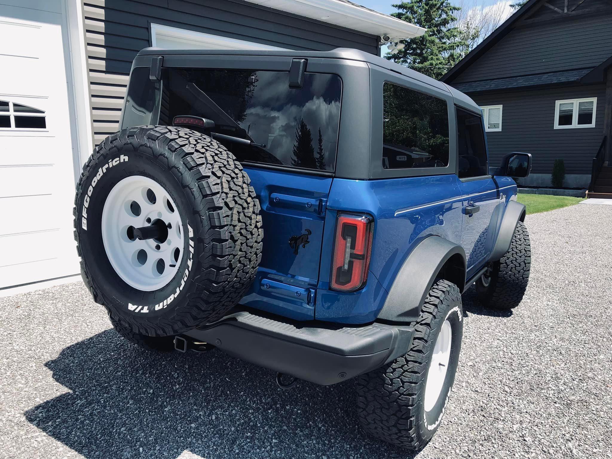

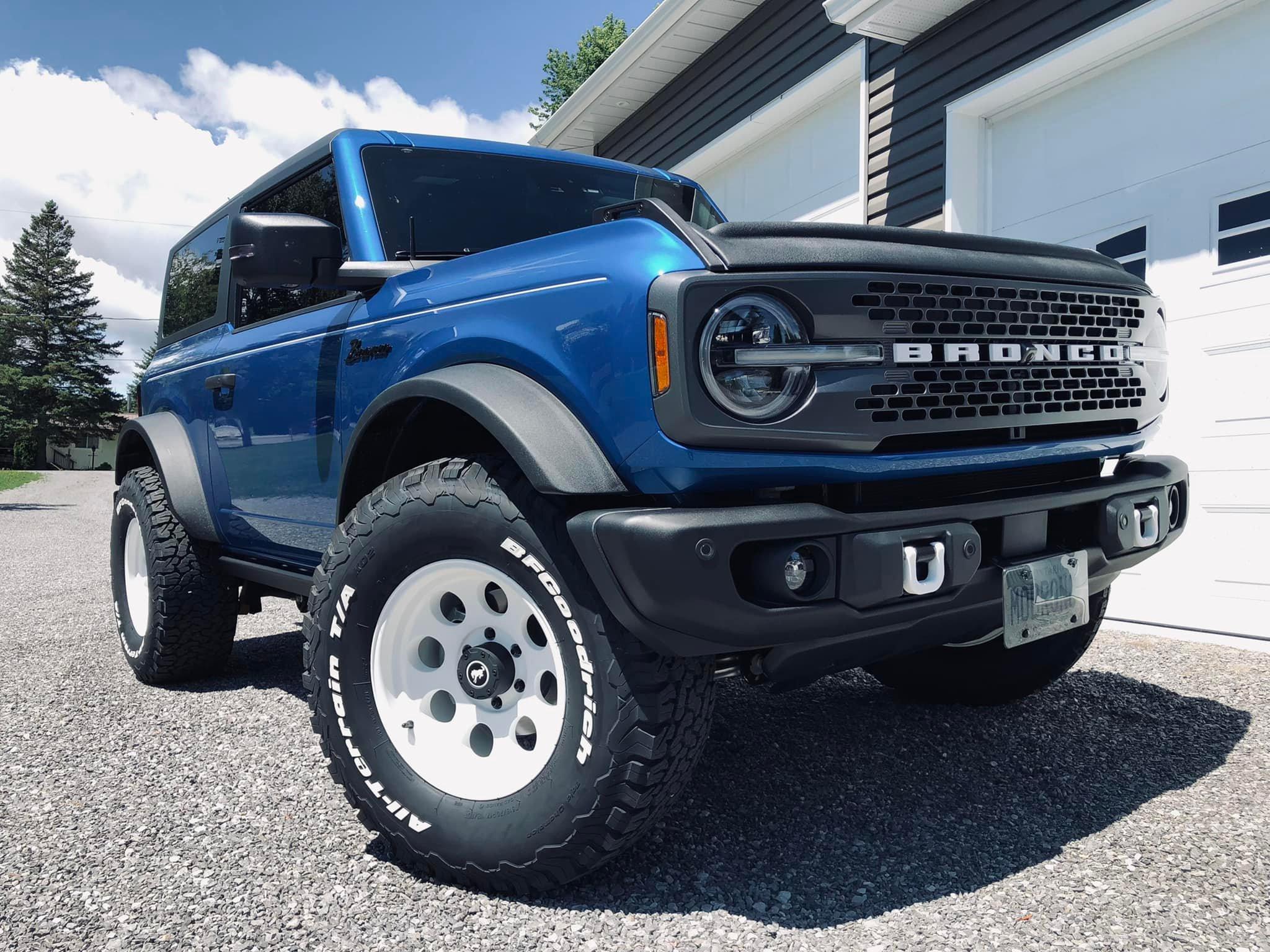

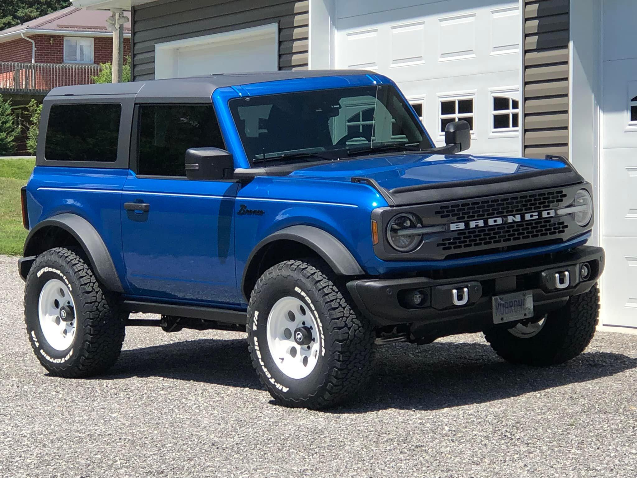

Thanks @BadBlueBronco for the idea...
Have too say I'm loving look and the drive feels a bit smother then stock.
Replace the sas wheels /rubber with these Pro Comp 69 Series Vintage Wheel, 17x9 with 6 on 5.5 Bolt Pattern. and some BFG K02 315/70/17.
Gained a bit of poke too which was nice !
Had a friend make me some Custom center caps to match

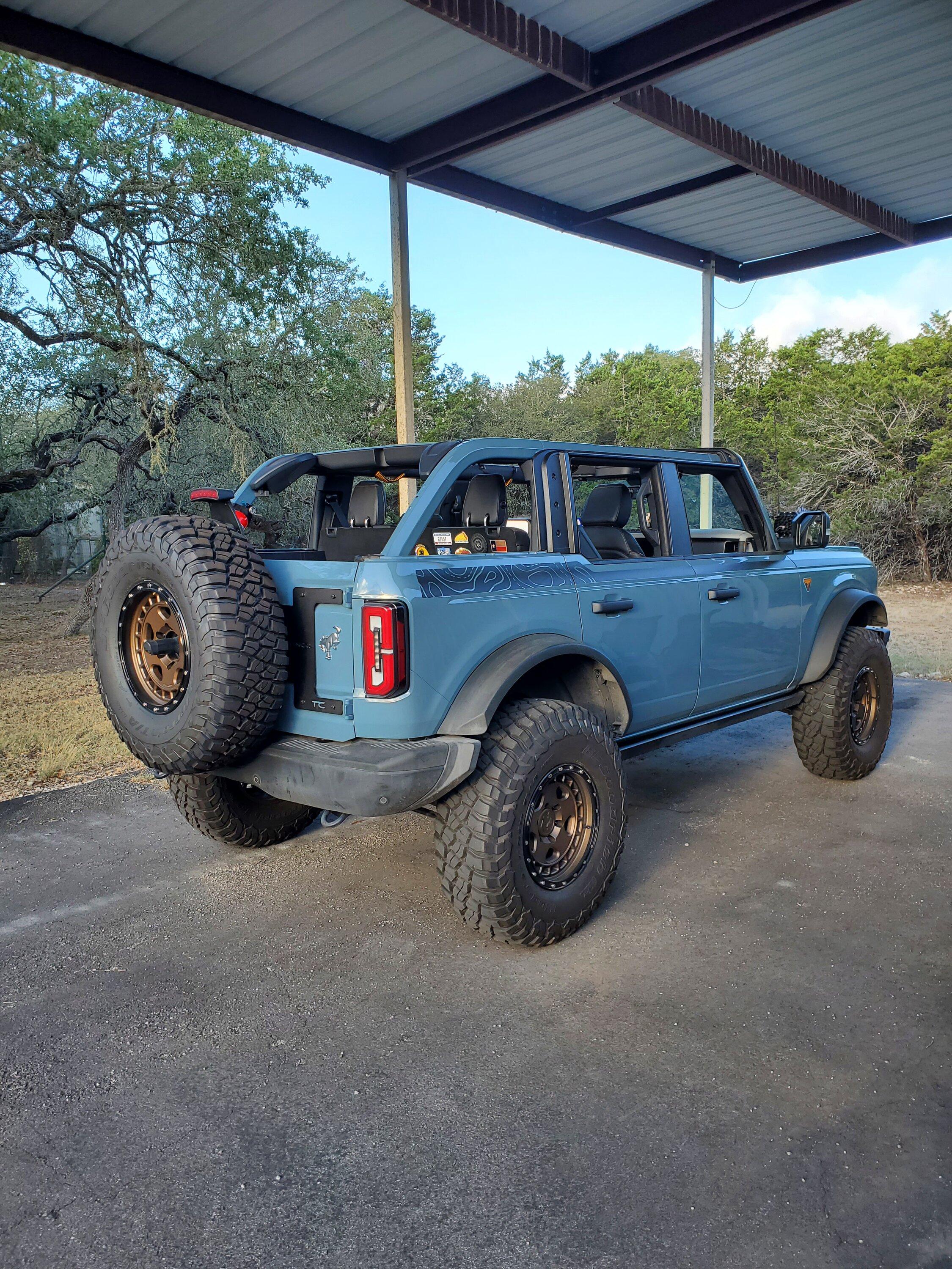

Vehicle Showcase

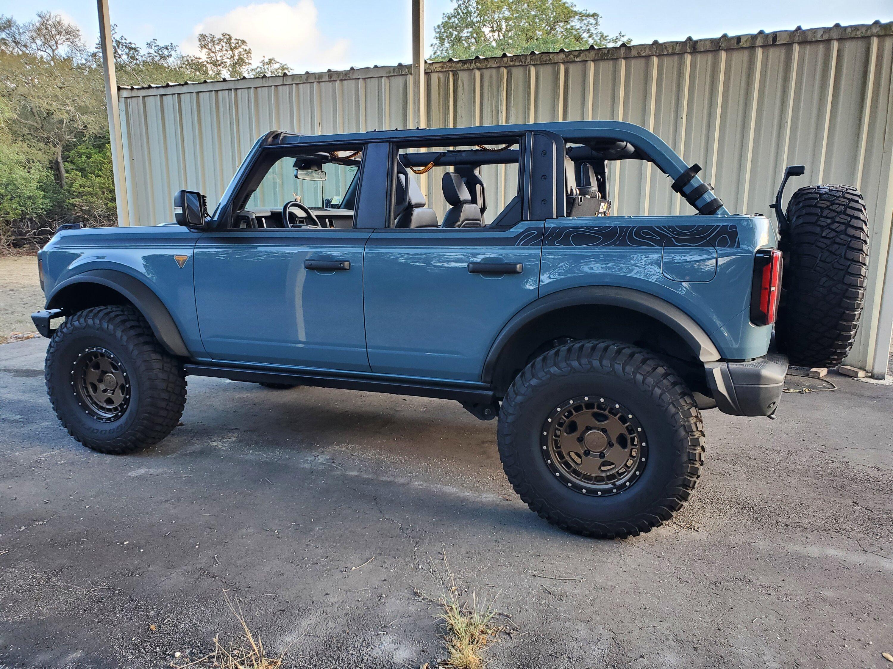

Wheels: Fiftenn52 Turbomac HD
Tires: BF KM3 37"
Lift: Zone 3"

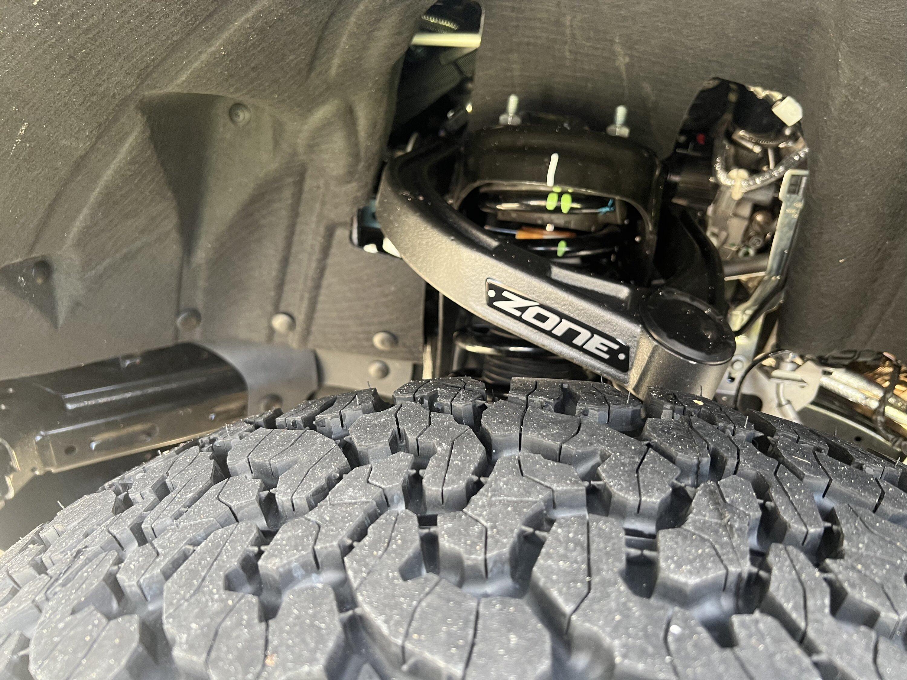

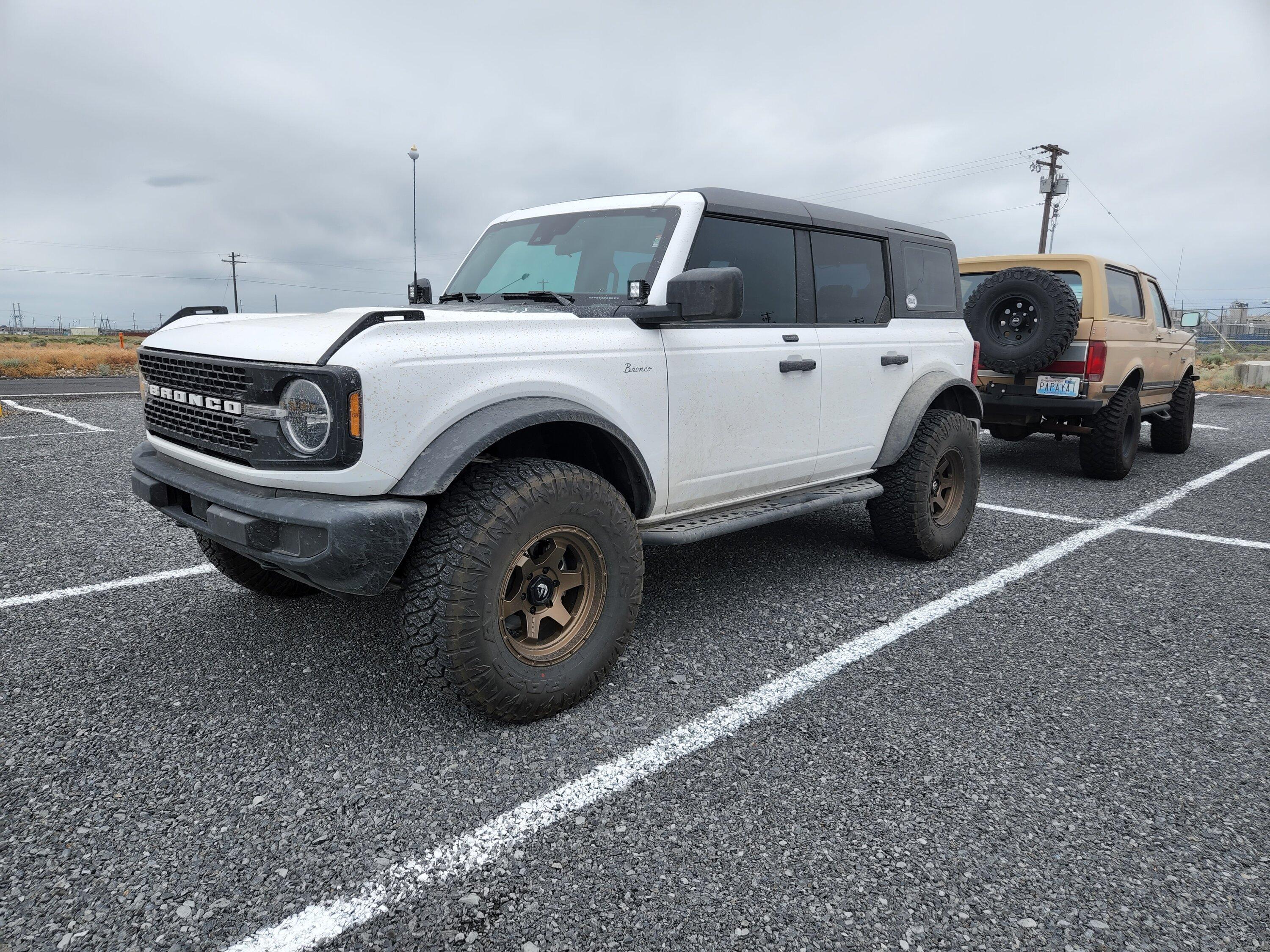

Hello,
I spent months in here looking at pics trying to figure things out. Hope this helps the next guy/gal in the same position.
2” Zone w/UCA’s
18x9 w/ 0 offset
35x12.50
Did you buy a third brake light extension for this set up? What is the wheel model you got? I'm assuming you had a non-sas? This is the exact look I'm going after.
