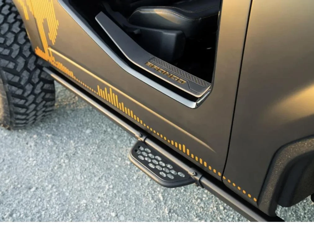

I’m getting a badland Sas, so 35s on it. I know this will be pretty tall for my kiddos and possibly wife. As many of you know it comes with rock rails. Does anyone know if there are aftermarket steps that would connect to the rock rails or any other suggestions?

Ditto. Reading other posts nothing else. Sadly Ford themselves showed something like go rhino D2 steps attached but do not exist. I want the tube doors now also Ford. My badlands SAS coming in 2 weeks and my 5 year old will ummm jump otherwise

Those Go Rhinos don't look too bad. I'll be removing the rock rails on my Badlands '22 because I won't be doing rock crawling (not in near future at least) and mainly because it seems like Ford have made it so that we can't affix their mudflaps as long as there are rock rails in place.

My wife had trouble getting into the Bronco, so I plan to get the Rock Slide Engineering rock rail steps. Both a strong rock slider and a good step. Not cheap, but the they won't bend like the Go Rhino steps are likely to do if actually up against rocks on the trail.

Go Rhino DSS added to mine!just for the wife and kids😌

I like the Rockslide, but that’s a lot out of the budget. I’ll probably get the DSS from Stage 3 for my Badlands. I’m assuming they’re not fully legit sliders, being bolted on. I was comparing prices, and they were ~$100 cheaper than others, with free shipping.

Of course they do. Thing is, rocks don't just hit from the bottom. That's easy. They also hit from the side. If you're on the trail and driving around rocks that you don't want to drive over, that are bigger than you want to drive over, then you can drive next to them and possibly pivot off of the rock, and the force of the rock will be on the outside edge of the step. That will require a very strong step, with a good mount to the frame, to not bend up.
Coming from years in the Jeep world, we've seen plenty of steps bend. Since on the Bronco these types of steps are being mounted to the body, rather then the frame, there is potential to do body damage which could be hard to repair. My point is that for those who bought Badlands, with lockers and sway bar disconnect, and factory rock rails, who will most likely be tempted to use the Bronco for what it was designed to do, those wide steps mounted to the body are a risk. In the Jeep world, folks who have steps like those don't actually wheel, because the folks who really do wheel don't have steps like those. Wide steps mounted to the body scream "mall crawler".
Your money, your Bronco, do what you want. Just sayin'.
