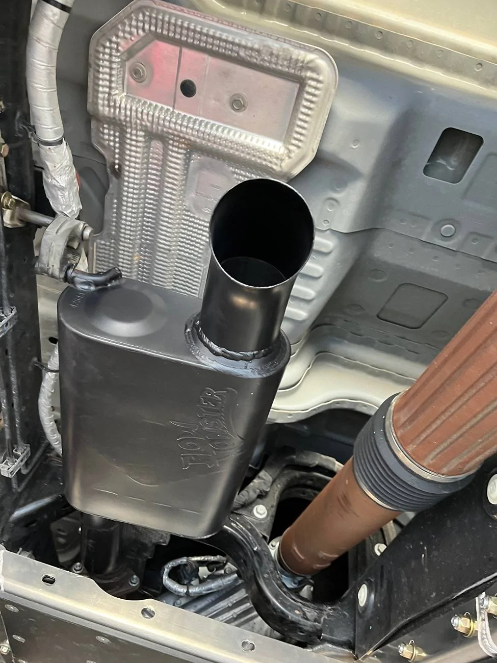

Yeah. Definitely doesn’t sound abused. I figure its either water in the fluid or some heat related issue. Do ya’ll have a custom exhaust that runs near by?
We have this guy but it’s all factory by the transfer case and not under the skid. Though maybe there would be some benefit to wrapping the exhaust that is under the skid, now that you mention it.
