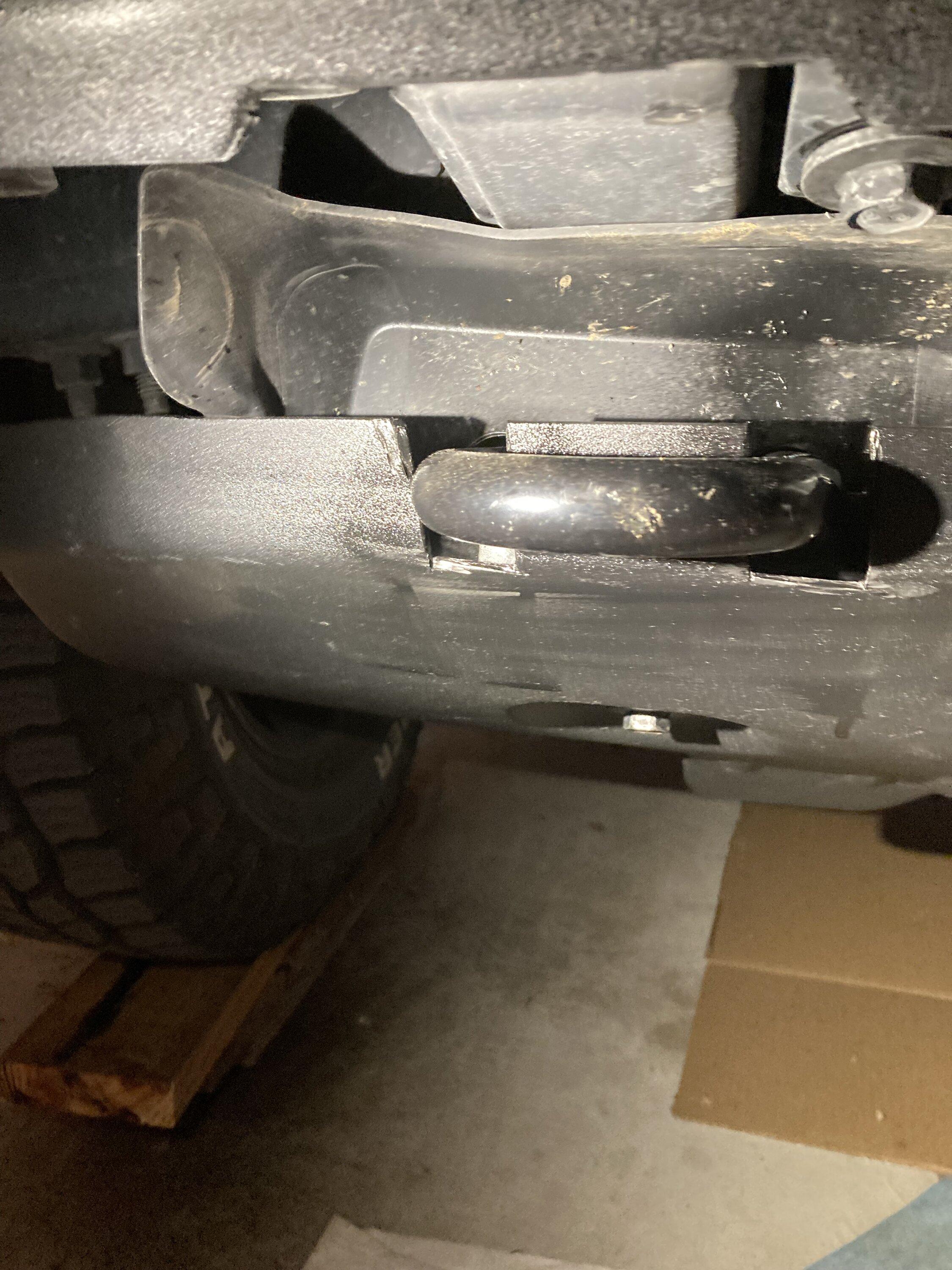

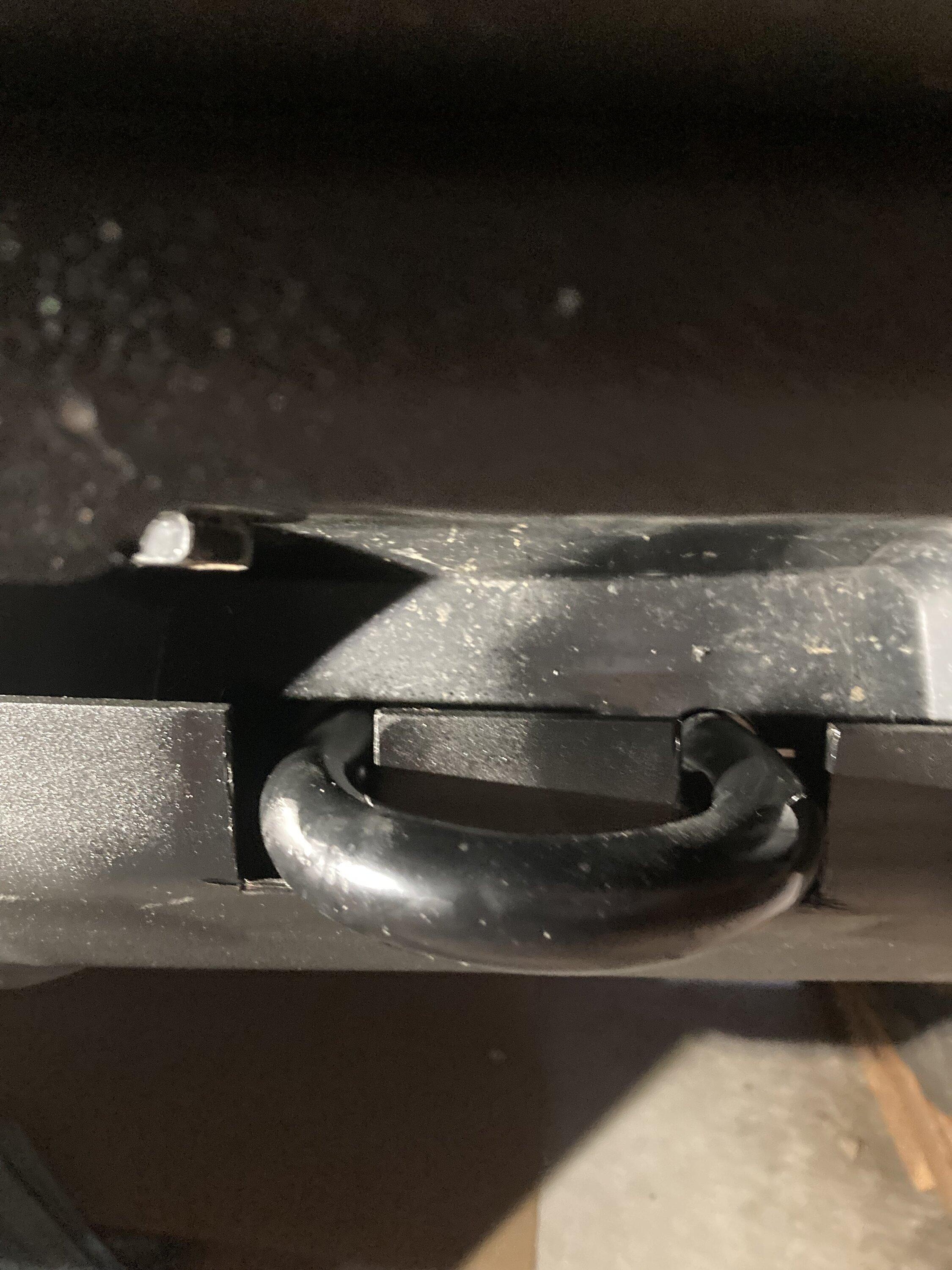

Can they swap? Yes. If you have the plastic front bumper you will either need to replace your intercooler mounts or shave off the hooks. The first skid is the Front skid, followed by the Engine skid.
well I got it mounted ,did not have to shave off the hooks or replace inter-cooler mounts.
what I did have to do is cut some slots on the bash plate . did that with a dremmel tool and metal cutting blade , took all of 20 minutes . now I have the bash plate mounted and waiting for the engine cover mount from IAG performance .
