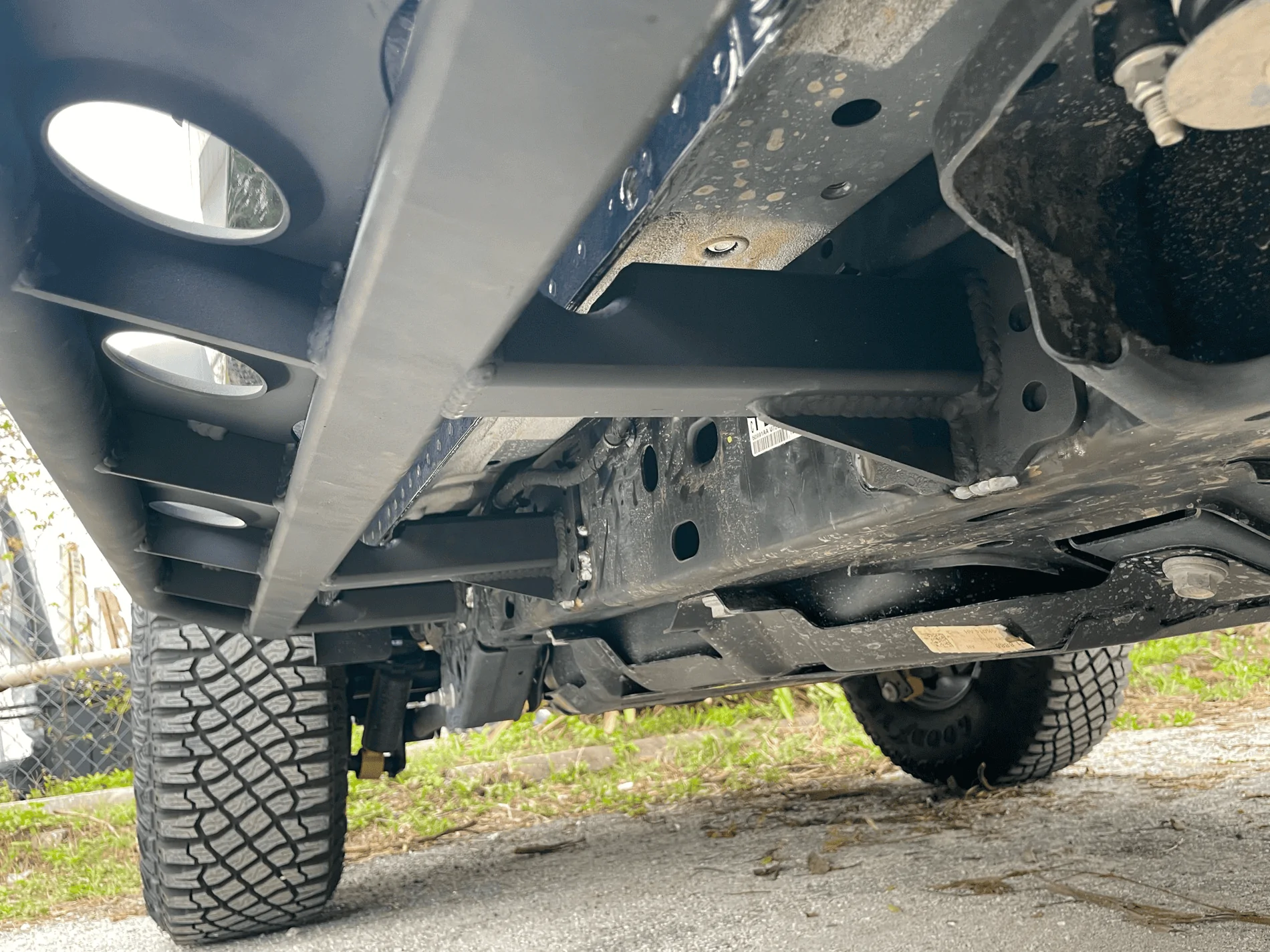

dumb question - I know that securing (bolt or weld) to the frame is THE way to go for a true slider. The factory sliders on the BL are rated at holding 1.5x vehicle weight (so Ford says), If any "slider" mounts to the same points as the factory items, why are they not good enough for sliding?
for that matter, most every manufacturer has not created anything that will attach to the frames by bolt or weld, seems odd that with so many experienced offroad MFGs that there is virtually nothing.
My biggest concern with the one or two that are frame mountable, is that I would only weld them, I wouldn't want to pierce the frame tube unnecessarily, I am in New England and I've yet to find an aftermarket slider for my JK that survives more than a couple of winters, needing to replace a slider after a few years that was welded on seems like I am creating another ordeal for down the road.

pic of what I think are SRQ sliders welded to a Bronco
Ford Bronco Sliders - why are there virtually no frame mounts? 1641216390893
