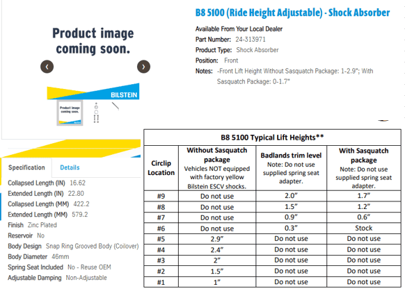

Excuse my nerdiness-
Here are the specs comparing the Bilsteins/OME. The Bilstein 6112 fronts sit between the OME medium and heavy, and the rears match the medium OME springs.
I can get the Bilstein 6112 kit for $1540 https://www.suspensionlifts.com/sho...t-coilovers-shocks-for-2021-2022-ford-bronco/

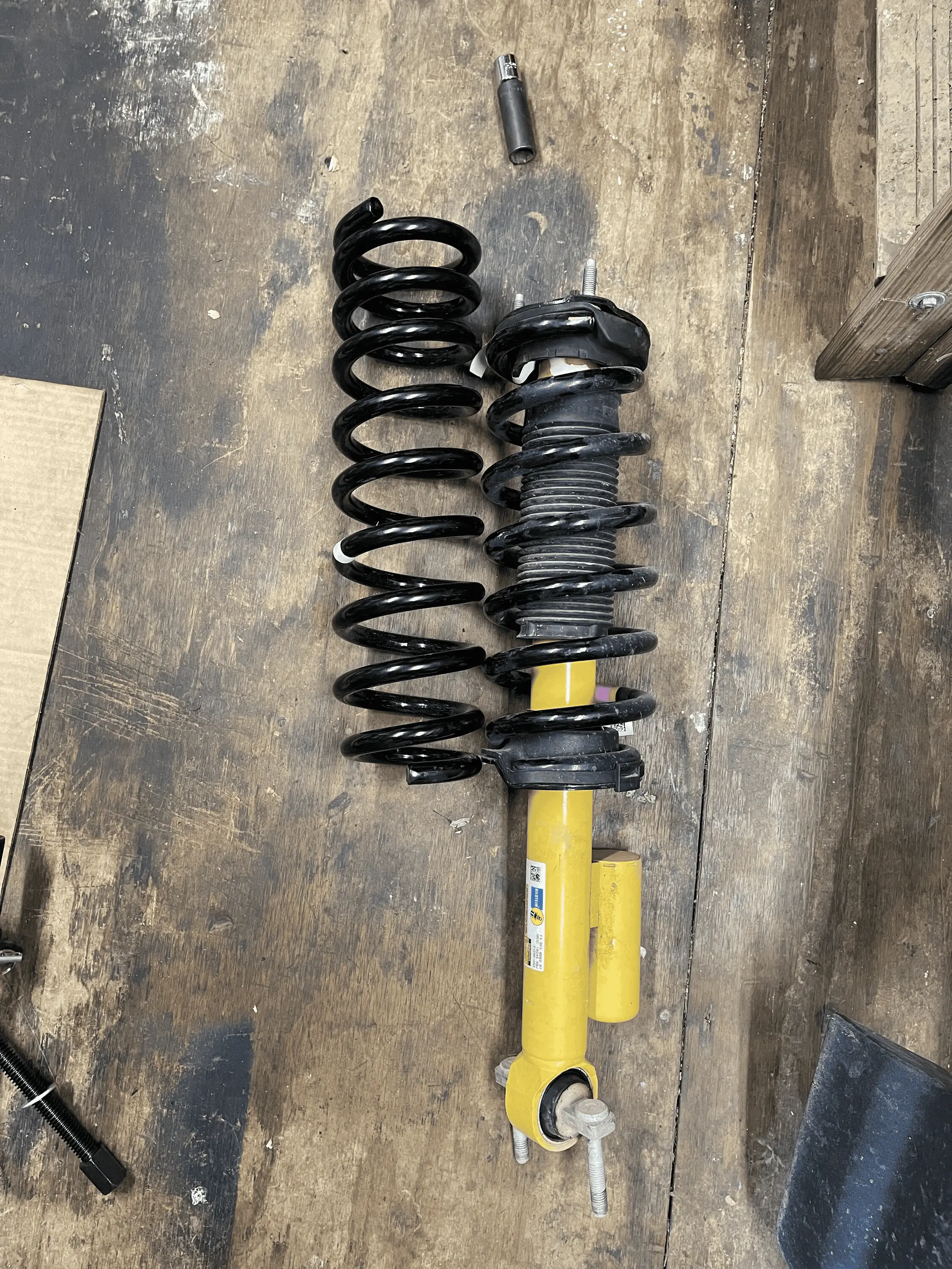

The issues with knowing the spring rate is needing to know the length of the spring. So guessing the 6112 are most likely near SAS bronco length which will make them shorter than OME. Went and dug up this old thread and you can see the OME springs are longer than SAS.
Ford Bronco Snacktime's 5100 Bilstein Shocks review & takeaways 1665695508492
Issue is you take two springs of the same stiffness, if one is longer it feels softer. Age old cutting springs to drop cars makes them feel stiffer. So without knowing the length they could ride very different.
Hypothetical and based on assumptions:
6112 are using the released 6100 shock for SAS only so they are designed for SAS length springs which are 3-4" shorter than OME(assumption). The provided springs with the 6112 should feel closer to heavey OME and actual act like a higher spring rate due to being a shorter length.
I would say your looking at a springs designed for bumpers and added weight? I need to go find the factory SAS spring rates and take a look.

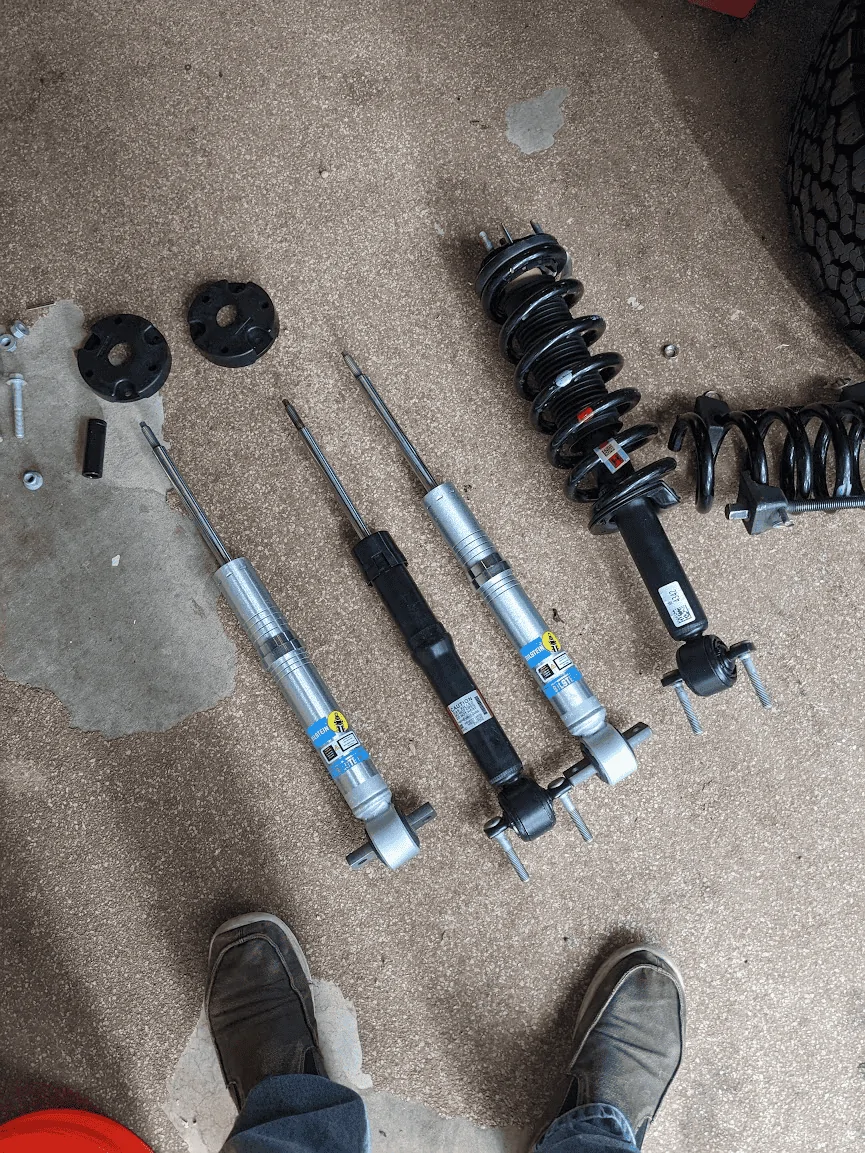

The compressed and extended lengths of the OME shocks are very similar to the 5100s/6100s. My question is how much of difference there is between SAS and OME springs when they are off the shock? I don't know.. and I am assuming I am wrong that they might be the same length?
Specs on front OME shocks are
  • Open Length: 22.64 inches
  • Closed Length: 14.96 inches
Bilsteins are 22.80 extended, 16.6 compressed..
Longer springs would imply longer extended shocks? The OME shocks having a shorter closed length does make sense with a longer spring...
Tell me to leave your thread if I am going to far down a rabbit hole. I just appreciate the discussion.

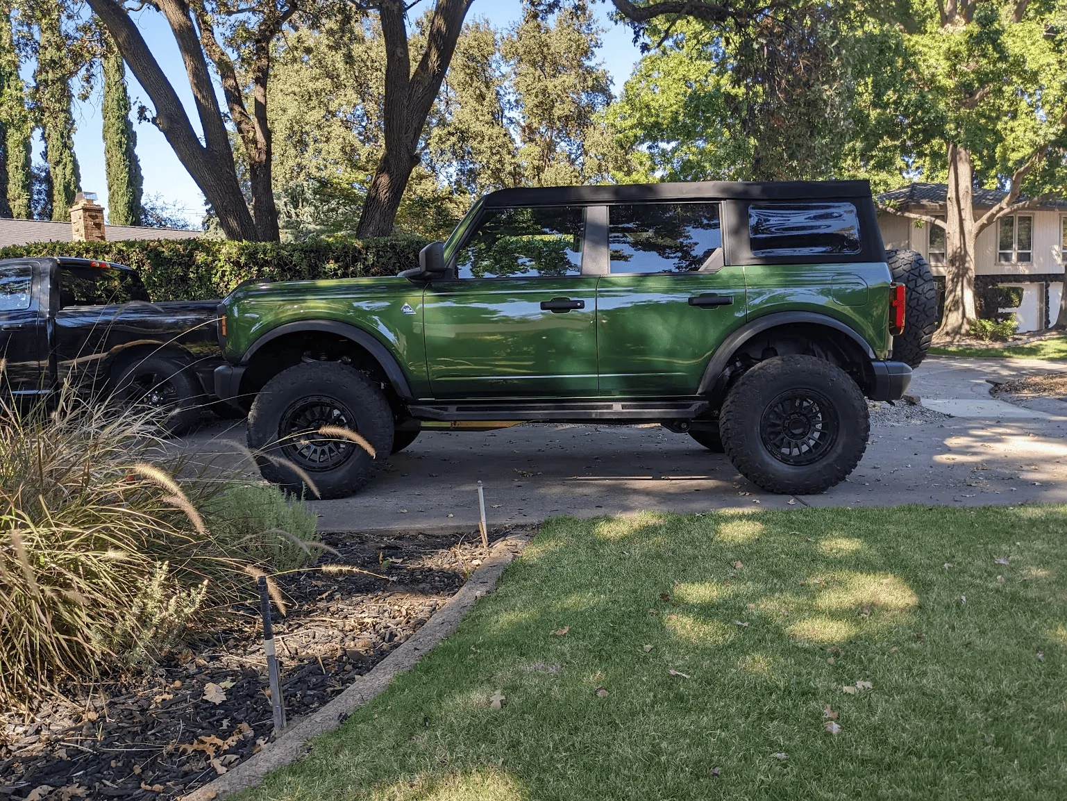

I think it looks fantastic!! I really need to make a decision on leveling/lifting my Black Diamond because this look is just too good.
Off topic question… how do you like the MetalCloak skids? Any complaints?
Here’s my Black Diamond with same 5100 at max lift

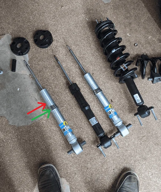

Bellow you can see I marked the strut with a Red arrow for max height with SAS Springs and Green arrow for hitachi max height setting. Hitachi spring are longer and lower spring rate and feel softer. The SAS springs are shorter and stiffer. Both work on the 5100's and provide the same travel. The difference is how the spring is designed to work. As you load a spring with weight it compress and becomes stiffer(depends on spring design). So shorter stiff spring doesn't need to travel as far to support as much weight.
Ford Bronco Snacktime's 5100 Bilstein Shocks review & takeaways 1665697192245
You want a stiffer spring with heavy tires paired with a large shock to slow down the movement. Long soft springs feel like a vehicle is floating around as energy is dissipated from the springs moving side to side (when over loaded). The shorter springs will have less lateral movement as they compress and unload(feel stable). On the SAS bronco the shorter coils are to allow the lower reservoir to be shock mounted and a design constraint. Its a giant mess trying to figure everything out. Feels like a huge contradiction.
Simple way to explain is short and stiff to go fast, long and soft to go slow.
OME is just closer to the Hitachi design with a longer spring. OME has always been more geared towards running a heavy rig with bigger tires. Longer springs allows more compression before binding so fully loaded your suspension can still travel. I would say be careful running to stiff of a spring, you will ride high and like a stiff old 1 ton truck.

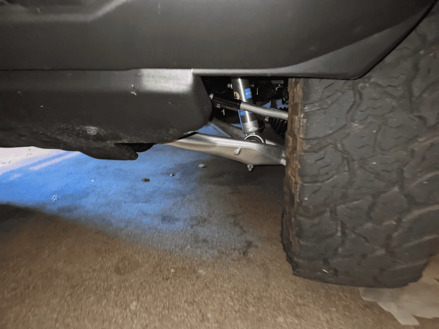

Haven't changed anything other than bigger tires. I went from a 67lb 35" tire to a 68lb 37" tire. I still want to drop the ride height for daily driving but for wheeling high as possible is still the best answer for the trails I like. Working on adding bumpers so that should lower me down.
I have no issues keeping up with SAS shocked Broncos. With coilovers equipped broncos they run away from me, plus I tend to lift a rear tire when they keep all 4 planted(I don't unhook my sway bar). I would like a softer riding shock but damn the 5100 do an awesome job with stability on crap roads. Hitting off center joints on the freeway use to be wild with Hitachi shocks and 35s, very happy not to have that issue.
I wouldn't run spacers if you want to stay in safer tie rod angles. The spacers definitely take you out to the danger zone of needing to be more careful.
