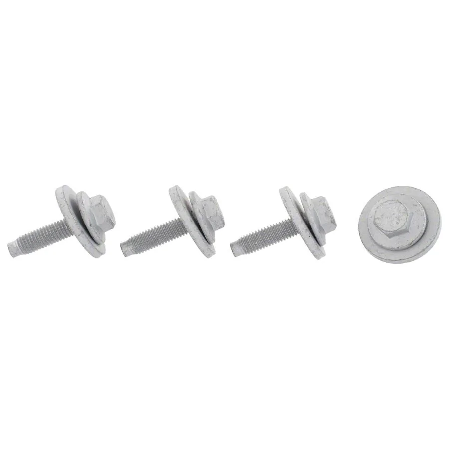

Also, Order these 4 Bolts to Mount the bracket to Vehicle. About $7 each.
Hardware - Miscellaneous.
Part Number: W707288-S442
Supersession(s): -W707288-S442; W707288-S301; W707288S301; W707288S442
Ford Bronco Softop Alignment W707288S442-FRO
