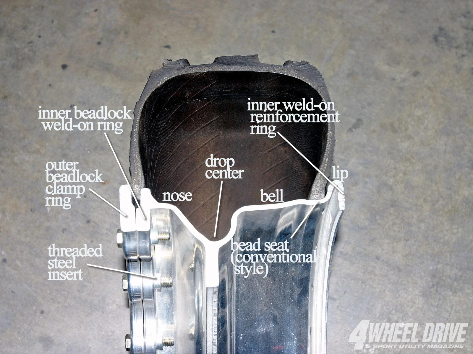

The rim goes inside the tire and the beadlock ring clamps outside of the tire. It's a tire sandwich.
edit: Found this picture. Not a Ford wheel, but you get the idea
Ford Bronco Someone please explain how the wheels work? sg%2fB%2fzg&riu=http%3a%2f%2fi.imgur.com%2fhdRsnSw
Normally the tire goes inside where it says "inner beadlock weld-on ring"
edit 2: Wait I think I misunderstood your question? You mean the outer side of the inner wall of the tire? Sorry I was thinking you meant the inner side of the outer wall. Now I'm confusing myself and inner and outer no longer have any meaning.
