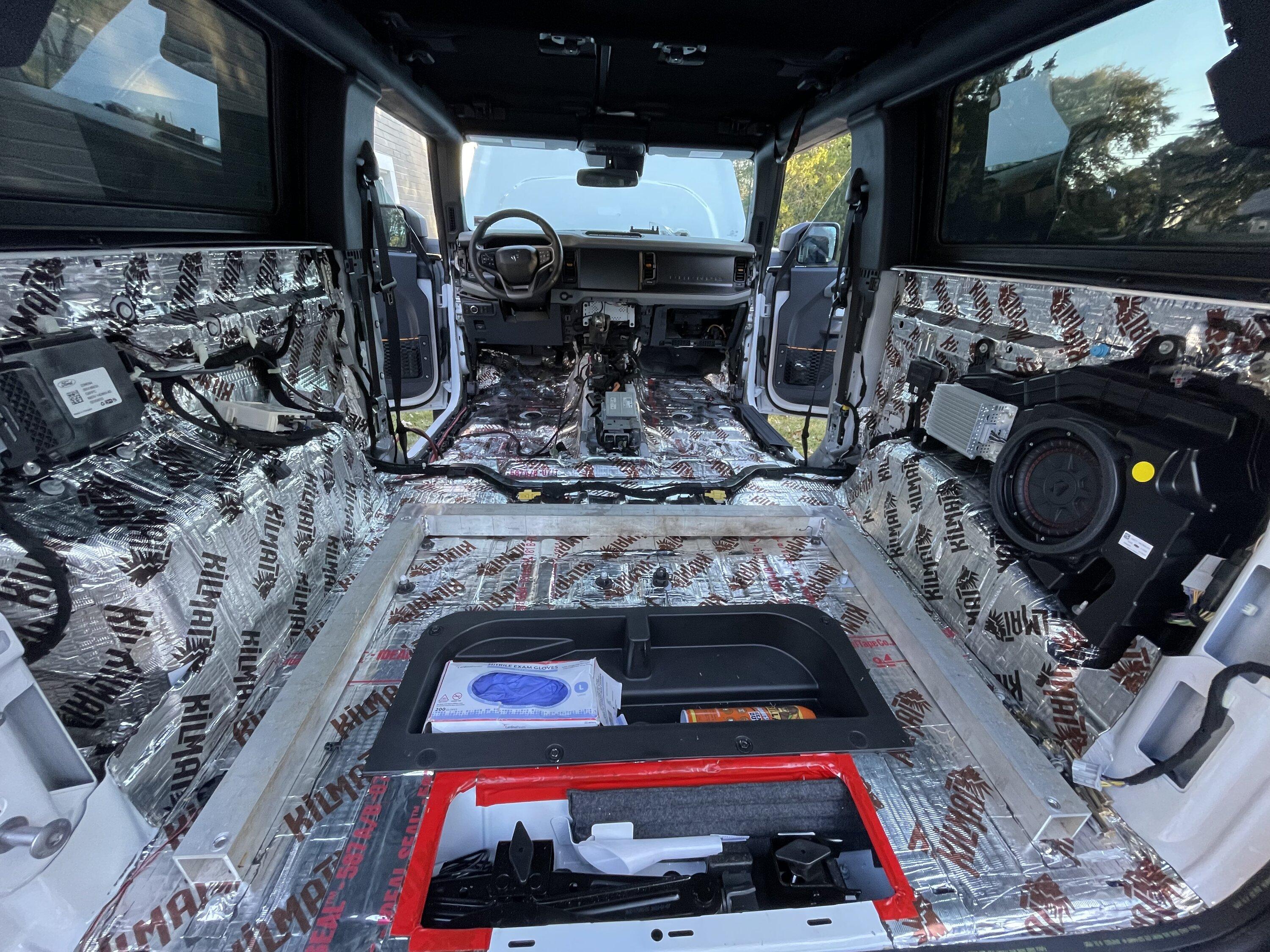

I wallpapered my two door with killmat.
Doing a rear seat delete also.
Tow inch riser for the four door security drawer in the back.
I did not install any in the doors...yet.
Do you have any plans to do anything similar for the roof, or has this made enough difference it doesn't matter? Awesome pic, can't imagine how much work that would be!
Nice work. Did you weigh the boxes to see how much weight was added ? That stuff isn't lightweight,lol.
