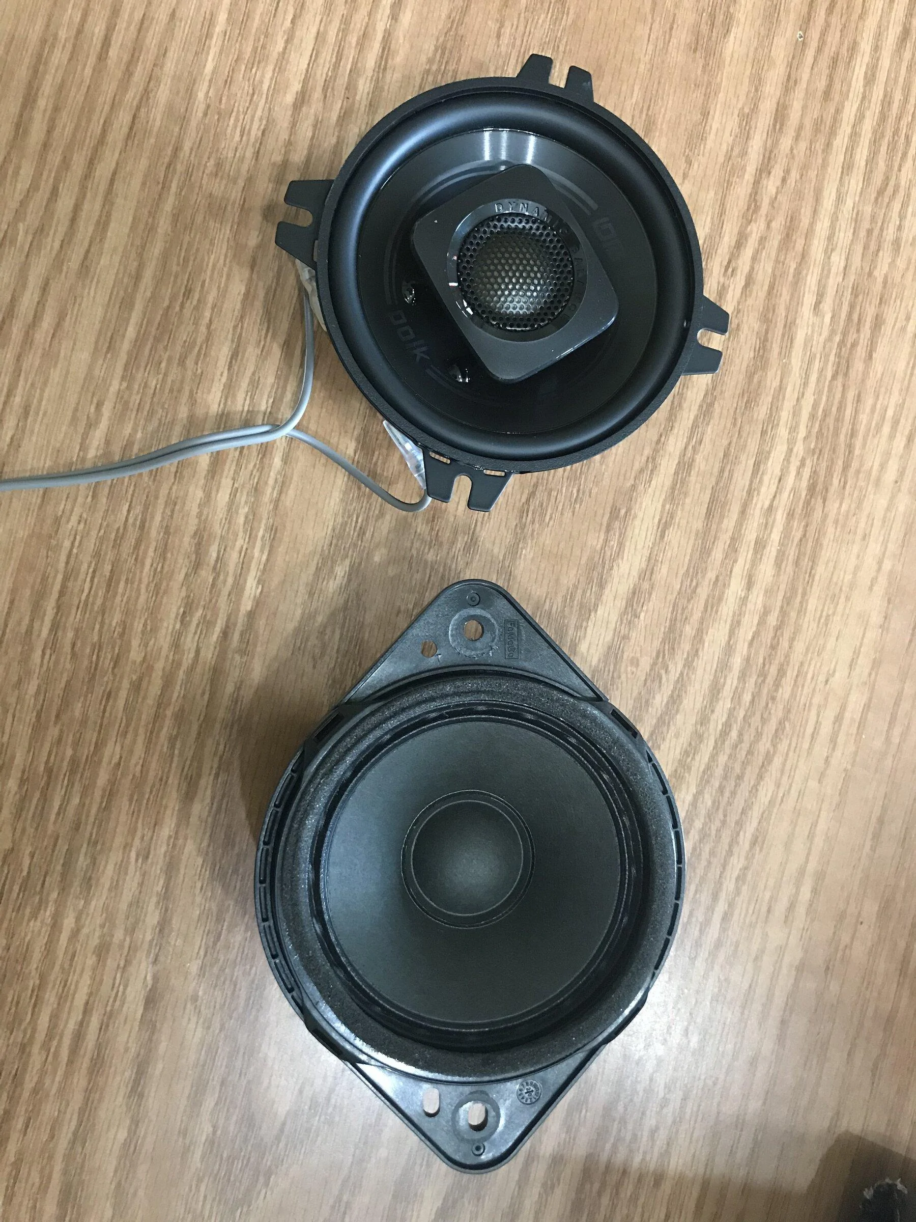

So we purchased Polk speakers for the rear; the only problem how do you get the speaker stay?! The Ford speakers was wide enough to drill in but these Polk ones are not as wide to hold. Any advice here?! Might have to get creative. The Polk speakers are on the left.

Maybe a really big washer, would bite enough to hold them in place? Just a thought, I'm sure you probably tried that.

I believe that is what my husband is going to do. We didnā€™t think of that we purchased the Polk audio. Every video we saw, no one said they had issues or had to use washers or drill additional holes. He says I will need an amp, any recommendations?
Add some new holes? Rotate the new speaker a little to get a clean area for new holes. Cover or fill in the old holes.

Why are you trying to use the Polk covers and not the factory covers on the pods? Just mount the new speaker in the hole and snap the pod covers back on.

Because they look cool and I thought they would fit. But no biggie we will just use the factory covers. We ran into a problem with the 6.5ā€ speakers. It did not come with an adapter and we didnā€™t know we needed one until now. The problem is finding one, having a hard time locating one.
