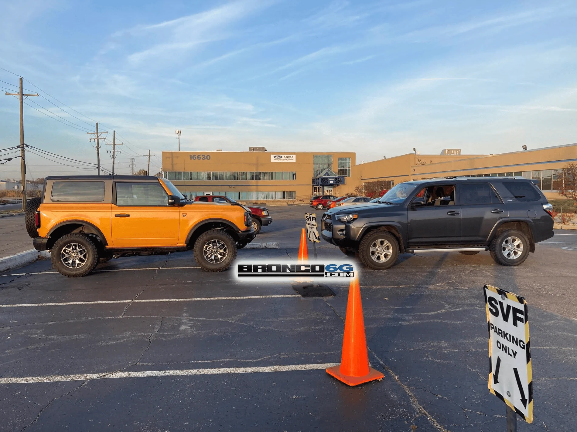

it might be one of the mules without an engineThese look good but this CO badlands looks like it has too much space in the wheel wells. Maybe it has a small lift:
i'm not sure that's a safe assumption to makeI think it's safe to assume that Squatch travel is the same as Base and the other trims besides BL.
op said about 30sec later engineers walked up and drove it away.it might be one of the mules without an engine
