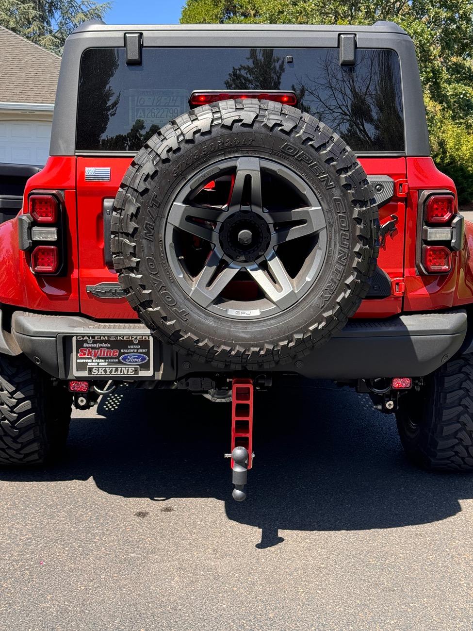

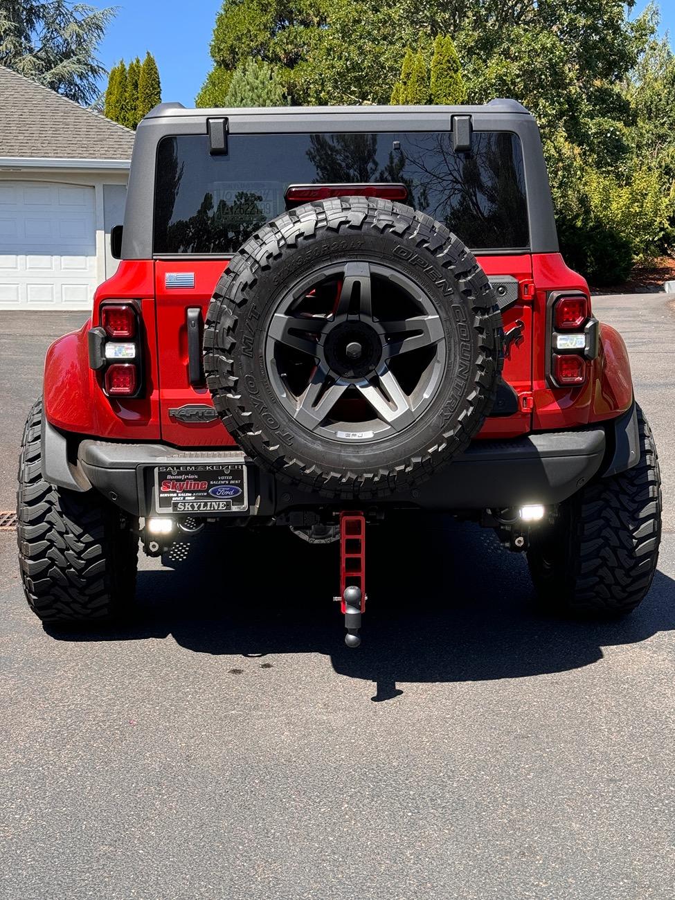

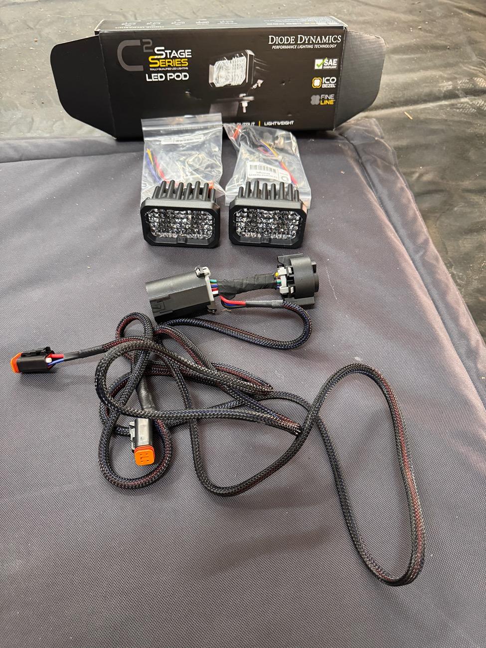

ordered the Dual LED Light Reverse Kit from 4x4 Truck LED @4x4TruckLEDs.com I selected the SSC2 Pro lights which I think look great.

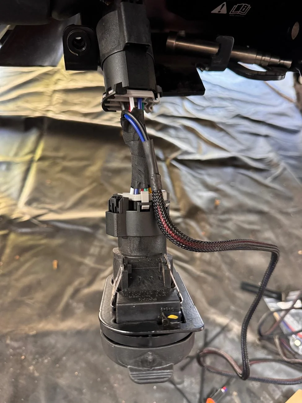

installation was very straightforward. On the Bronco Raptor I removed the trailer plug mount to get access to the rear plug then plugged in the adapter from the kit. I selected two outboard bolts to mount the brackets and then connected all the wires and tightened everything up. Looks and works great. Acts as red tail lights with the lights on. Powerful reverse lights when backing up. Lights also work with Zone lighting.

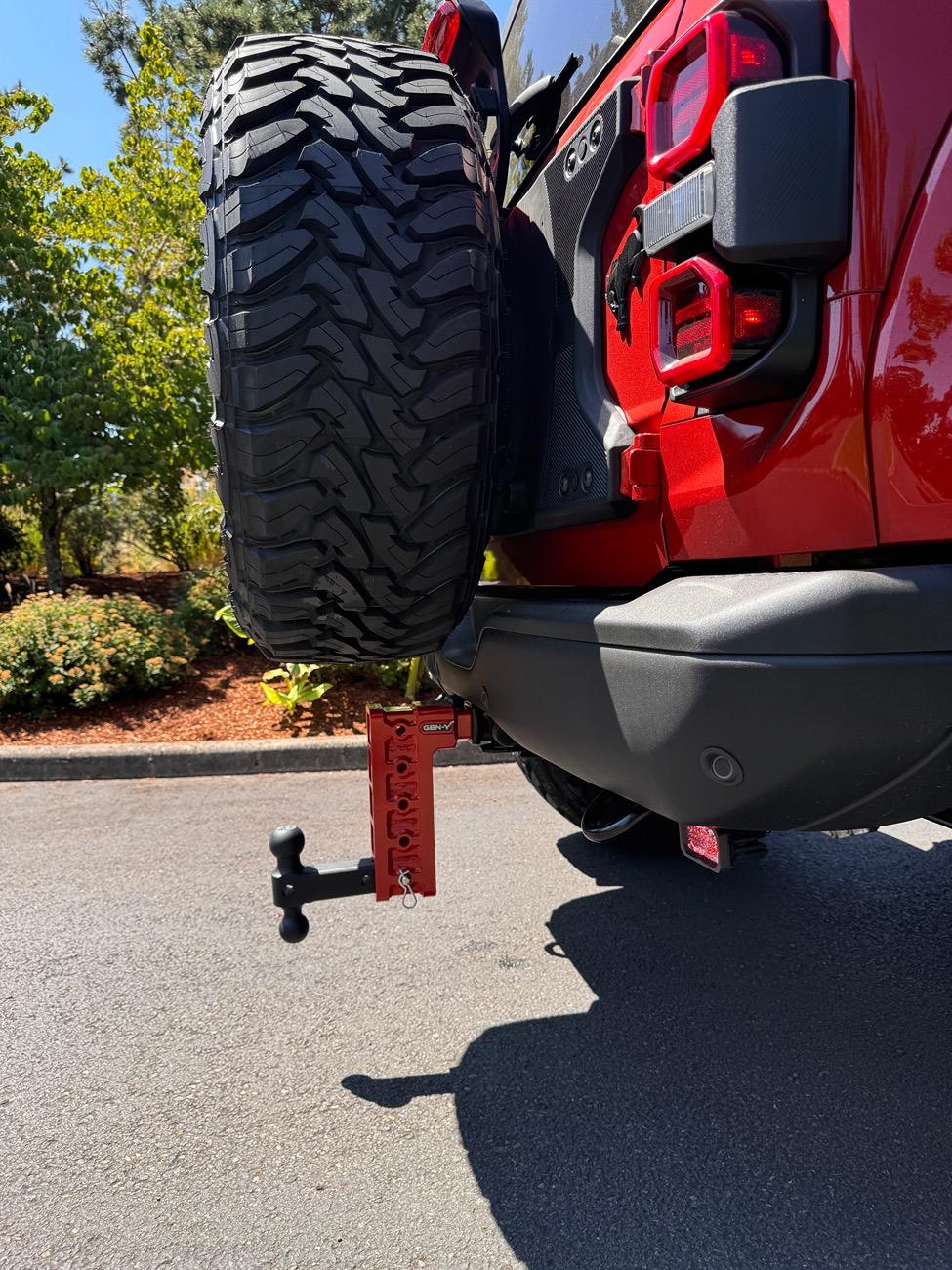

Where you have them mounted, will they come into contact when off road before the tow loops or bumper?
Always a potential for that. But they donā€™t sit lower than the rear tow hooks.
