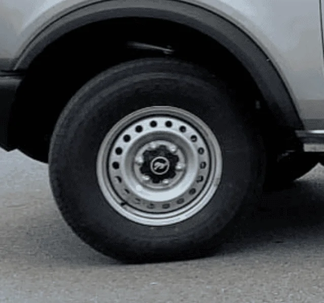

Ford Bronco Steel wheels buddies! Screen Shot 2021-03-09 at 12.18.11

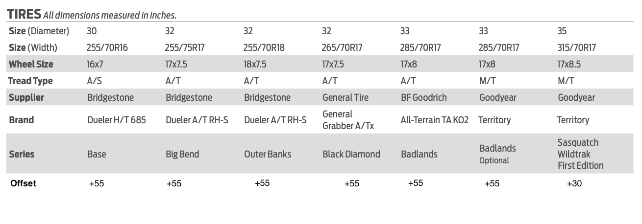

Ford Bronco Steel wheels buddies! Wheel and Tire with Offset
