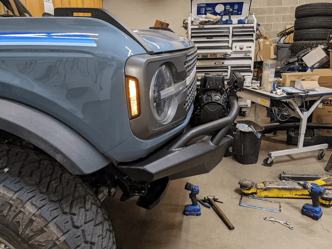

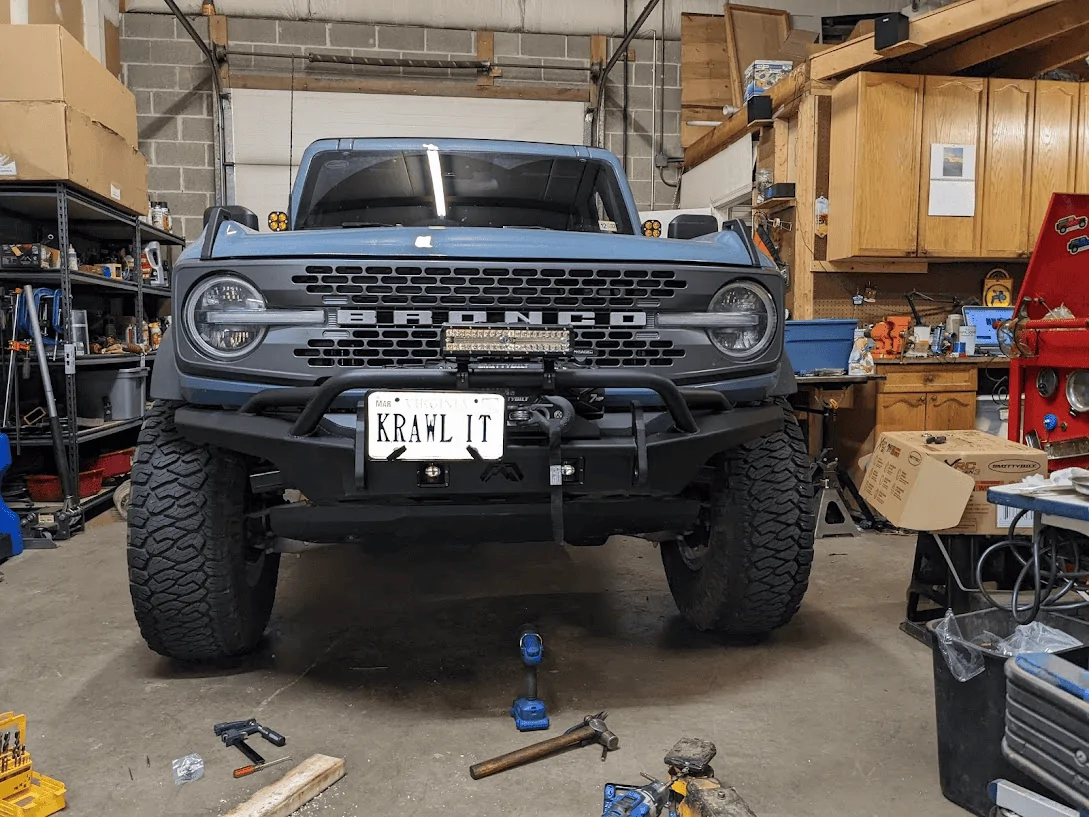

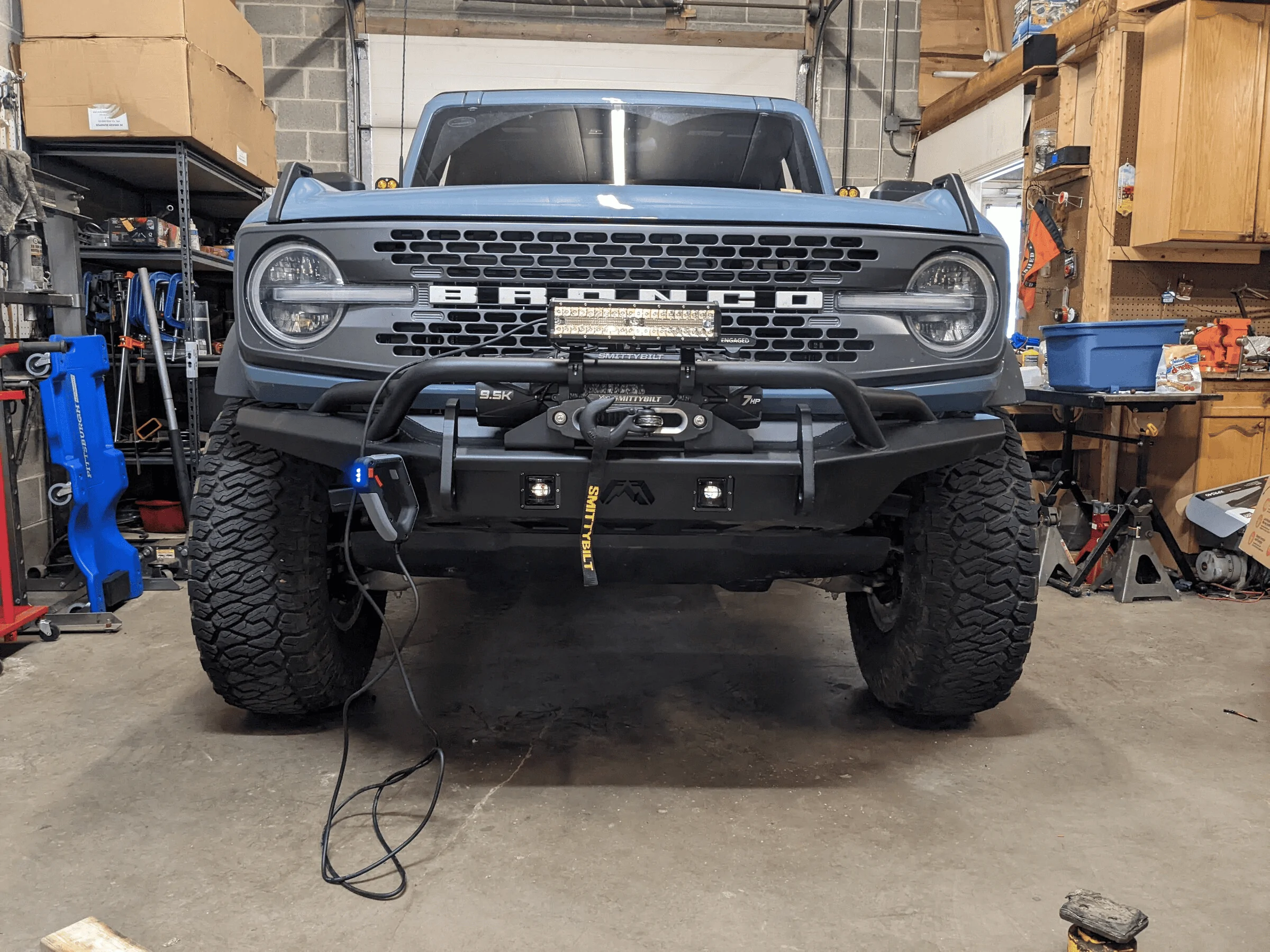

Fab Fours on my Badlands with a Smittybilt winch;
Ford Bronco Stubby front bumpers.  Let’s see ‘em! 1707761582294
Ford Bronco Stubby front bumpers.  Let’s see ‘em! 1707761617577
Ford Bronco Stubby front bumpers.  Let’s see ‘em! 1707761639856
These pictures are with the factory Bash Plate, though I have since upgraded to the Fab Fours matching skid plate, bashed up the factory skid plate pretty early on, but nothing to do with this bumper..
