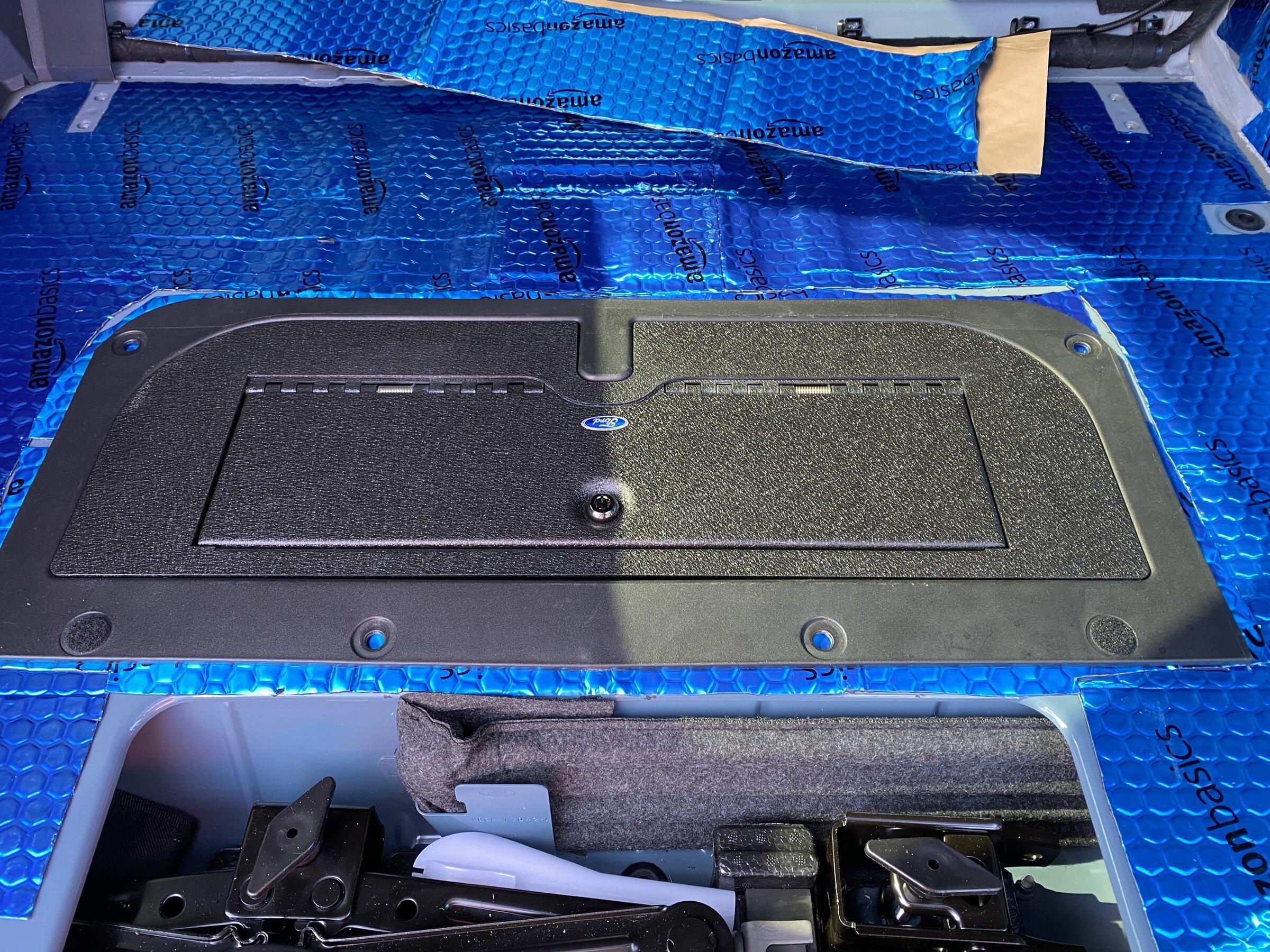

Between all the threads and posts, I’m chipping away on my stereo upgrade. And I’m an absolute novice at this stuff.
Going to swap all the 4” speakers with Hertz DCX 100.3. I listened to those compared to Alpine’s and Focal’s. My ear enjoyed the Hertz. Anyone selling a single by the way?
I’ve gotten off all the covers after some wrestling, in particular the front center. Amazon adapters in hand.
I feel like I’m in over my head, but gonna keep soldiering on. Some really helpful DMs are keeping me on track.

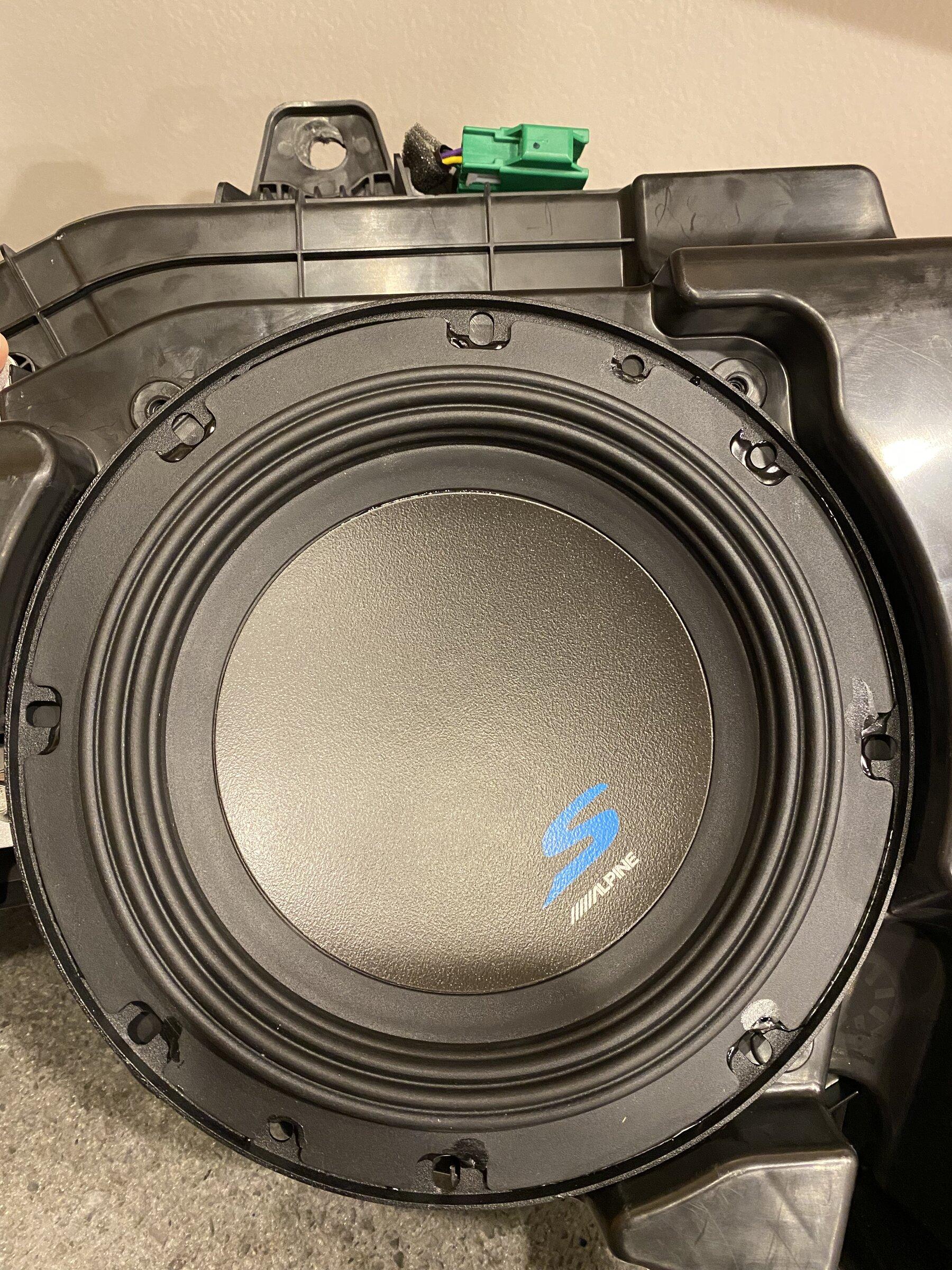

Stripped the back panels and started adding sound deadening. Also got Metra adapters for an Alpine DVC 4ohm sub.
So where I need help is mounting the sub. Any advice off this pictures? I would like to install the rubber ring that came on the sub and isn’t pictured. To do that, I think I need to cut part of the sub enclosure in the bottom left of the sub port.
Questions.
1. If I cut with a Dremel, what can I use to glue back the cover part to the enclosure? I saw some posts with epoxy or something.
2. Is it ok to just use self tapping plastic screws in the existing enclosure?
3. Should I seal the existing screw holes? If so, with what?
thanks to anyone with helpful guidance.

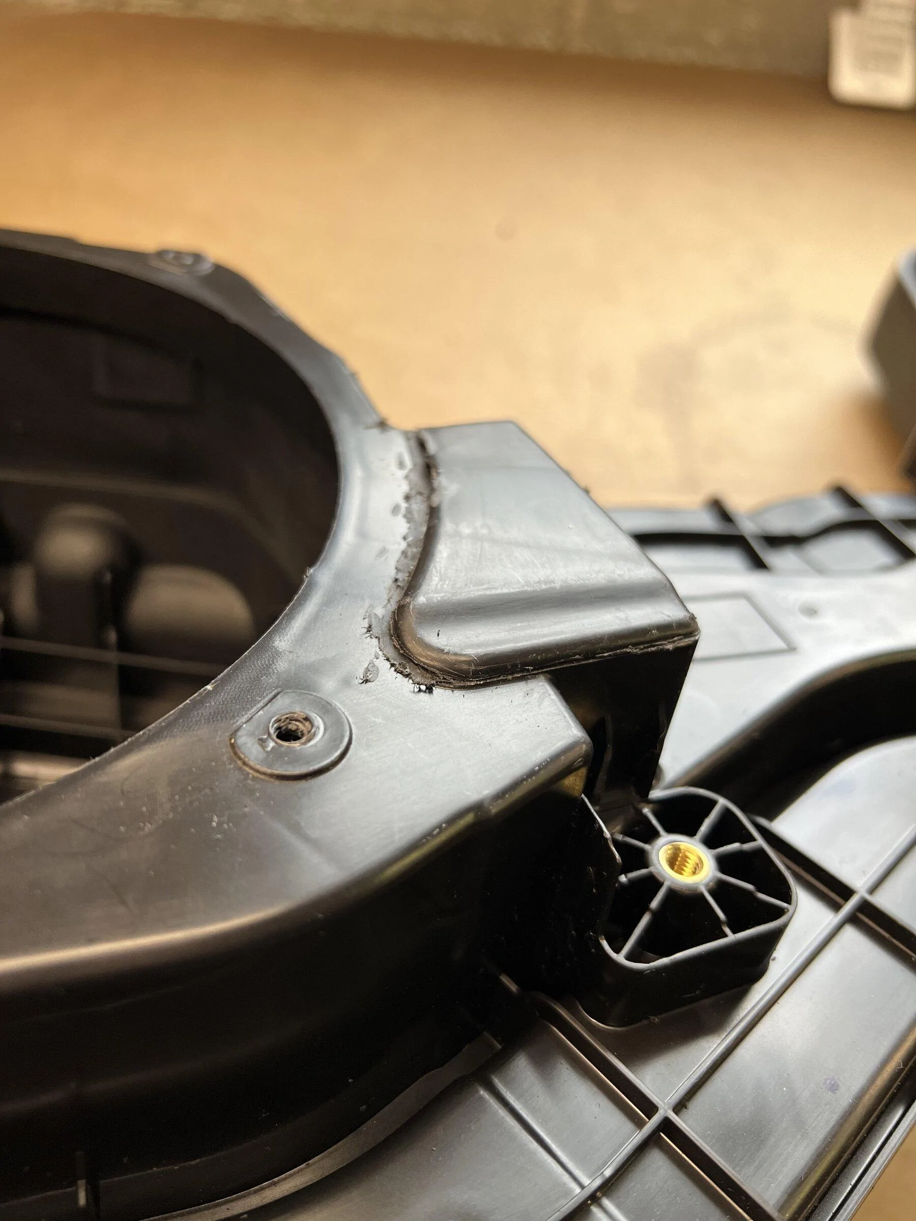

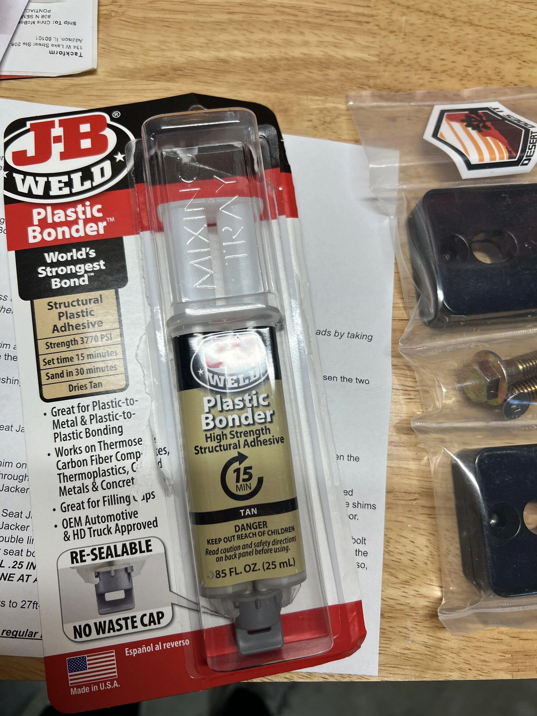

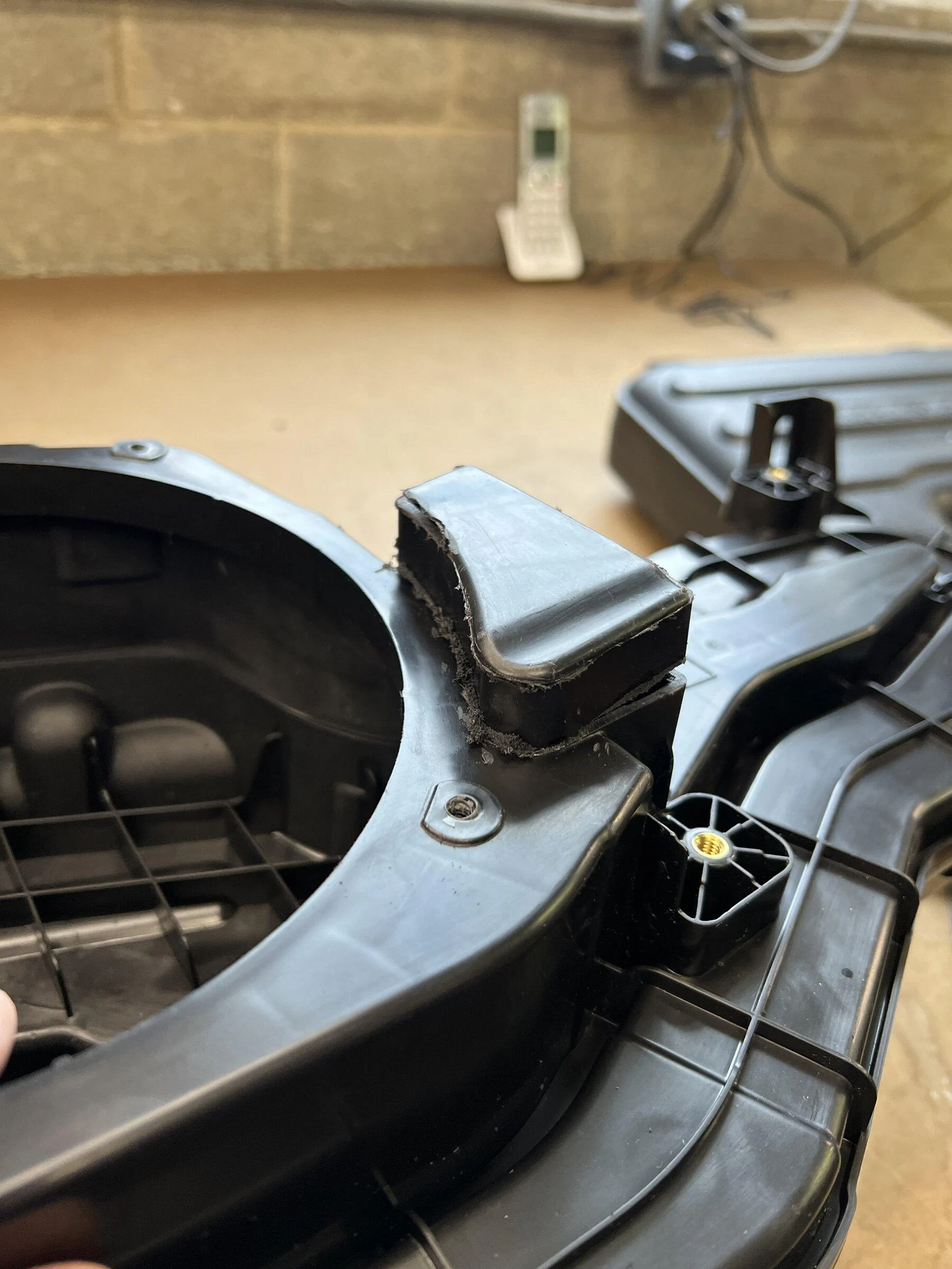

I used jb weld. Good stuff and it has a fast cure time. I also filled the unused holes with it as well. Also attached some pics to show how I cut the bump out off the enclosure. Hope this helps!
Perfect! Thank you
it was your post I saw on another thread, so basically was wondering what you used.

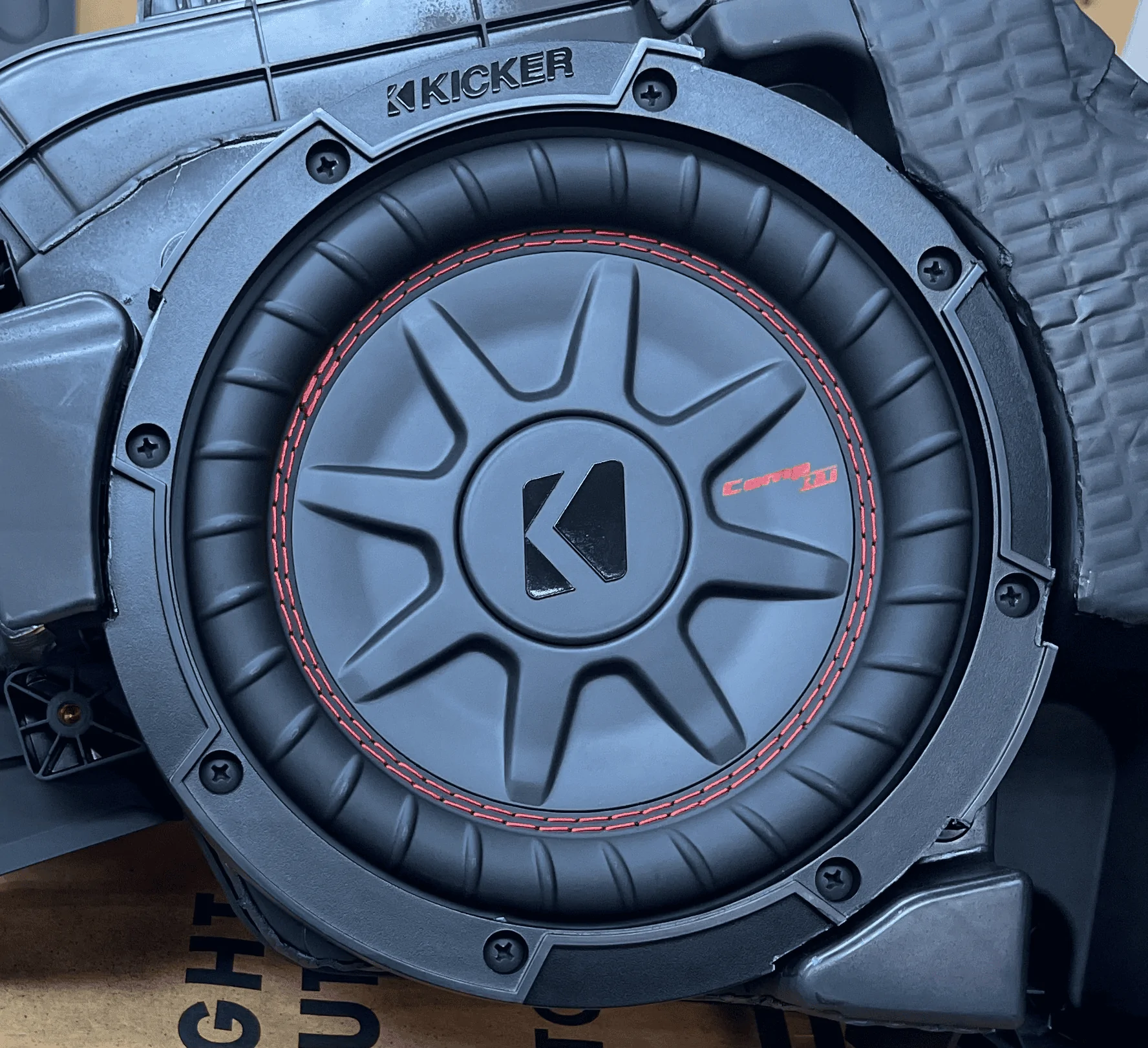

Another option for getting the speaker to fit on the sub box is to trim the ring after you peel it off the speaker. I just cut back in the areas that were impeded by the bump outs on the factory box. In hindsight, I probably cut have cut the ring without removing it from the speaker but didn't want to risk slipping with a hot razor knife and messing up the speaker.

I probably should have just stuck with the Kicker like everyone else
I can fit the Alpine without the rubber ring, but I’d rather make the sub fit with the rubber

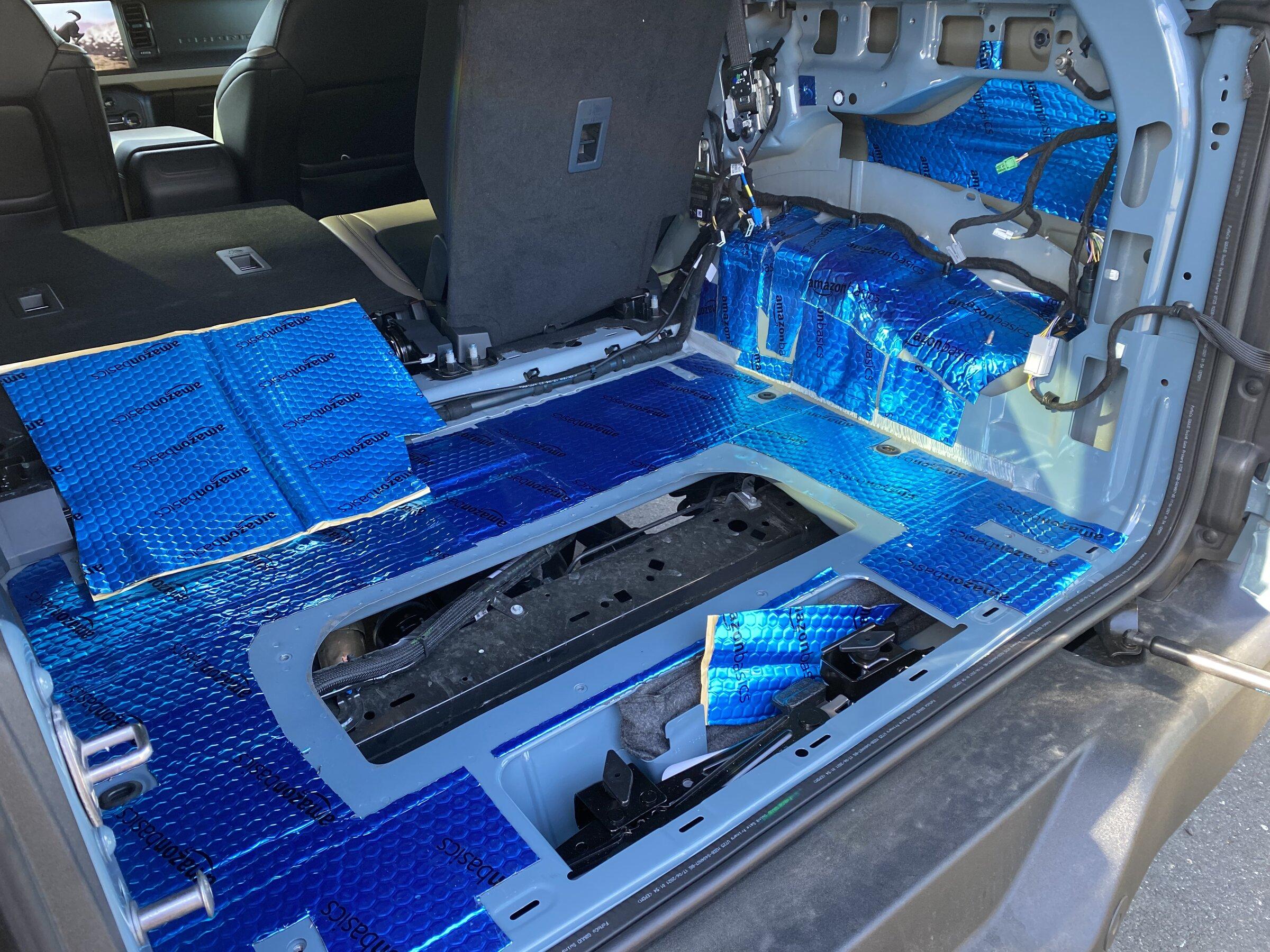

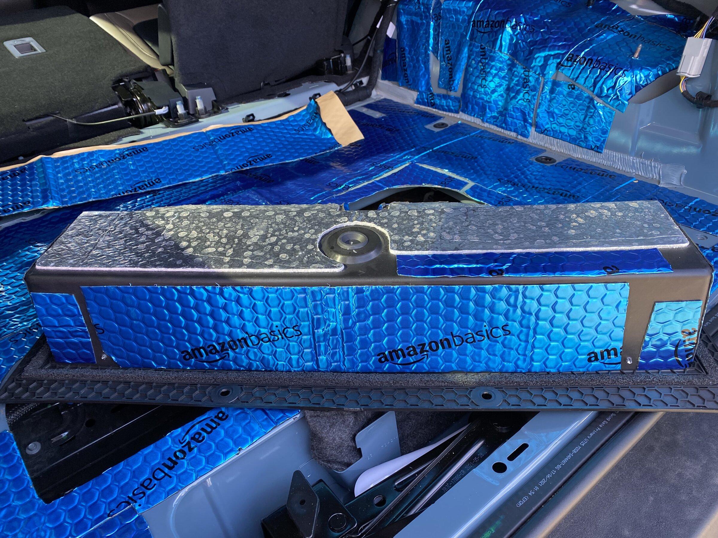

It’s been days, a little bit here and there. The wife isn’t thrilled.
Good news I plugged back in the amp and sub, everything still works
front two speakers are in.
Still hoping JL Audio comes out with a custom stealth box that is truly plug and play. Maybe with a 10inch

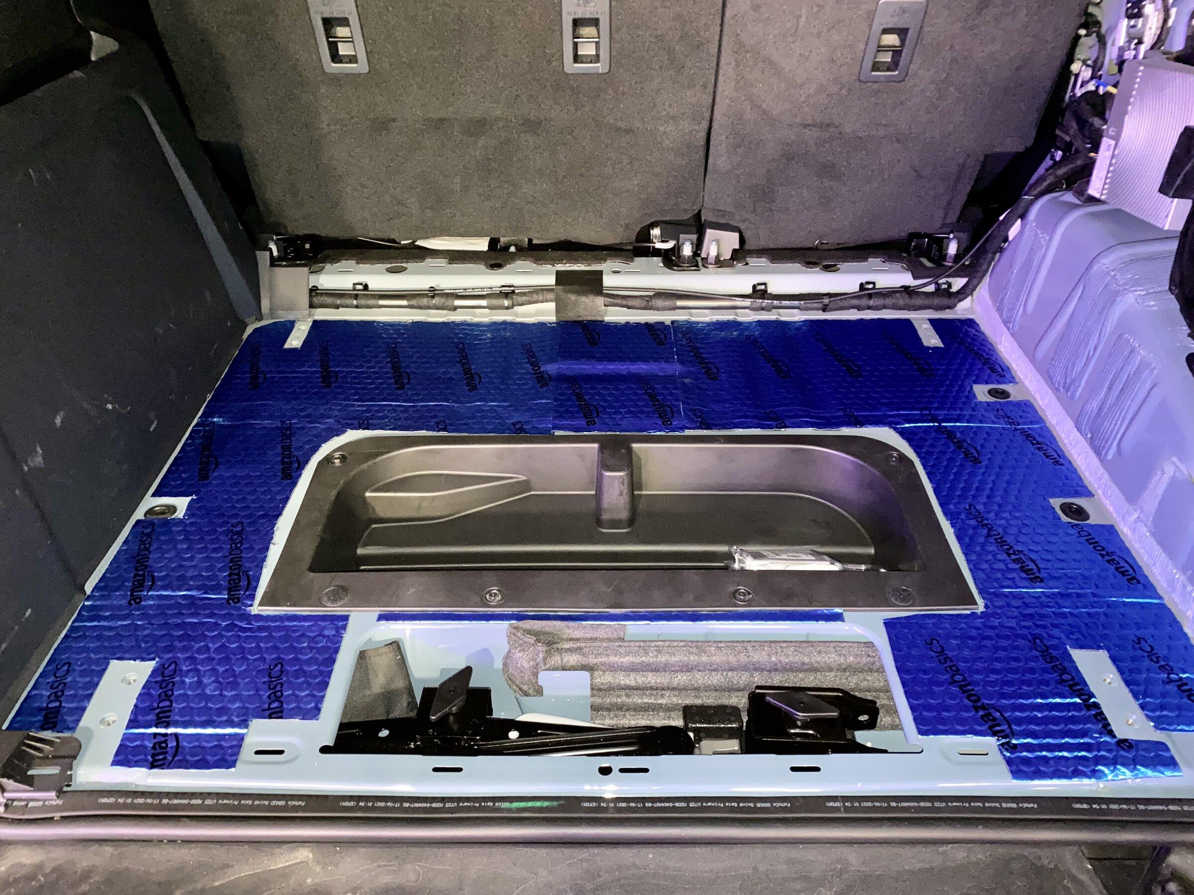

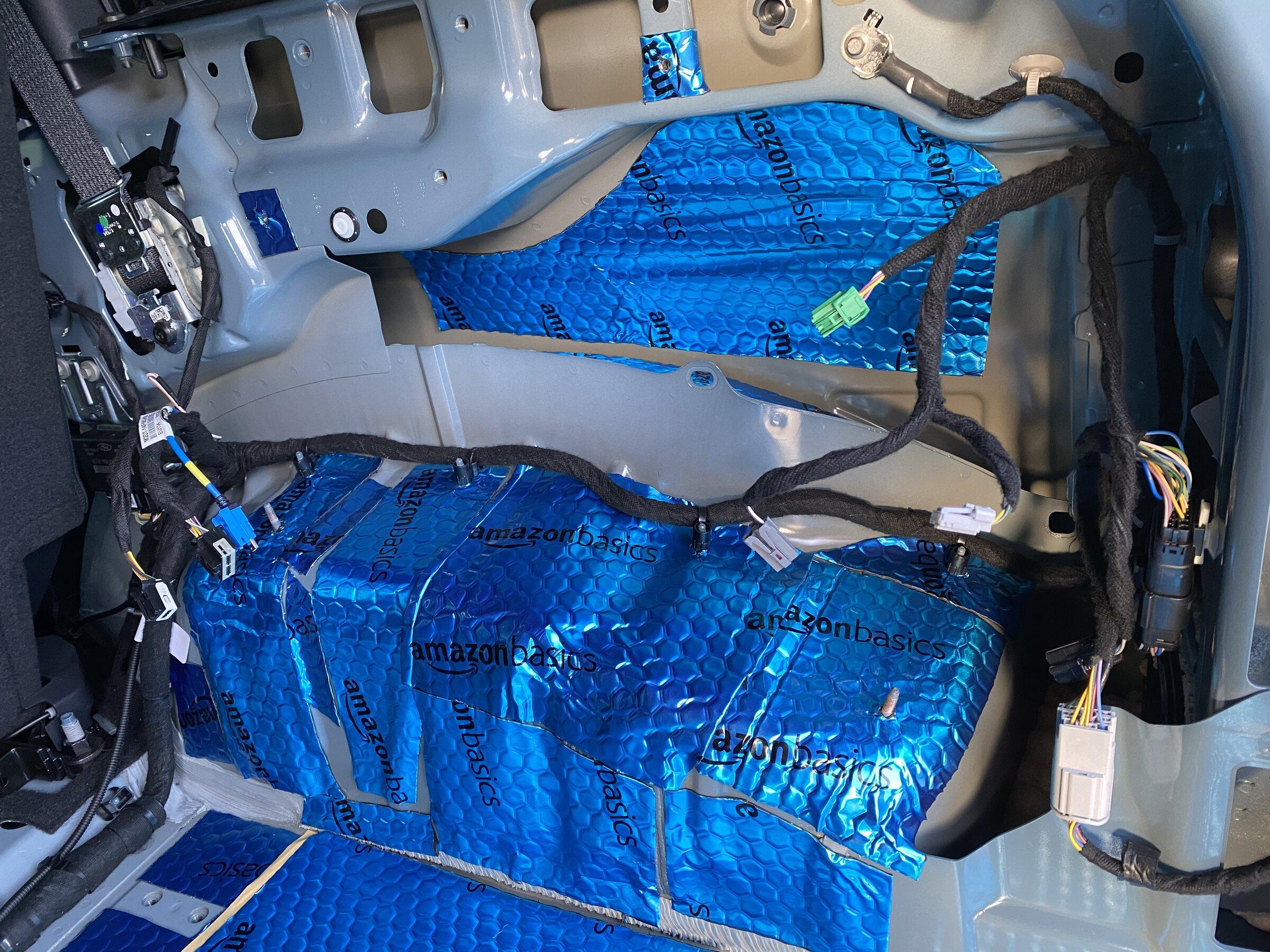

Since it was all torn apart I also added. Locker and added sound deadening to the plastic storage

You should be able to make the ring fit also with a bit of trimming. The Kicker fit without the ring but it is better to have the ring on it. The ring also helps mounting the speaker in the box without messing up the rubber surround on the actual speaker. It was really not difficult at all to trim that ring. If you look close at my pic above, you can see the three spots I had to trim.
The kicker ring looks like hard plastic
the alpine is soft rubber. A little trick to cut in the same way
worth a shot though
