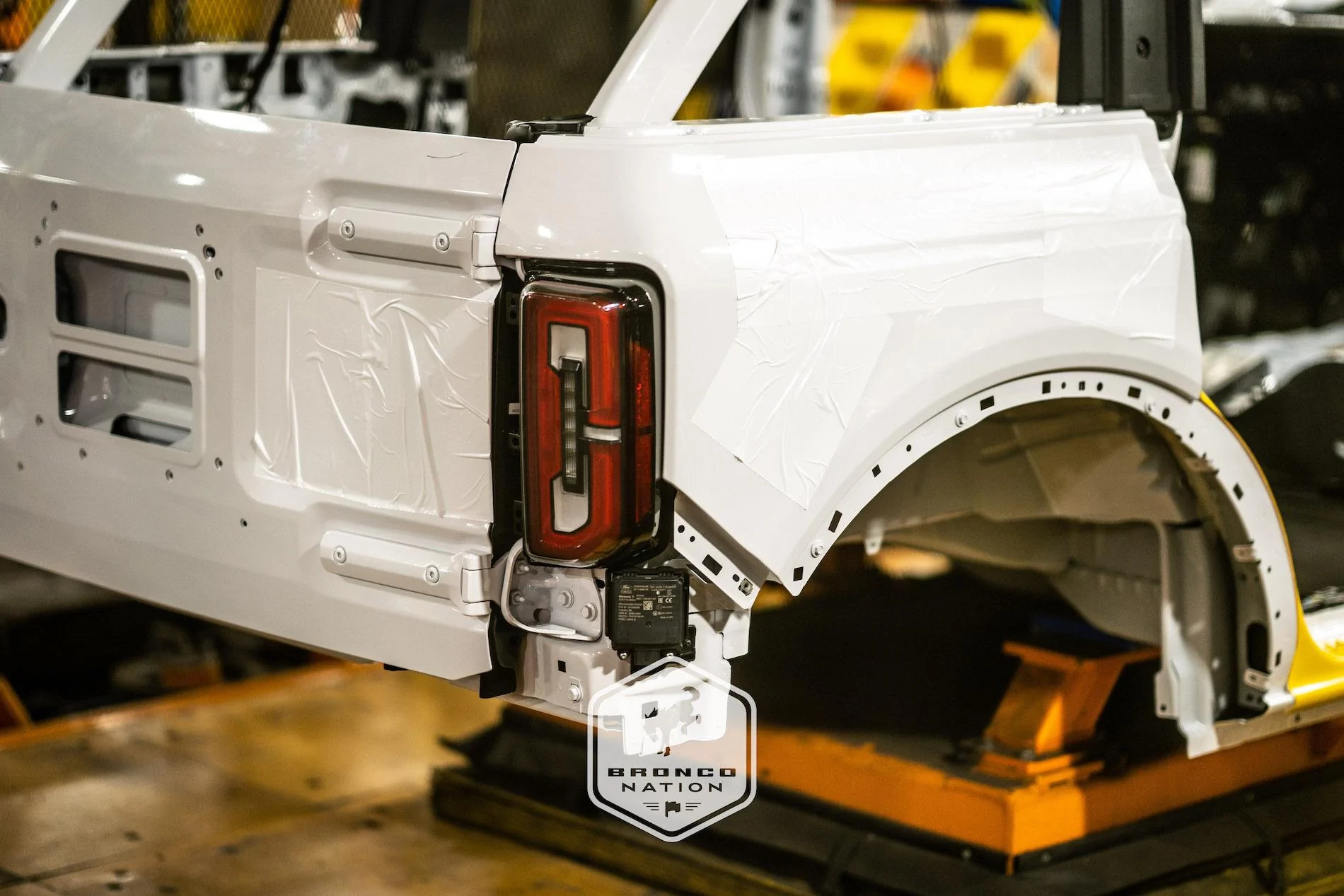

The rear mounting location I'm eyeing is the apparent plastic panel below the rear brake lights. Should provide a good wide surface with easy access for wiring, and options as far as aiming.
The black box there is suspected to be the BLISS sensor. Still looks like there's plenty of room around it for a small surface mount light.
