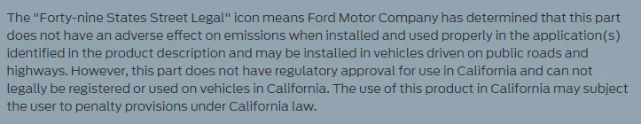

The factory cats are fine, no need to change them out on a FP tune. I'm assuming you are going near or full throttle and then smelling sulfur? That is completely normal when the pcm richens the fuel mixture.
Ford Bronco Sulfur smell upon acceleration ? 1668020021142

I am not accelerating at full throttle. The smell occurs early in the rpm curve.
