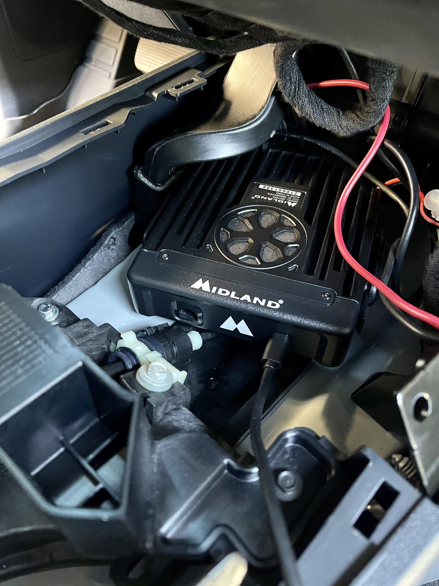

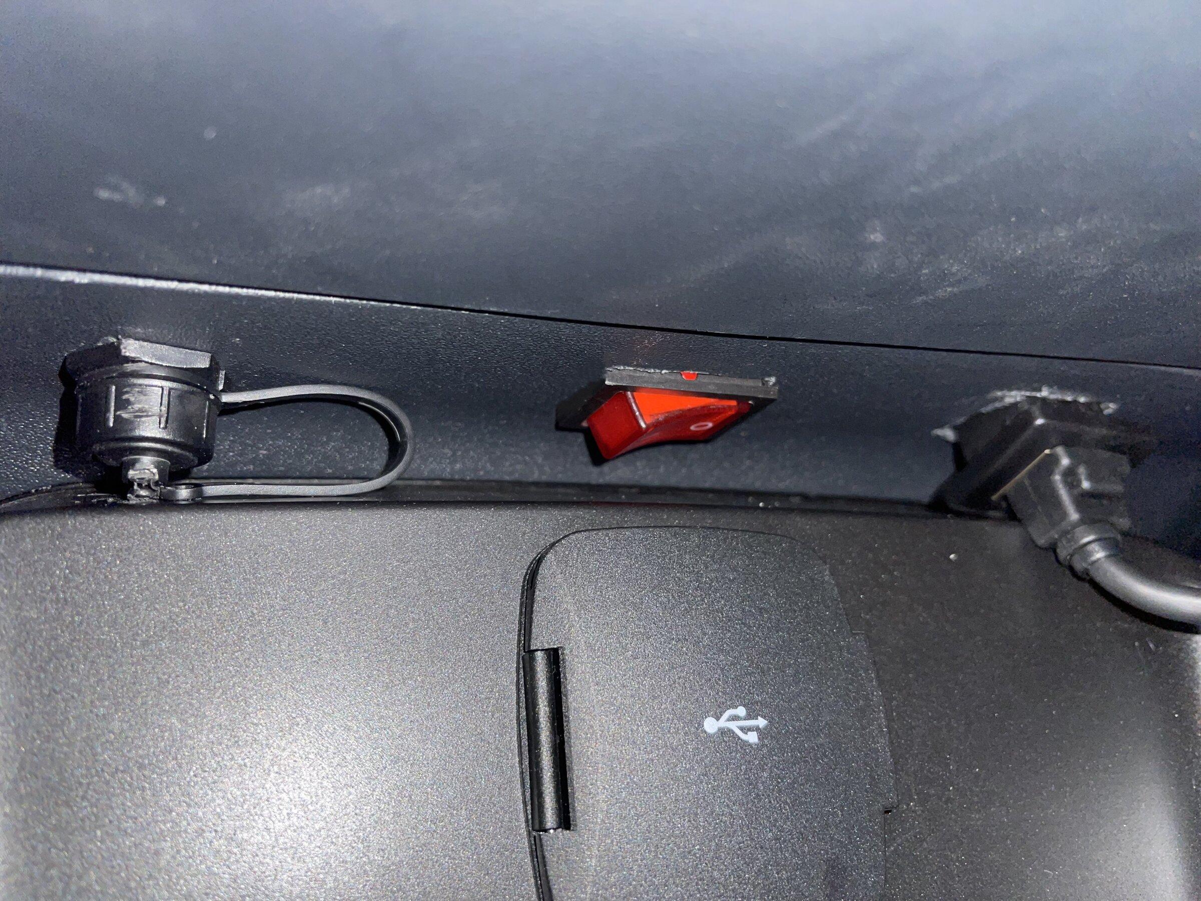

Just wrapped it up. I messed up a bit with placement of the pass through. I wanted it to have its own direct switch to the battery as all my six switches are spoken for at the moment.
Ford Bronco Super Clean GMRS Radio Install! CC831A54-2C7C-47B2-9EF5-5A8887B1F33C
in my hubris to make the most of a dead space I decided to add a switch, Ethernet pass through & usb c pass through from the unit. I was able to add all three but the usb c is essentially a waste as I could never get a plug in it because of the angle (you live and you learn). Second mistake was not putting the Ethernet pass through closer to the center of the trim piece. With the angle I have to nudge it out to connect the handset. I honestly don’t really care as it’s not visible but I will probably purchase the trim piece and redo the switch and the Ethernet pass through in the center and ditch the usb c all together.
Ford Bronco Super Clean GMRS Radio Install! EAFC120B-034A-43D6-9F7C-31889FA46242
The fit is certainly tight but it was doable, if you power through an aux switch there will be less wires so it may be a bit easier. I did the same method as the OP and drilled out the mount hole to use the existing screw below.
Ford Bronco Super Clean GMRS Radio Install! EFFA4E30-5BF9-4A57-B199-CADD6325F96B
In the end I’m happy the unit fit, but pissed I have to reorder a trim piece to make it 100%. I hope this helps anyone out and if you have questions I’m happy to help.
Ford Bronco Super Clean GMRS Radio Install! AFBCC0DB-1A4A-4580-B43C-326B1798F344
Thanks for the update and photos. This is going to make it really hard for me to not want the more powerful unit.
I'm noticing how large the heat sink fins are on the 575. Anyone more knowledgeable than I have any thoughts on if the confined space under the console might create some heat issues? Not like there is any air flow there.
ChrisInSC
Dec 9, 2021
307
614
San Clemente, CA
Cactus Grey Badlands
I had the same concern but I believe the with the larger heat sinks it should be fine. There is actually an air duct that passes through there to the back seat. If you care as little as I do about your kid being climate controlled in the back seat, you could divert the air in there. I’ll report if there are any issues as I’m going out on the trails next weekend.
