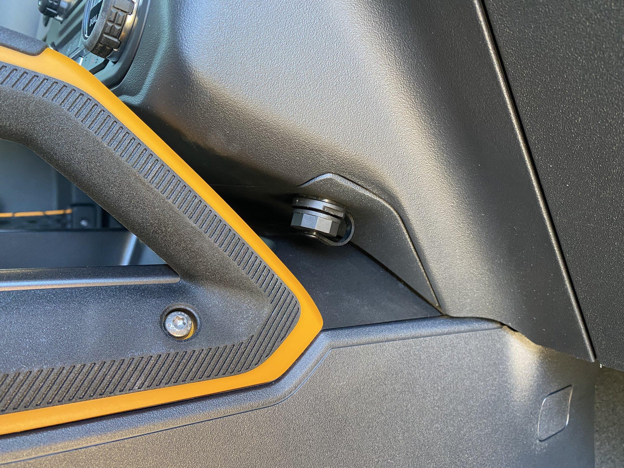

I’m going this route. Anyone have any ideas what size nut I can use on these studs? Before I go by a bunch of hardware and trial and error I figure I’d ask here

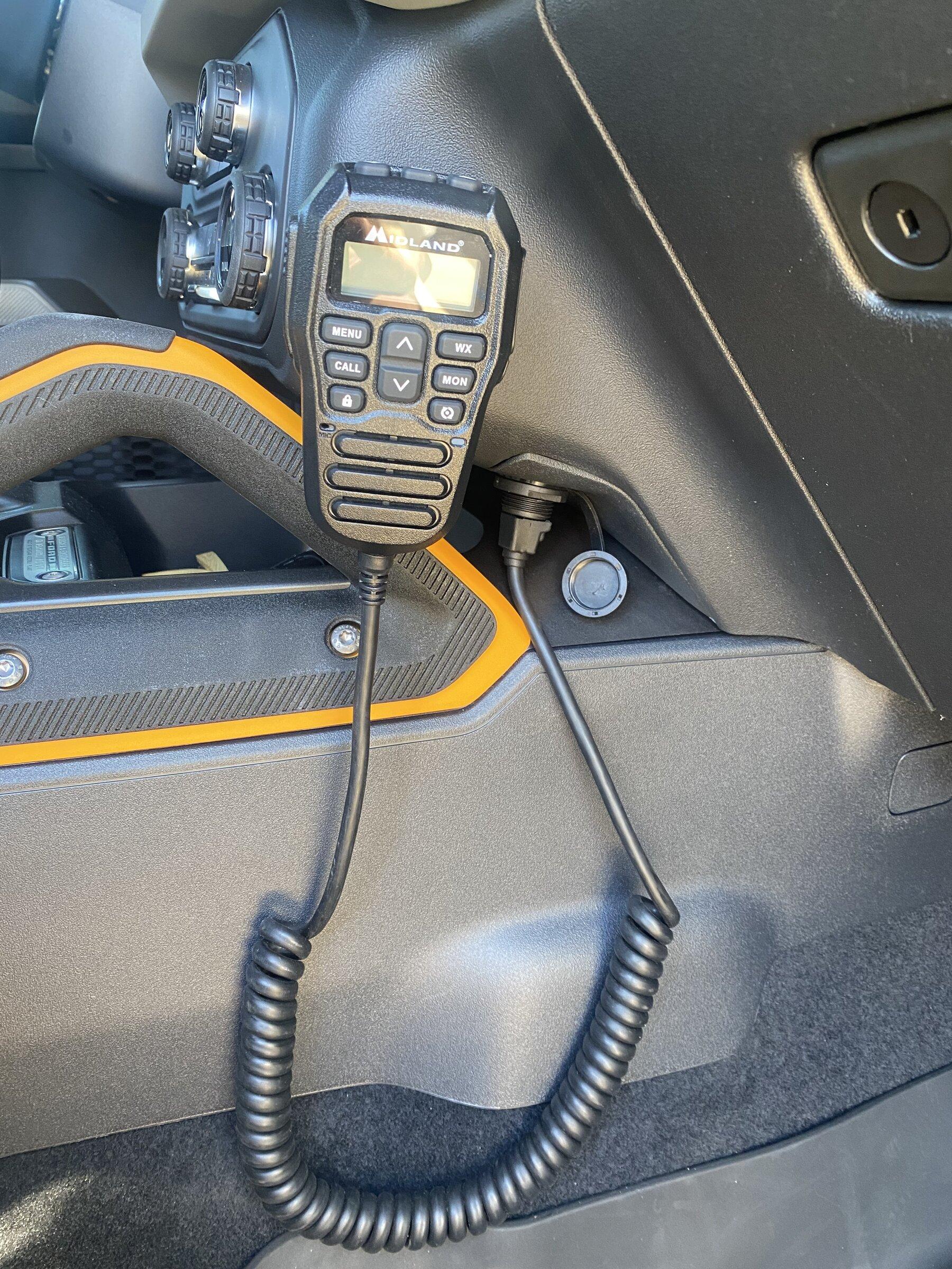

Only putting it there because its a super easy location without removing anything. I’m going to wire cat 5 to this location. I didn’t go with Ethernet connector near the usb outlet because I didn’t want to obstruct that storage area for when I connect the handset
Oof. Gotta be honest... I somehow did not consider that and am now hoping that doesn't come to bother me in the future 🤣

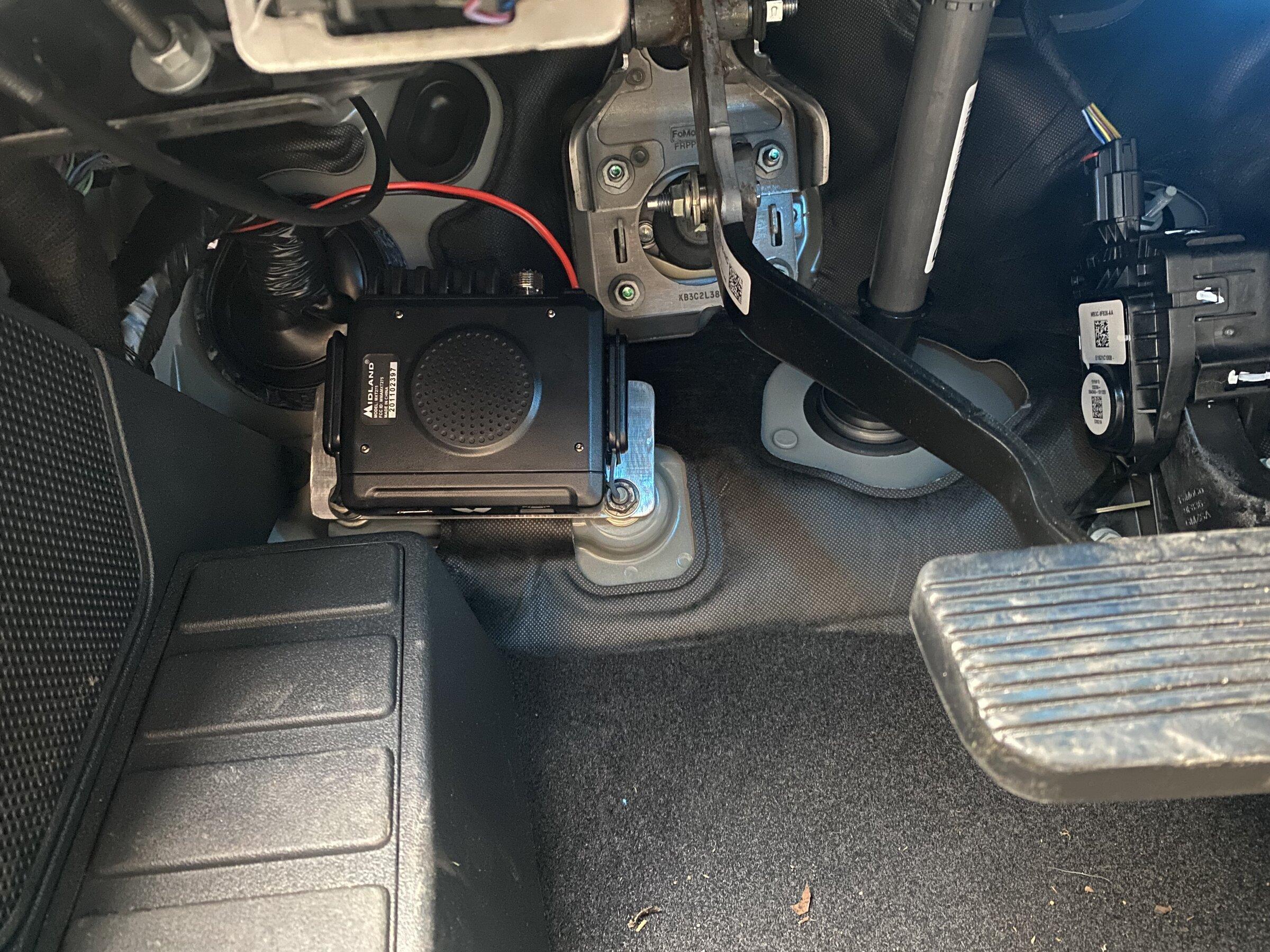

Each to their own for sure, but placing electronics near the floor seems like it would be a bad idea. Pretty sure those are not even water resistant :unsure:
Ford Bronco Super Clean GMRS Radio Install! F7046805-0955-448B-8D70-34C7AD9DED13
Ohhh I like this route. I have same equipment but just storing in center console until I could determine perfect route for me.
Do you have info for this grommet/cap?

So just my take on this But actually, I'm hoping to have an Aux switch that has power at all times. Maybe there's a setting in the radio I don't know of, but whenever I turn off my ignition the radio turns off. So when I start my rig back up, I have to reach down and power back up the radio. (Not to mention The obvious that you can't use your radio unless your Ign is on).
So you flip a switch to send power to the radio when you start your off road day, and flip it off when the day is done. No unnecessary wear and tear on your radio for your daily drives, And it stays on the entire time you're off-roading regardless if the ignition is on or not.
My particular model reverts back to the previous state it was in before the power was cut. So if the Aux switch is left on and the radio was on when I turned the vehicle off, when I restart it it comes right back on.
My main reason for not leaving the radio on a constant power source is the fear that I will be somewhere remote and forget to turn it off for the evening and wake up to a depleted or dead battery. If I want to use a radio while the vehicle is off I have handhelds.
With all that said, I would definitely appreciate the ability to have an Aux switch that always has power. There are certainly times that I might want to run something off the truck battery without having to power every accessory on the vehicle.
