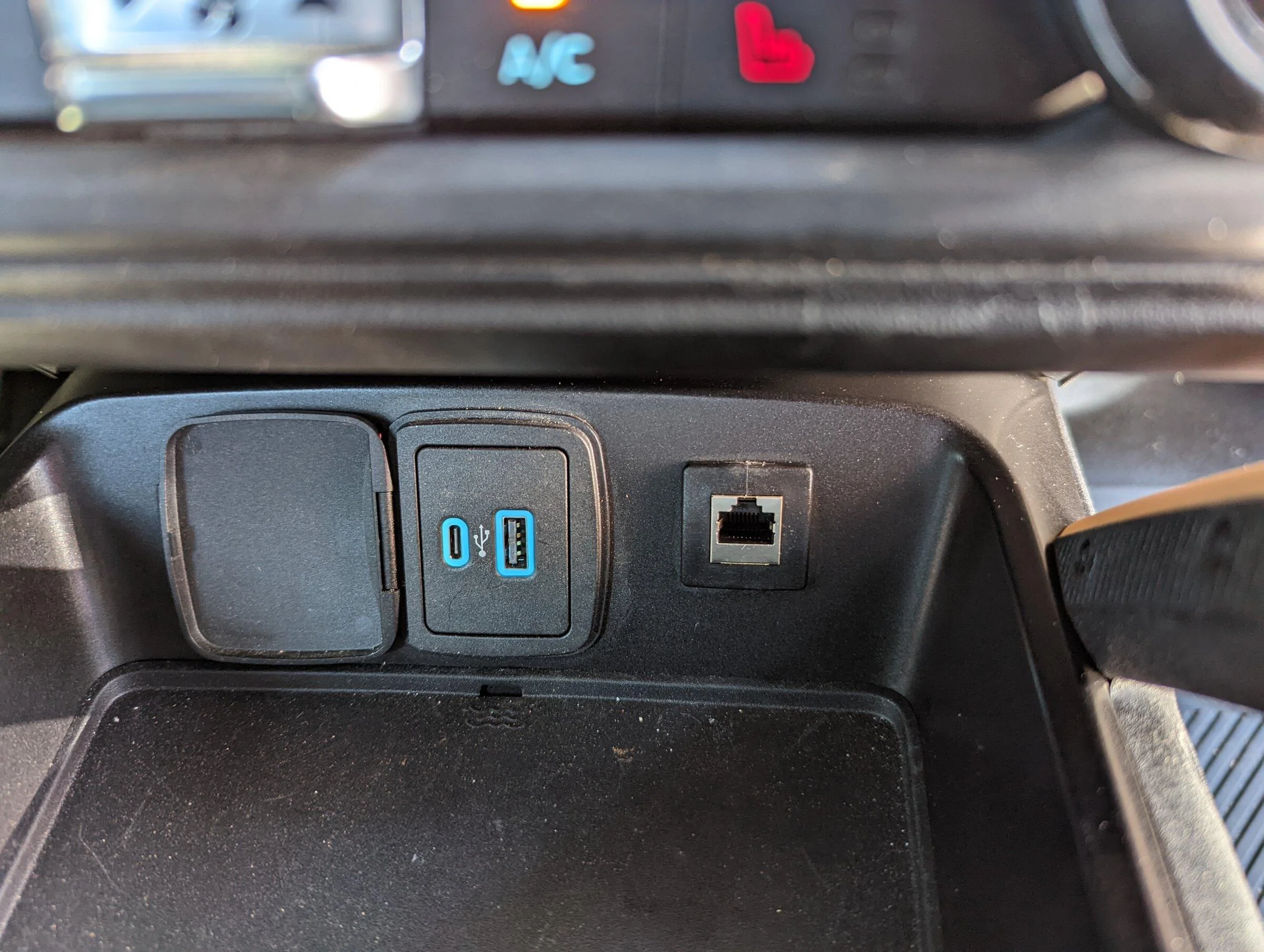

THANK YOU For the thread and write up. Knocked out my install today and did exactly what you did. Super clean looking and hides away when not in use.
Ford Bronco Super Clean GMRS Radio Install! PXL_20220510_174041707
Ford Bronco Super Clean GMRS Radio Install! PXL_20220510_174002670
Thank you again!!!

Heck yeah!!! Looks great!! The hardest part is dremeling the Cat5e square hole, but it doesn't have to be pretty it just has to stay inside the lines, and yours looks super clean 😎
I'm super proud that I was able to help you with your install, and I hope to run into you on the trail somewhere!
I think I would drill a proper sized round hole and use a flat file to square up the corners. Shouldn’t take more than a couple of minutes?

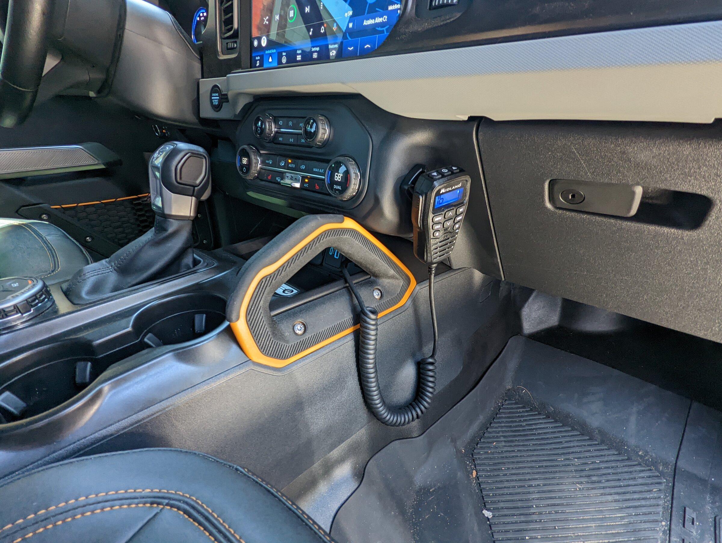

I set out to install a GMRS radio in the Bronco, but pretty early into shopping for options realized that there really isn't an ideal place to put the head unit without being inconveniently located or intrusive.
Enter the Midland MXT275.
After reading some threads on here from people who had done an install, I knew exactly what I wanted to do. I installed the radio under my center console and installed a remote Cat5e jack into the front storage tray of the center console. Mounting the radio could not have been easier. I bored out the center mounting hole on the Midland bracket and used the existing fastener Ford uses for the transmission cable pass-through to mount the radio body.
Wiring it was a breeze. I powered it using the Brown/White Aux switch wire behind the glove box, which conveniently comes completely off with no tools. I then ran the antenna cable under the driver's side dash and through an extra grommet in the firewall. I then routed the cable up through the cowl and to the Driver's side pillar, where I installed a JCR ditch light bracket and Midland antenna.
It really felt as though they designed this truck to have this exact radio installed. If people show interest in this install I'd be happy to provide all of the links to what I bought. But for now, here are the install pics:
That should work just fine
