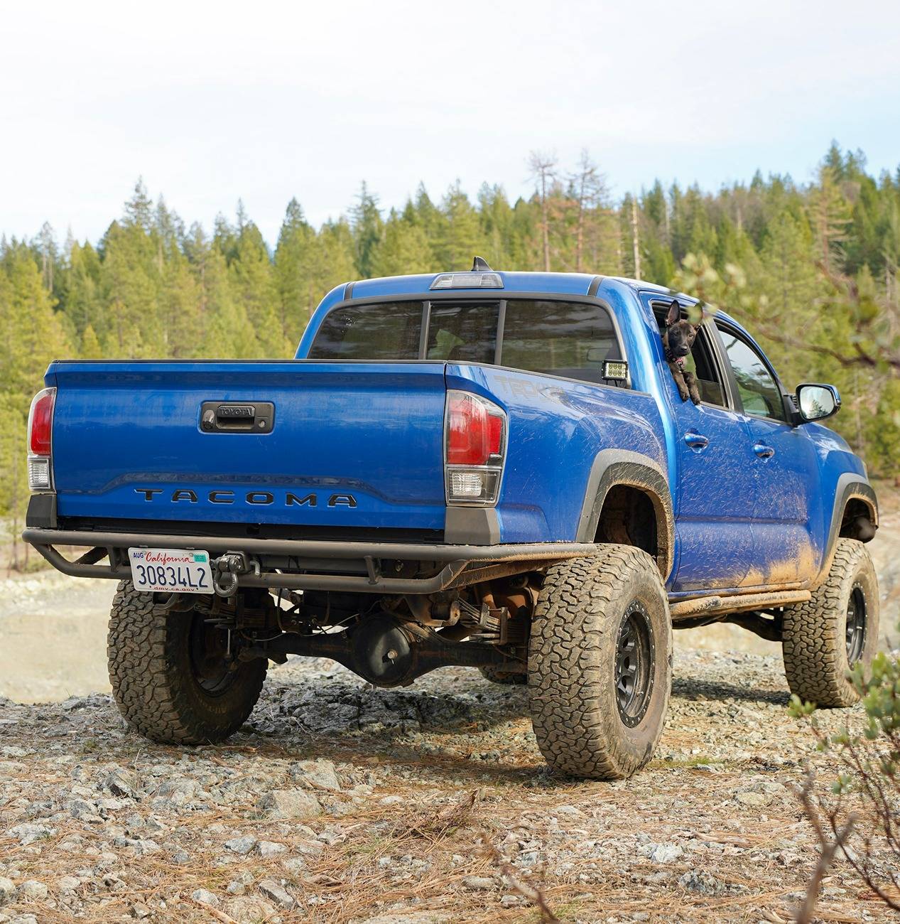

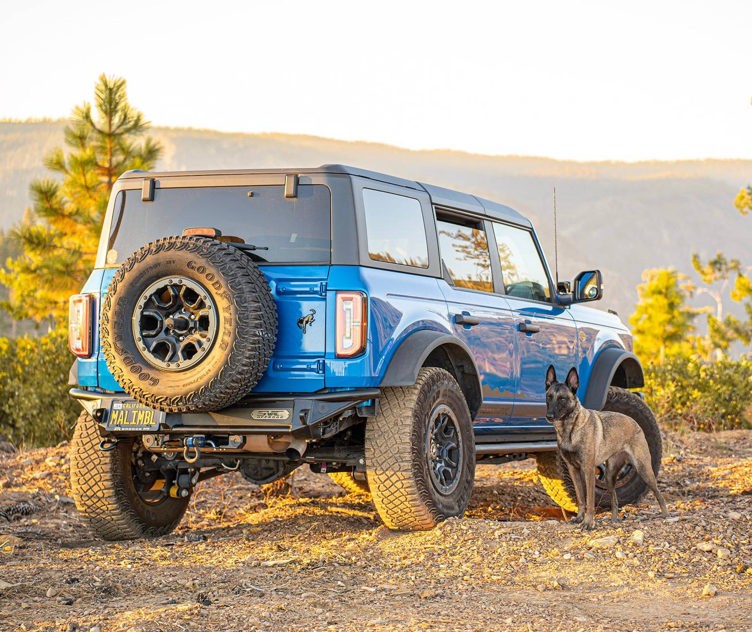

Hey Bronco6G! I thought I'd make my first forum post. Thanks to @wilbersk for the rear bumper and @SVCOFFROAD for making it, I wish I could get the front now! This thing is minimalistic, offers good clearance, and has perfect welds all around! It slightly reminds me of my old Tacoma bumper that I miss. Pictures and my install video with a detailed look at the bumper below!
Installation was straightforward. 4 bolts off, unclip 2 sensors, remove the old bumper, install the new bumper, and thread in 4 bolts. And then if you have the hitch and sensors, swap those out. I made life harder by routing the sensor harness through the frame for a cleaner look to hide the wires. Only small thing is the plate light didn't click in without a minor edit. Not sure if it was the thickness of the metal where it clips or if the connector was too thick and would hit the inside of the bumper, but I just filled down the light side clips to accommodate the thicker metal. Thanks for reading!

I'm digging that bumper too - good choice. Also love the pup - breed?

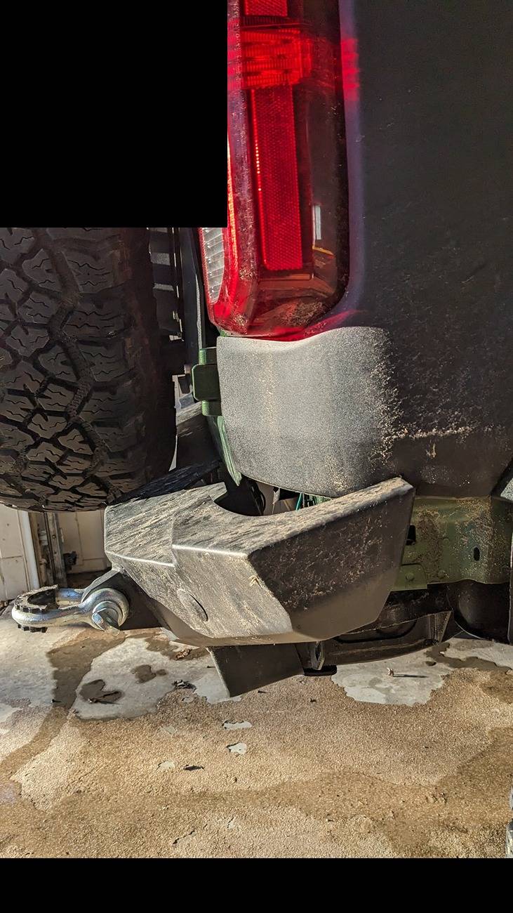

For $1500 the rear bumper should be held on by more than 4 bolts. I learned the hard way that you need more mounting points to use the bumper d-rings. Glad you put the factory recovery point back on, I wouldn't use the bumper.

I am talking about the aftermarket bumper d-ring mounts. 4 bolts isn't enough support.
