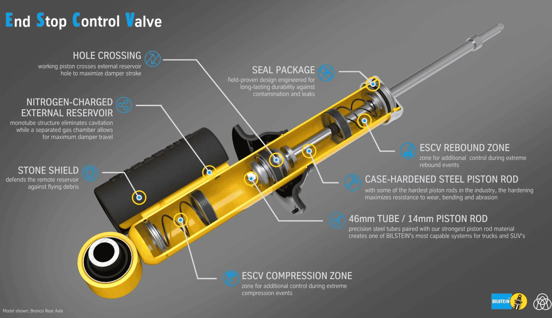

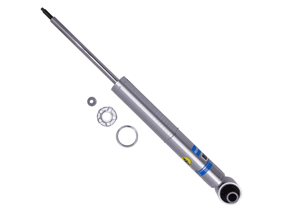

Bilstein 6100 shocks for the Bronco have multiple positions for the spring perch. There is definitely some leeway there without putting the shock out of it's operational zone. How much? IDK.

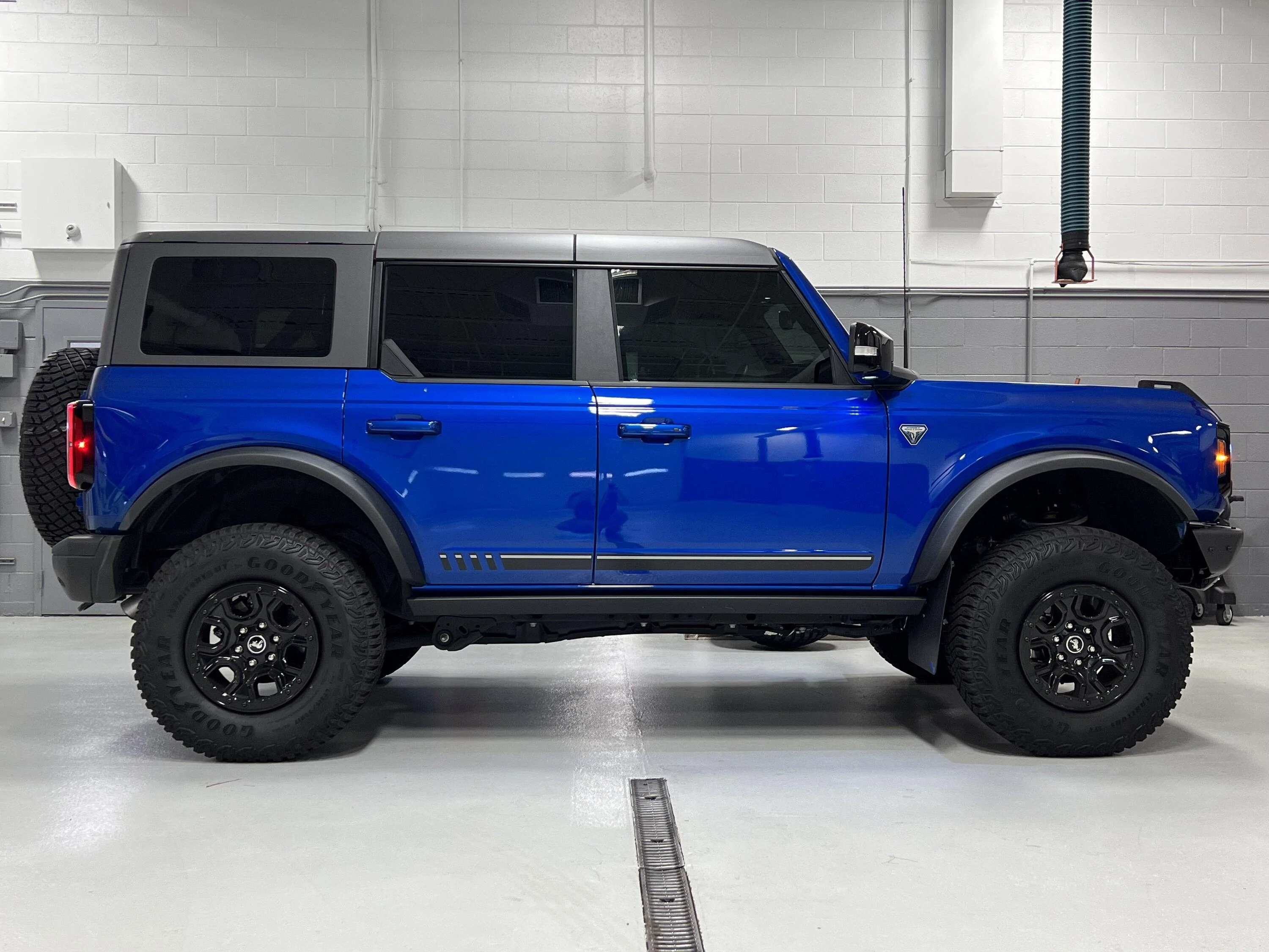

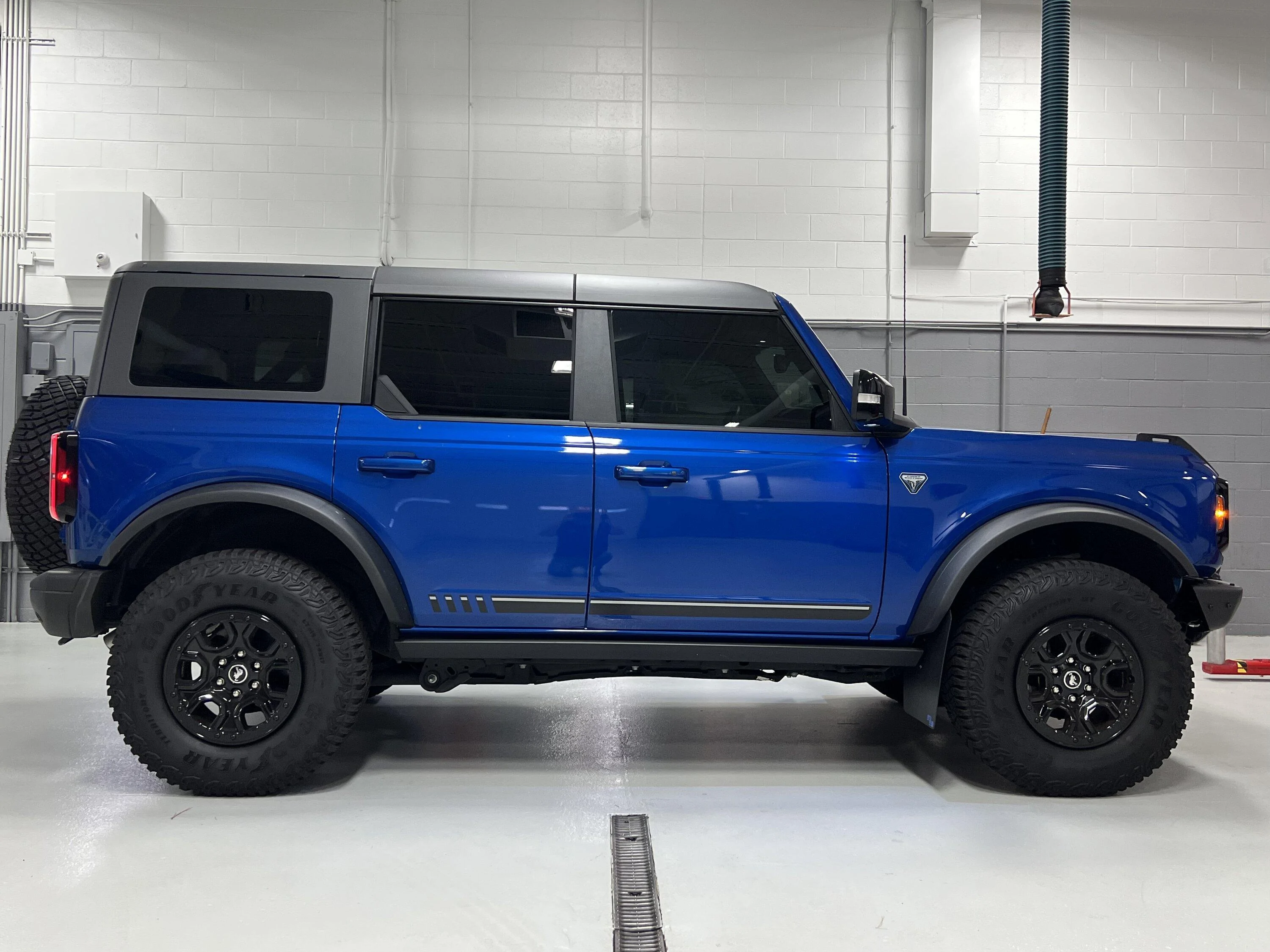

I finally found time to install mine today. I’m very pleased with the results visually.
Have not had a chance to drive yet so can’t comment yet on any possible change in driving dynamics.
Before:
Ford Bronco SVC's New Coil Spacer Lift! 1664485899686
After:
took me about 4 hours (not including the alignment) in a well equipped shop with a lift, working at a leisurely pace. But I’m a rusty old guy that hasn’t turned a wrench in 13 years so it could have been done considerably faster.
my alignment was WAY off afterwards.
I used the control arm technique instead of breaking loose the tie rods, ball joints and risking the stripped CV axle nut that some have experienced. I believe this was likely a significantly easier method.

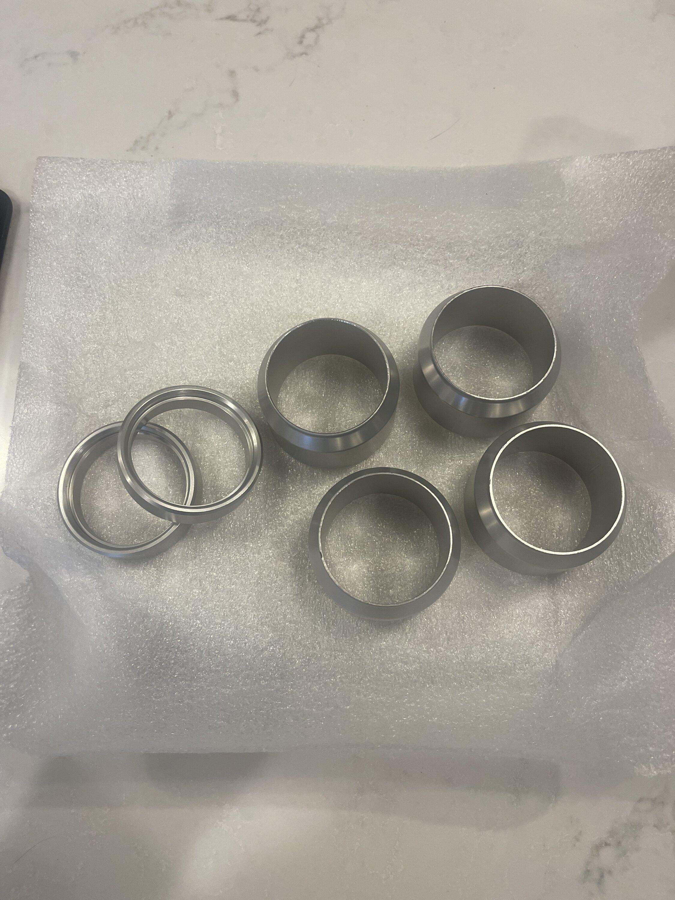

What are the 2 extra pieces?
Edit: They are for addedlift front or rear if you’re running a heavier bumper.

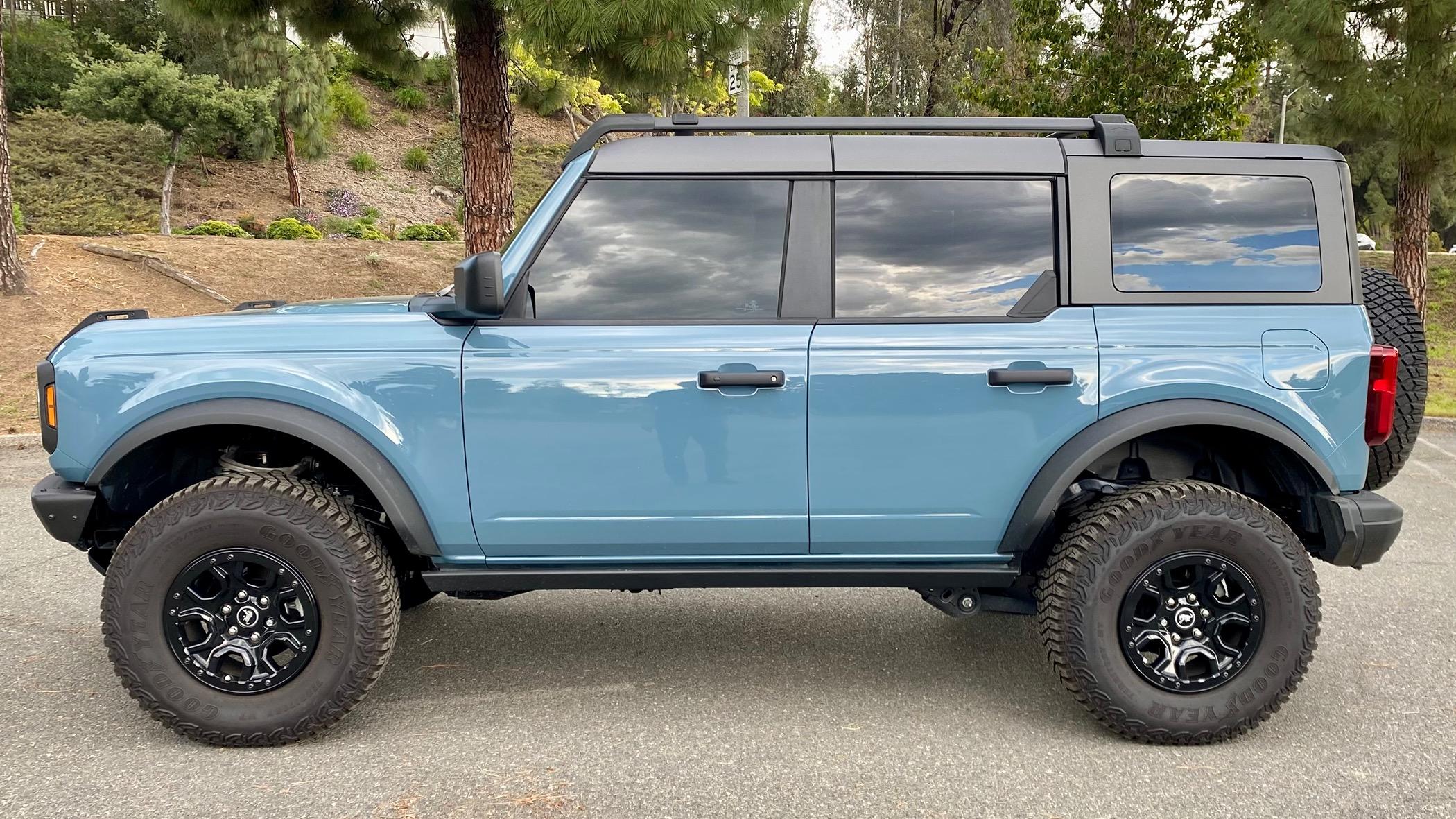

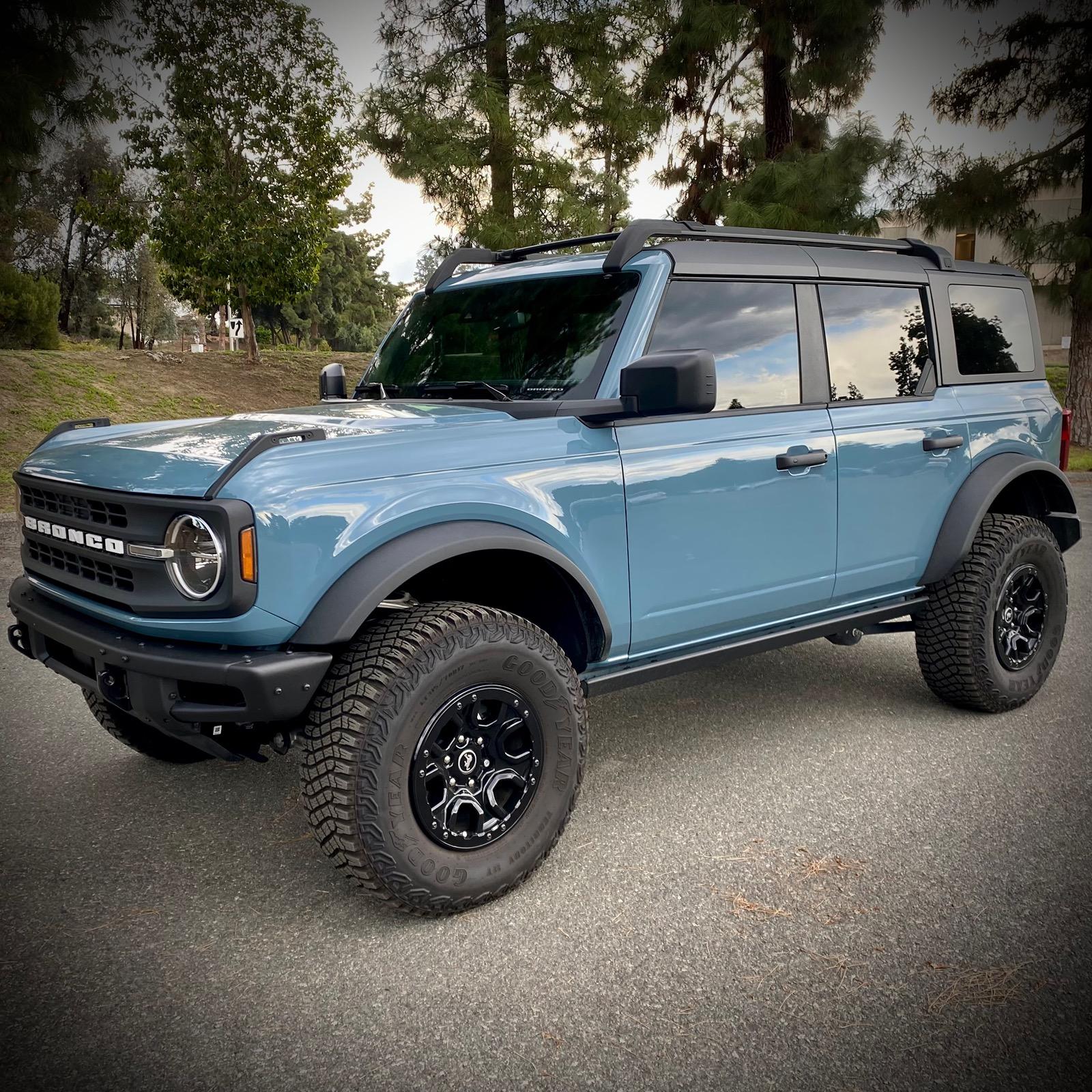

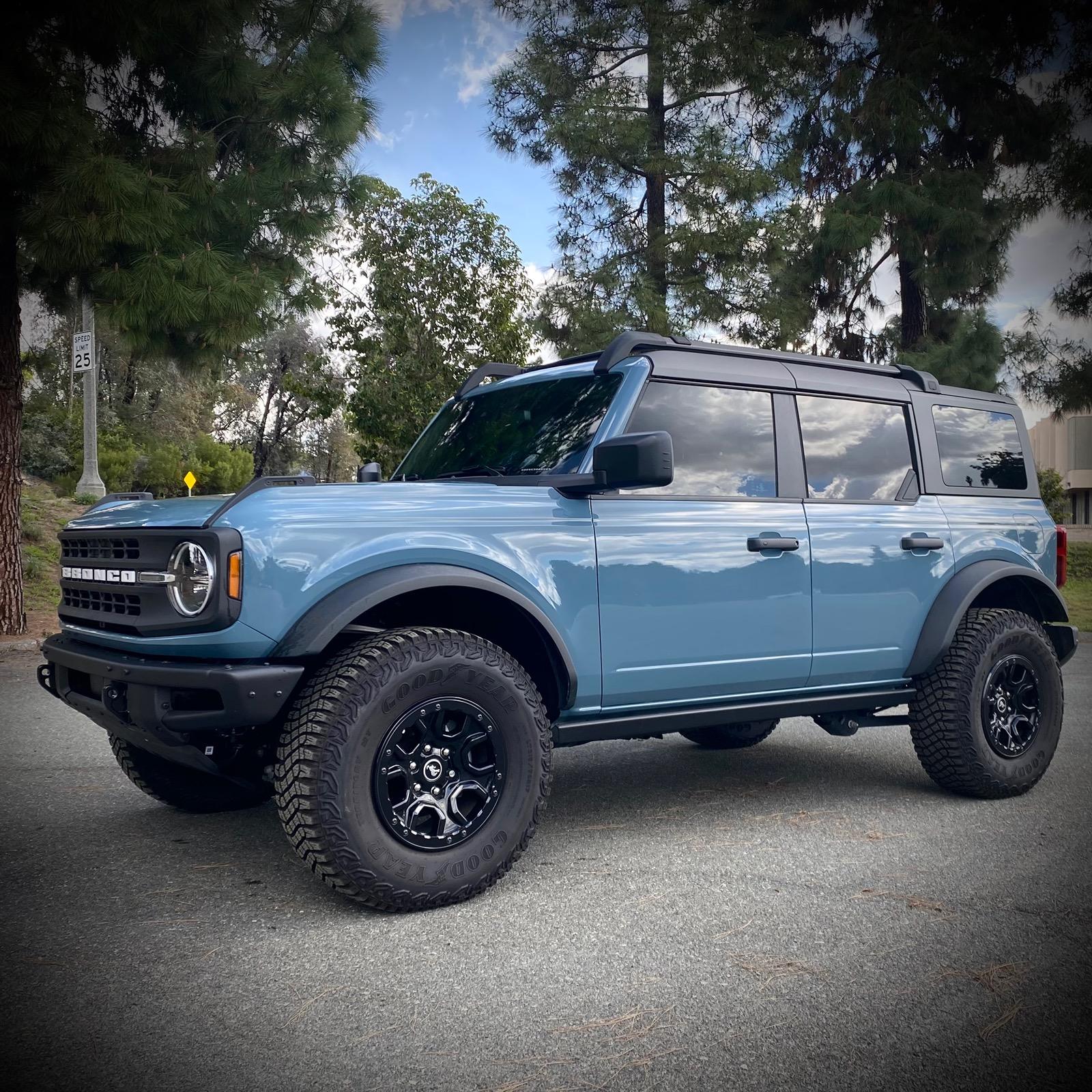

Ford Bronco SVC's New Coil Spacer Lift! IMG_5263
Ford Bronco SVC's New Coil Spacer Lift! IMG_5266

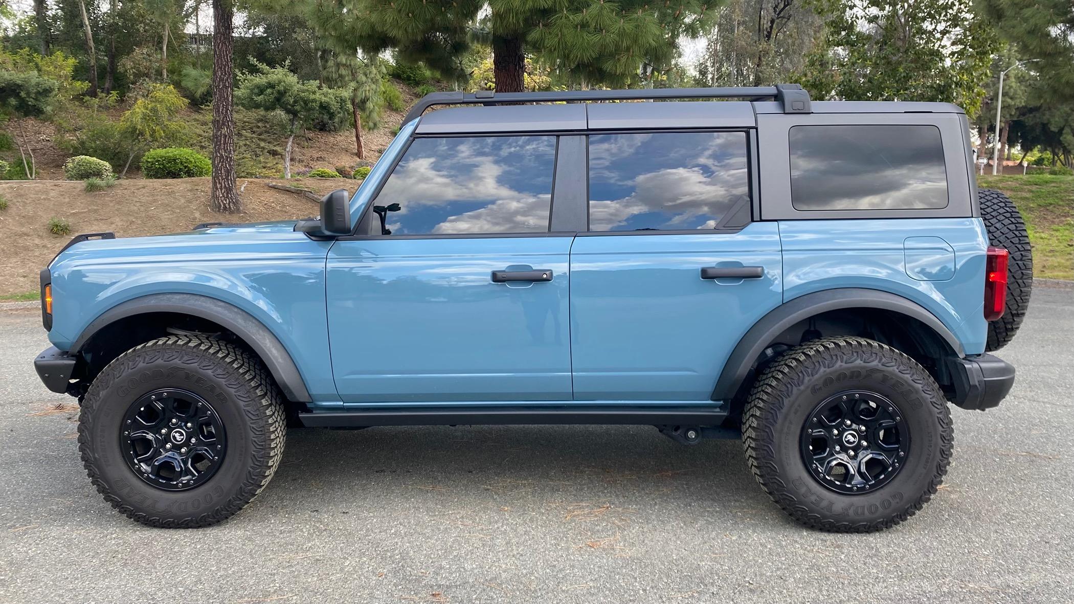

SVC 2” collars front and rear.
Ford Bronco SVC's New Coil Spacer Lift! IMG_5293

I was worried the 2” would make my 285/75R17 Toyo look tiny, but they’re only 1/2” shorter than the Goodyears. So, that’s promising. I’m also installing on non-sasquatch Bilsteins. So, that should make up that 1/2” and potentially loose a bit less articulation.
Thanks for posting @Shrek27
