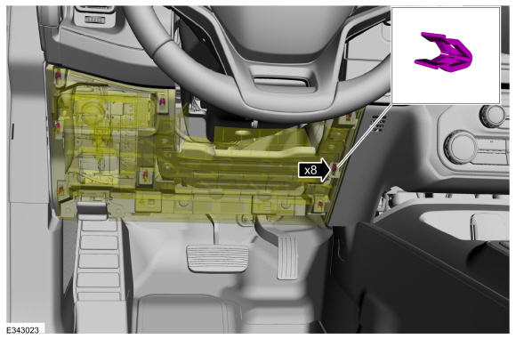

  1. Release the clips and remove the lower instrument trim panel.
    Use the General Equipment: Interior Trim Remover

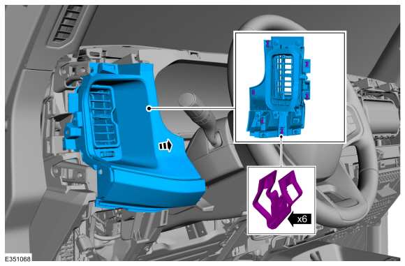

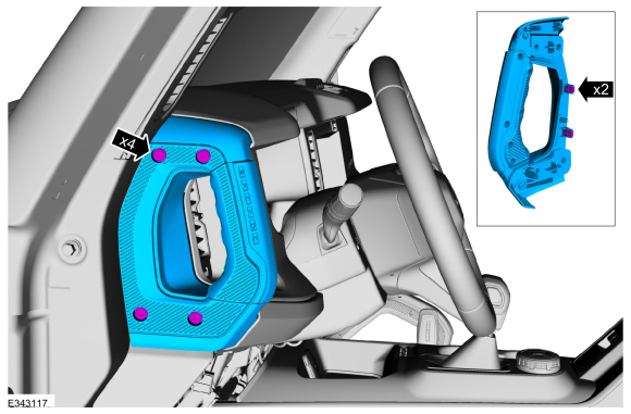

  1. Release the clips and position the lower steering column closeout panel down.
Ford Bronco {thread} {filename}

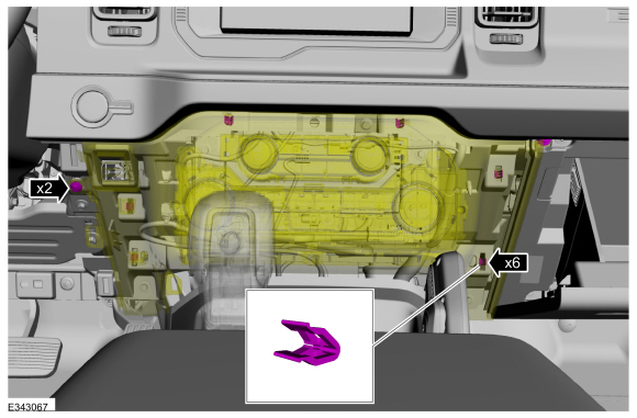

  1. Remove the screws, release the clips and position the lower center instrument panel trim panel.

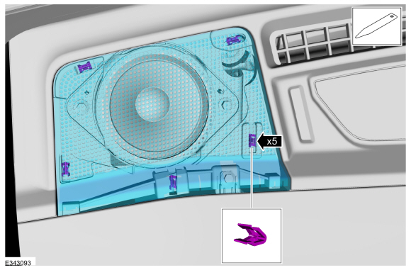

    Release the clips and remove the instrument panel speaker grille.

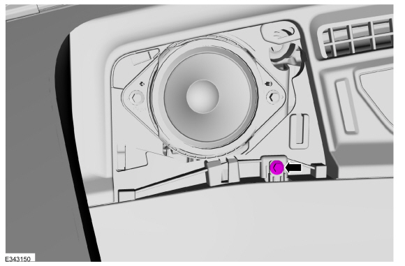

  1. On both sides.
    Remove the bolt.
    Torque: 22 lb.in (2.5 Nm)

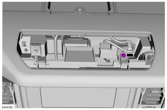

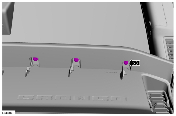

  1. Remove the screw.

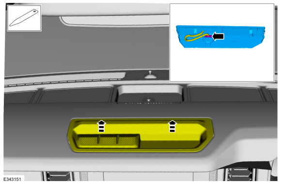

  1. Position the screw covers.

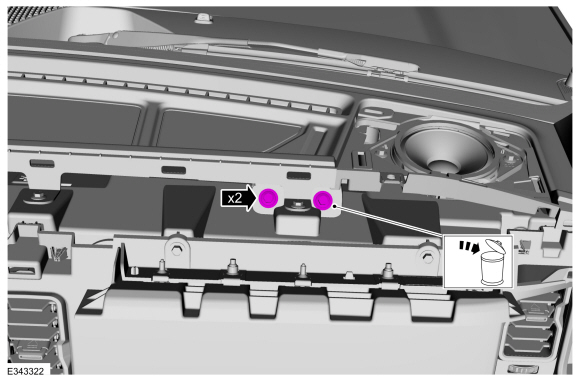

  1. Remove the screws.

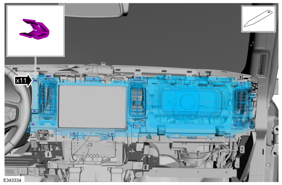

  1. Release the clips and remove the upper instrument trim panel.

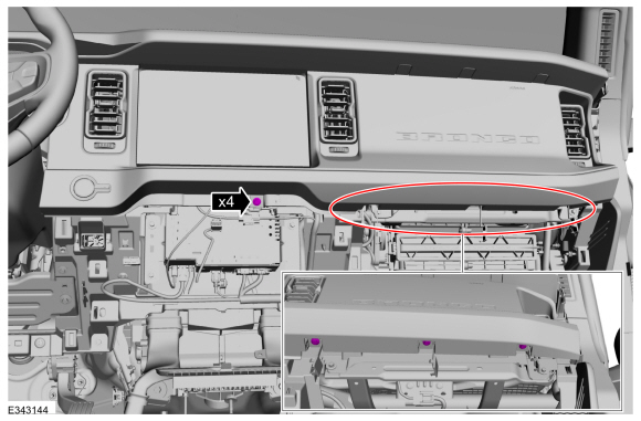

  1. Remove the upper passenger side air bag bracket bolts.
    Torque: 93 lb.in (10.5 Nm)

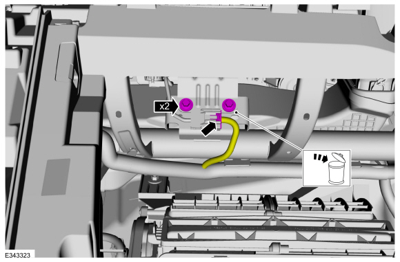

  1. Disconnect the electrical connector and remove the lower passenger side air bag bracket bolts.

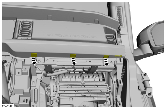

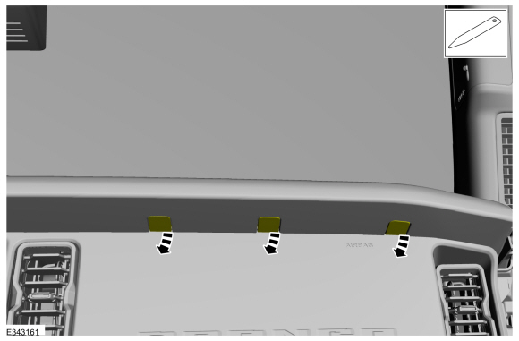

  1. Release the clips and remove the RH center instrument trim panel and passenger side air bag as an assembly.

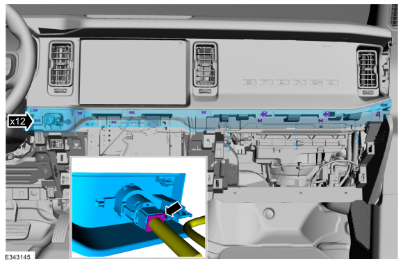

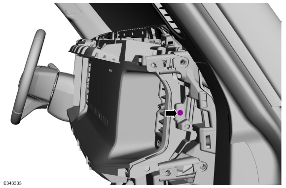

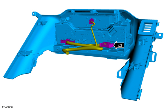

  1. Remove the bolts, release the clips and remove IPC trim panel.

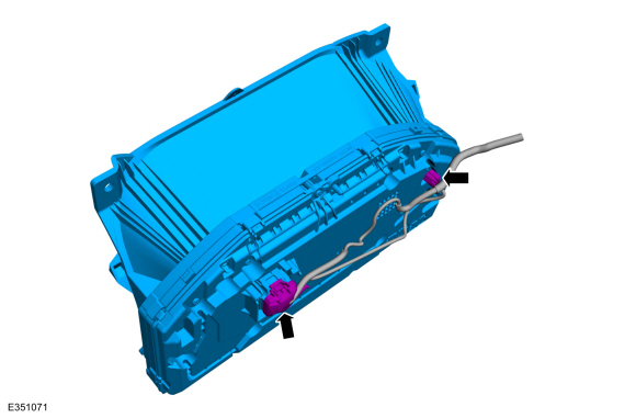

  1. Disconnect the electrical connector and remove the IPC.
