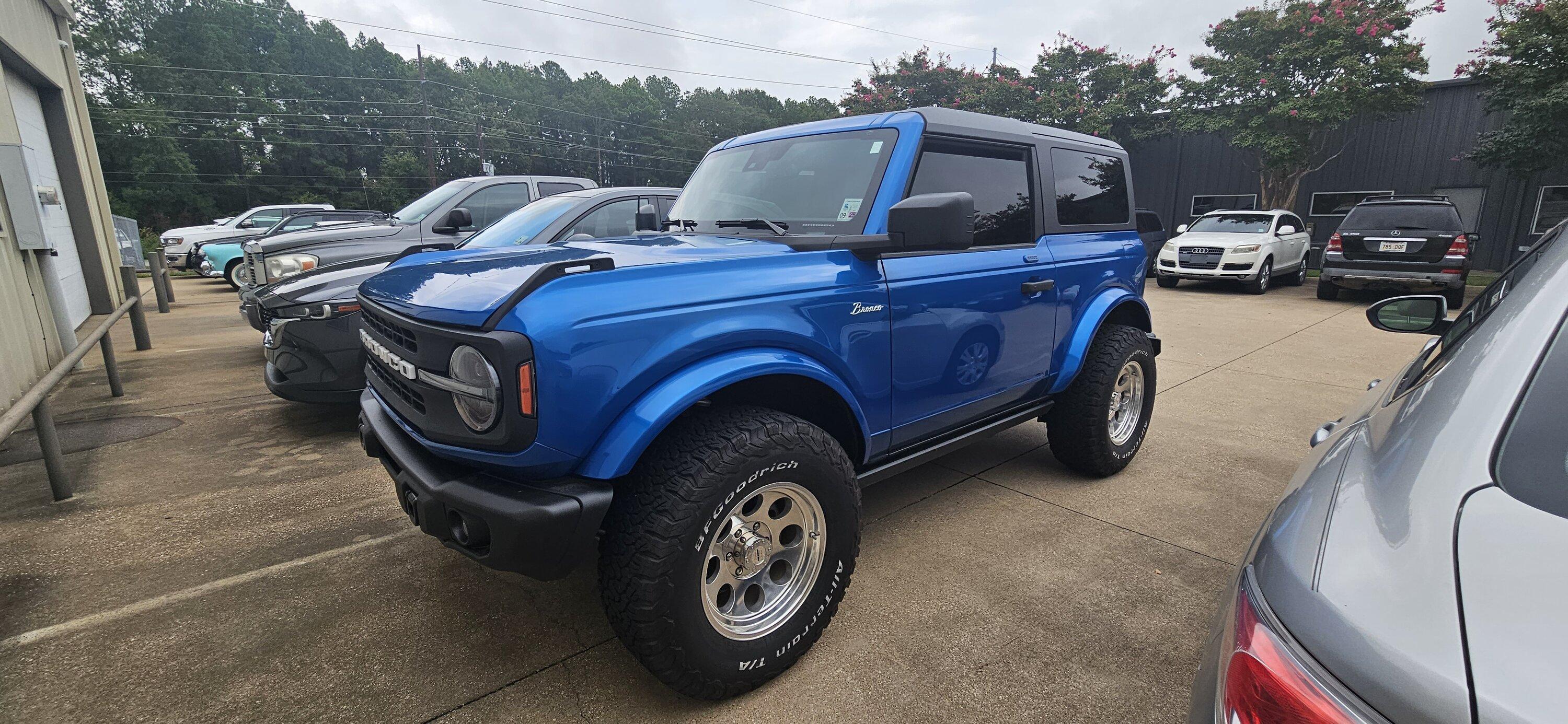

I know theres tons of info on this topic but ADD and attention span gets the better of me trying to search so much. I have a 2dr black diamond non sas 2.3 auto and looking at sas take offs. Found a set of 2dr badlands 2.3 sas takeoffs. Can anyone tell me what to expect? PFA

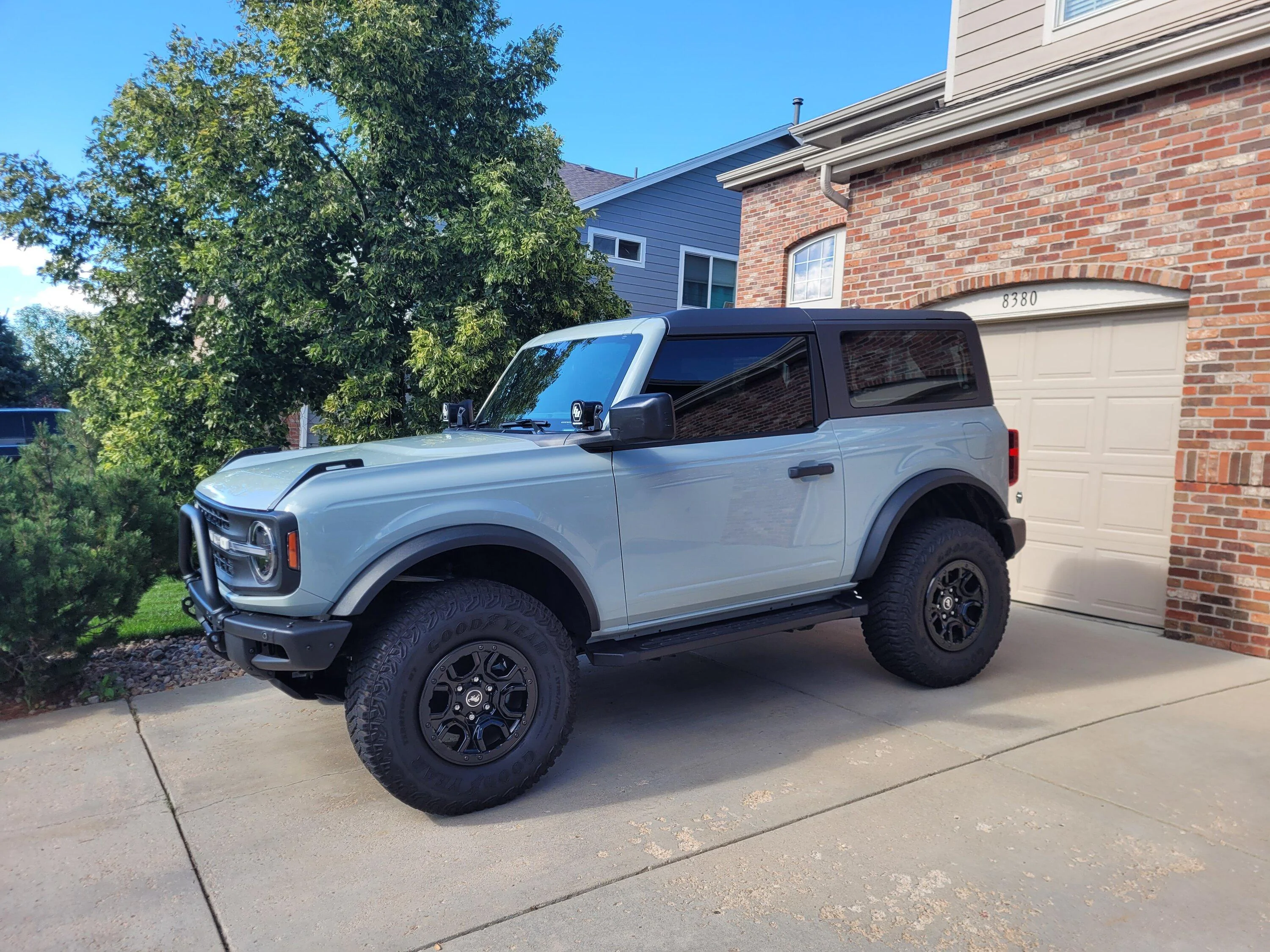

I have a 2.3 2 dr auto as well and put SAS takeoffs on mine. Not sure what you mean by what to expect but it was a very easy swap. I also did an additional 1 inch lift front and 1/2 inch rear with 2 RC level kits.

When I asked what to expect I was referring to how much lift and ride quality. Sorry shoulda been more specific. Im very happy with my ride quality but the hitachis have a horrible nose dive when braking. I thought I had read that swapping will eliminate some of that. As for lift Im hoping to get roughly 1.5f/1r at least.

I put the full level kit up front, 2 round shims and the u shaped spacer on the bottom and then for rear just the 2 round shims on top. After it was a little nose high for me so I removed the lower spacer in the front so I have the 2 round shims at all 4 corners now.

Nice! That's basically what I'm after. Good to know about the shim placement, for balance when loading stuff in back, I don't want the front too high. Thanks for the info.
