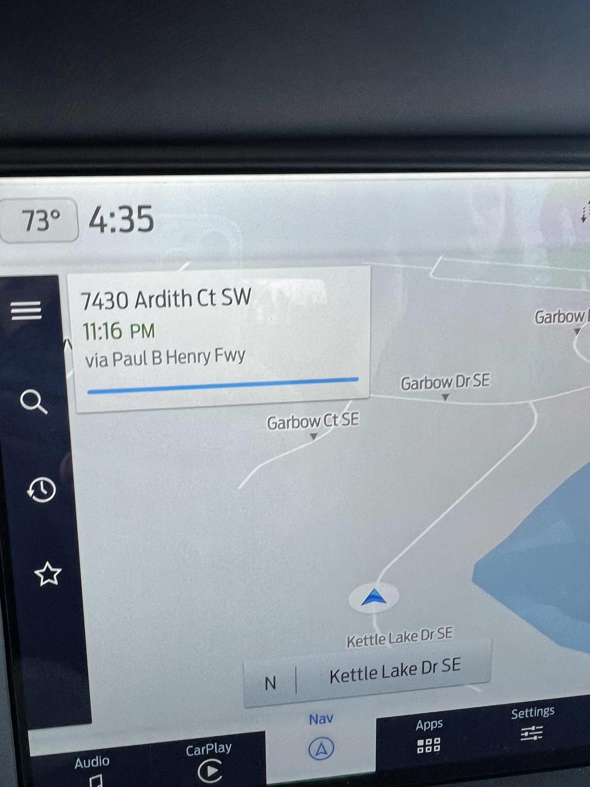

Here’s a new one I haven’t seen listed yet. Since my update my arrival time is now all over the place. It’s a 25 minute drive from my house to the office. The time now shows several hours and minutes. As I complete the drive it’ll slowly become more and more accurate. When I’m a block from the office it’ll still show an arrival time that is 5-10 minutes out. Noticed this both on the way to work and going home.
Ford Bronco Sync Bugs Post-PowerUp 3.5.3 IMG_6481
Having the exact same issue, super frustrating. Also found that when I ask Alexa, it only shows on half the screen. It's almost like the UI thinks it's an 8inch screen not the 12inch.
